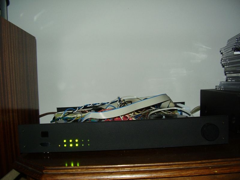

My humble UCD180 integrated amp.

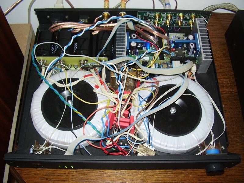

It uses a ready-made module for input switching and volume control (top-right), controlled by a microcontroller. Has working remote control. The Vishay pot you see on the right is actually going to the A/D converter input of the MCU, which is used for sensing the movements of the knob, and indirectly controls the digital pot (DS1666). Although the wiring looks crazy, the signal path is very short, and does not physically expand past the modules.
The LEDs on the left are not VU-meters as one might think but volume/selected input indicators. I felt that was the most visually elegant solution. The button on the left is used for input switching.

maxlorenz said:
Wouldn't it be better to separate de modules and put the PS caps in between?
(that way you could have shorter speaker wires if you place the binding posts near them, one at each side of the box)
M
Maybe from an aesthetics' point of view, yes. But that would lengthen the input wires. Which do you think is worse? 🙂
Hi mr_push_pull,
Congratulations on a very nice amplifier project.
All wires in a power amp should be kept short. However, if you had to choose, then the wires carrying the most current should be shortest.
If it were my project I would have put the PS in the middle and the modules to either side of that. The input jacks separated and on the far outside edges of the back with the output posts for each channel just in from each of those. The power cord and fuse would be in the center of the back plate. With that arrangement you can make all the internal wires short.
Best Regards,
Graeme
Hi Graeme and thanks for the nice words
I totally agree with you. Unfortunately, I was forced to make some compromises. For instance, te input module wasn't designed by me, but ready made. It was designed so that it used the RCA input jacks also for fastening to the case. It has no other means of fastening, nor any place on the PCB to improvise one. And that's not a bad ideea after all, it saves you a lot of trouble, and there is no wire from the jack's to the PCB. You can't get a shorter a signal path than that. Also, the holes for the input jacks on the case were already drilled - as a matter of fact they're factory made.
So, the decision of putting the modules near the input came naturally.
The only drawback, if it really is a drawback, is longer wire from UCD's output to binding posts. Anyway, even if I had put them near the sides, I wouldn't have saved more than 2 inches of wire.
Try to look at it this way: the output and supply connectors of the UCD are closer to its input connector than the output wire is to the transformers or the input 🙂
Everything is a compromise in the end. And I wouldn't give up the luxury of having a remote controlled input selection and volume for anything in the world 🙂
