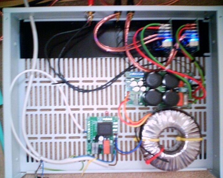

I agree about the cooling. I box I bought to 'get things going' had both a grill in the base and the lid ( as can be seen in the crappy picture attached) While i thought would aid ventilation it's actually made construction very difficult as I had nothing to screw anything to.
However you'll see I put a piece of 2mm aluminium plate under the 180s. Whether it's because of this, the vented floor or just the ambient temperature (spring) the case (and plate)hardly produces any heat at all.
What I like about the boxes from VT4C is that all the connectors are fitted already. What's really dumb is that i've spent $100 on the 'temporary' case when I could have spend a lot less on a finished product 😡
Next up is 5 channels. The HG has DC protection for 2 channels which i duly connected. I'm not sure what I'll do for the other 3 channels. A second HG will afford protection for 2 of those channels, but I don't suppose I could simply wire two together?
I did have a bit of trouble with secondary wiring. I'd seen somewhere a recommendation to use 3mm cable. I used 2.5 but even so was hard to route easily. thinking about it now is any reason why 1.5mm wouldn't suffice?
Ian

Looks good!
Layout is important and I think you did a good job of separating the different wires into a logical path, avoiding any unecessary criss-crossing.
Yes 1.5 mm is good enough. It is recommended to twist these DC wires together.
I have no experience with DC protection since I don't have this on my amps.
Right, you cannot.I don't suppose I could simply wire two together?
