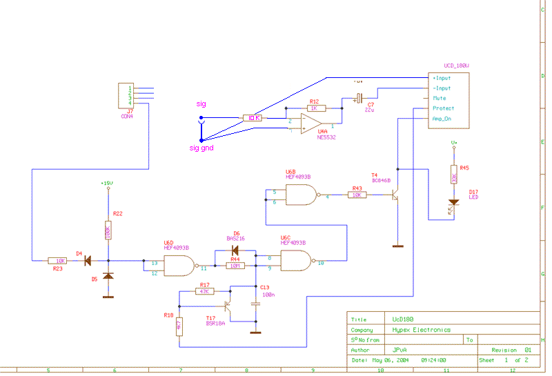

Also as my sources are unbalanced could I slightly "botch" (excuse the terminology) the board to accept a single channel op-amp at the input buffer and tie the ucd modulator to signal ground, the pre-amp will be integrated and so shouldnt be an issue with grounding hum, I think I can put a schematic together but any considerations would be greatly accepted.
thanks all for your help
TAWN!
perhaps as simple as this or perhaps not, I will sertainly be after four of these amps, although opinion would be appreciated there is nothing like finding out for yourself
if my schematic is BS please tell me I suck and throw myself in the garbage can......
Thank you

I don't know if your schematic is OK but why don't you just do what Hypex recommend in their application note for unbalanced input? http://hypex.nl/docs/wiring.pdf
And quote from Bruno:
Here's the full recipe for wiring up an RCA chassis part:
*Use non-insulated RCA chassis parts. They will serve as the chassis connection for the whole amp. You don't want to have the whole amp floating in the chassis or you'll get one heck of a buzz when you leave the inputs open.
*Make no other chassis connection elsewhere, but otherwise wire the whole thing normally.
*Preferably use shielded twisted-pair cable, such as microphone cable.
*Tie pin 1 of the module's input connector (J7) to the RCA signal pin using one of the two conductors.
*Tie pin 3 of J7 to the RCA ground lug using the second conductor.
*Tie pin 2 of J7 to the RCA ground lug as well using the cable shield. This step insures the amplifier is no longer floating with respect to chassis.
This method insures that any ground currents flow through the shield, not through the "cold" wire on pin 3.
If you have a substantial personal preference for using 3 separate wires instead of a shielded twisted pair, at least twist the 3 wires together.
The problem with unbalanced (RCA) connections is obviously the sensitivity to ground loops. Because of this, you should not connect the chassis to mains earth. Instead, follow double-insulated construction methods on the primary side for safety.
There are a few tricks to make an RCA input "pseudo differential" using the differential input of the UcD module, but I'm afraid to "float" them here because that will cause more confusion. Besides, the above description is the most solid because using uninsulated RCA parts also keeps your amps from RF break-in.
Having said all that, it is always best to use XLR inputs and build a "converter cable" (see new doc on Hypex site) that extends the differential sensing trick all the way to the pre outs.
Bruno
If your pre is integrated then you would connect it as you would a RCA. I would not mess with the UcD's input stage but if you know what you are doing maybe that's a possibility.

Well a couple of reasons, why I would prefer to do things the awkward way, the first of which being that I am plain awkward,
As my amp is to be of the integrated variety in the typical sense the preamp in this case will be of the unbalanced type, and so if I can take the opertunity to use a OPA627 as a (buffer) buffer I would like to do so (still looking at how well that one would fair unity gain) the cost of these being more economical certainly in this case to use a single than a dual, Its more a case of taking advantage of a scenario, and simply being DIY the whole mod & con aspect is what one finds so appealling, call me obsessive compulsive (and call myself impurist) but I would feel like ive got an itch that I cant scratch if I left a channel of an opamp just conducting to ground.
I am not looking to have a chassis input for the UCD180
I would never power a power amp up with the interconnects unplugged anyway!!
I beleive using power and signal grounds correctly will have the same effect in this case with respect to ground currents.
again appreciate the input it does help indeed
Thank you!!!
