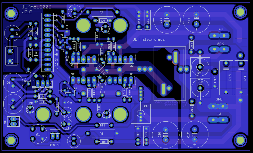

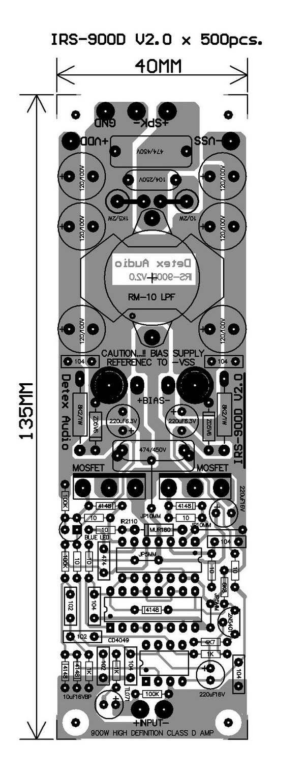

IR9OO
LAYOUT-PDF
what r differences between these?!
ir900
hello, friend !!! can pass me the pdf files to transfer the ir900 ?? grateful !!^ OK! thanks,
