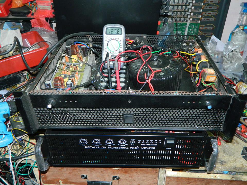

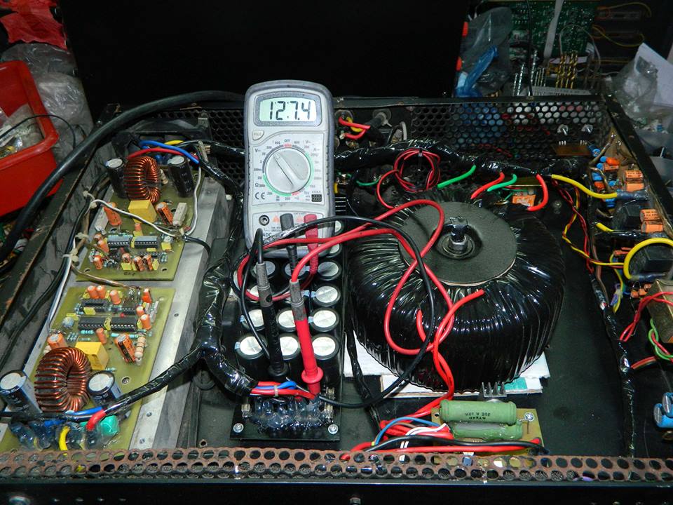

MY DIY TORRIDAL 90 0 90 AC
Hi andrew,
for 127V supply which MOSFET you are using??
Peak RMS is 2016W @8R load current 16A
Good design
Regards
MANOJ

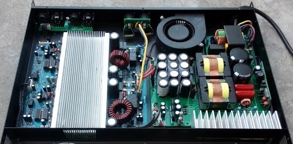

Hi NMOS, is this D-amp base on IR2110 ? Carrier base or self OSC. It look's new to me.Hope you can give us an idea.
Yes its self OSC, my latest design ready to start promote and sell in qty
850 W @ 8 OHM RMS
- Class D
- UCD 25 watts to 1200 watts using 2 mosfets
