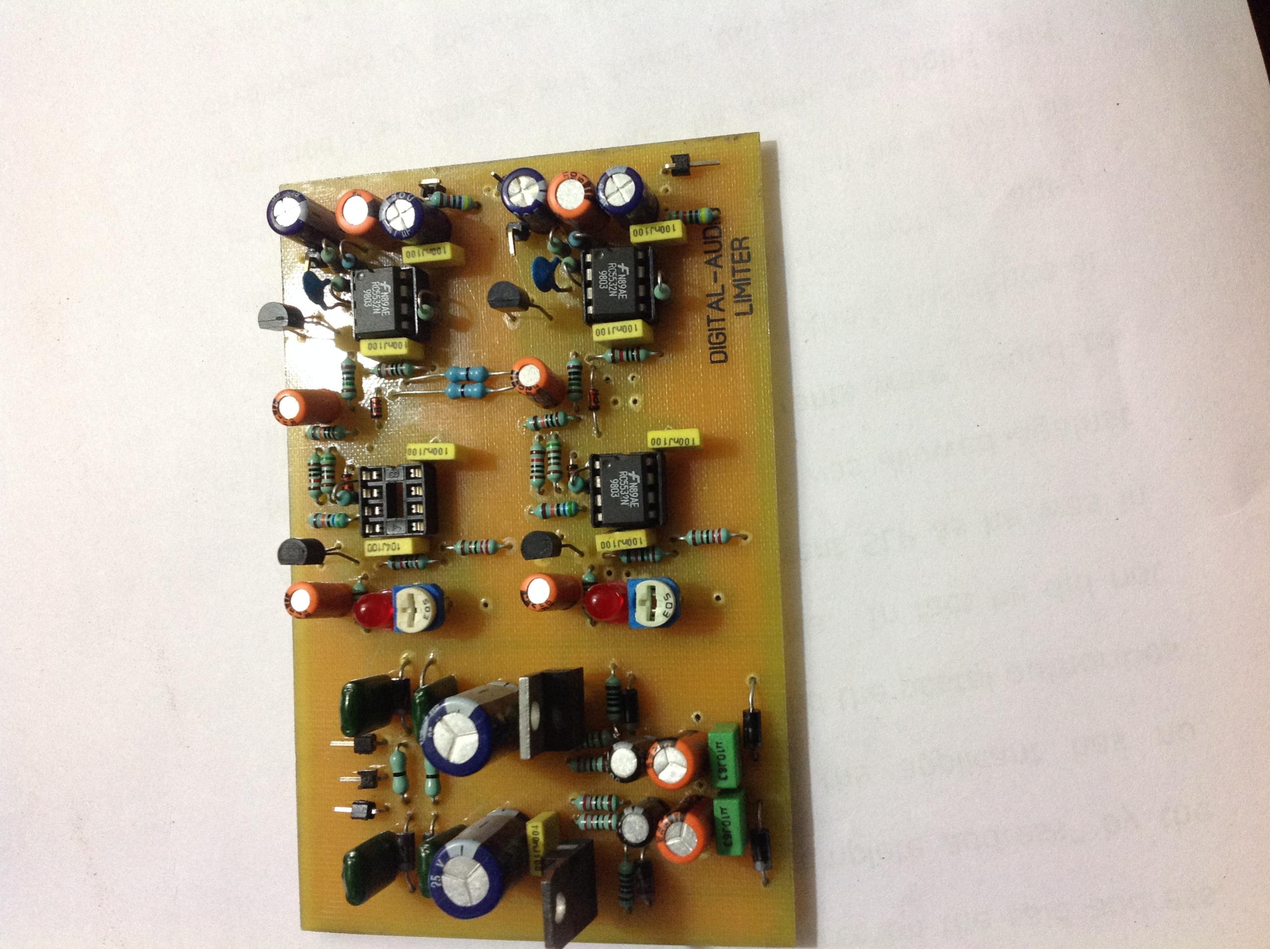

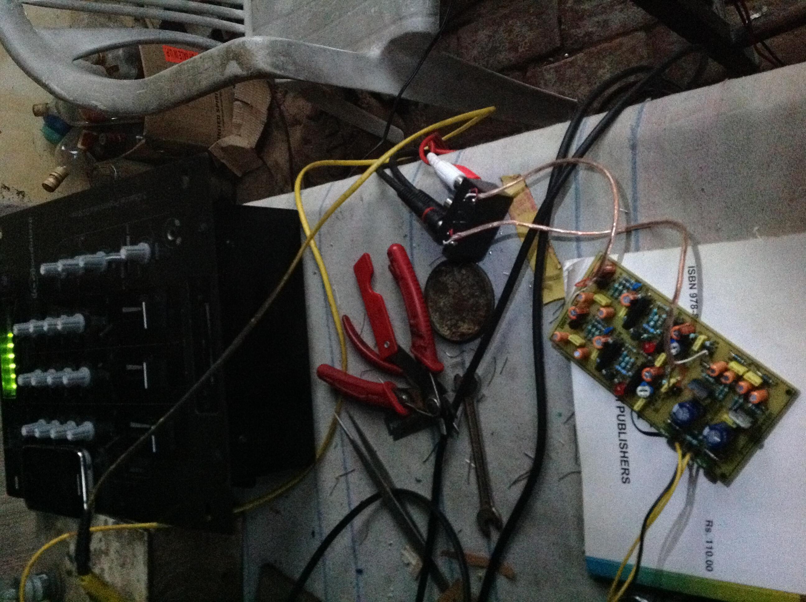

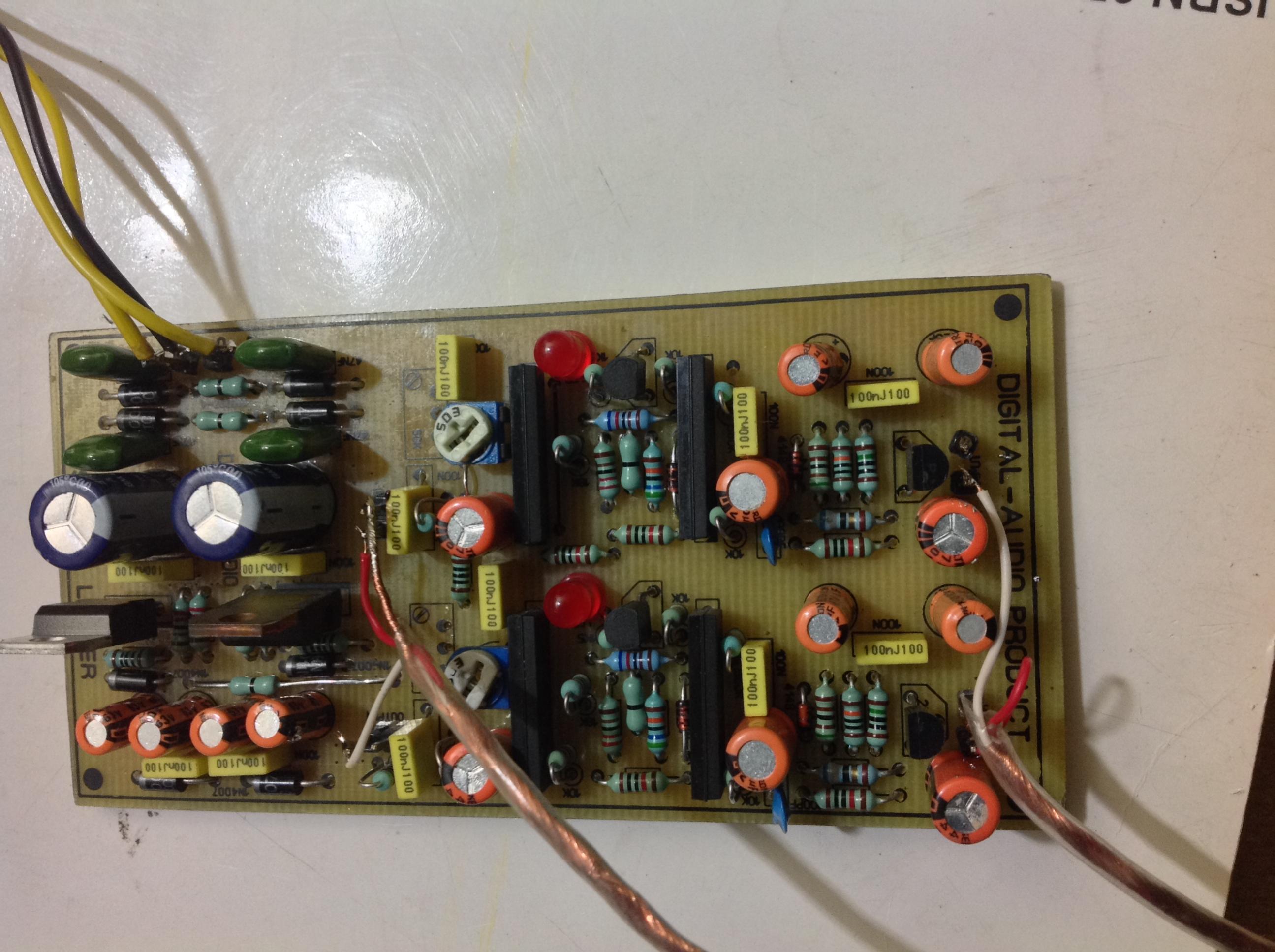

Hi ,Finally tested limiter on class d amp😉
but I cannot see any optocouplers on your pcb ? :eek What is the regulator element of the limiter ?
PS can you show a video how the limiter works ? I mean from a oscilloscope....

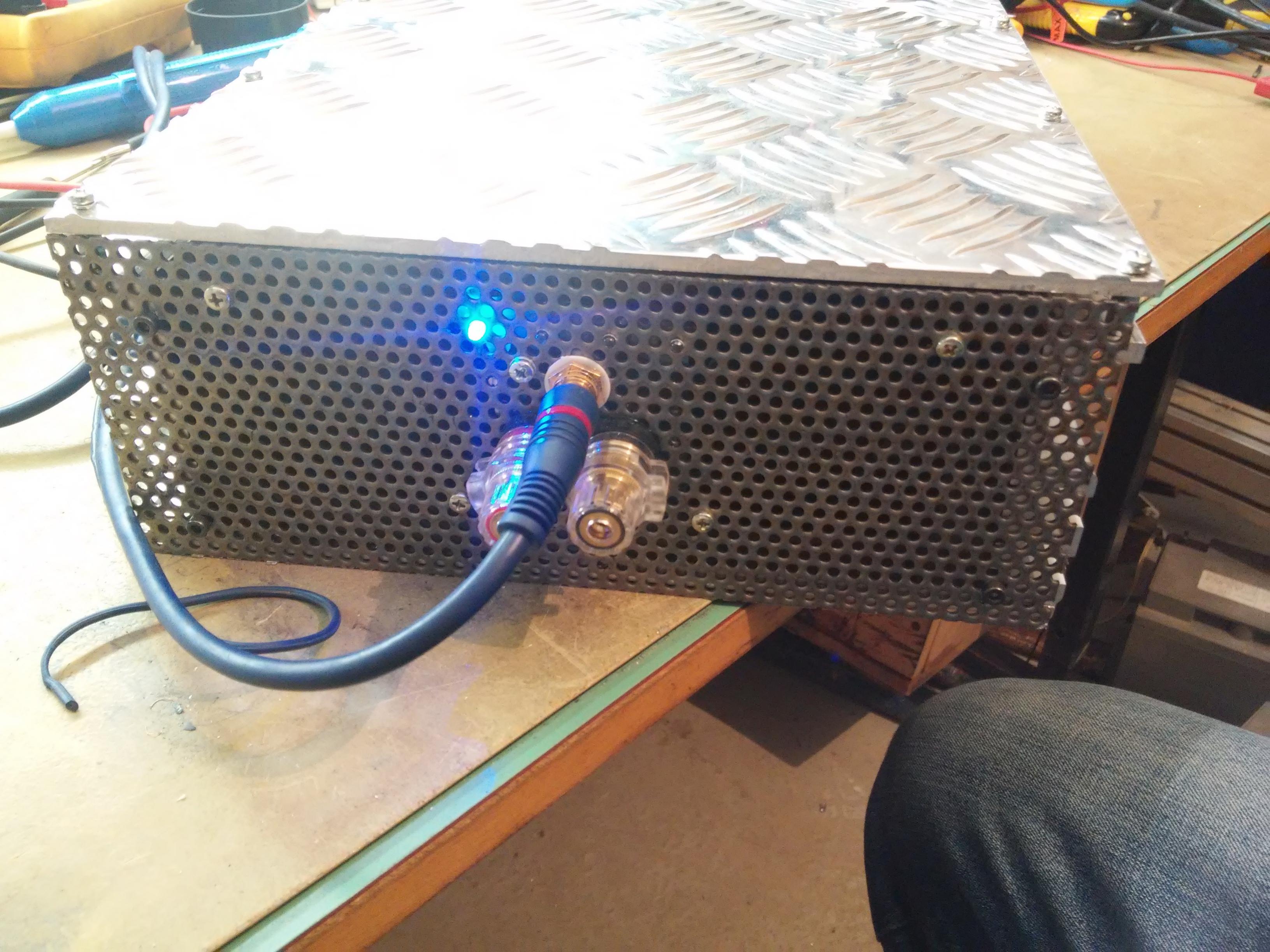

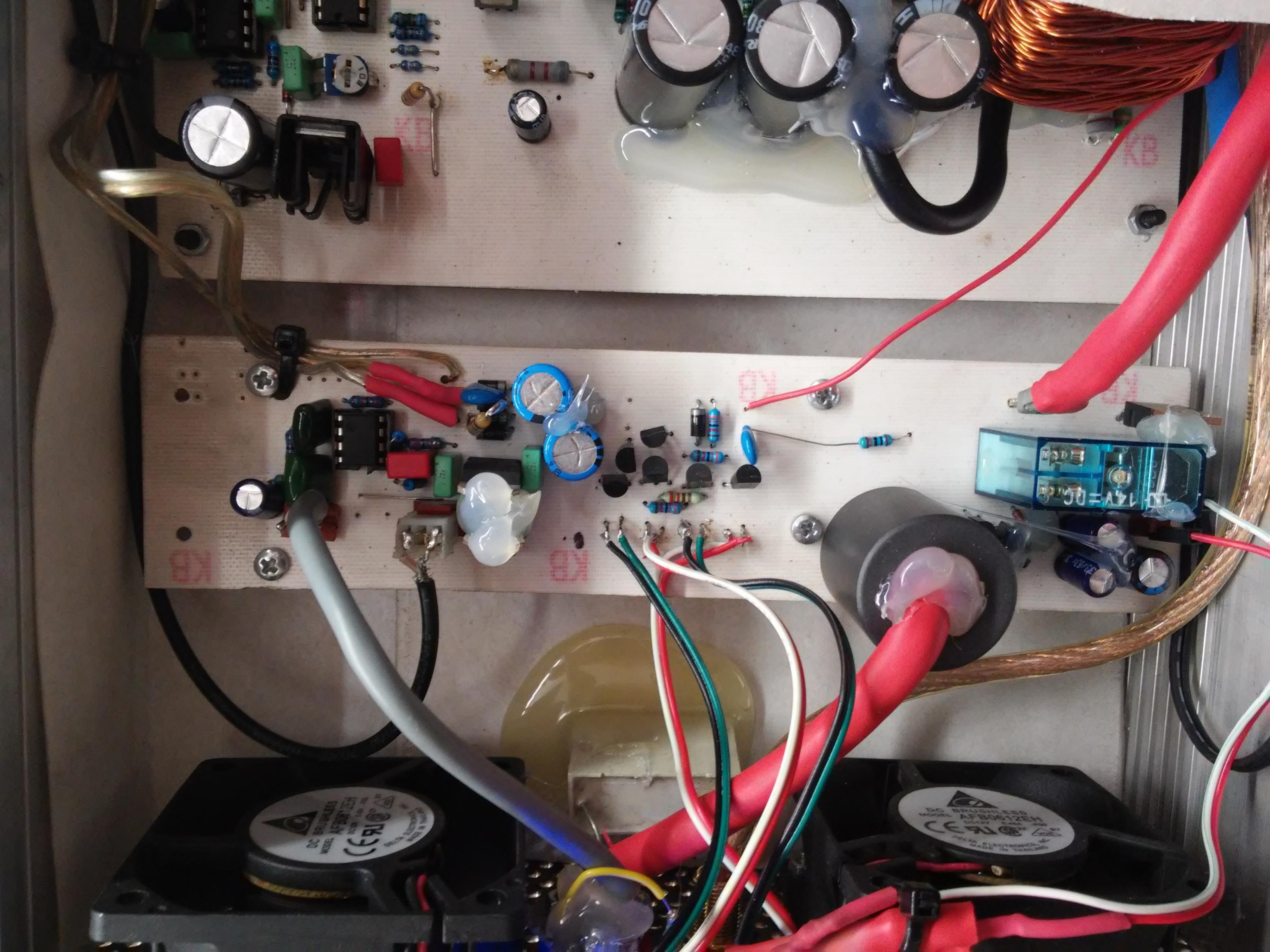

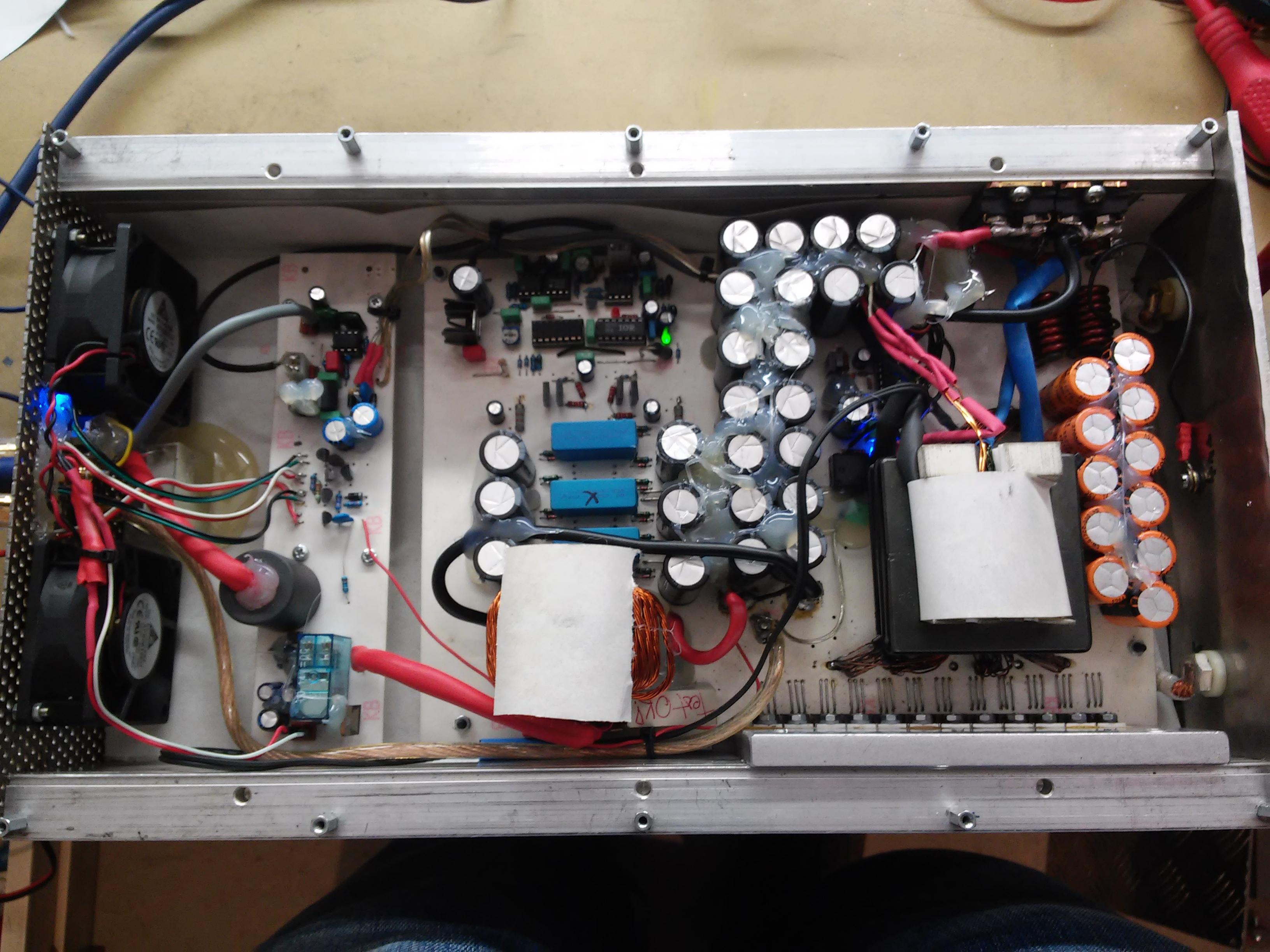

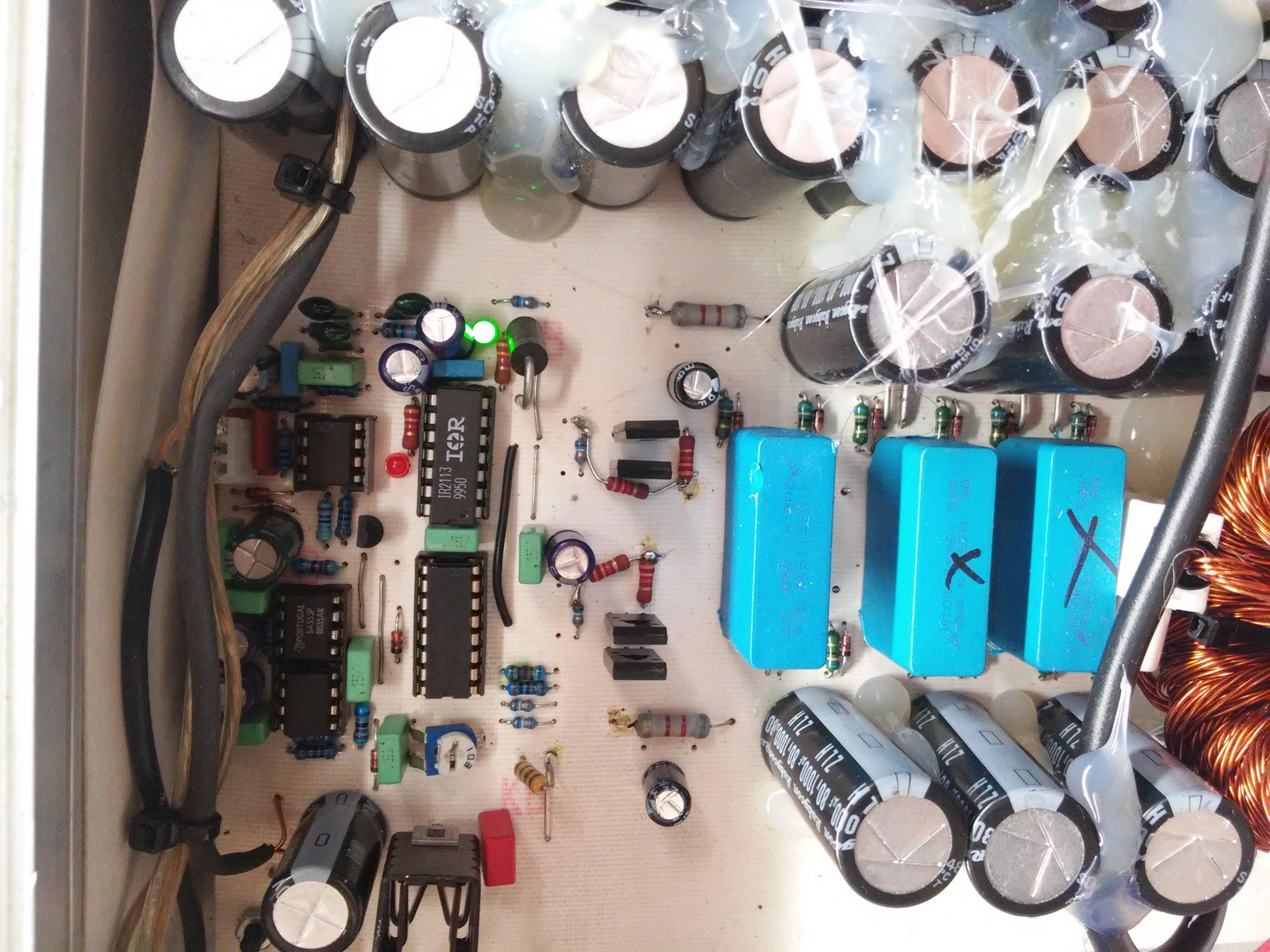

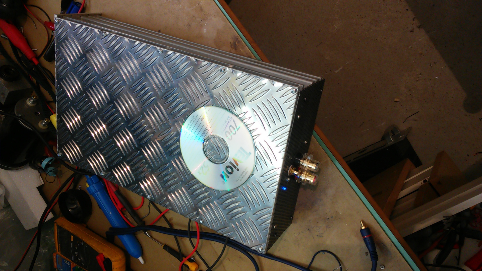

And my product + - 80v at 1 ohm with LPF filter, OC, DC protection, vu meter.
Interesting... was it tested on 1R yet?And my product + - 80v at 1 ohm with LPF filter, OC, DC protection, vu meter.
look great... what was final price for all?

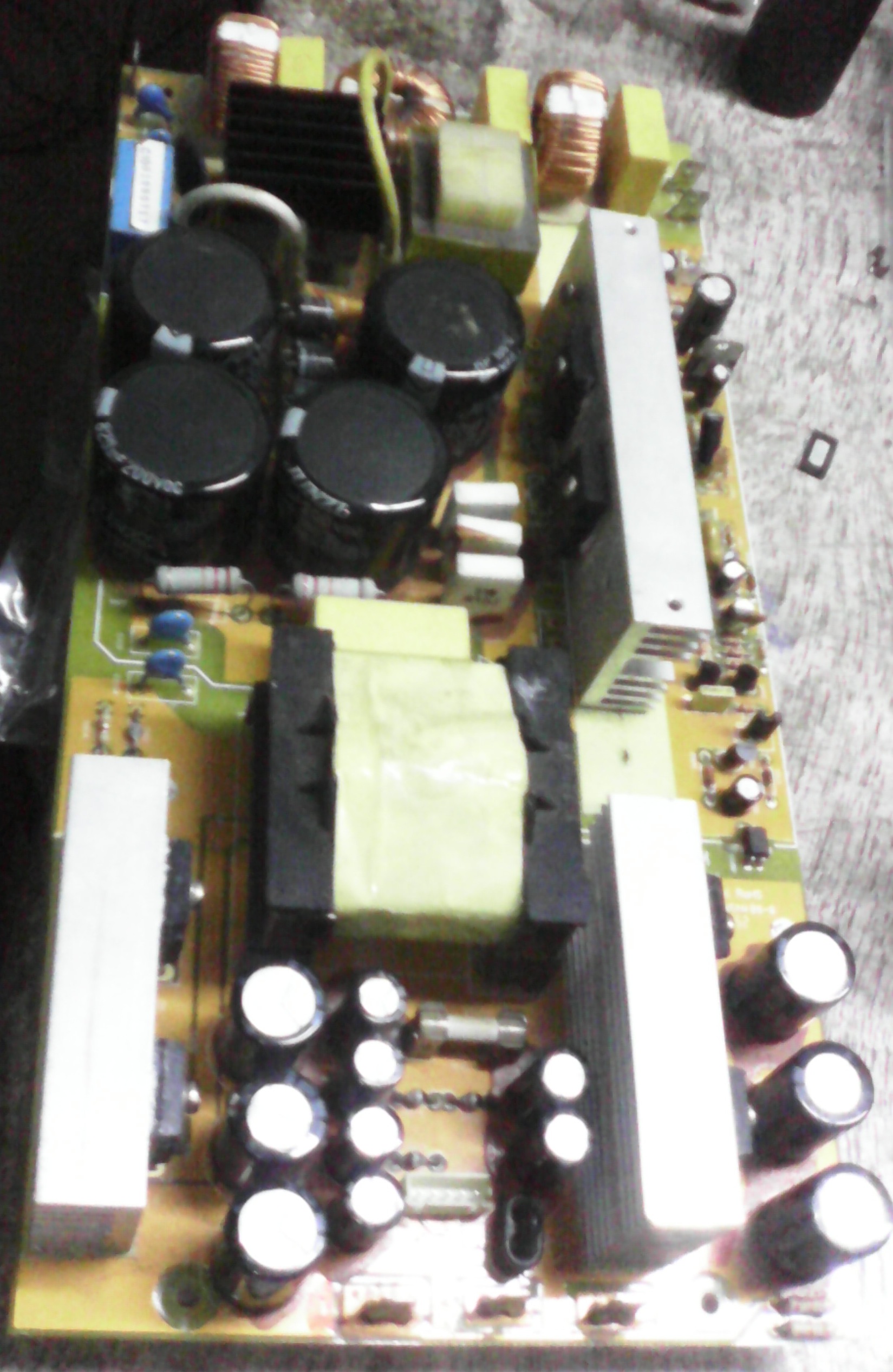

Hi.
I want to build irs900d +/- 80V. I have a problem I do not know what to use for the reactor core. What do you recommend for the core of the amplifier?
Hi.
what is the load impedence and switching freaquncy
300khz>Fs>250khz
8 ohms speaker 80v/8ohm =10A (T106-2 is ok,T130-2 good)
4 ohms 20A need high currunt inductor (T157-2,T187-2,T200-2 best)
2 ohms 40A not possible for us(diy level)
Fs>300khz
8 matirial 6 matirial OK
http://www.micrometals.com/downloads/MicroRelease_March2010.exe
Many thanks for your reply..
The original frequency is 270-280khz. My smps has only 1,2kW and overload protection so load impedance is 8 ohms.
I decided to buy T157-2 core.
I have a problem irfp4772 are not available, what is replacement?
Better use ferrite core , it requires less turns and so less copper . The difference in losses is huge .I decided to buy T157-2 core.
