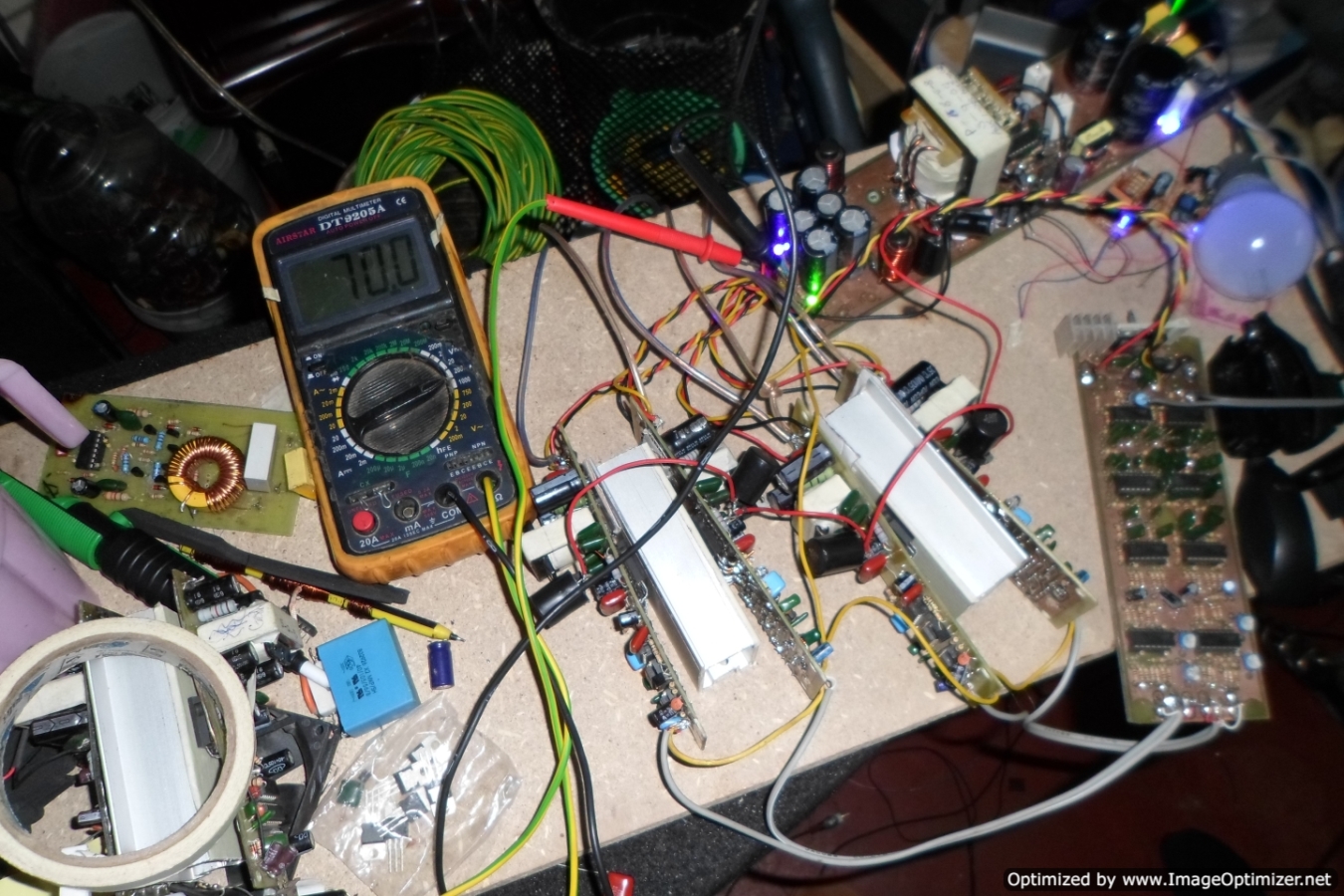

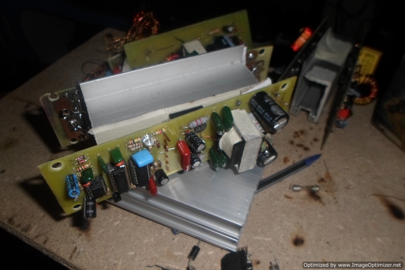

Hi Steve,
your schematic does not show any start up path for the upper gate drive supply.
==> A self oscillating amp without such start up path is likely to lock up, especially during turning on.
You can try a 33k (at least 0.5W) resistor from positive power rail to the VB pin of the IR chip.
Your obseravtion of high current draw and blowing fuse is a little bit making me afraid, that you are also struggling with some parasitic effects which provide some uncontrolled gate drive to the upper MosFets even without driver supply.
This is adding the unpleasant risk of a heavy defect when experimenting with the additional resistor. To reduce this risk, you should put serial light bulbs (i.e 230V/100W) in the pos and neg supply wires before experimenting.
Good luck
Markus
[/I]

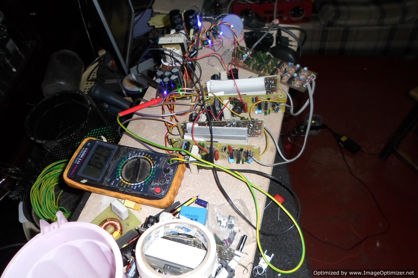

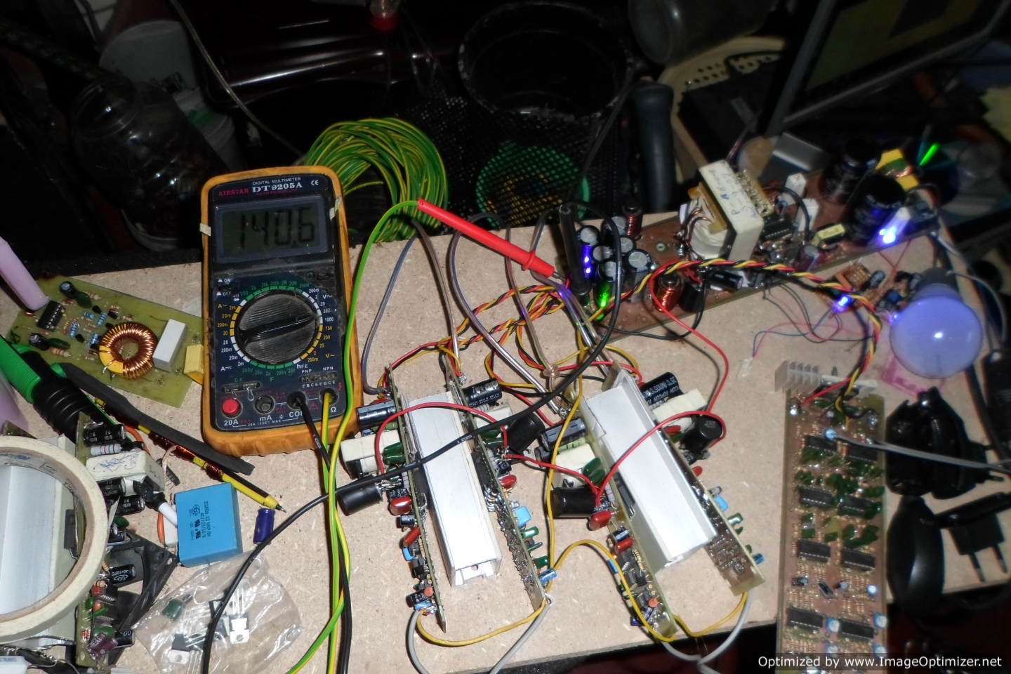

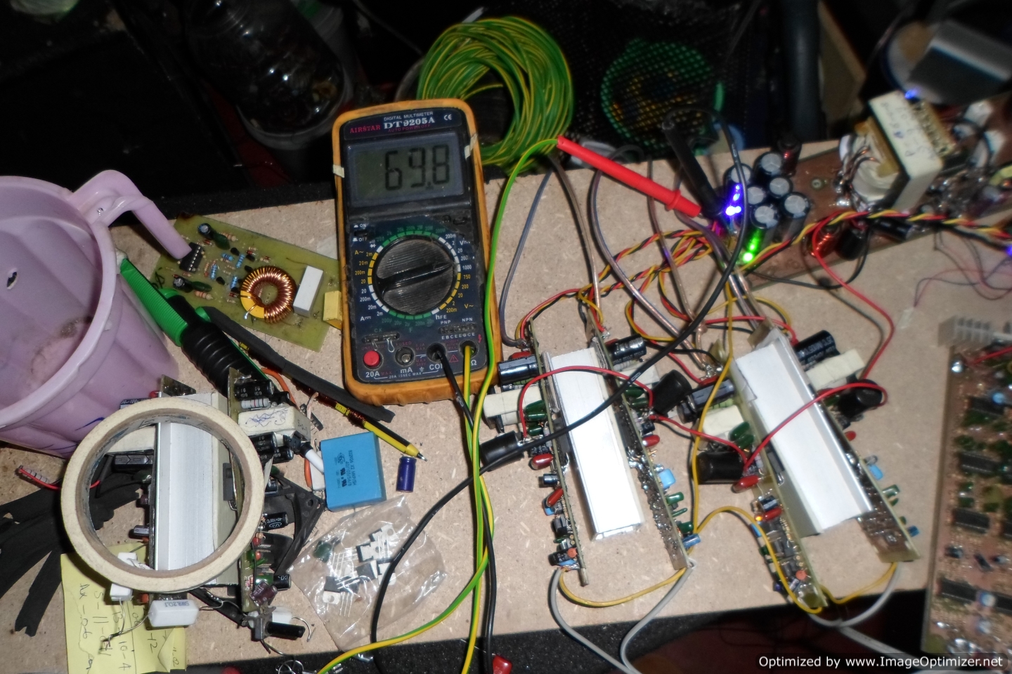

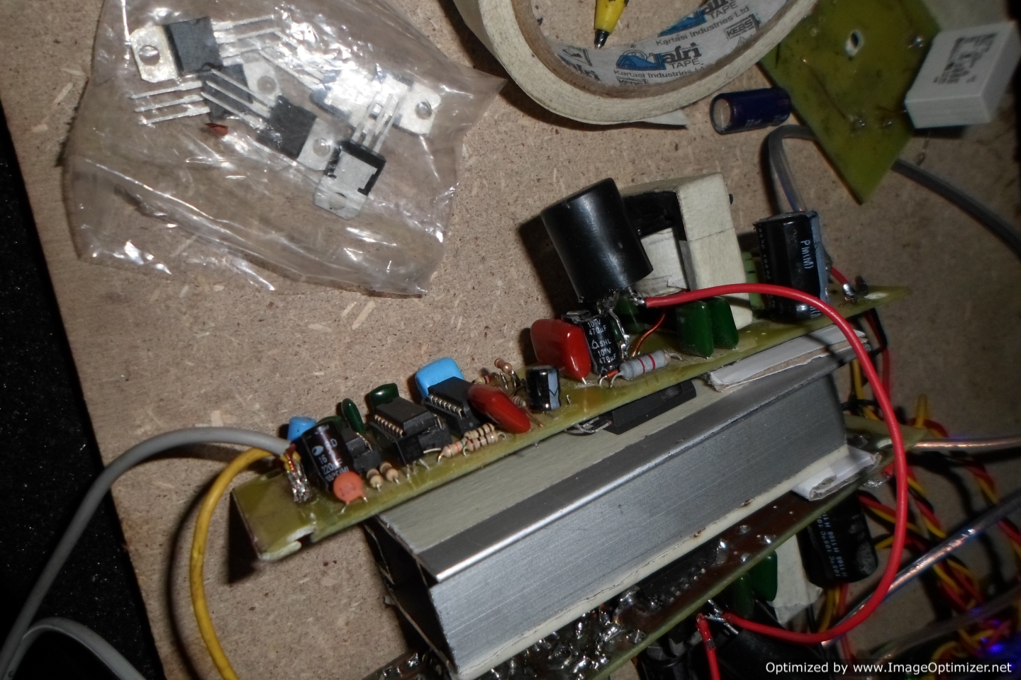

hi choco i did as suggested still no improvement but a bit stable on starting up.
Hi stewin,
Without load(speaker) amp will not oscillate.Provide a dummy load use 1K5/2W or 2K2/2W resistor.
Regards
MANOJ
also manoj the 1k5 is at each output still no change
😕i think i'll go back to ucd original circuit by etajale or use one power supply for a maxx of two channels😕
any way my smps worked with the amps and crossover without issue i thank GOD for dimonis sharing the amazing calculation tool diysmps
diysmps
http://www.diyaudio.com/forums/powe...r-4000-a.html?highlight=smps+transformer+tool

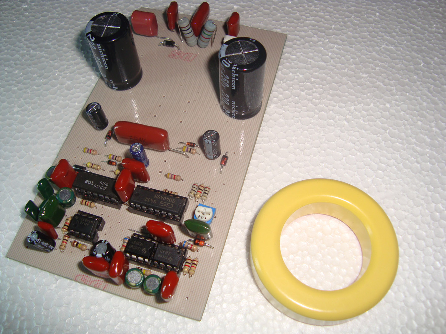

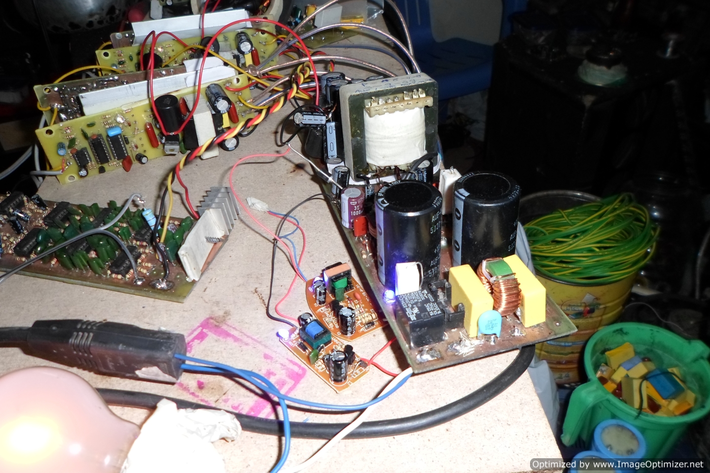

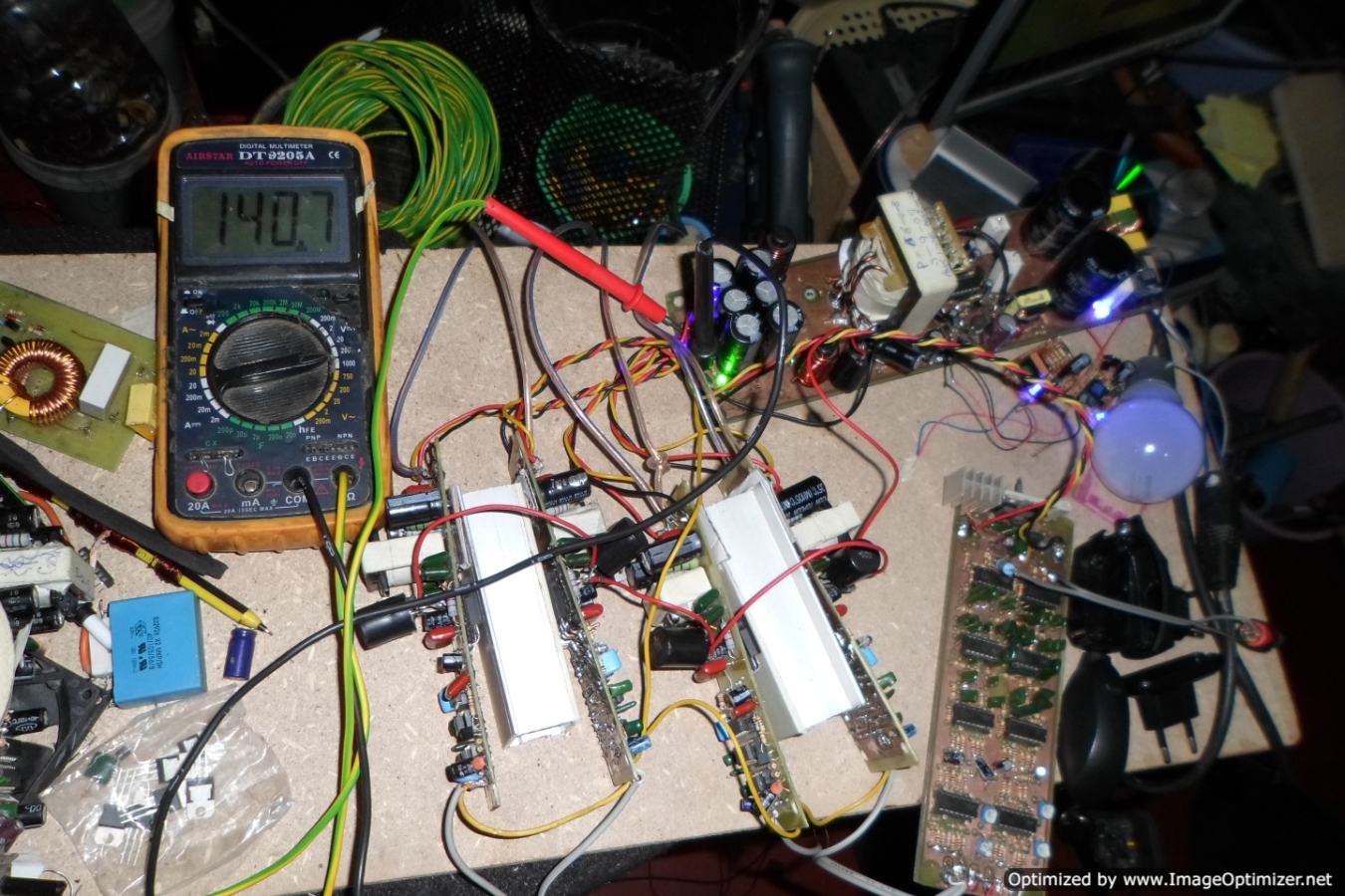

also added small aux dual 6vlts travel phone charger for power supply because the mje 340 2k2 2wts droppers were over heating but every thing works fine even the amps provide i did not disconnect a speaker from any of the four 4 channels . the channel i disconnected a speaker failed after 20 mins even though there was no signal except just power supply. but apart from the above every thing was cool and the no class d noise the photos

...to bad that your amp has remaining issues without load.
Seems like we are at the point, were detail measurements would be necessary for proper debugging.
Of course also always an option - (no, I am not proposing it, my engineering soul dislikes this method to much) just randomly varying components / randomly trying small variations of component values...

Hi Stewin,
changing to UcD is in my eyes also just a random variation.
And for sure a variation which is large enough to make it impossible to draw any engineering conclusion from it.
Even if it works in UcD config there is no evidence if the issues of your current version are caused by the working principle or specific implementation details.
Basically your schematic is showing a self oscillator consisting from a rectangle+integrator+hysteresis, which is a well proven traditional configuration for oscillators.
Nevertheless, if you know a bullet proof implementation of UcD then it might be easier to use it rather than debugging your current design.

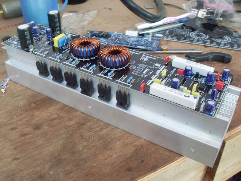

working in progress irs3000 detex audio.
Already mounted this amp and have had several problems with it
what is the problem u faced with irs3000?
This circuit oscillates with only the audio signal at the input and output load.
Rather circuits based on IRS2092 or the crystal oscillator - according to the scheme already posted this forum.
Stewin, try it with separate bias supply for each of the module first before scrapping your work haha,..
the amp sound is excellent , except the issue of powering the amp without a speaker load everything is o.k.
bias supply you mean the 12vlts to feed the ir2110?
