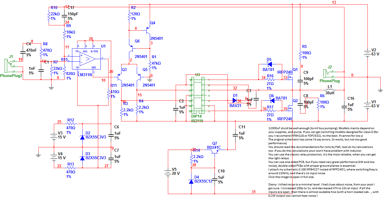

Voxac30:
12000uF shuld be well-enough (to kill bus pumping). Mosfets mainly depend on your supplies, and purse. If you can get switching mosfets designed for class-D (for you I reccomend IRFB4228 or FDP2532), its the best. If cannot for low p
The original schematic has some I'd say errors. (it works, but not too good performance)
You should read the reccomendations for coils by Pafi, look at my calculations too. If you do the calculations youn won't have problem with inductor.
You can use the classic relay protection, it's the most reliable, when you can get the right relays.
You can use one-sided PCB, but if you need very great performance (kW and low noise), double sided PCBs with proper ground planes is essential.

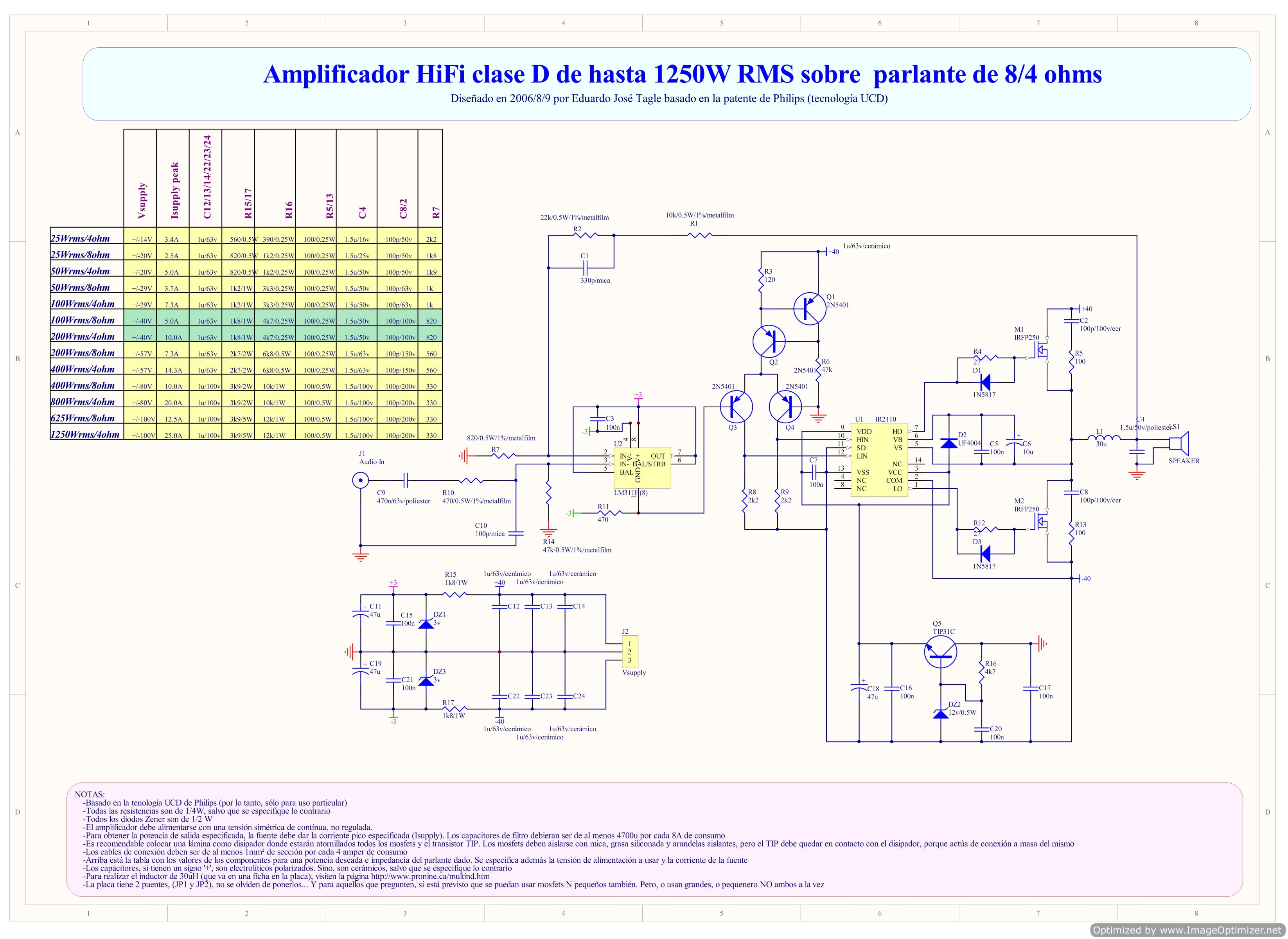

I attach my schematic (I USE IRFB4227 insted of IRFP240!), where switching freq is around 220kHz, and there's no input noise.
Dzony: i killed noise to a minimal level. I had clues about noise, from your post i got sure. I increased 100p to 1n, and decreased 47k to 22k at input. If all the inputs are open, then there is almost audable hiss (with a horn loaded cab..., with 0,1W output you cannot hear noise 😀)

hi all back to basics that is ucd mode . i hope there will be no issues with multi channel. my current project based on lorylaci ucd tested and improved in terms of noise and harmonics.
  • ucd 25 watts to 1200 watts using 2 mosfets pg 75 correct pimped ucd schema UcD_IR2110_www.k (2).png

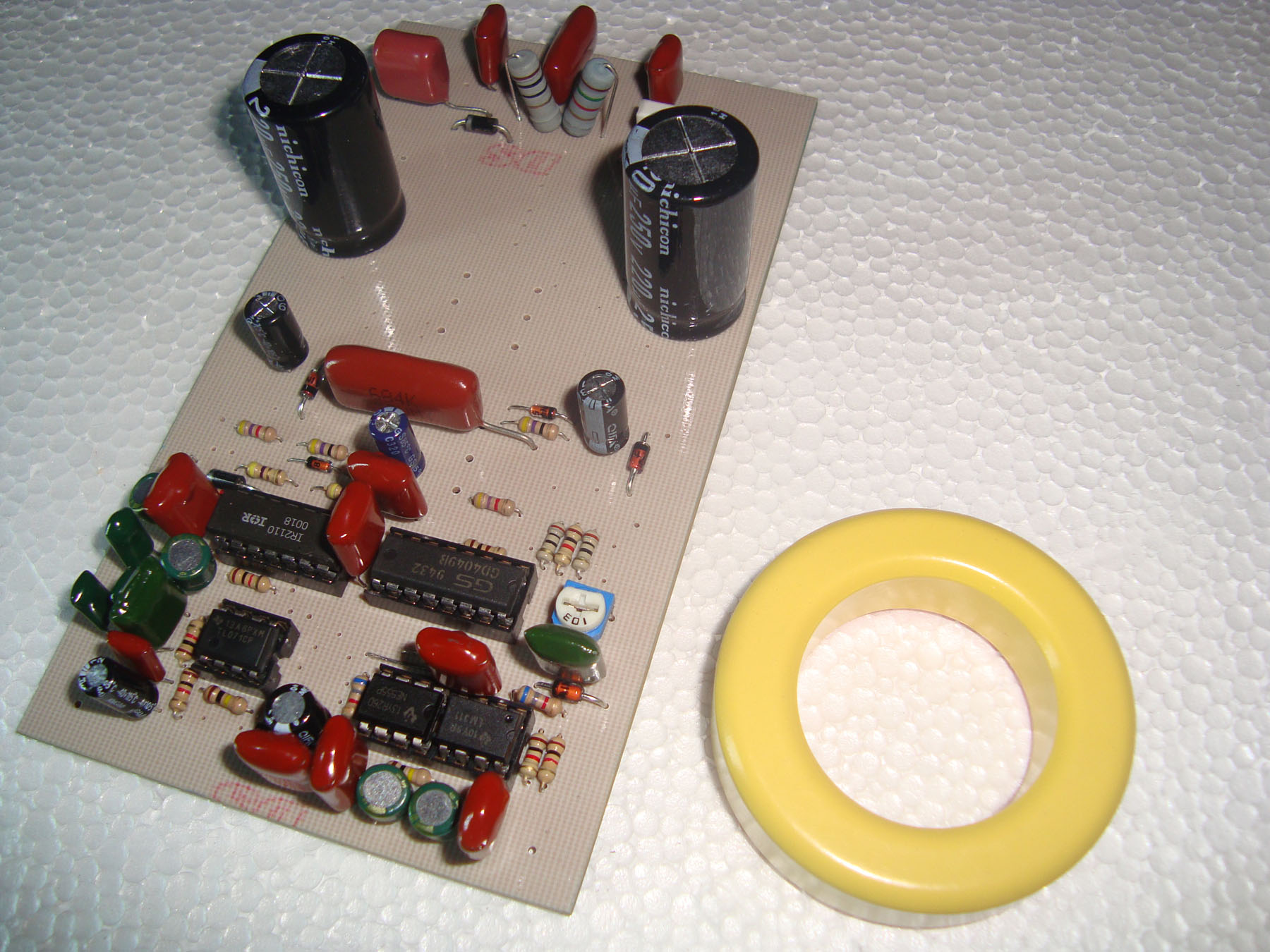

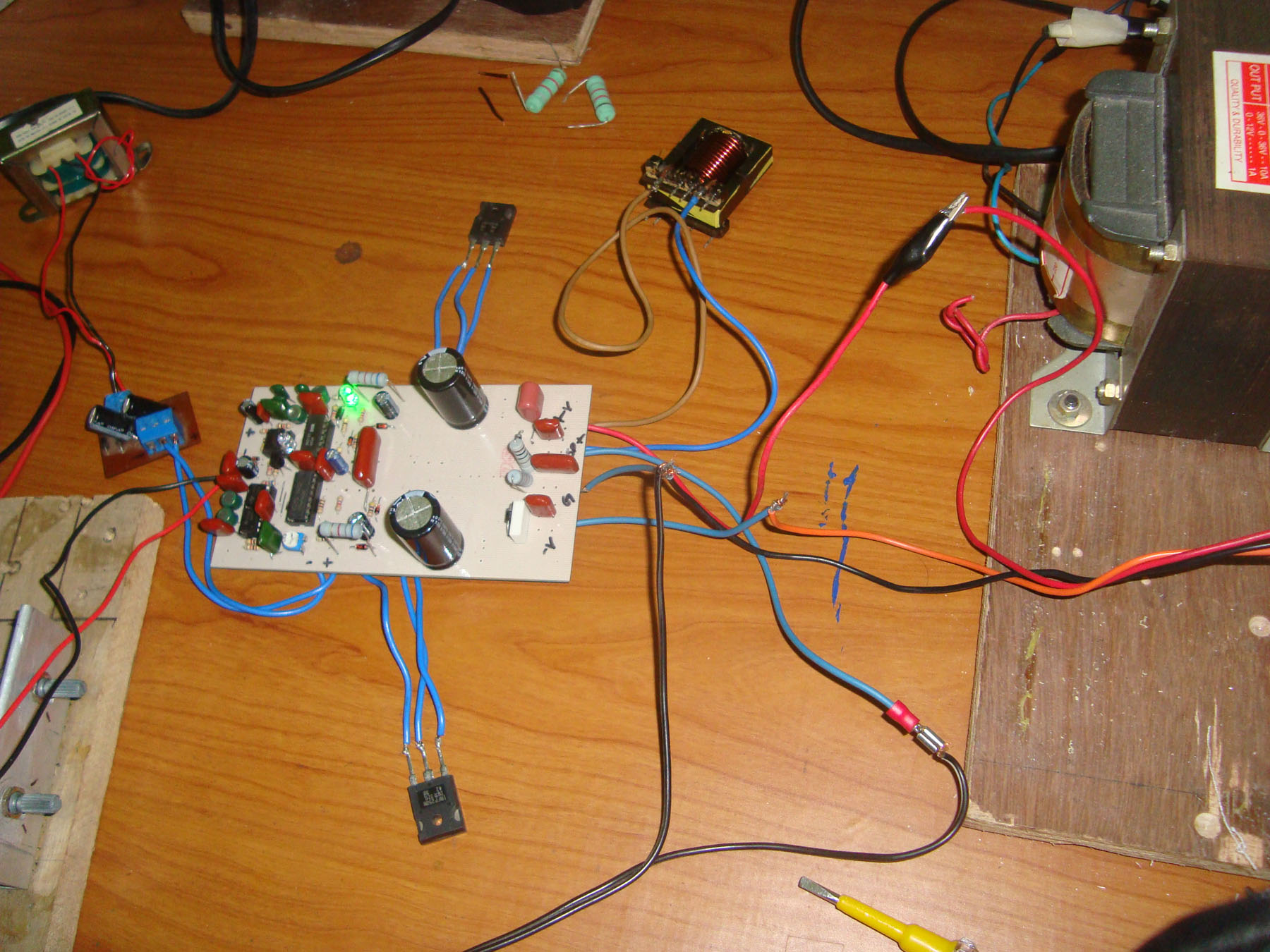

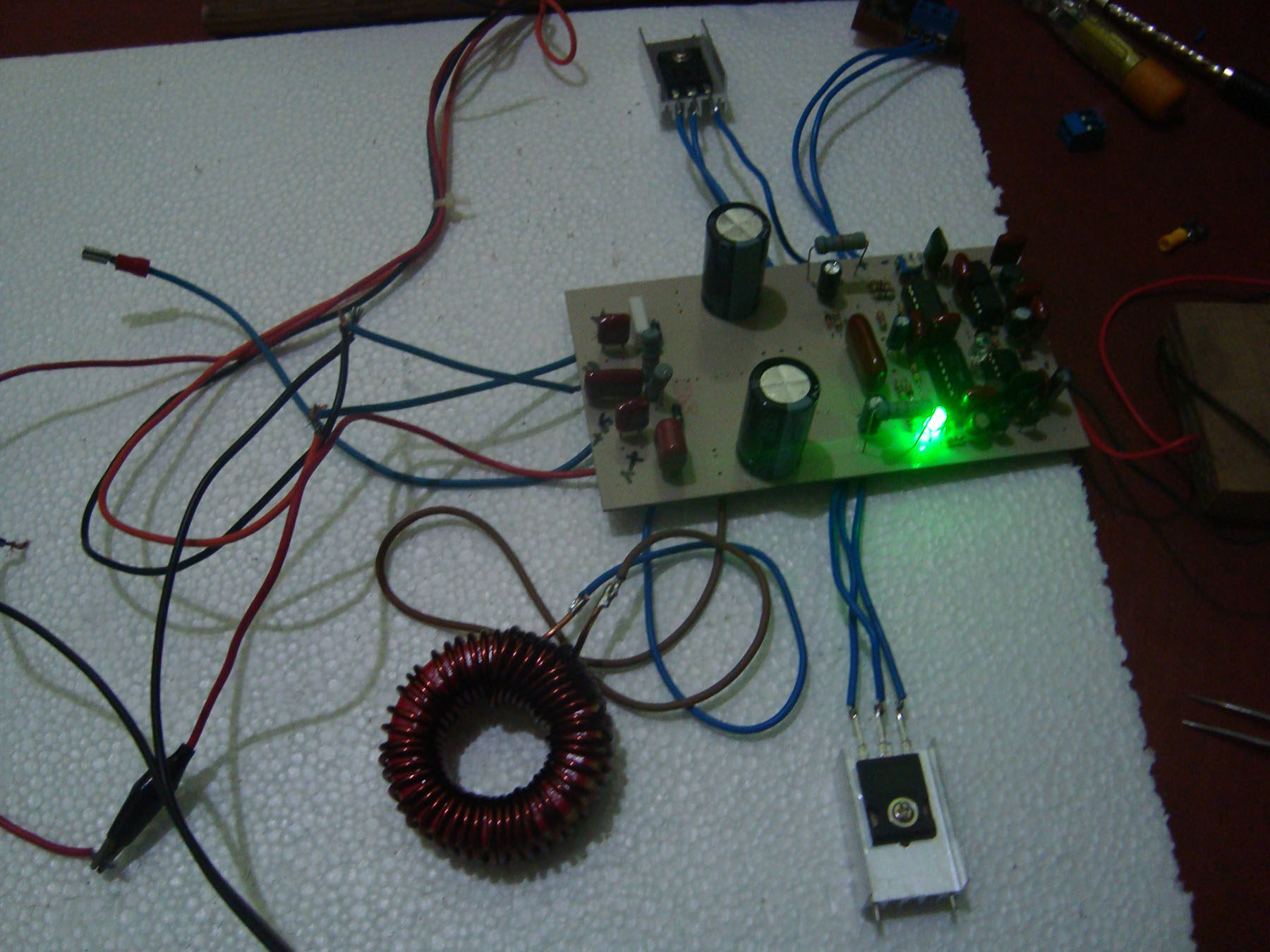

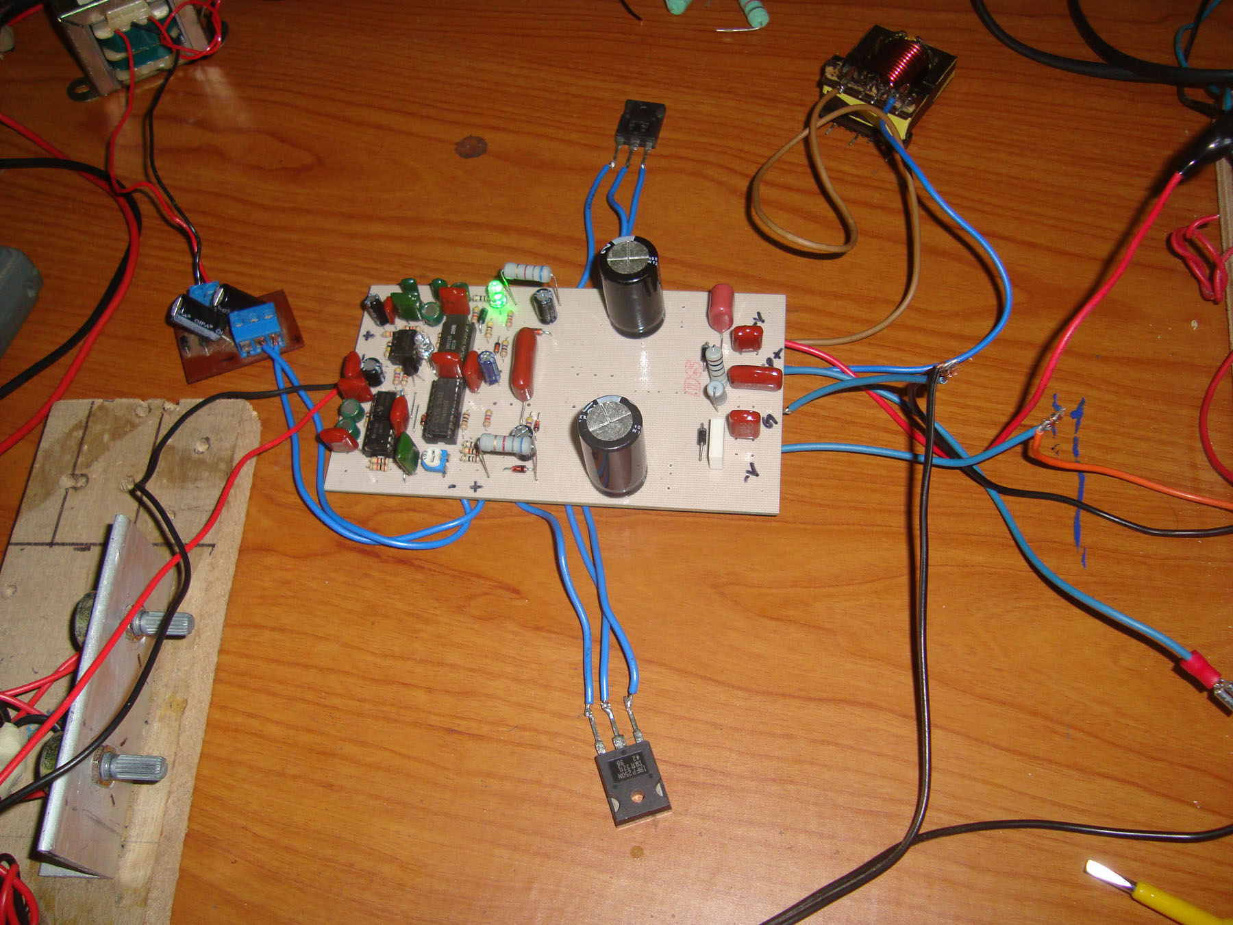

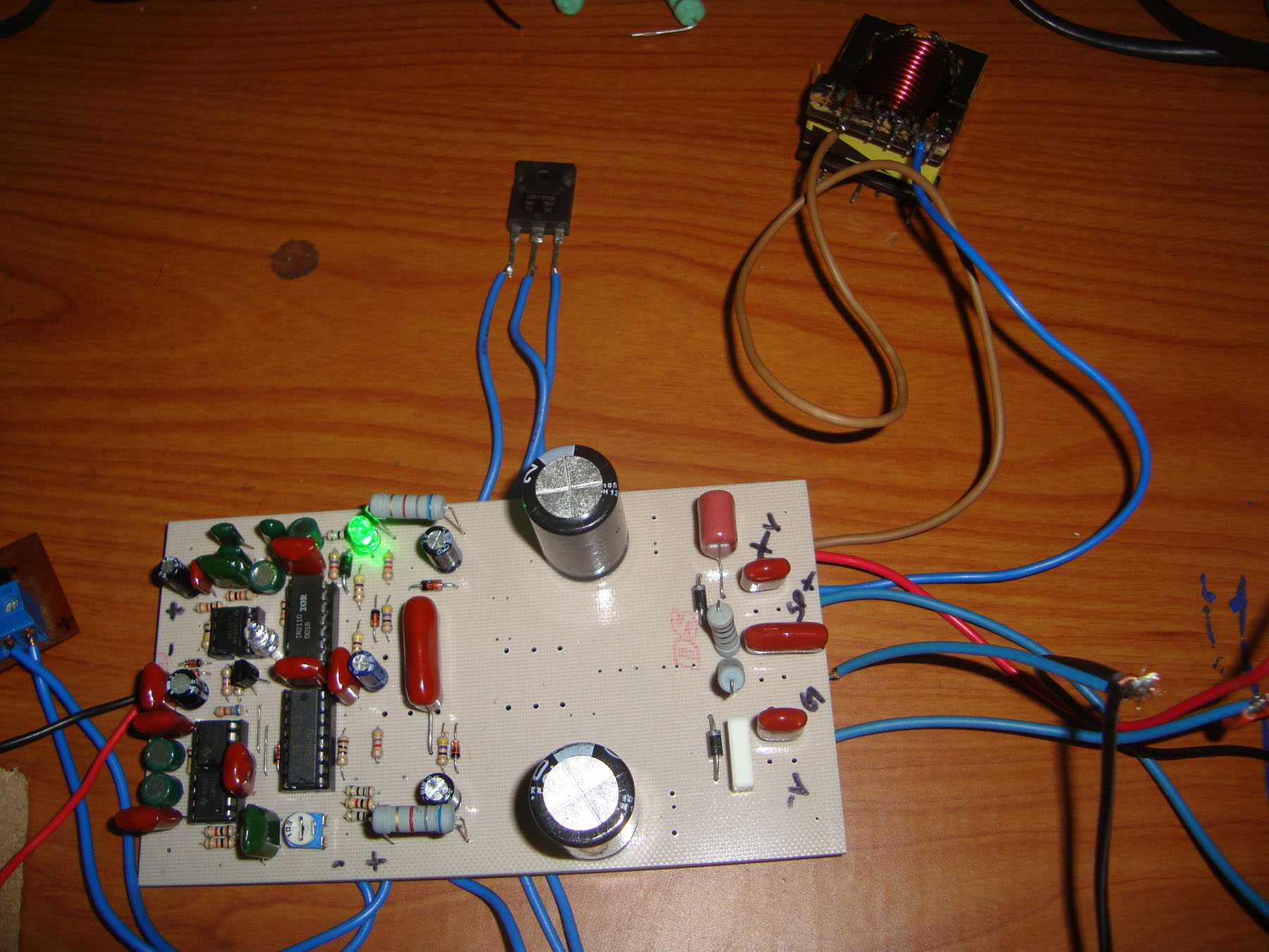

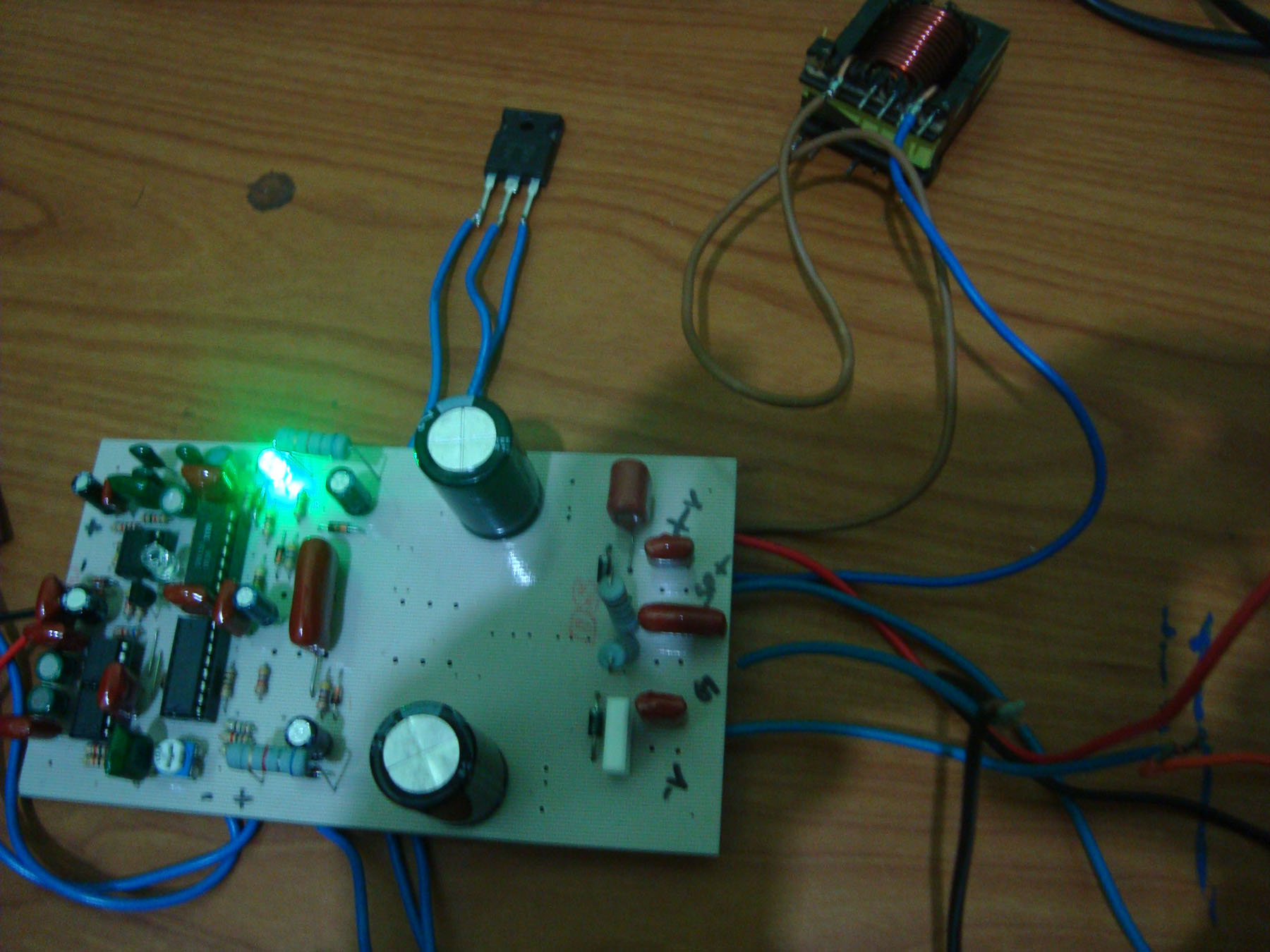

testing irs3000d first try working perfect.
dc supply 55v,
irfp250 fets,
ring not hot,
ic's are not hot,
after signal input the active led is on,
pls some one guide me to adjust the preset 10k,

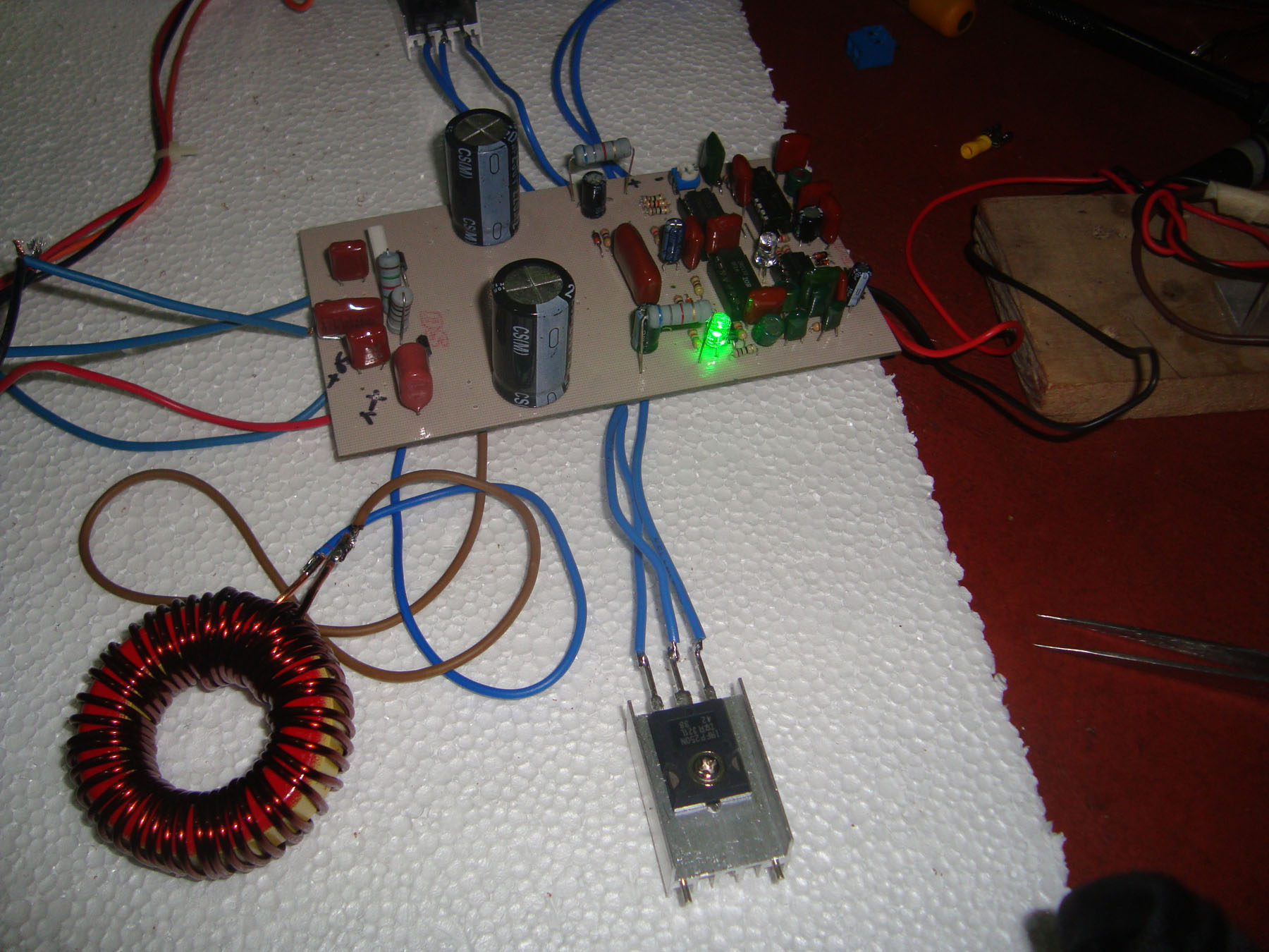

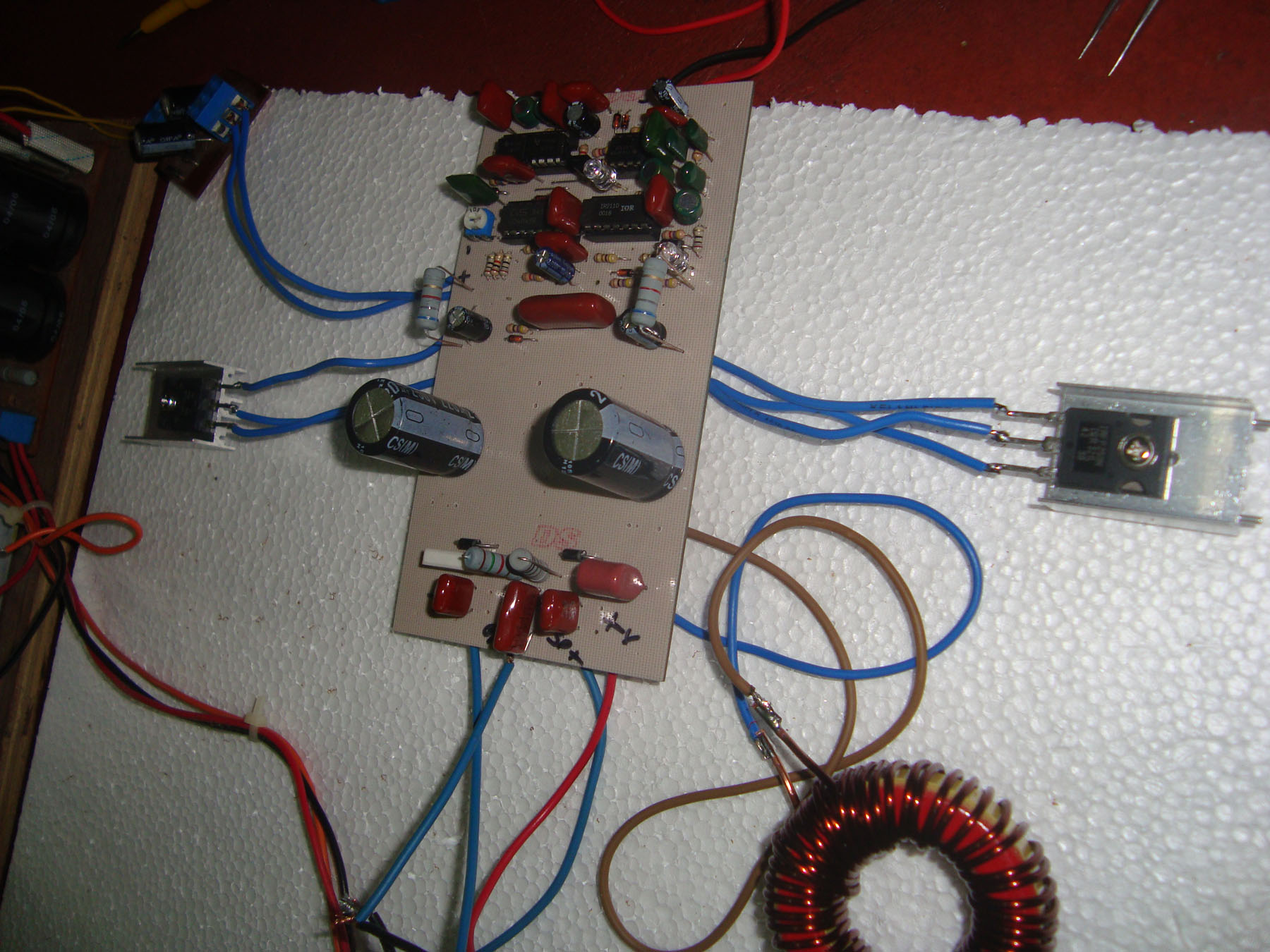

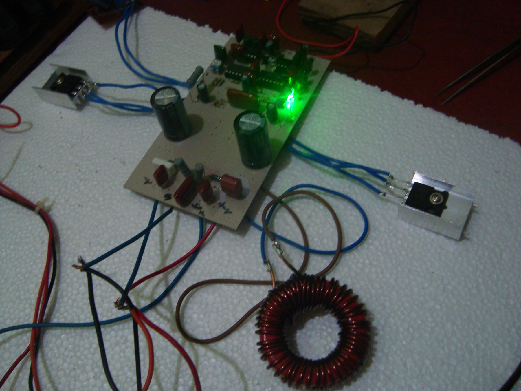

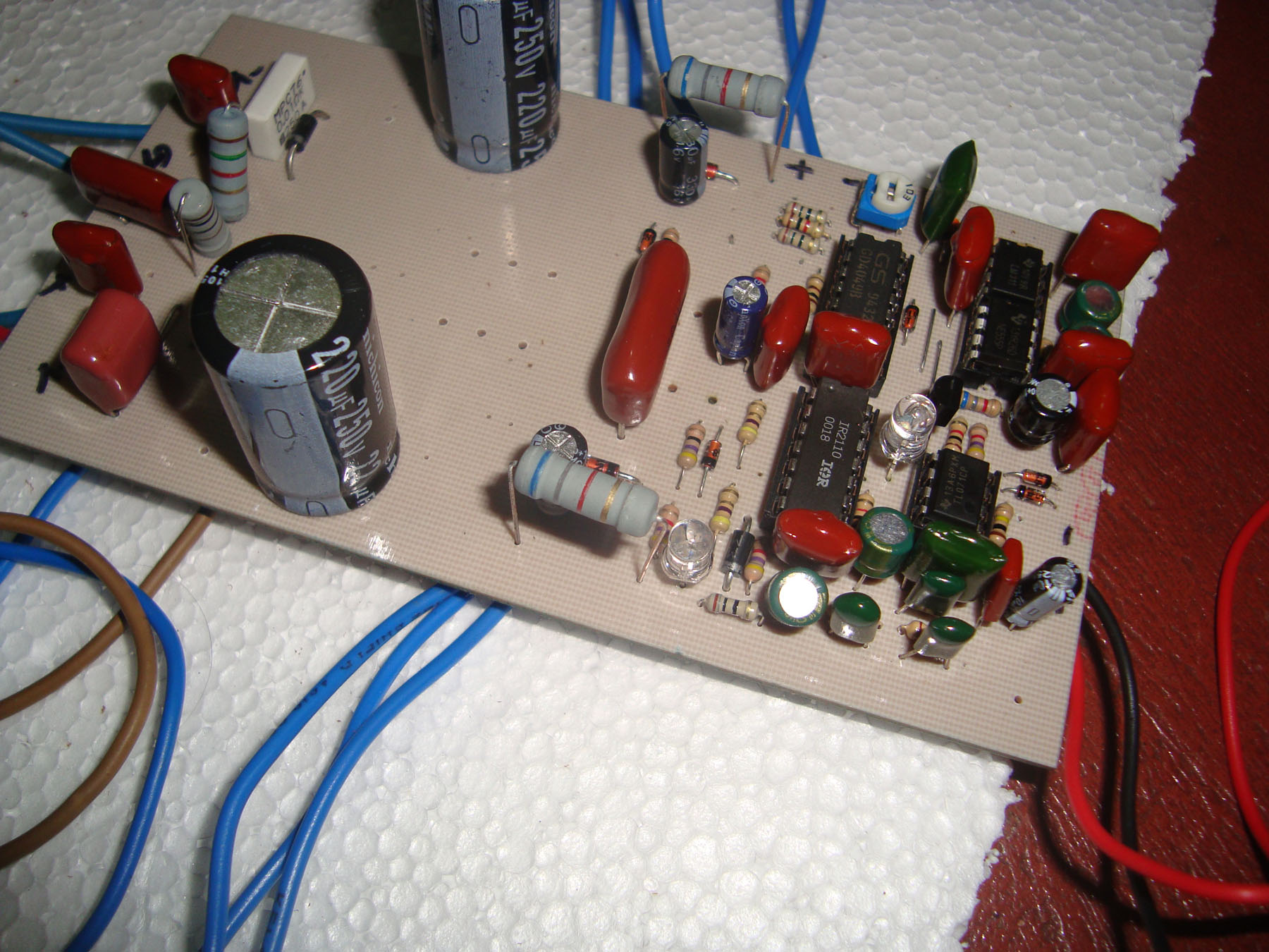

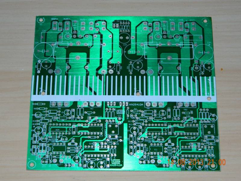

another test irs3000 with atx ee core,
good sound with good weight,(bass)

thanks for the reply . i am facing serious issues with irs900 both thienchay and detex they work for a short time or a few days and fail i have had three different experiences .in all the above the voltage was
>>> +/- 70vlts about 6amps and filtering caps were 6800uf per rail.
>>>the load was 3ohms to 8 ohms
>>>all the output fets were one pair irfp250n
>>>all the inductor i used was etd 33 or ee 33 , 15turns and 1mm gap on both legs using a piece of CD or DVD disc
>>>switching frequency was 250khz normal on the thienchay and detex layout
two projects had two channels one project had four channels.
i am thinking maybe busspumping, slow fets ("but dismissing it because big proffesional companies powersoft use irfp250n") , non ucd topology or core saturation . please help i am really confused .
i have another irs900 three channels which has survived for one year plus without any issues except bowing fuse when one output of either channel ,a speaker or load is disconnected when the amp is on. all the specs are like the above except the voltage is +/-39vlts.

Most short comings in layout, gate drive, snubbering and Qrr of the MosFets body diodes translate into pain for the MosFets. Detecting the most dominant short coming(s) is only possible with detailed measurements of the critical load situations using a fast oscilloscope.
Of course without any measurement you can be sure that the MosFet stress grows overproportional with the rail voltage.
So your observation that +/-39V is fine while +/-70V shows issues with reliability is nothing strange.
...sorry that I cannot offer a simple cure.
thanks marcus but . i want to turn to ucd lorylaci schematic to try my luck. also i will use the only available good fet in my area which is the irfb4229 instead of irfp250.
what about output core 1mm gap and 15turns can it cause saturation and ruin the outputs?
With 15 turns on an ETD34 and approx 1.1mm gap (CD) in all legs, I would expect an inductance somewhere in the range 10uH...15uH and saturation somewhere between 30A...45A.
Nothing to worry regarding saturation during realistic operating conditions.
