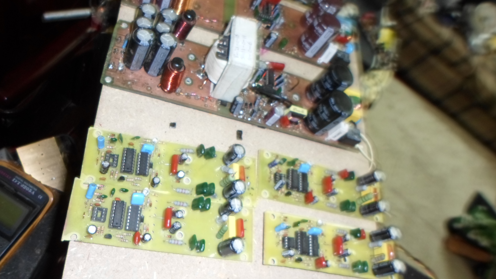

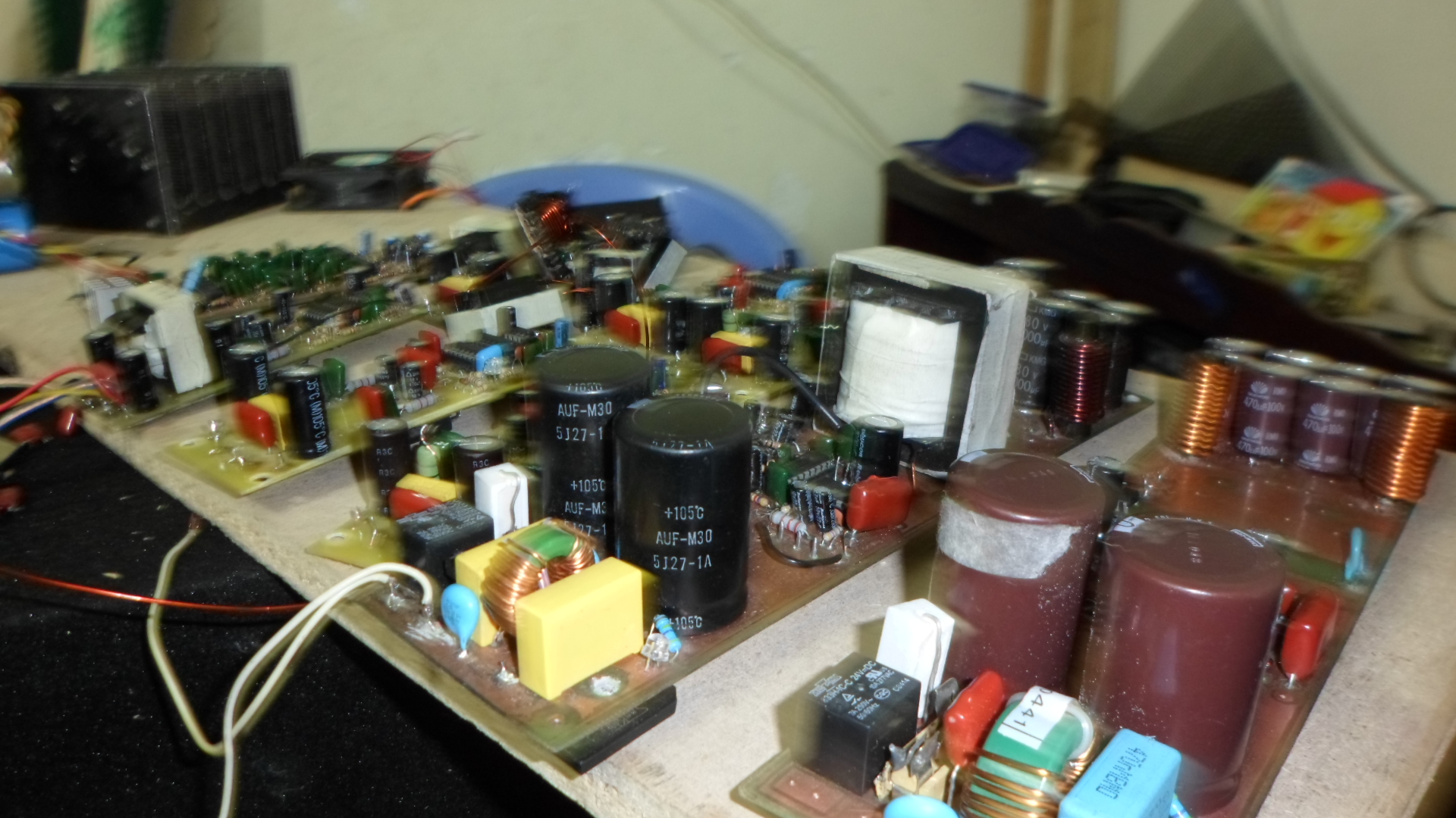

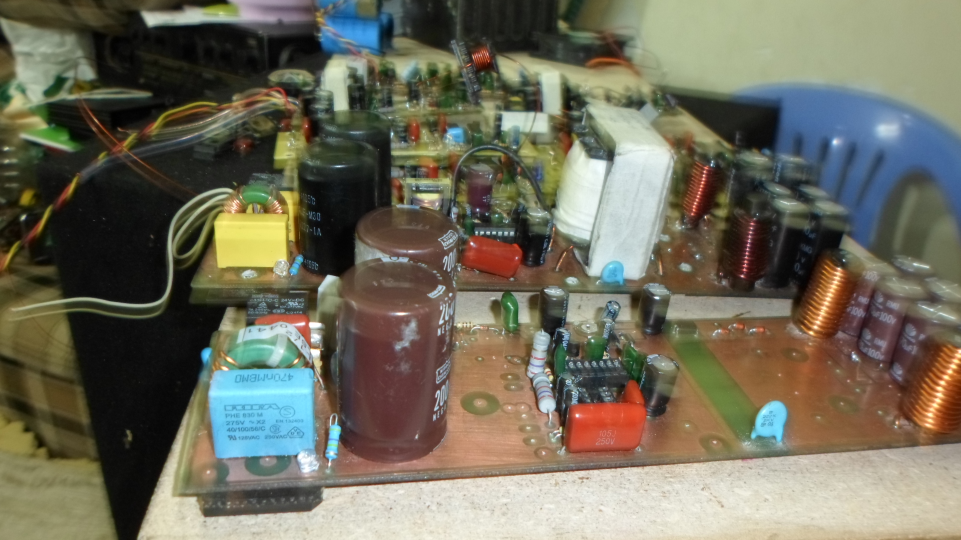

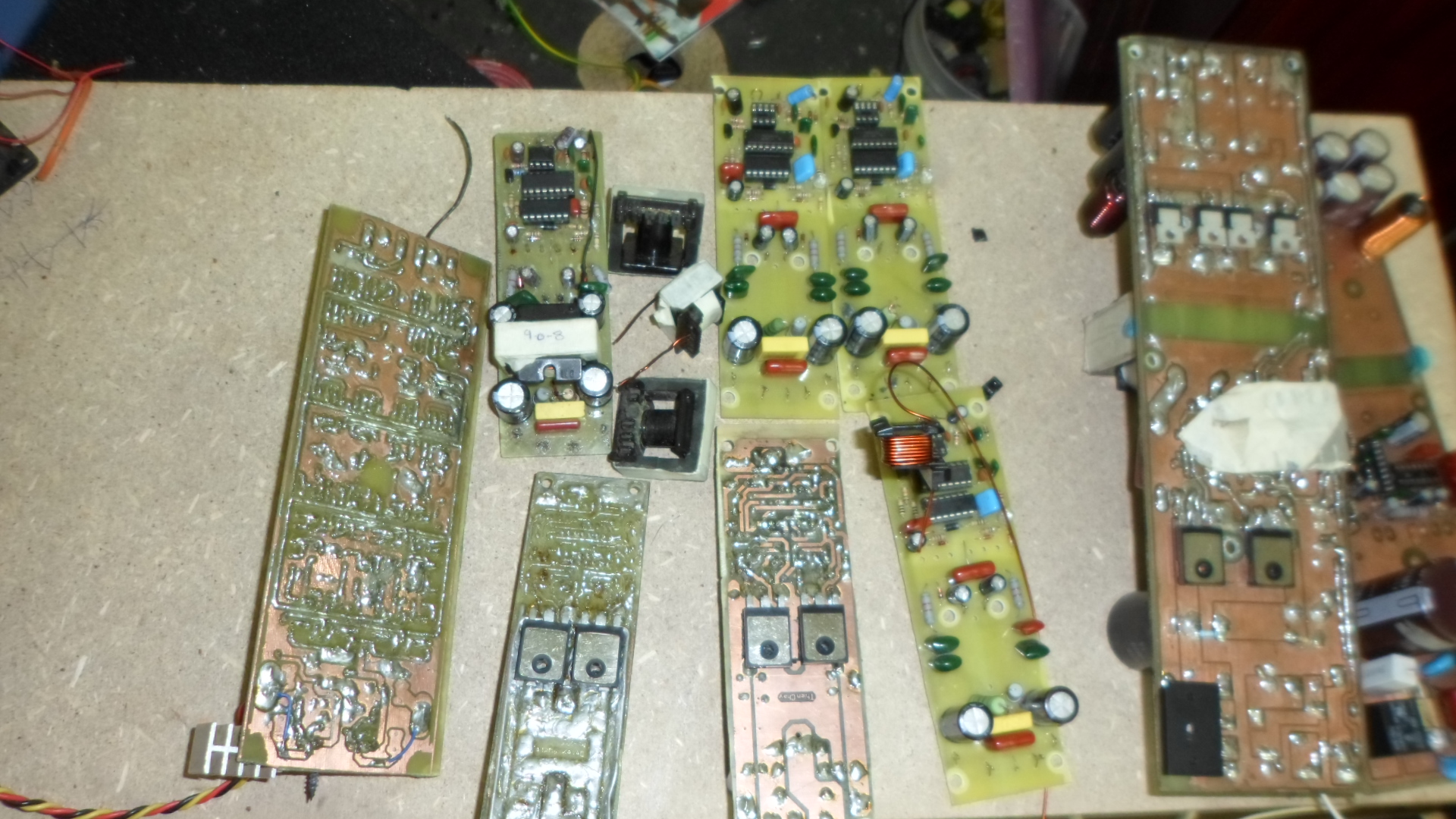

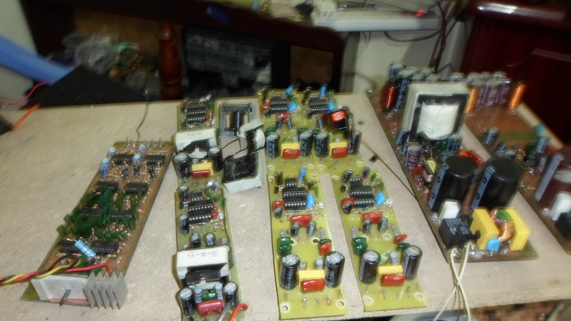

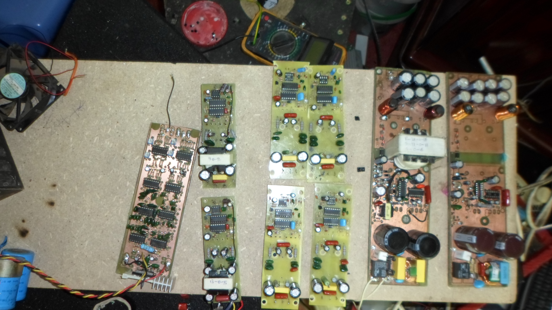

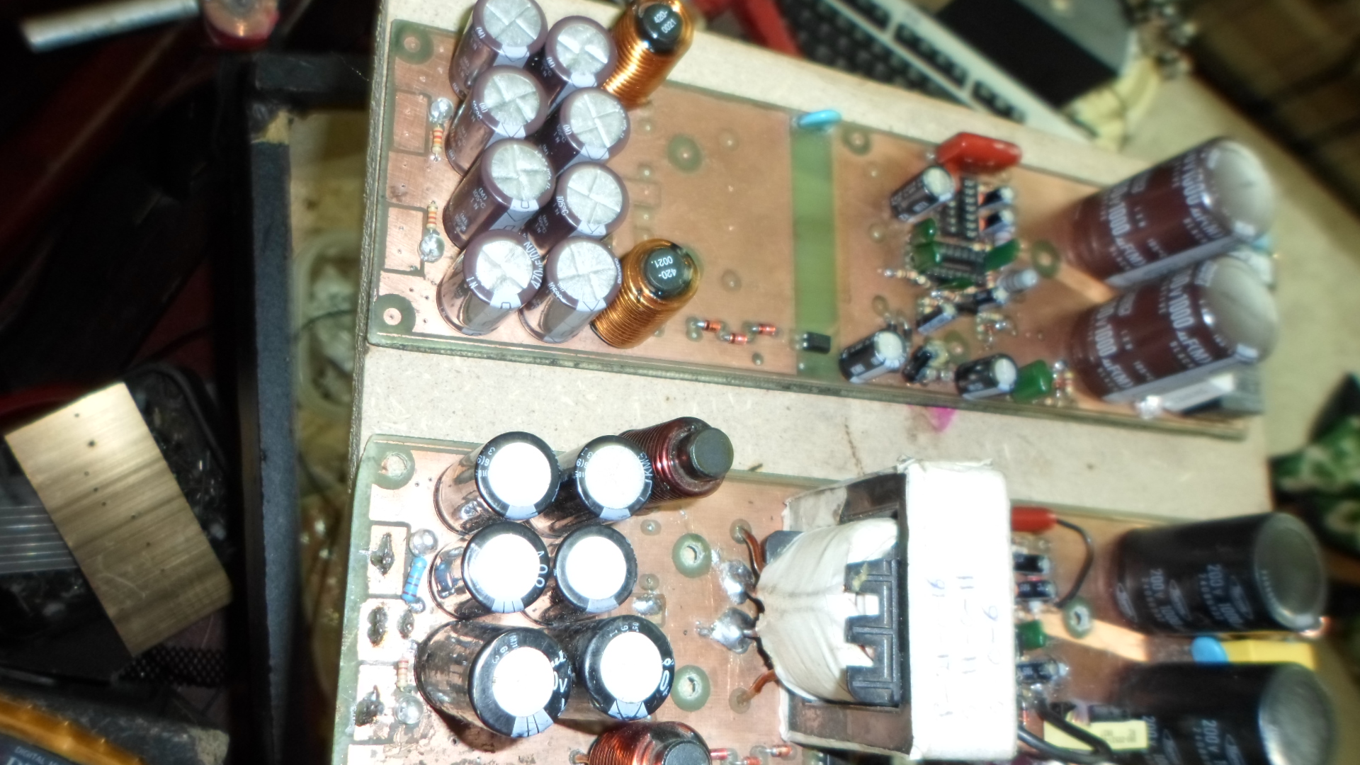

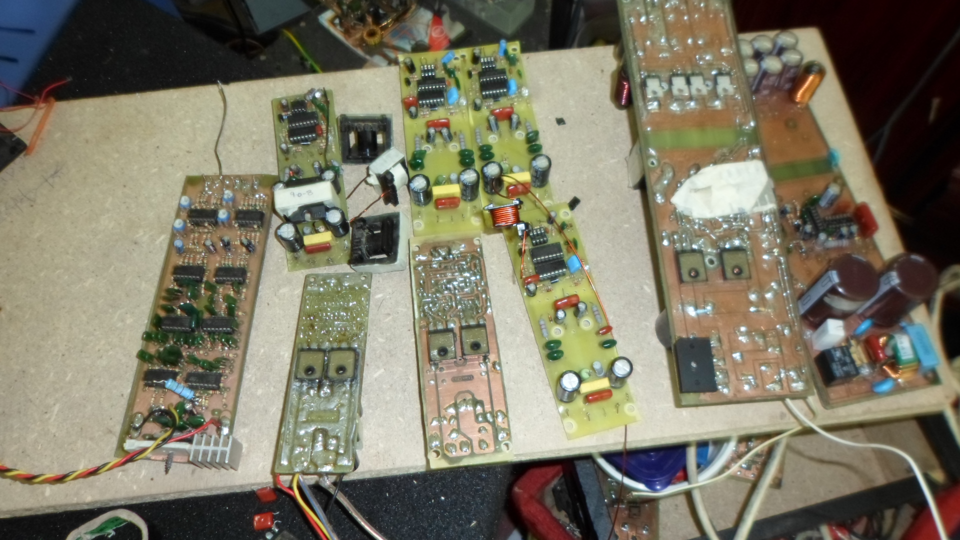

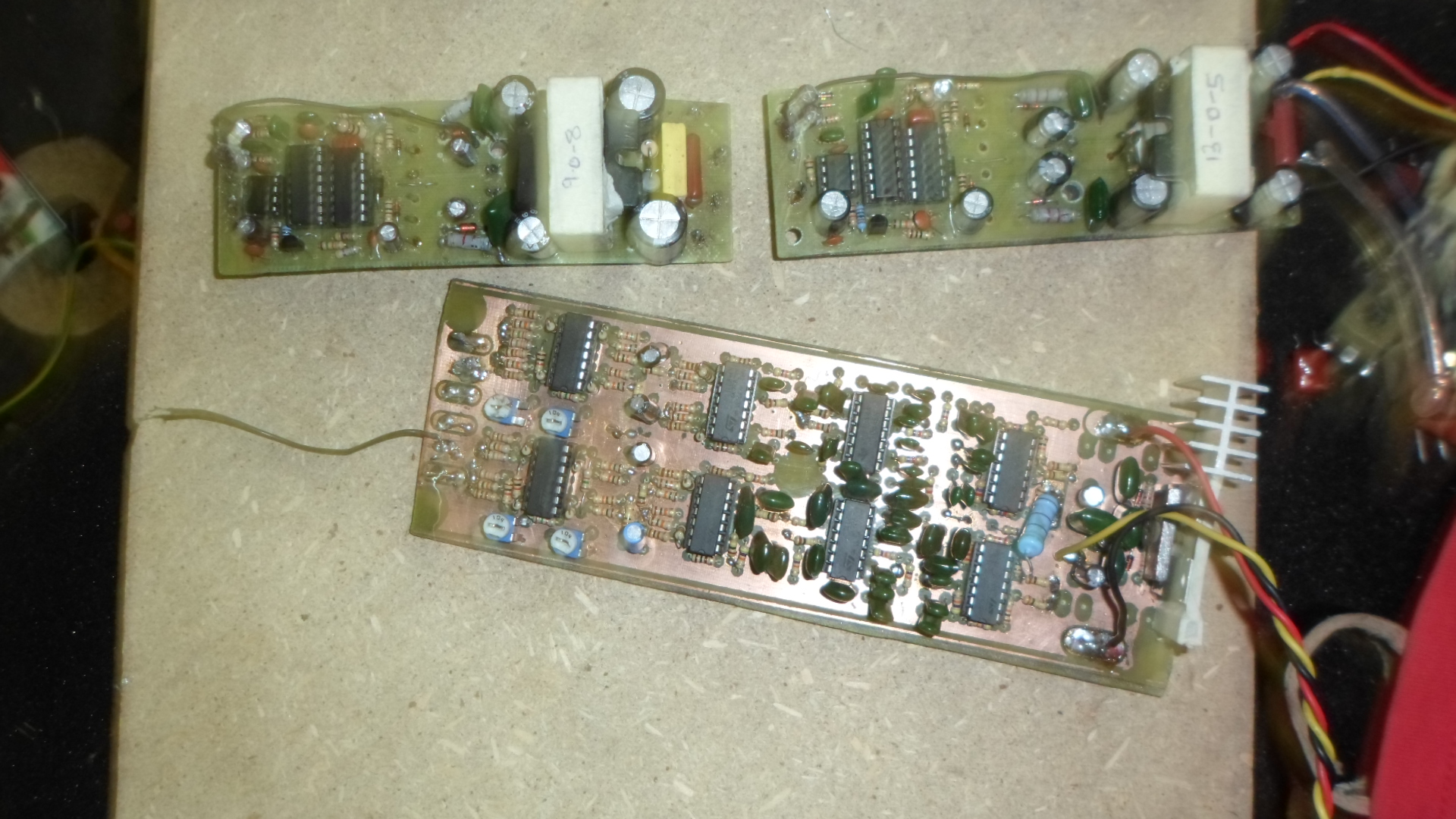

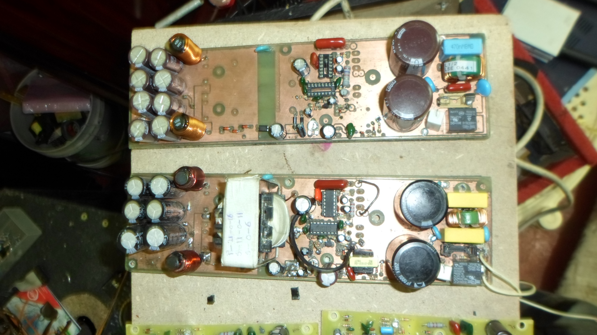

hi all photos of my project. detex irs900 , thienchay irs900, my smps version of lukas design but with ocp protecton , and my 24db 4way crossover with high pass and low pass on all 4 channels 33hz o 22khz😉😉🙂
>>>after mounting the amps and smps i will resume the new simple amp i posted on #3587

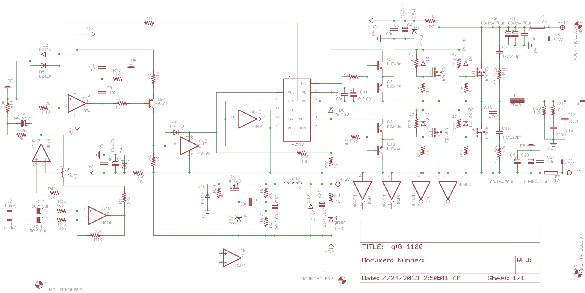

hi all i have a few questions
>>> is it o.k technically to use one aux 12vlts 2 amps to power the ir2110 and cd4049 for four channels of irs900 or irs4k5. or does it need a 12vlts aux power supply for each channel.?
>>> has anyone else experienced this challenge , when you have irs900 4 channels and same power supply in my case "
(+\-40vts, outputs irfp250n,gate resistor 100ohms, output inductor 22turns eei 35, aux 12voltage each channel with its own 12vlts dropping the voltage from 0-40vlts by a small fet irf640 ) "
if i do not connect a speaker to any channel . it drains a lot of current and cuts the fuse . but if all channels have a load i.e speaker connected everything is o.k and works perfectly provided i do not disconnect a speaker from any of the 4 channels. what is the solution?

Hi stewin,
Without load(speaker) amp will not oscillate.Provide a dummy load use 1K5/2W or 2K2/2W resistor.
Regards
MANOJ
Hi Steve,
your schematic does not show any start up path for the upper gate drive supply.
==> A self oscillating amp without such start up path is likely to lock up, especially during turning on.
You can try a 33k (at least 0.5W) resistor from positive power rail to the VB pin of the IR chip.
Your obseravtion of high current draw and blowing fuse is a little bit making me afraid, that you are also struggling with some parasitic effects which provide some uncontrolled gate drive to the upper MosFets even without driver supply.
This is adding the unpleasant risk of a heavy defect when experimenting with the additional resistor. To reduce this risk, you should put serial light bulbs (i.e 230V/100W) in the pos and neg supply wires before experimenting.
Good luck
Markus

Just adding my safety hint from the other thread, because I see the same pictures here.
1. My honest congrats.
2. In the region of the wide isolation barrier, please scratch away the thin copper lines at the sides of the PCB. In the moment this copper line effectively jumpers most of the creepage distance, because it is a conductor which is very close to the primary and also very close to the secondary.
3. Take care with the creepages also in the transformer.
4. Check if the blue cap across the barrier has Y1 rating.
5. Enjoy your build! Great to see your walk of success.
...ohps just seeing now, the tape around the ferrite core should be wider.
Again the same topic - the ferrite comes close the primary and the secondary PCB.
My proposal: Make the tape much wider than the transformer (i.e. 6mm on each side) and have it 3 layers at least. I know that's looking ugly.
Keeping fingers crossed that the inside transformer construction provides sufficient isolation, cannot judge this from the distance.
Fundamental rule for you to check:
Imagine the currents wants to creep from primary to secondary along any surface.
Also indirect path which incorporate conductive parts like unconnected copper or ferrite are critical. I.e. Primary ==> core ==> secondary.
Distances along the surface of conductive material are no creepage, because the conductive material jumpers this distance.
Whereever you find a path which has less than 5-8mm creepage over isolating material, you should think how to enlarge.
