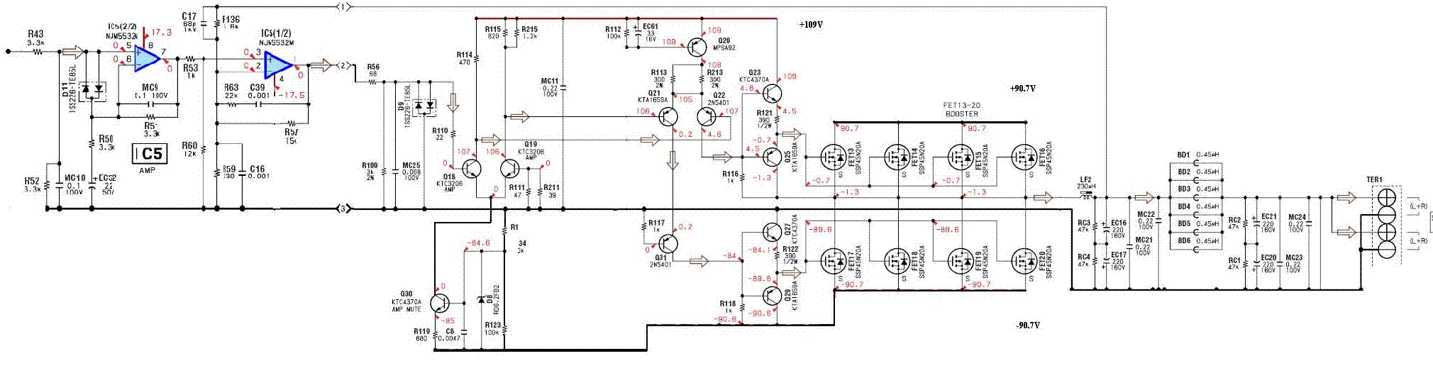

Hello
greetings anyone tried this schematic

hi I'm no longer with the original project ucd tacatomon this amplier mentioned is very unstable and much emi also has lots of background noise. 🙁
