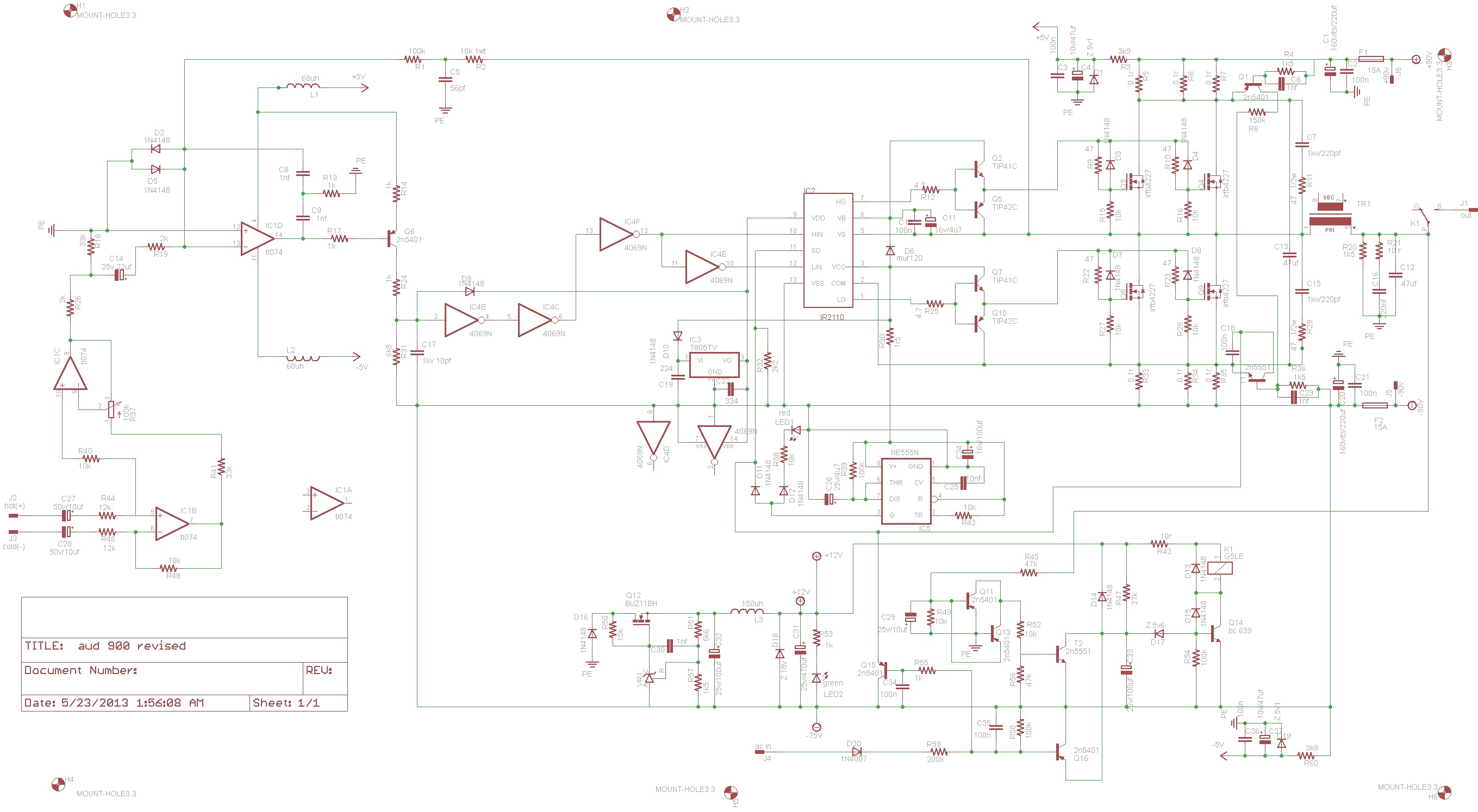

it is a good amp design but it is tricky to drive it with high voltage such as +/-70 to +/-95vlts
aud 900 with protect in one board on the way
Hi stewin,
found mistake in your schematic
Regards
MANOJ
Hi stewin,
Regards
MANOJ
hi sir manoj please do tell me so i can rectify 🙁🙁
D
Deleted member 148505
You can increase the size of your C11 to 100uf since you didn't provide a bootstrap resistor in the schematic.

thanks jlester . it is said in the forums the more voltage you use, the value of c11 has to be decreased for example irs4k5 . but i am very open to change the value if it is suppose to be changed.
thank you all i will post correction later in the day.

No, the value of the bootstrap capacitor is computed by the RC time constant formed with the bootstrap resistor.
Since you don't have the bootstrap resistor in the schematic. The charging of the bootstrap cap will not be delayed. So you can use a higher value for that.
The amplifier's oscillation will not start if the RC time constant is too high. Around 55us is good.
For more info read DT99-7 🙂

Hi Stewin,
sorry for mistake
I marked one red colour link near 555 pin-2 after 10K (connected to +12v bias line) it is wrong and it should be before 10K resistor(conect to PIN-2 ne 555 IC).
Regards
MANOJ
