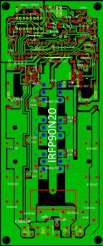

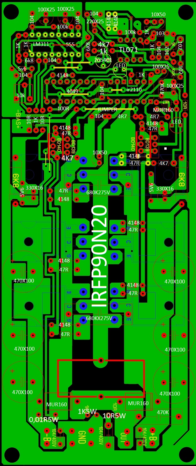

How do you find my design? Any change needed?
hi akraj your design looks fine . but since i have found the schematic i will redraw and build one based on double sided . according to the forum i have learnt that class d performs best when using double sided boards that is when screened .

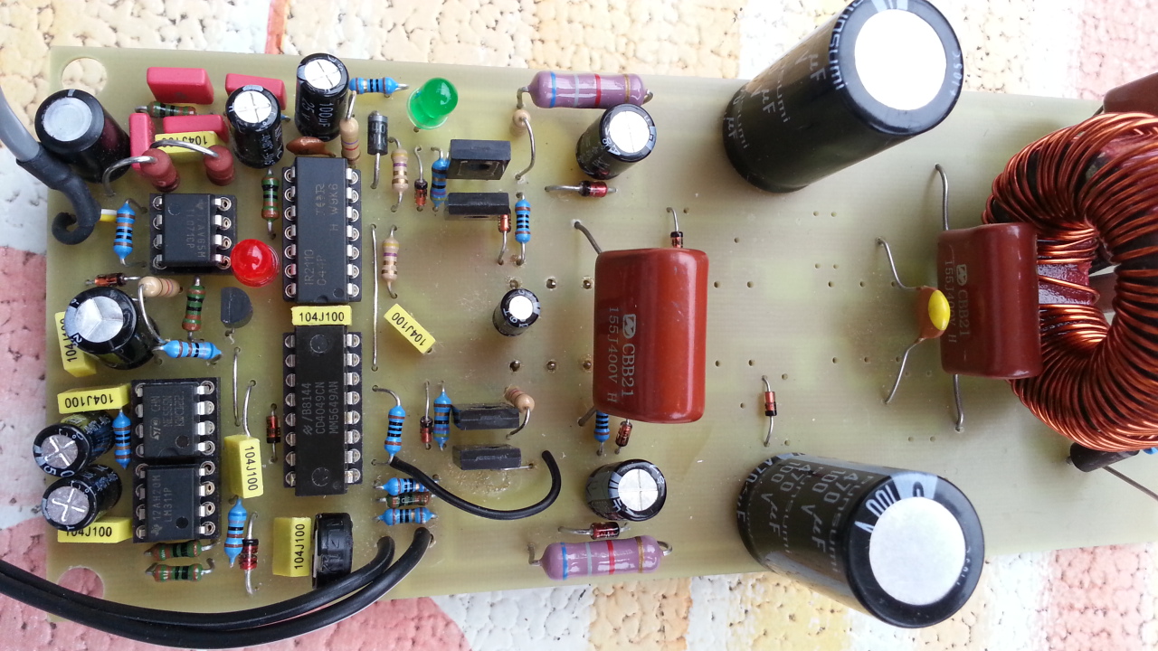

Have make IRS4K5 but big Problem, not working !
NE555 and LM311 very hot after 1 minte
IR2110 - NXP HEF4049 or Texas Instruments CD4049 - TL 071 cold and have 12V bzw. 5V rail
Red Protect LED is on and IRS4K5 not work
does this PCB working or is it fake ?
I have replace all, ICs, Mosfets everytime same fault
Does somebody have solution ?

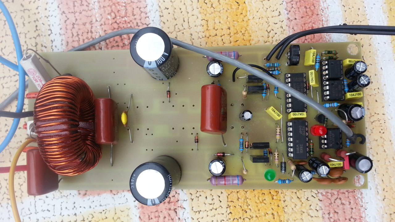

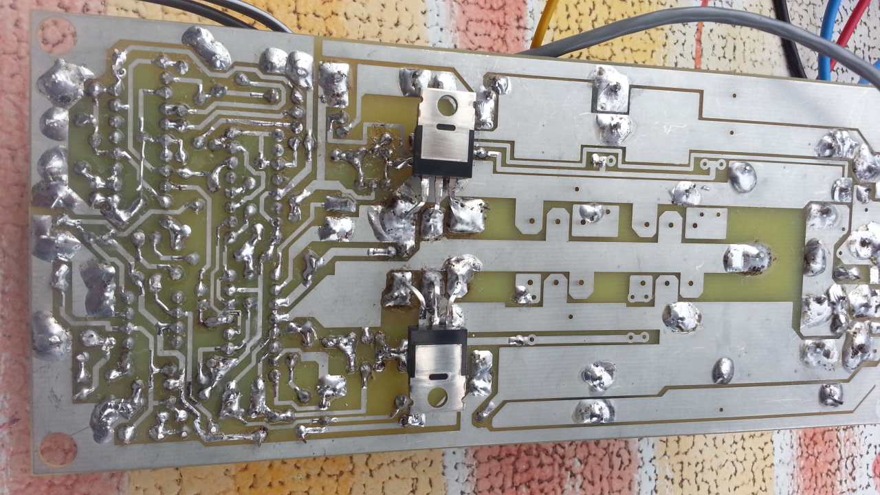

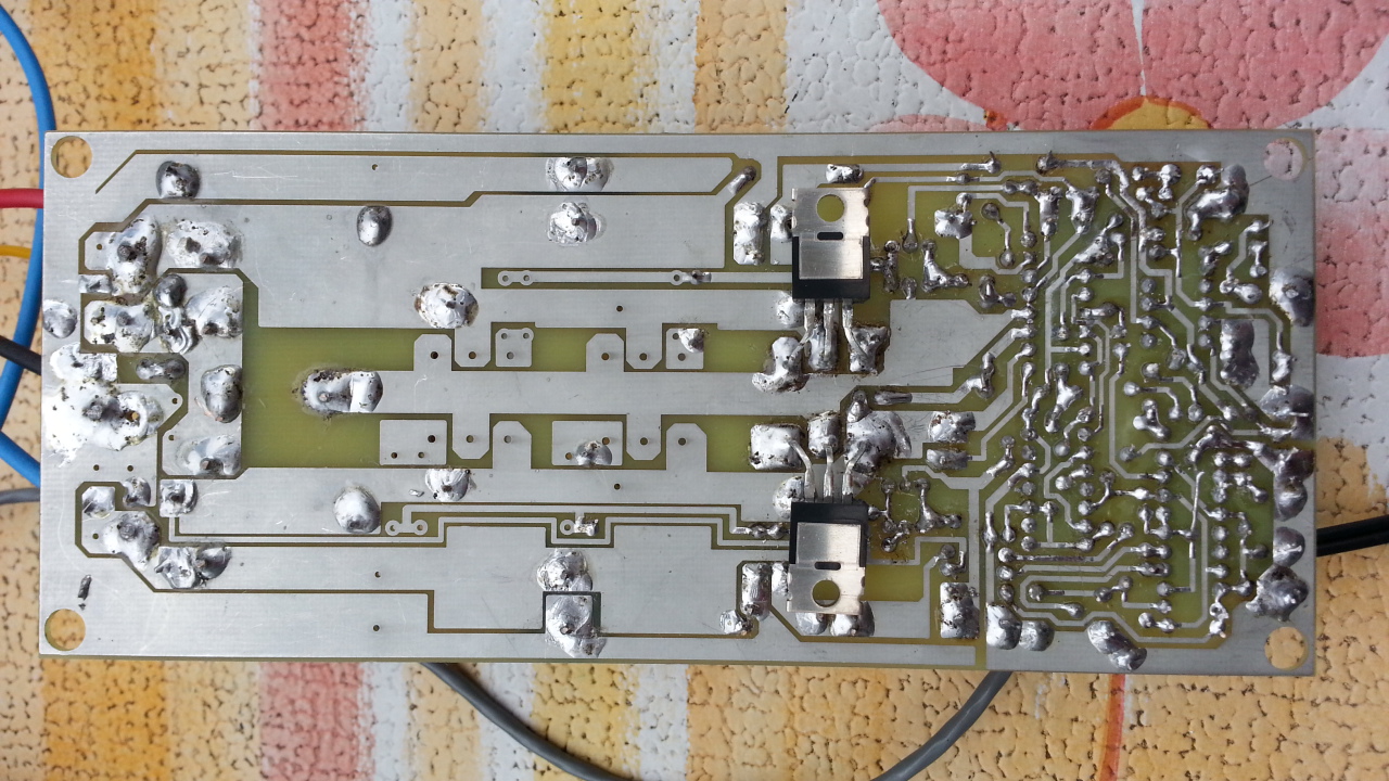

Ok thanks have change diode 1N4148 look pics
then have check my board all look ok
Then After connect with Rail Ics and Mosfets are cold
Green Led flash short time and speaker make plopp after connect with rail.
Amplifier have no DC at outpurt all looks ok,
After disconnect Rail green Led flashs about 3 seconds and speaker make plopp plopp plopp plopp
But Im worry now,... no music comes out.
have replace all ICs but same like before, no music comes out
Then have amp connect with PC Soundcard, with maximum Volume output from Soundcard I get distortion noise
I dont know what can I do to get music?
I cant see fault in Board, any idea to solve problem, have upload pics from Board

hi nmos i still insist you go through all the pcb traces again . i faced the same issues because pcb traces are so close together. i had to recheck many times but the pcbs i made all worked after many rechecking and clearing the tracks.
