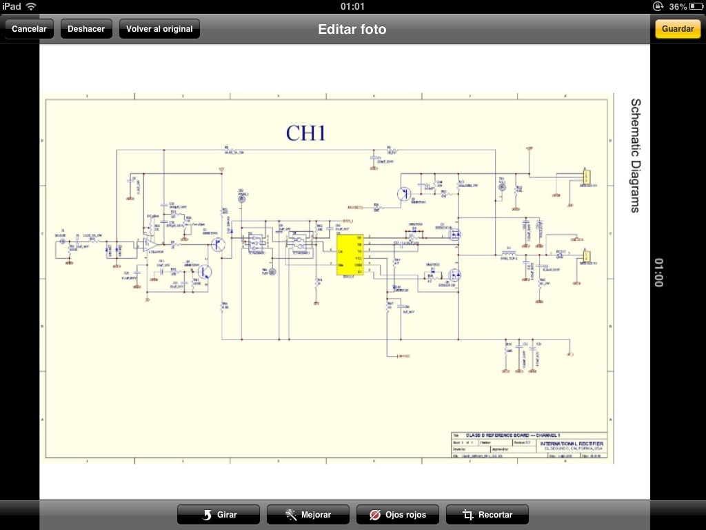

hi all I have doubts why diagrams removed
if all this, now this amplifier with sigma delta modulator is basically the work of international rectifier IRAUD1 and pag.IRF is available in this forum is to discuss and learn and then teach because it removed the schematics and PCB artwork? ?
greetings to all ...if the moderator permits desire iraud1 put the diagram and leave here as a reference in fact heard super good

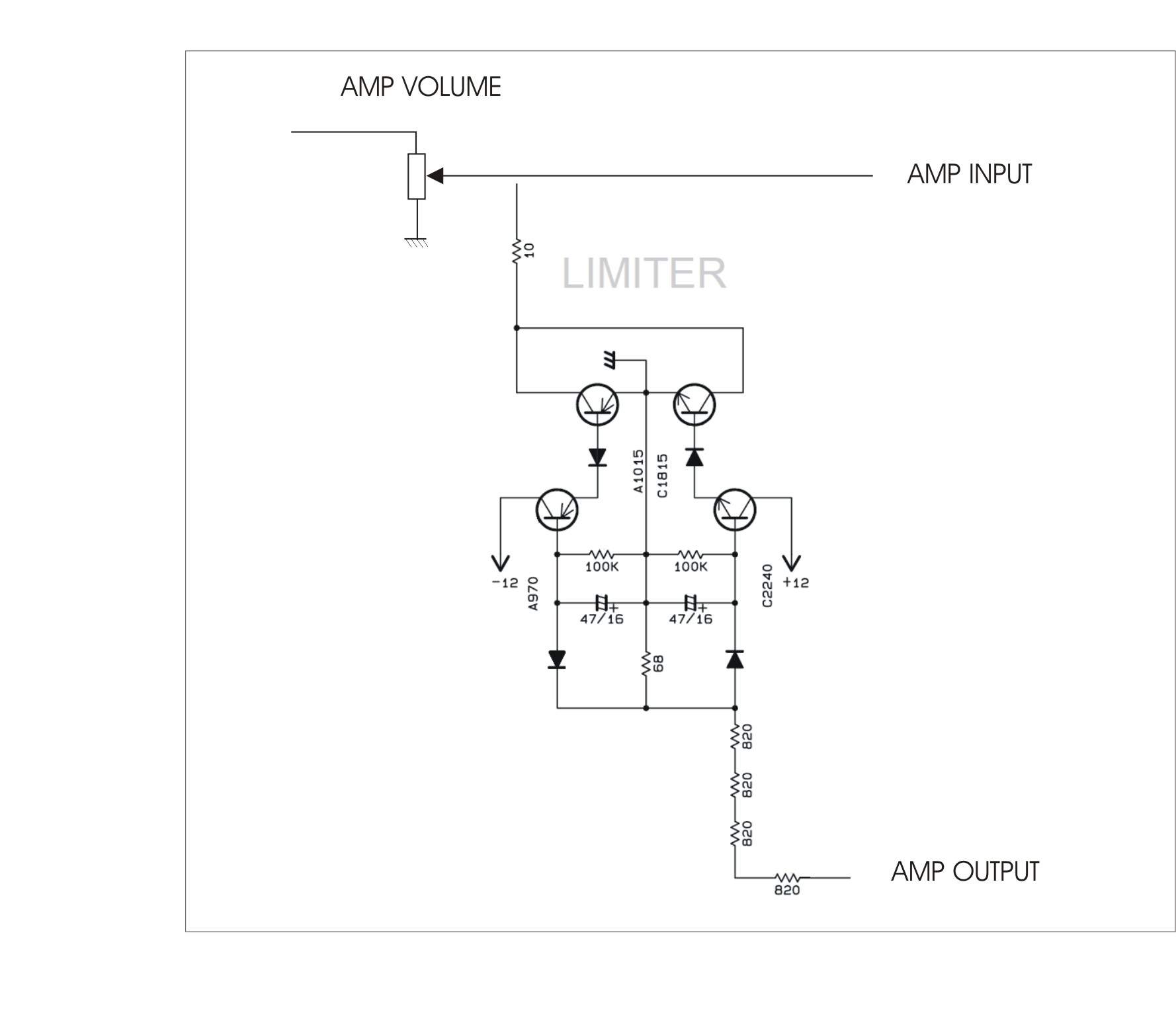

Was ist ein OTA? (Dynamiklimiter mit OTA LM13700, LM13600, CA3080, transconductance-amplifier, agc-amplifier)
link to EXFLACO schematic Triell limiter

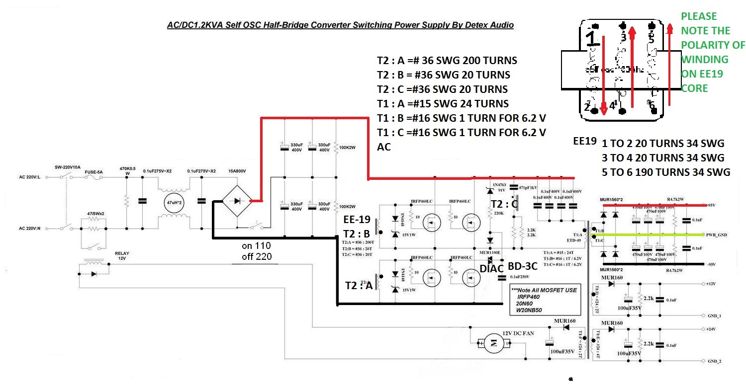

one more smps completed
warm regards
andrew lebon
hi andrew
do ee16 or 19 have gap in the middle legs.pc cores have gap in midde legs i got cores without gap too.
did you use 15swg single solid wire or srands.
i have 23 swg wire thinking of paralling 5 in primary is it ok.
regards
thanks
Hi Ravs
greetings EE19 core use one with gap and use 5 parallel strands 23 swg
warm regards
andrew lebon
warm regards
andrew lebon

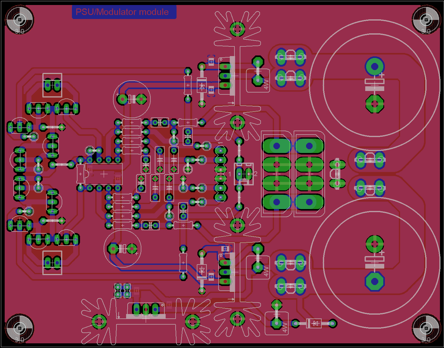

I've cobbled together a PSU/modulator board to go along with the power module boards.
It may not look too impressive but the seemingly long traces only handle TTL DC signals (enable/mute) so it shouldent be an issue.
This module uses a LM393 and is thus designed to be used with two power modules to form a full stereo amplifier, however i am not sure this will work as the two halves of the LM393 may interfer with each other, causing problems such as noise.
