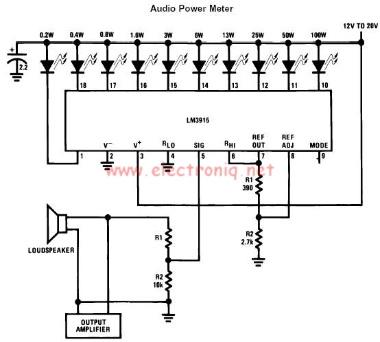

Hi Sameer,
use LM3915 for LED Bargraph Display. it is very simple
Regards
MANOJ

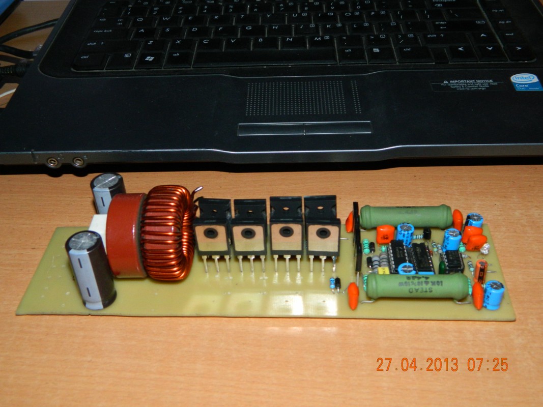

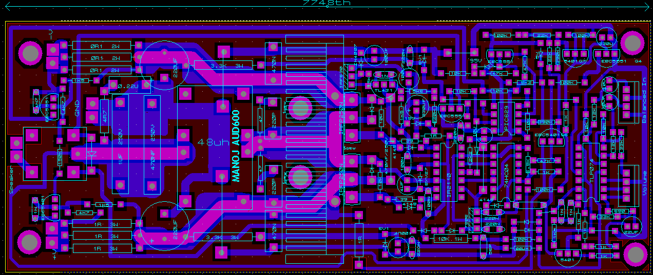

Hi Manoj:
Here is the final artwotk of AUD600 ver3.0; will use double sided if EMI makes problem. any suggestion?
It will have OCP, OVP, TP, DC etc controlled by uC.
Raj

Hi Manojtm
Im little confused with Bias AUD 600 Rev 3.0 configuration
my PSU have +/- 80V DC
and +/-12 V DC
want ask.... - Bias connect with - supply rail - 80V DC
+ Bias with +12V DC is this correct ? dont like AUD600 fire with first test
best regards

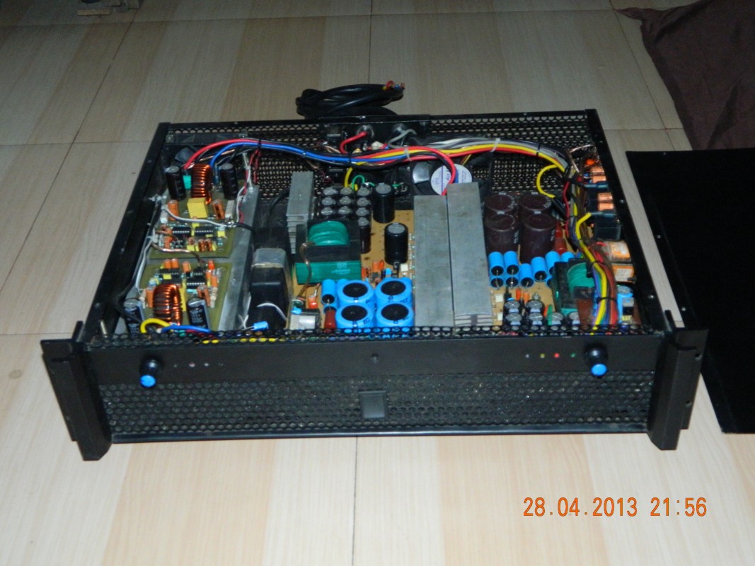

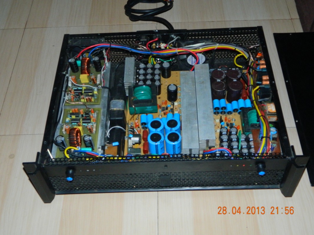

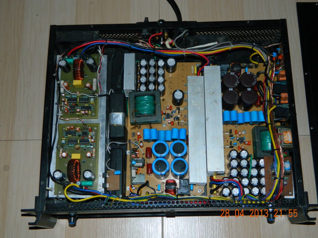

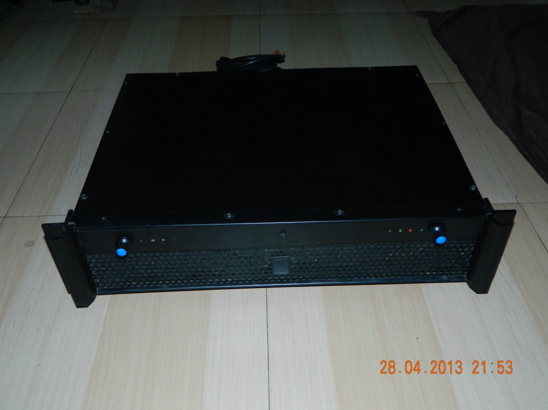

class d 6000w
My class D stereo amplifier 6000 W rms 2 ohm with smps supply
Do you sale those amps?
how about protections DC OVP HOPS
DC crowbar
Then Balanced Input? limter
