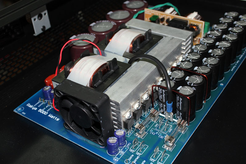

UCD 25 watts to 1200 watts using 2 mosfets

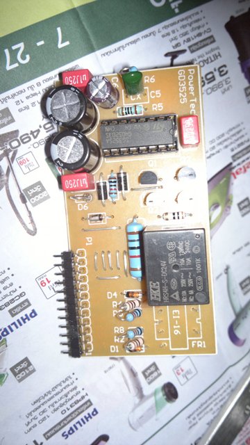

smps ossc card
Hi Exflaco
greetings this is pic of card please can you post crown lt schematic of lt amp for reference
warm regards
andrew😎
