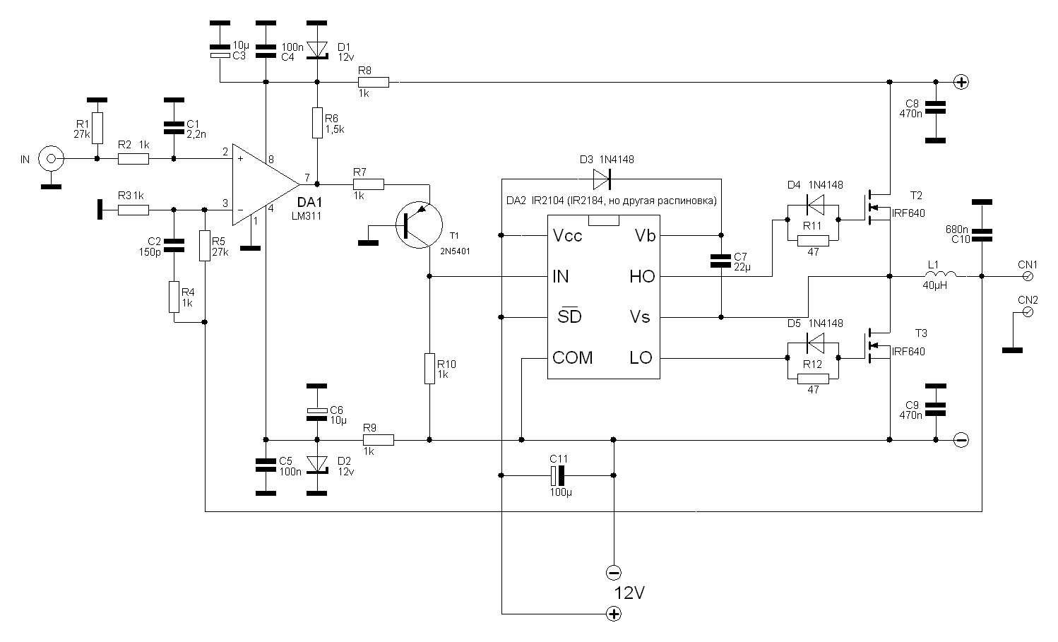

UCD 25 watts to 1200 watts using 2 mosfets

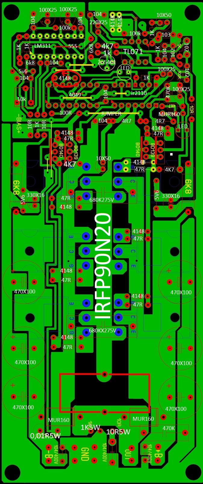

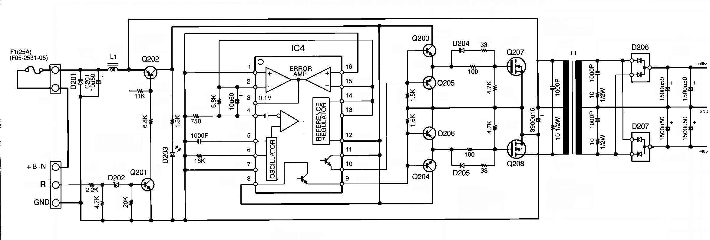

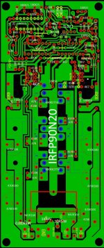

Hi Hadi,
You can use this. this is not my circuit
Regards
MANOJ
  • DC-DC smps-pcb.pdf
    DC-DC smps-pcb.pdf

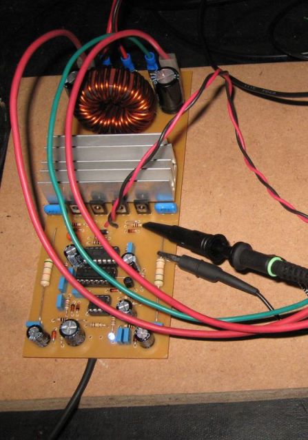

hi fra, what type of toroidal core can i used on this design? it may handle a large amount of current is it a low or high permeability type?any idea and how about the outside & internal diameter, thickness of this core that your going to used?is it available in the market?thank's
I use a t106-2 core.
You might need a slightly bigger core for your current needs.
the t106 is 1.06 inches diameter and the -2 is the core type.
