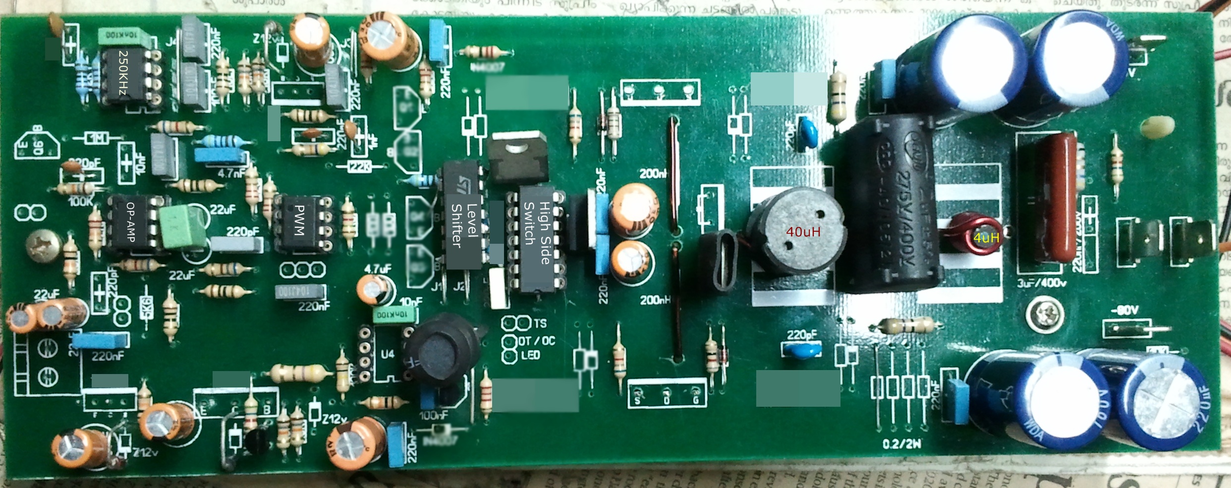

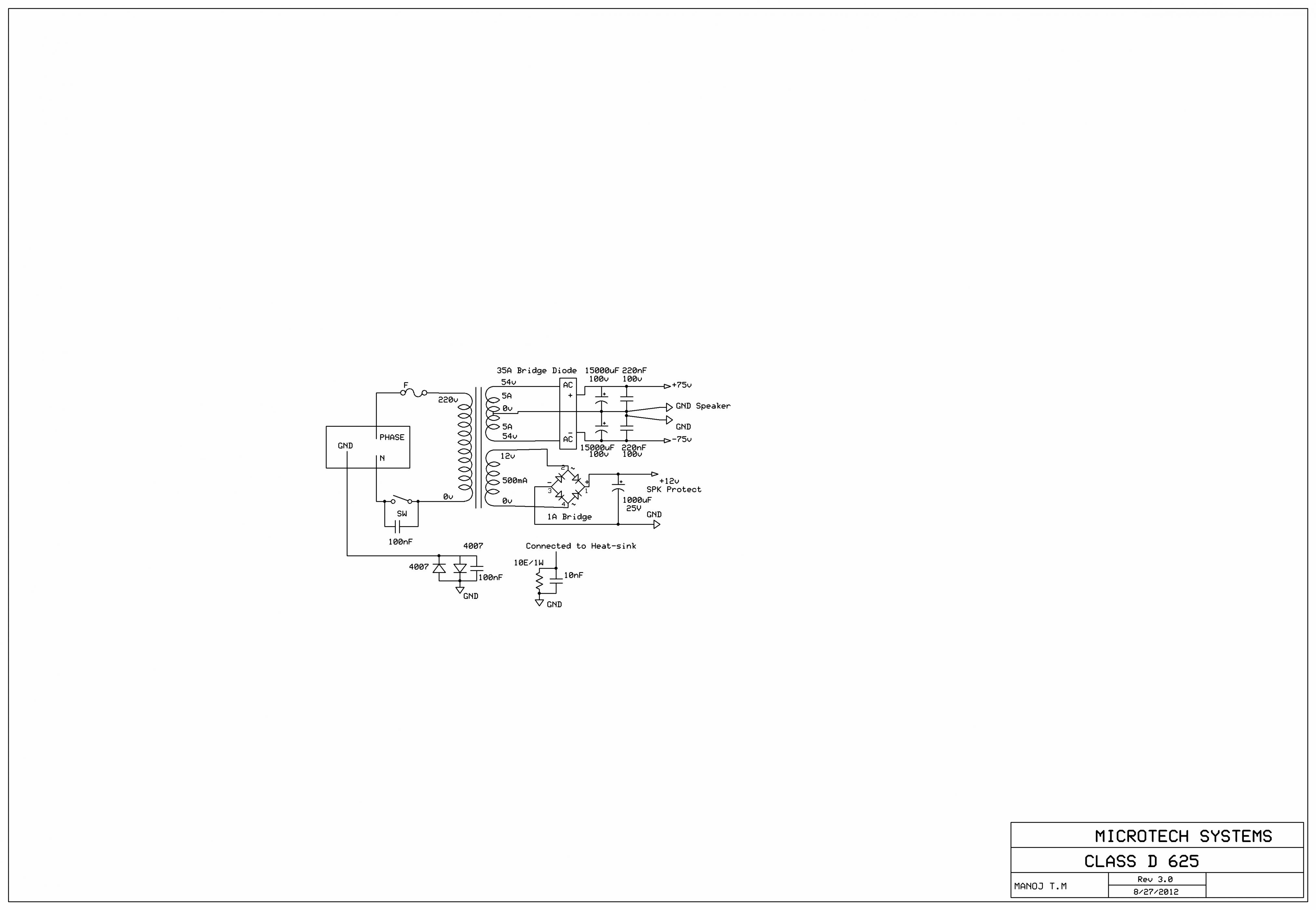

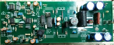

UCD 25 watts to 1200 watts using 2 mosfets
Its my old PCB and i modified some parts EMI is very low i already posted the EMI details
Regards
MANOJ

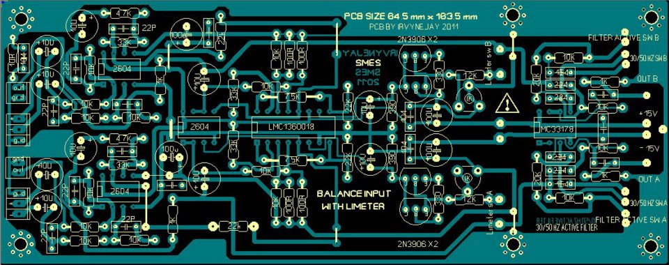

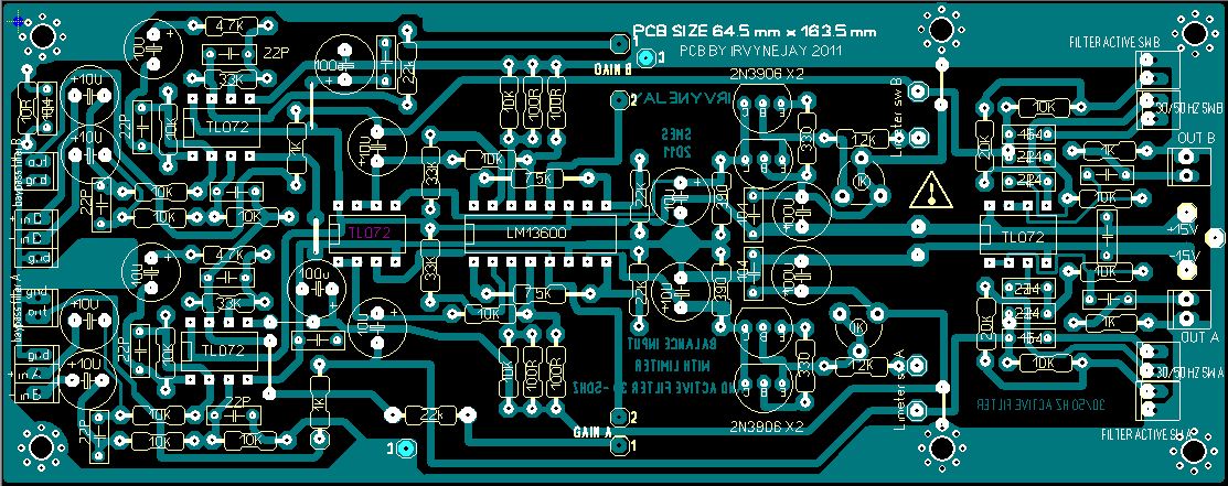

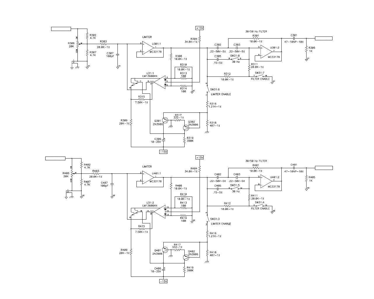

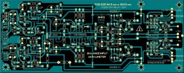

Andrew pcb full with balanced input,limiter,and filter from Irvynejay (a clon qsc input)exelent job please share the pcb for diyers Irvy
Ok here we go with fix
