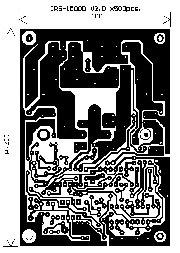

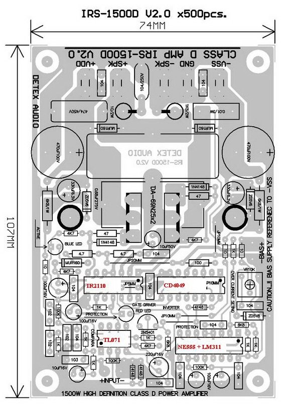

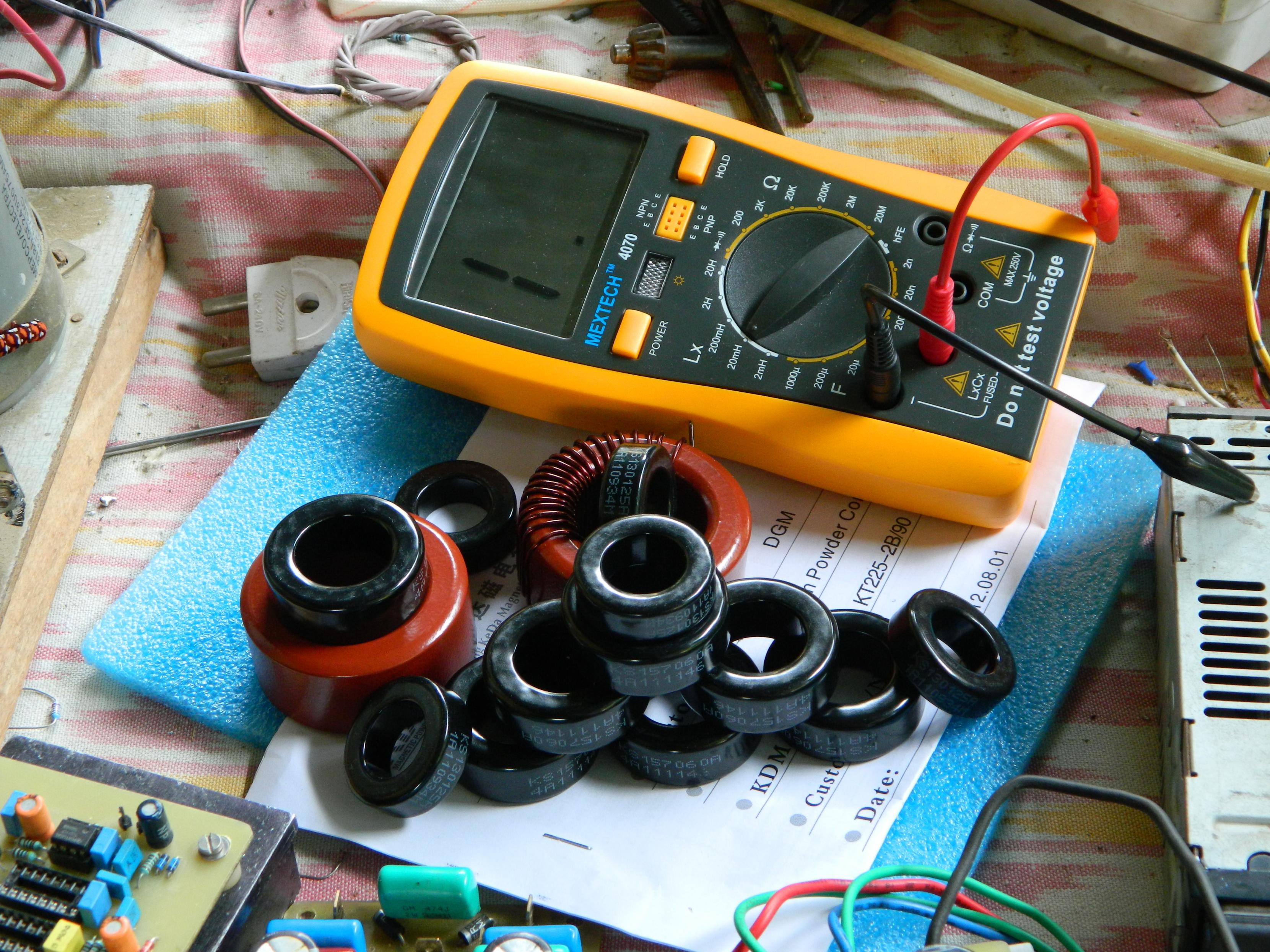

i used a yellow color from PC power supply and i double it up with 32 turns of 1.2mm,sound 's good,hope can find an EE core here is KSA.
detex pcb
warm regards
andrew lebon

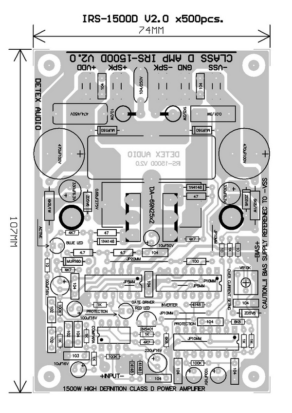

FYI - It seems that some of the tracks (under the IC's) got "masked" by the white background... 🙁

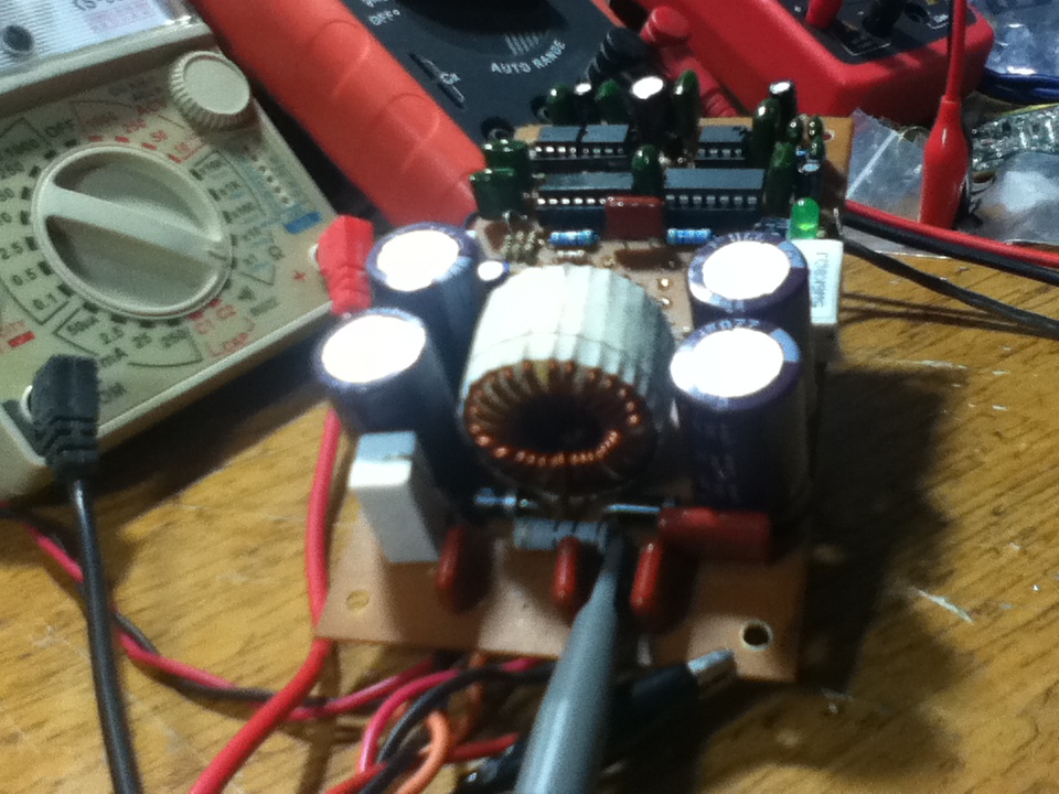

HI ALL,
My new class d design it will work very cool on +80v -80v @250KHz full band
i connected 3x 8 Ohm speaker parallel without heat-sink
Regards
MANOJ
pls post a schema are the outputs irfp250?
hi andrew and exflaco can i use irfp250n/260n with pcb 1500 watts detex audio at +/- 75vlts dc with a 4ohms woofer
