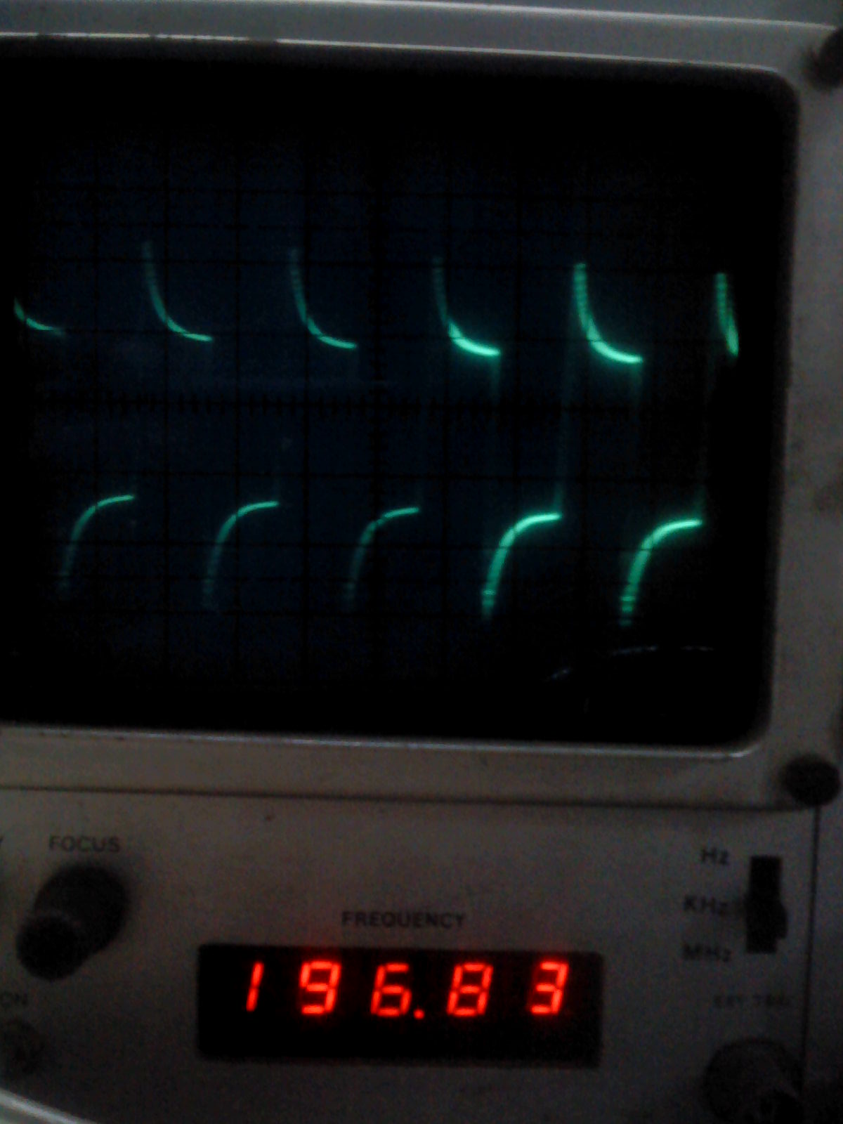

thanks for the feedback....i just wrote it to get some attention...actually i dint mean that...i know all the designs are working....but i'm having a small prob and nobody hear has given me a correct solution yet....what can this thing make to give out square wave output after coil...and on applicaton of signal generator with 1khz it gives out 3khz....any idea can u suggest!!!!!!!!!🙄🙄🙄Hi Sweetperfume

what coil you are using now and what is your switching frequency,MOSFET Used,supply voltage ......

i had used 33uh coil... switching freq is very low at around 200khz...unable to set it...mosfet are irf250N ant supply voltage is +/-35 volts..Hi sweet,

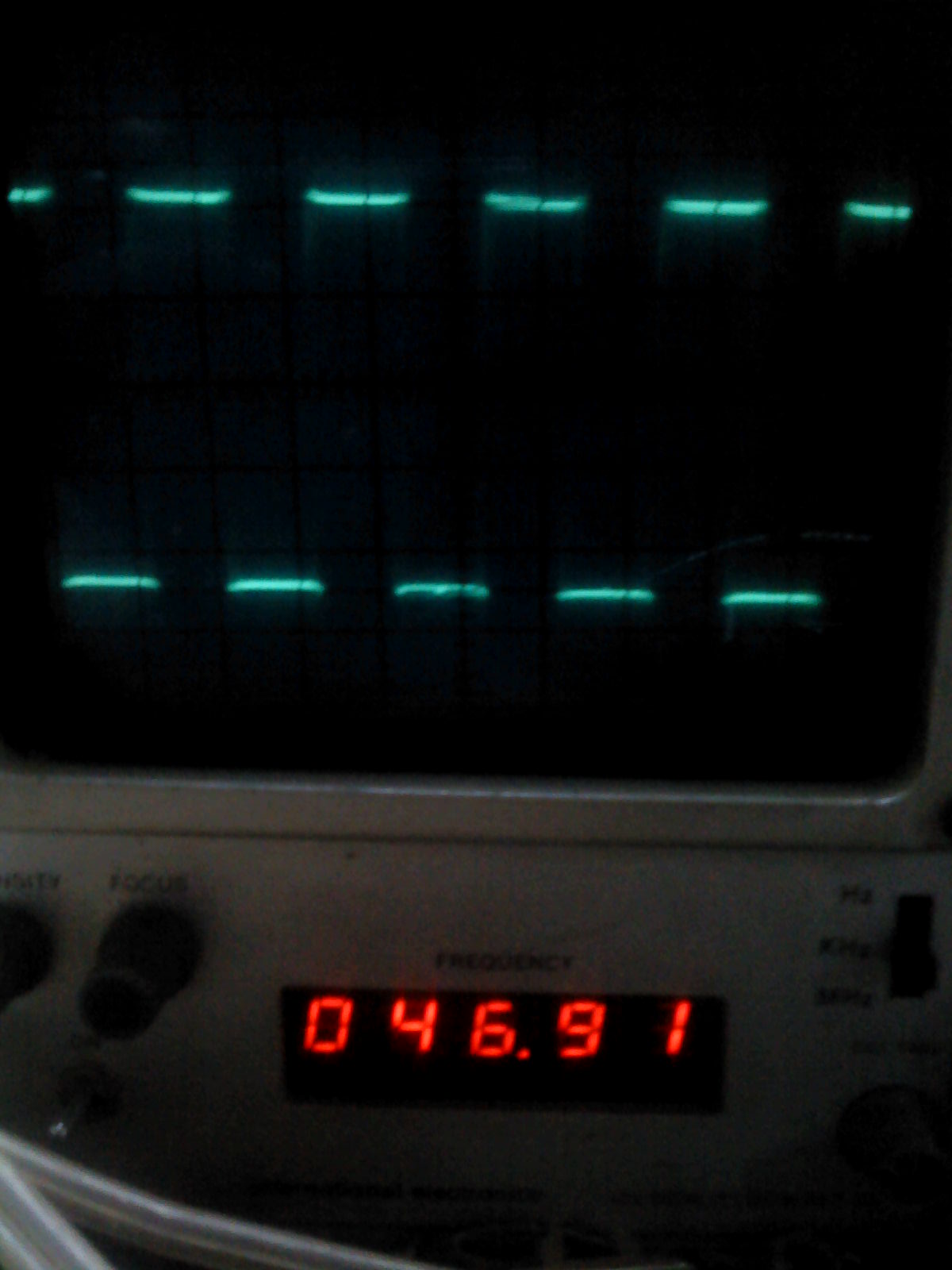

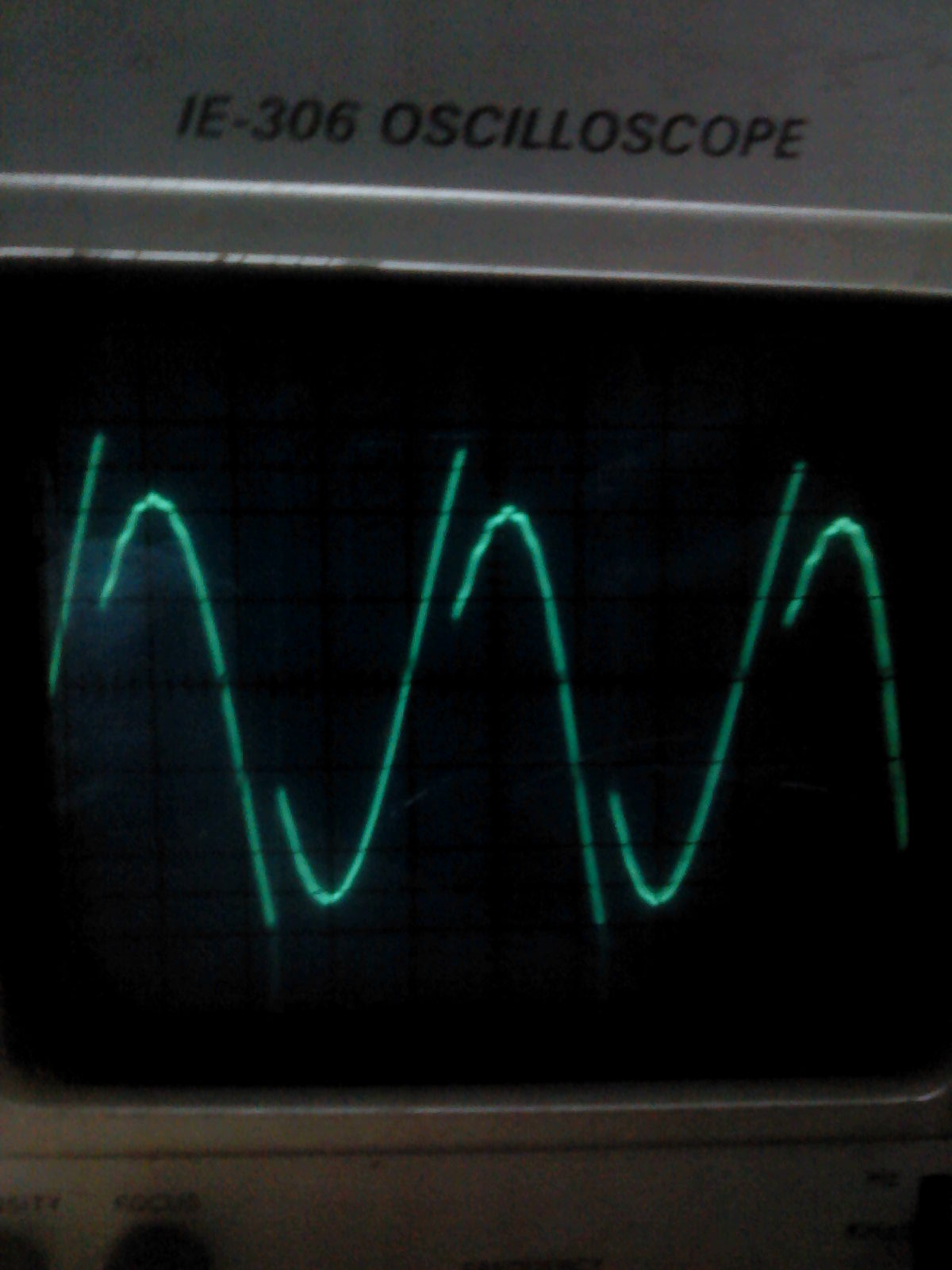

when the the 1nf capacitor is removed...the output is very clear when applied player but not when signal generator is connected....1st image shows freq with input frm signal generator...its self oscillating freq wave before inductor...
2nd after applied signal of 1khz
3rd after coil with signal generator
take a look at the waveforms which i got and freq..i dont think its correcttry using IRF540N they are 100V fets and are much more faster than irfp250n

You said that you have sware wave output. Are you sure you are not clipping the output?Decrease input signal to 1/10 and see what happens.

the thing remains the same...the third image shows the freq after the inductor coil....it is square wave take a look at it...i lowered the signal but onle waveform size reduces not its paternsweetperfume:

Measure signal at comparator pins IN+ and IN- and post it.

this if the frequency on -IN but it shows unstable freq of 140khz and aroundIt means i can not identify the problem remotely, but i will try a little more.

hello Sweet as what you have shown on the first image that situation is when your both output transistor are beyond or very low from it's pinch-off voltage or threshold,try to check the threshold voltage of the power mosfet you're using,(gate source voltage)IR's hi & lo output is between 4 to 5v to drive the output transistor,hope this will help,good day.
