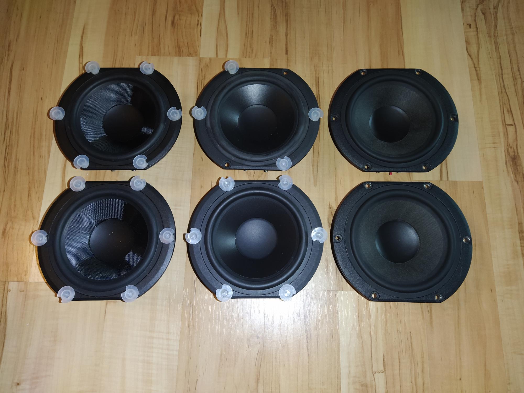

I the meantime I have checked these mid-woofers:
Seas Excel W15CY001 -> 5.5" (340 Euro)
Satori MW13TX-8 ------> 5" (274 Euro)
Seas Excel W12CY003 -> 4.5" (239 Euro)
Satori MR13P-8 --------> 5" (180 Euro)
for your opinion there is someone that can be match with SPH250KE ?

Midrange recommendations:
Your selection:
Seas Excel W15CY001 -> 5.5" (340 Euro), Problematic frequency response and 3rd order distortion prominent over 2nd. Will not sound as good as others.
https://hificompass.com/en/speakers/measurements/seas/seas-w15cy001-e0015
Satori MW13TX-8 ------> 5" (274 Euro), Excellent choice. Read more comments below.
https://hificompass.com/en/speakers/measurements/satori/satori-mw13tx-8
Seas Excel W12CY003 -> 4.5" (239 Euro), Don't like this one. 3% distortion peak at 1kHz will sound coloured. Too many dips and peaks.
https://hificompass.com/en/speakers/measurements/seas/seas-w12cy003-e0044
Satori MR13P-8 --------> 5" (180 Euro), Unnecessary dip at 1,5 kHz. There are better choices. Too much energy in the breakup region.
https://hificompass.com/en/speakers/measurements/satori/satori-mr13p-8
Would like to suggest some more in some different groupings.
Group 1, cost no object.
SB Acoustics Satori MW13TX-8 https://hificompass.com/en/speakers/measurements/satori/satori-mw13tx-8
SB Acoustics SB13NBAC30-8 https://www.dibirama.it/home-page/m...sb15nbac30-8-mid-woofer-5-8-ohm-100-wmax.html
ScanSpeak 15W/8530K00 https://www.dibirama.it/home-page/m...-15w-8530k00-mid-woofer-5-8-ohm-110-wmax.html
Group 2. A step behind group 1 in performance but still very very good.
Peerless HDS-P830991 Glassfiber cone. https://www.dibirama.it/home-page/mid-woofer/314-peerless-hds-p830991-mid-w-5-8-ohm-60wmax.html
Peerless HDS-P830860 Polypropylene cone
Peerless HDS-P832873 Nomex paper cone
ScanSpeak Discovery 15W/8434G00 https://www.dibirama.it/home-page/m...-15w-8434g00-mid-woofer-5-8-ohm-120-wmax.html
Look at distortion.
Should be low (below 0,5% at least for 1 W) and linear.
The less dips and peaks in frequency response the better. A peak of 1 dB over an octave can be detected. A peak of 2dB over an octave I would say is a colouration and unwanted in a high end design.
The more linear impedance curve of the higher registers the better.
Like the HDS drivers from Peerless a lot but think you want to take a step further and then a driver from Group 1 would be the best choice.
HDS drivers I had at home at the moment...
Very low distortion below 0,1% in the working area and very good linearity between 2nd and 3rd harmonic will give a very neutral, open and clean sound without any disturbing regions. One of the best drivers at the moment, but at a price of course. High rolloff fairly easy to handle. Copper cap 🙂
Almost as good as Satori MW13TX-8 but with a severe break up peak, but surprizingly without the distortion peak that normally result from breakup.
Excellent driver with good linearity and very low and even distortion. Copper sleve on pole piece for top sound.
Will probably need a notch filter to lower the break up peak. 🙂
Very smooth frequency response and linear and low distortion. Smooth rolloff will make cross over design a walk in the park.
Paper cone will be a bit softer on your ear compared to the harder cones above. Will work very well in this design. Copper cap on pole piece. 🙂
HDS 5,25" drivers is almost as good as it gets regardless of price. I have used these drivers a lot and them perform very well and are easy to work with.
No detectable colouration and very low distortion overall. As linear as a straight line. Would easily make it to Group 1 if they had a copper capped pole piece. Might would have selected this series of drivers my self for this design. That's how good they are. Love them...
A dB higher sensitivity than Group 1 could be reason enough to make this your first choice.
Out of these three I would select the Nomex paper cone first since glass fiber cone a bit soft and polypropylene changes more with temperature
which slightly will effect performance on hot summer days.
Dayton Audio DSA135-8 https://www.dibirama.it/home-page/m...dio-dsa135-8-mid-woofer-5-8-ohm-100-wmax.htmlHave not tried this one, but data looks as promising as SB13NBAC30-8 but with a rolloff that is easier to handle. With more copper on the pole piece it might rival SB13NBAC30-8.
Have not used this one, but it seems very similar to Peerless HDS-P830991 which I like a lot.
Little better sensitivity on this one is welcome. Need to buy this soon to learn more.
I think any of the above drivers are good enough to be in your design.Look at distortion.
Almost as good as Satori MW13TX-8 but with a severe break up peak, but surprizingly without the distortion peak that normally result from breakup.Excellent driver with good linearity and very low and even distortion. Copper sleve on pole piece for top sound.Will probably need a notch filter to lower the break up peak. 🙂
Very smooth frequency response and linear and low distortion. Smooth rolloff will make cross over design a walk in the park.Paper cone will be a bit softer on your ear compared to the harder cones above. Will work very well in this design. Copper cap on pole piece. 🙂
HDS 5,25" drivers is almost as good as it gets regardless of price. I have used these drivers a lot and them perform very well and are easy to work with.No detectable colouration and very low distortion overall. As linear as a straight line. Would easily make it to Group 1 if they had a copper capped pole piece. Might would have selected this series of drivers my self for this design. That's how good they are. Love them...A dB higher sensitivity than Group 1 could be reason enough to make this your first choice.Out of these three I would select the Nomex paper cone first since glass fiber cone a bit soft and polypropylene changes more with temperaturewhich slightly will effect performance on hot summer days.Dayton Audio DSA135-8 https://www.dibirama.it/home-page/m...dio-dsa135-8-mid-woofer-5-8-ohm-100-wmax.html
Have not used this one, but it seems very similar to Peerless HDS-P830991 which I like a lot.Little better sensitivity on this one is welcome. Need to buy this soon to learn more.I think any of the above drivers are good enough to be in your design.
Look at distortion.

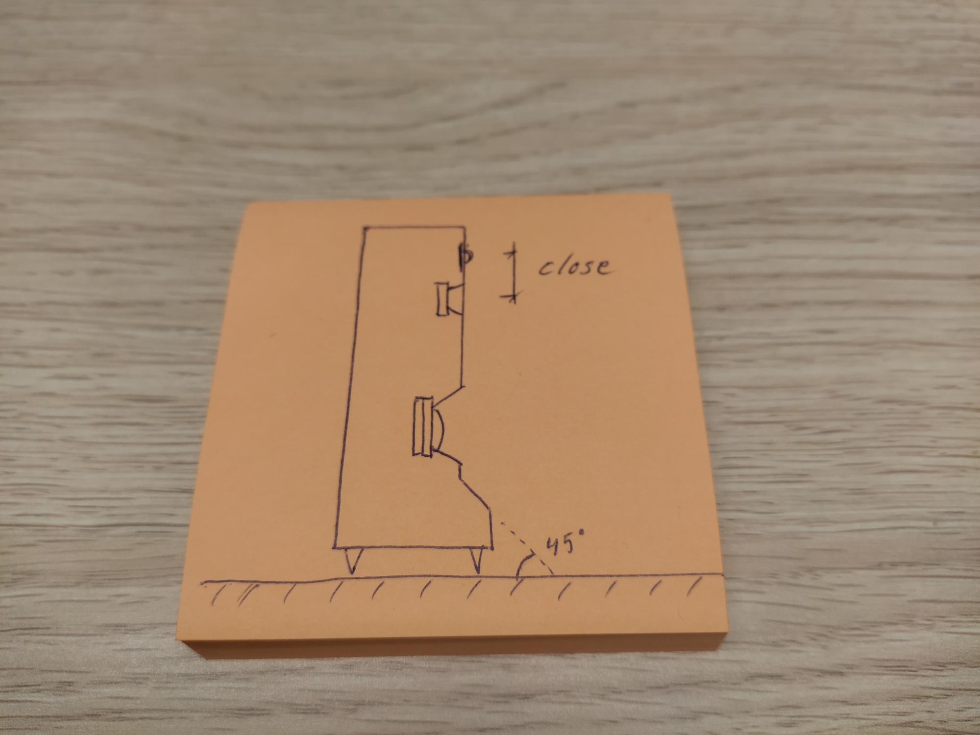

If you remember I recommended two driver placed with different distances to the floor which will help to further linearize frequency response.
Now you wanted one bass driver so you need to do what you can to eliminate the problem.
A 45 degree sloping baffle between bass driver and floor will also help a lot to reduce the dip.
Not pretty, but effective.

So place the driver low.

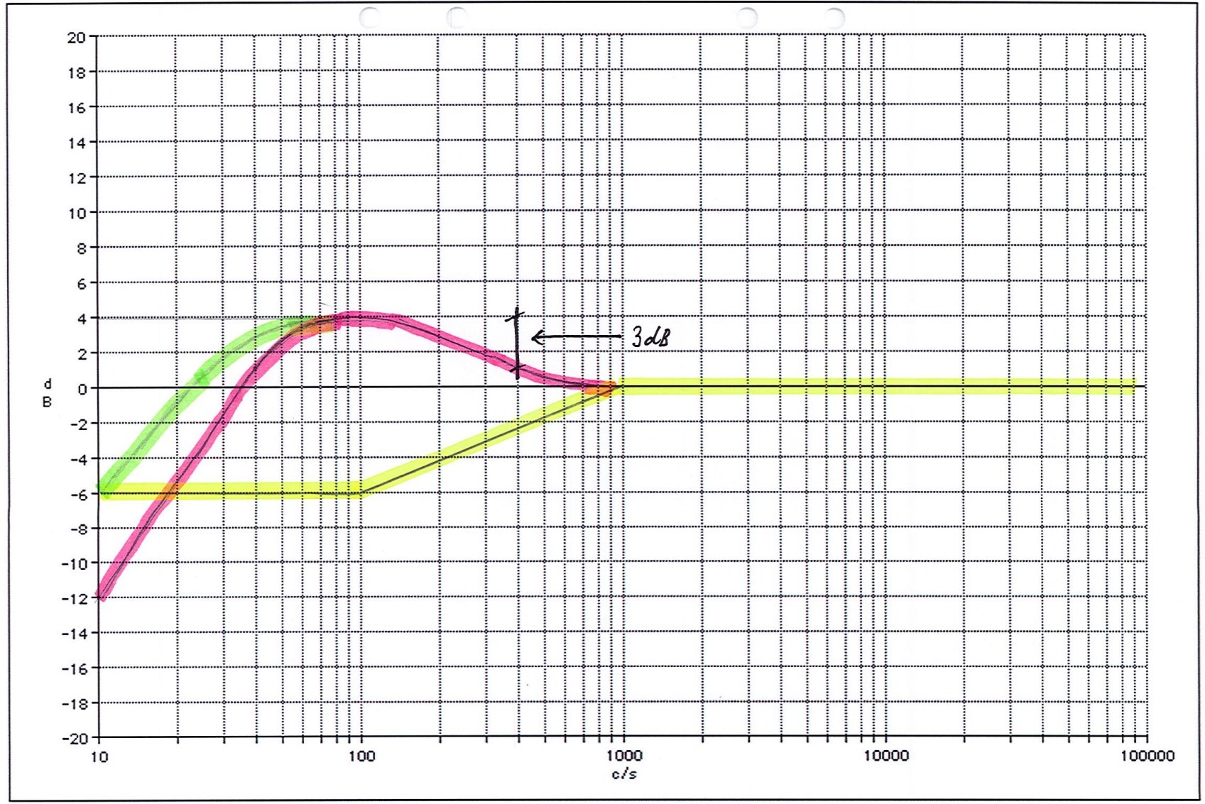

A word about the baffle step compensation.
By theory bass spread sound in full space (360°) space while upper midrange and treble spread in half space (180°).
So you the energy from the speaker need to fill a bigger volume in bass compared to the higher registers.
In theory bass needs twice the energy.
The transition is gradual according to the yellow curve, and width of baffle defines where the transition starts.
Rounding and chamfering of edges have an influence too, and it's good practice to keep the baffle as narrow as possible or round edges quite much.
https://heissmann-acoustics.de/en/kantendiffraktion-sekundaerschallquellen-treiberanordnun/
To compensate for this bass theoretically needs to be 6dB higher in frequency reponse than higher registers.
In practice only a part of it needs to be compensated for and it also depends on room size and how close to walls the speaker should be placed.
I think 3-4 dB higher level of the bass driver compared to midrange driver is good enough since reverb from the room also will add some energy.
Technically it can be solved in several ways, but in your case I think the easiest is to lower the low pass filter point of bass driver to approx. 200 Hz instead of 400 Hz, and let the midrange have it's high pass filter point at 400Hz.
I think you can start with a a standard 2nd order cross over for bass driver at 400 Hz and the increase the inductor gradually until you get the target you set.
Depends on the type of filter you would like to use, but I would not look at anything else than 2nd order cross overs for this design.
Below 50 Hz room gain kicks in as a consequence the bass output needs to roll off.
Pink curve is an example of suitable taget curve for near field measurement.
Hit that one and you will get a fairly straight frequency response in your room.

Hower I have looked the speakers you have post:
https://www.stereophile.com/floorloudspeakers/507peak/index.html
https://www.stereophile.com/content/kef-blade-two-meta-loudspeaker
in both case there is a uncommon placement on drivers, one put the tweeter and midrange diagonally and this can cause baffle step issue and is clear why need a compansation on crossover.
The other one have woofers on the side and also is clear why need a compansation.
However these project don't seem to have somephing in common with my apart the fact perhaps that the woofer is not quite on axis with respect to the other drivers becouse is not close to midrange.
About the impedence I don't think is easy get a flat line with a so large crossover gap. I don't understand how they did it
Suppose for example that the woofer is close to midrange at only 3/4 cm, for your opinion need a baffle step compesation ?
