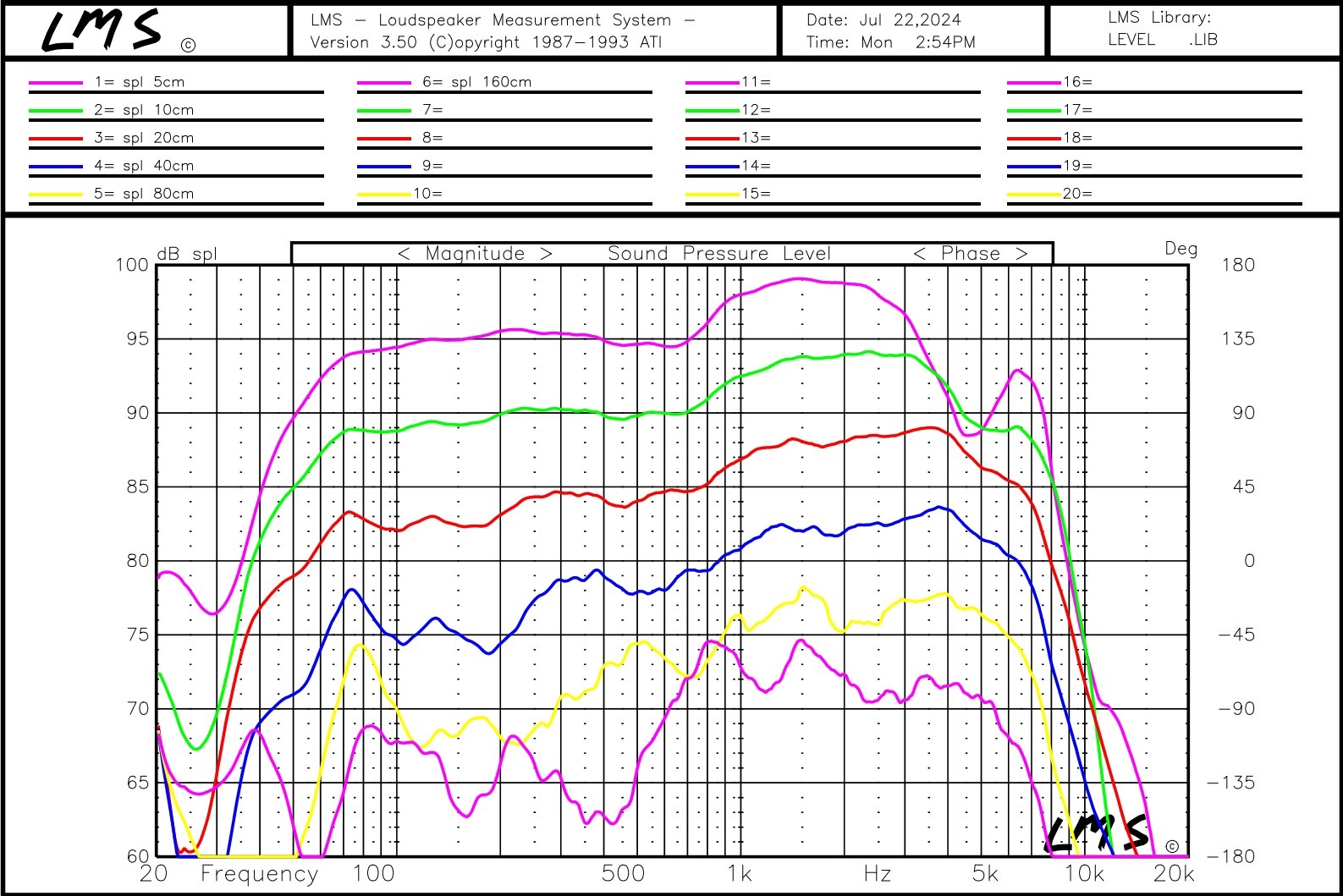

Could you explain this?So -3dB for each doubling of distance as you would expect.
I would expect -6 dB with each doubling of distance (that is: not including baffle, diaphragm dimension and room effects).
With room effect in the lower bass region the reduction is less, maybe -3 to -4 dB, in the range you mentioned.
And for the transition from 2pi to 4pi radiation, below baffle step frequency the effect is more than -6 dB, but only for near distances.
-3 dB would be expected for a line source, right?
Maybe I just did not understand your explanation - thanks in advance!

Most think the way you do so it's common misunderstanding.
We are measuring the acoustic power and acoustic power decrease with 3dB for every doubling of distance and increase with 3dB by every halfing of distance.
https://pulsarinstruments.com/news/understanding-decibels-decibel-scale-and-noise-measurement-units/
Theoretically the transition from 2pi to 4pi is always -6dB exactly.
In practice it's around -4dB because of reflections from walls, ceiling and floor.
When measuring at different distances it's obvious that amplitude level decreases with 3dB for every doubling of distance.
Someone more educated than me for sure can describe it better.
I'm just telling what I see and have learnt by practice.

We are usually not measuring acoustic power but sound pressure.We are measuring the acoustic power and acoustic power decrease with 3dB for every doubling of distance and increase with 3dB by every halfing of distance.
(Total) Acoustic power is not reduced at all with distance, if I'm not mistaken.
(Edit: power is actually reduced by air absorption losses)
Edit2: I'll probably think over it an do some research to avoid misconception!
Anyway thanks for the response!

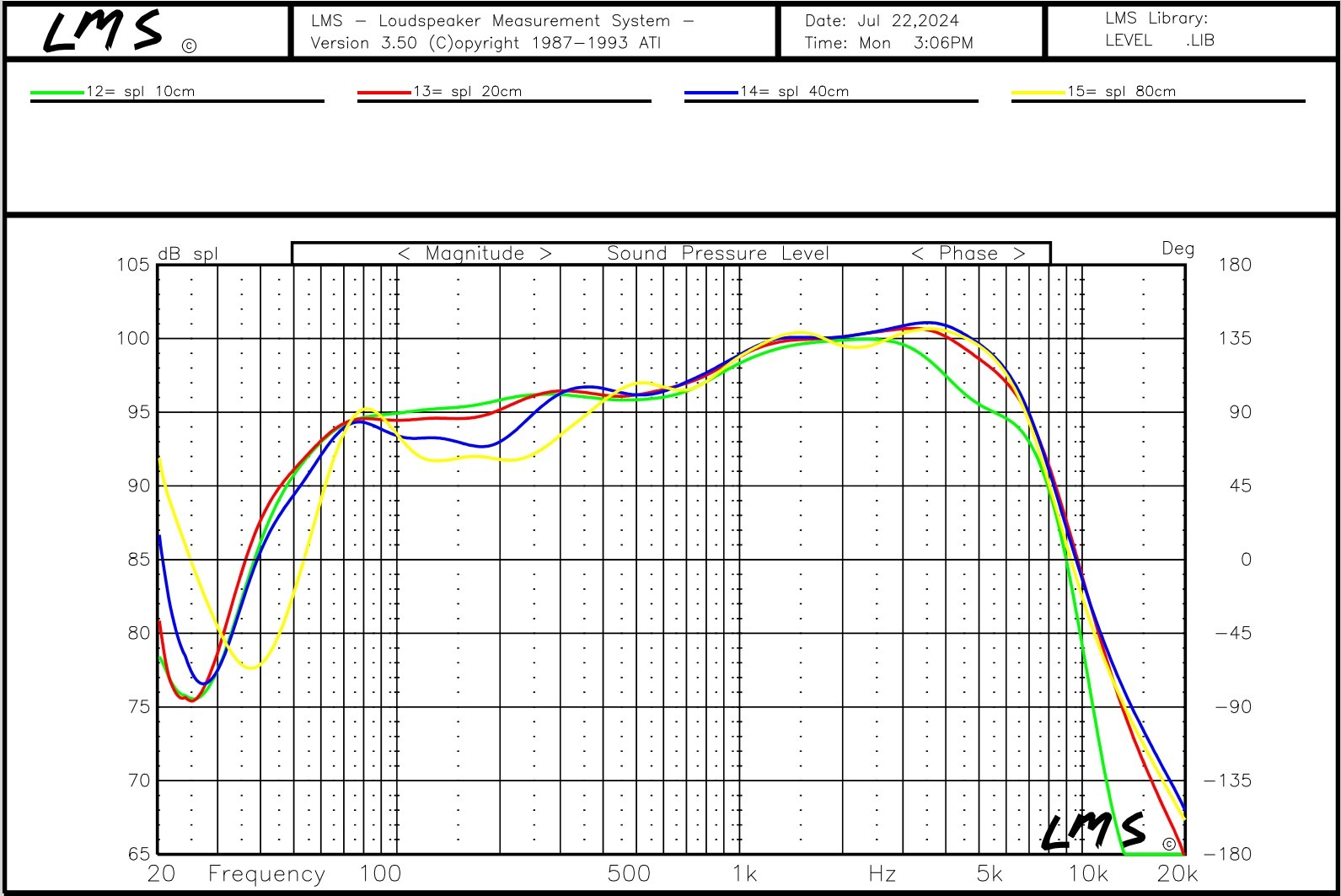

Thank you @flex2,
Let me do some consideration about your measures:
1) your room seem well treated and low susceptibility to external resonances caused by wooden furnishings and this simplify the measures.
2) The B&O Penta compared to other loadspeakers seem less affect to baffle step issue.
However now suppose we want compensate the baffle step, the question is at what distance you must use at reference ?
Suppose you compensate the baffle step at 50 cm adjusting the bass inductor. What happen to other distance ?
I don't think you can compensate equally at all distances.
So I guess if you compensate it at 50cm distance and repeat all the measurements , you will find that if before at 120cm the response was relatively flat, after compensation it will not be. Do you confirm ?
So if I wanted to make a more practical point, with your B&O Penta loudspeakers I wouldn't make any attempt to compensate for the baffle by modifying the crossover because I assume the listening point is more than a meter and I don't think 50 cm. Do you confirm ?
Apart this I have another question at what height did you put the microphone ?
I ask this becouse I see that frequency response of tweeter is relatively flat at 50cm but starting at 110cm starts to get lower.
I suppose this depend by off-axis dispersion tweeter. It is true ?
While the baffle step occurs at small distances therefore rather far from the listening point, instead the tweeter lowering occurs near the listening point.
So it seems that in the graph you reported the off-axis dispersion should have perhaps more attention then the baffle step compensation.
What you think about ?

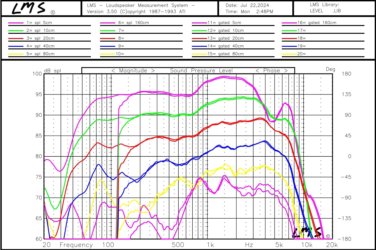

Just for the sake of completeness:I'll have to do some further research.
I think I know where our (eventual?) disagreement comes from - your measurement is probably not gated and thus includes reflections and measures the total radiated/reflected energy - which is probably a valid method to determine far field voicing.
@stv
I can check if gated measurement behaves differently. It shouldn't, since the 3dB decreas is valid for measurement from 5cm to 10 cm too and then room have very little impact.
You are correct that it is measered with continous sinewave since I wanted to see result down to 20 Hz.
Use gated measurement for near field measurement above 200 Hz but have never reflected over any differences in result because of type of measurement.
But I check and let you know about what I find.

At such close distance the diaphragm behaves like a "big" surface radiator. once the distance gets big compared to the diaphragm diameter (maybe 50 cm to 1 m) it is more like a point source with 6 dB anechoic decrease with double distance.since the 3dB decreas is valid for measurement from 5cm to 10 cm too

I practice it like this...
I know that the baffle step exists and based on prior knowledge and experience I set a target for near field measurement.
That target is what I have drawn for you in earlier posts where bass is 4 dB over treble in level, and I estimate where the transition begins and ends out of which baffle width I have for the project.
So you don't need to compensate for different distances, just hit the target curve with near field measurement.
Once you measure it far field in the room at listening position it should be pretty close to a straight frequency response.
If you have a straight frequency when measuring near field you will lack bass since it will be 3-4 dB to low compared to treble.
It's pretty straight forward and far field measurement is almost impossible to fully trust since reflections and standing wave nodes in the room normally have a huge impact and create lots of peaks and dips in the bass region below 200 Hz.
It took a while to find "my" way of performing measurement since it is an art that is not that easy as a DIY without controlled envioronment like silent room.
I just let you know my experience, but I expect you to find your own way how to perform your measurements.
Hopefully you have got better insight into the problem and can make better choices once you start building your new loudspeaker.
Remember, it's a hobby...
We learn from trial and errors too.
I will check and let you know the result.At such close distance the diaphragm behaves like a "big" surface radiator. once the distance gets big compared to the diaphragm diameter (maybe 50 cm to 1 m) it is more like a point source with 6 dB anechoic decrease with double distance.

Now some new measurements as promised:
First picture show difference between SPL and Gated SPL measurements. Basically equal up to 50 cm from baffle.
Please note that very close measurements closer than the drivers diameter are corrupted in the upper regions.
I measure from at least the same distance as the diameter of the driver. So no super close near field measurements.
Second picture shows amplitude level in relation to distance and as you said -6dB per doubling of distance.
In third picture I have scaled all measurements to the same level, and here the effect of the baffle step can be seen where
sound pressure drops faster when the loudspeaker goes from half space to full space distribution. Needs to be compensated for a linear frequency response at listening position. Here the width of baffle are 28cm and edges are sharp 90°
This graph seems not to confirm what has been seen in previous measurements.
In the previews graphs the baffle step issue was more present at closer distances within 50cm and at 110cm, the response was almost flat.
But in this one Instead, it seems to be the opposite, less baffle step issue at 20/40cm and more at 80cm.
Do you have measure the some loudspeakers ? and you have putted the microphone in the some point ?
