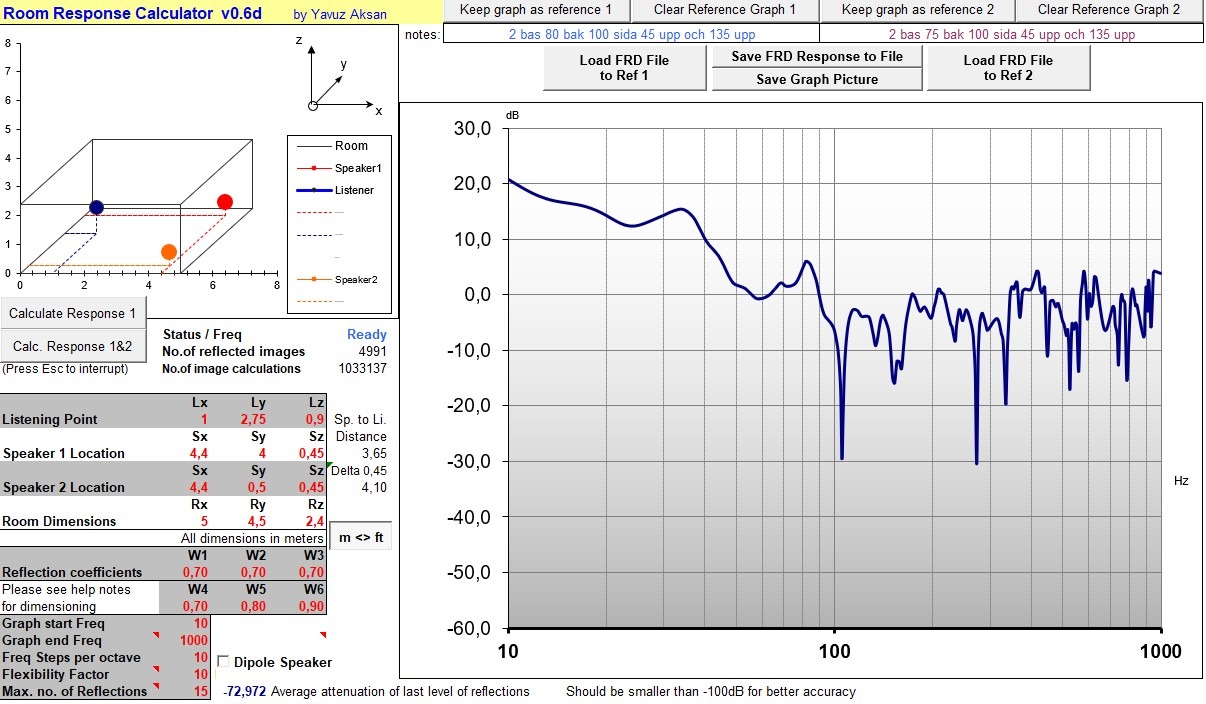

First I have included a simulation of how much bass level will increase because of room size.
Here I have simulated a 22,5m2 room with your speakers quite close to side and rear walls.
Basically you have:
50 Hz +3dB
40 Hz +10dB
30 Hz +14dB
20 Hz +14dB
For simulated "real" response in your room you should add these room gain levels to the loudspeaker simulation.

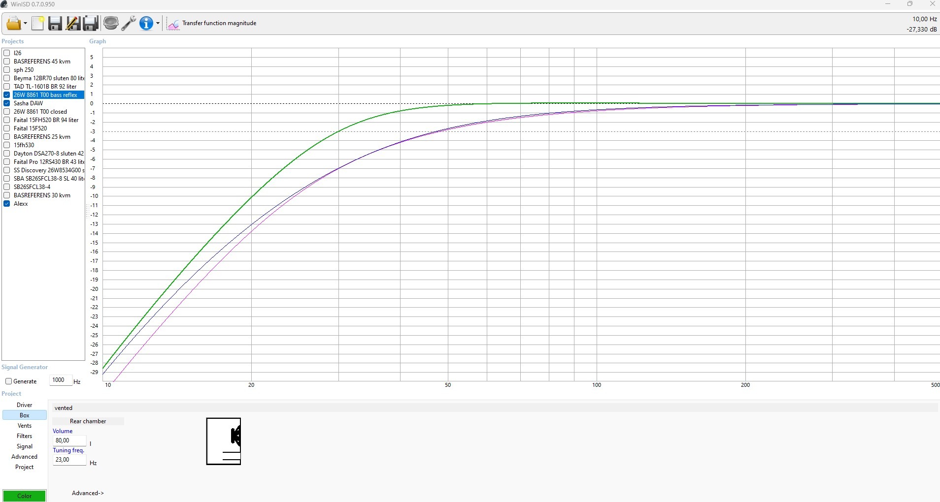

In this simulation:
Green curve 26W/8861 T00
Blue curve Wilson Audio Alexx
Red curve Wilson Audio Sasha DAW
Both these Wilson speakers used drivers from the same series from Scan speak and I have selected to make simulation on the drivers in this series that most closelly give the same result as Stereophiles review measurement, so I belive they are fairly similar to the real world drivers Wilson uses.
Their Alexx and Sasha DAW is developed to be used in rooms that are 35-50m2 as far as I can tell.
So another 3-4dB of extra bass with 26W/8861 T00 would be too much for even 35-50m2 rooms and totally to much in a 25m2 room.

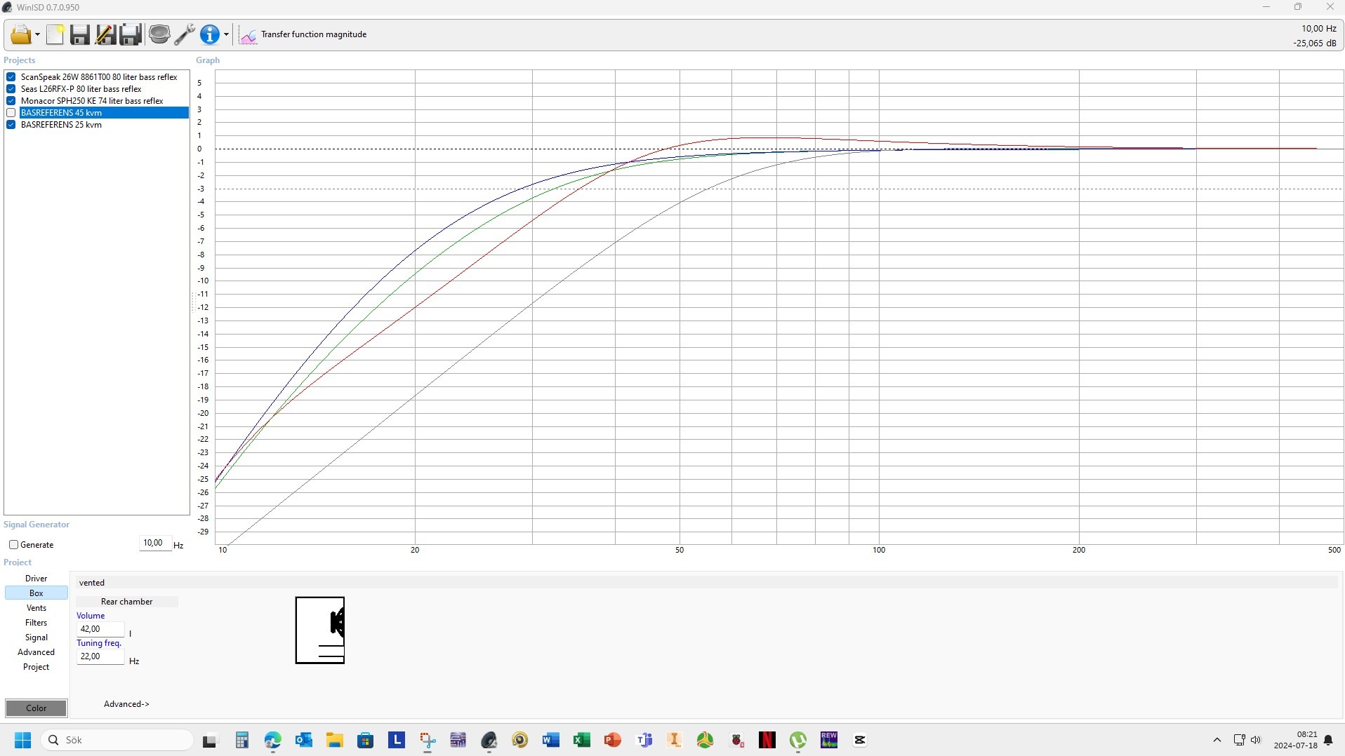

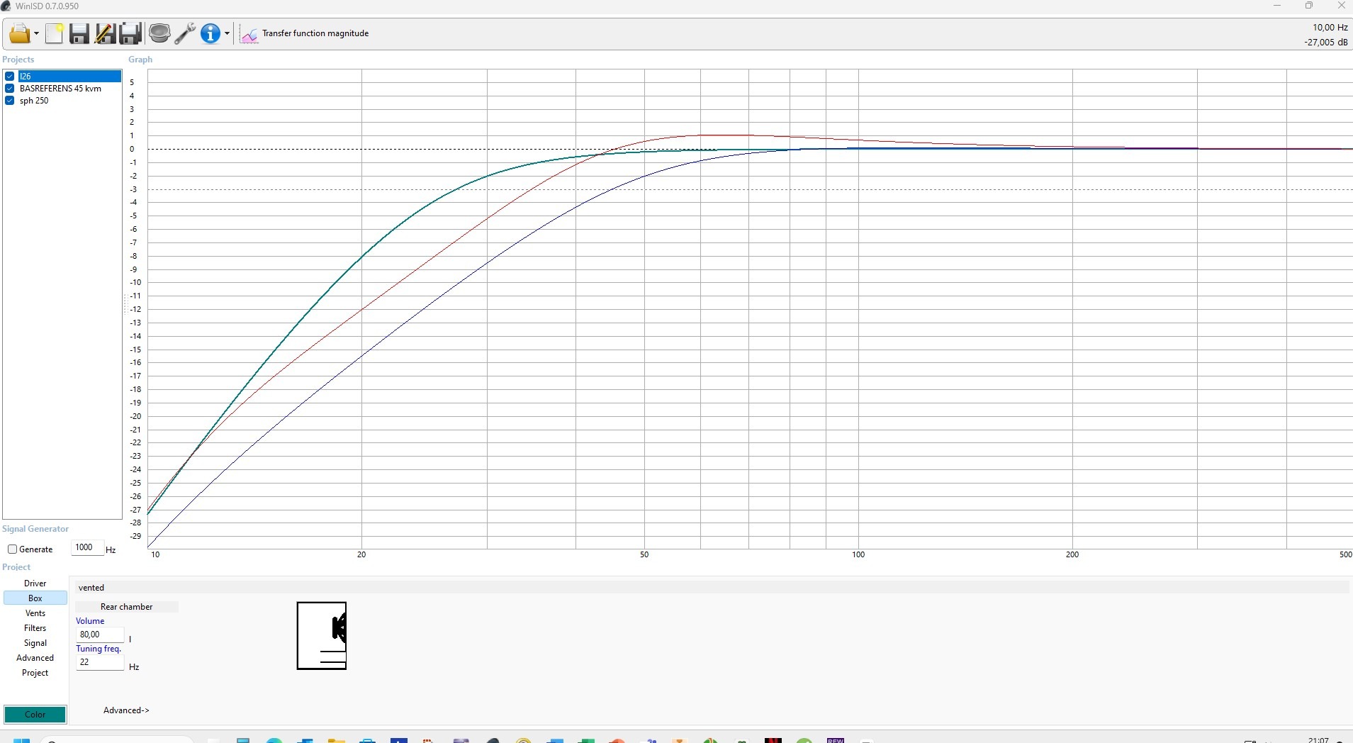

Sure...
All bass reflex cabinets.
Do not blame me if you end up with too much and overwelning bass since all of these drivers are best suited in closed cabinets and bigger rooms.
Blue curve Seas 26WRFX/P in 80 liter bass reflex cabinet
Green curve ScanSpeak 26W/8861T00 in 80 liter bass reflex cabinet
Red curve Monacor SPH250 KE in 74 liter bass reflex cabinet
All curves without room gain added.
Gray curve my target line for 25m2 room.
Also note that this is transition curves and that the drivers have somewhat different sensitivity.

Another simulation to help you decide where to go from here.
Red curve Monacor SPH250 KE in 74 liter bass reflex cabinet.
Blue curve Monacor SPH250 KE in 74 liter sealed cabinet.
Grey curve my target curve for 45m2 room.
Listen to your speakers and decide if you like it best as a bass reflex or as a sealed cabinet.

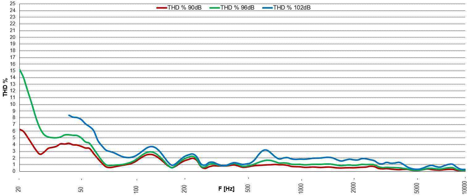

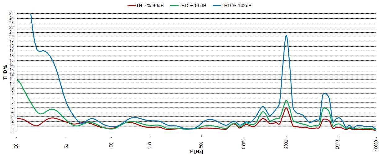

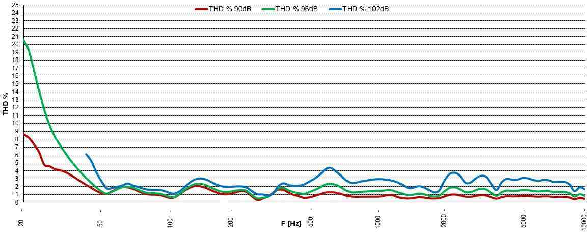

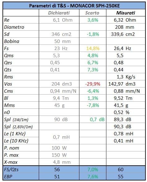

I attach 3 woofers (with my SPH250KE included)
For your opinion the distortion between SPH250KE and the others is the some ?
In other words, if I choose SATORI MR13TX-4 that allow to cut at 400 hz, can I consider better L26RFX-P and 26W/8861T00 then my SPH250KE ?

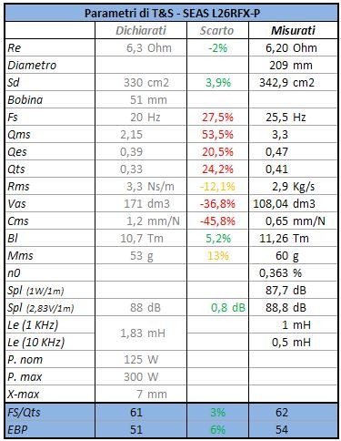

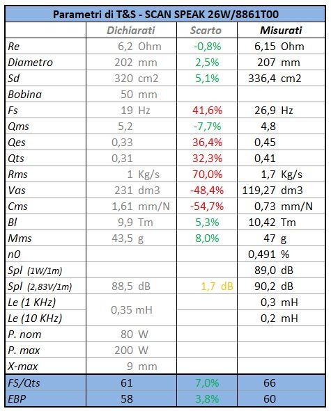

I would stay with the Monacor SPH250 KE.
You should not select bass driver based on their distortion performance from the graphs on DiBirama.
The reason is that I suspect that both Scan-speak and Seas wasn't broken in when measured.
Their values are very far from the manufacturers.
So it might be that they will change later when suspension is softened and then more distortion will kick in.
Monacor have the highest sensitivity of these three so it is probably the stiffest suspended and I do not
think you would like to go to even softer drivers.
Monacor SPH250 KE also have the smoothest frequency response above 300 Hz out of these three.

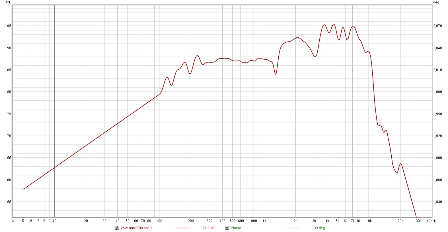

I'm confused about the Scan-speak 26W/8861T00 woofer, when I look at the manufacture's frequency response data it seems a bit of a mess to me. The 3 db dip at 1.3kHz isn't so bad but the 5 db rise to 2kHz just looks bad to me. There also seems to be some kind of resonance at 1.3kHz. I understand that this driver will be crossed low, but I don't understand how this driver should cost so much. What am I missing? Glad to see you rejected it. I wouldn't be so quick to dismiss the Dayton RS270, I used the RS180P-4 in a two way and I was surprised at how easy it was to work with.

Mtidge, the graph you show is not 26w 8861. I already posted the link to hificompass measurement, as a warning that this driver cannot be used upto 500hz due to its strong resonance around 500hz.
Anyway, scan speak woofers are excellent units when used right.
