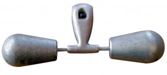

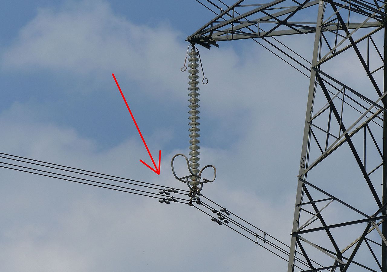

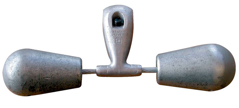

I am a retired electrical engineer and when I first saw the Longhorn cartridge modification it made me think of a device used by the electric utility industry, known as a “Stockbridge Damper”. A Stockbridge damper resembles a dumbbell and is commonly seen attached to the ends of high tension transmission line cables near the insulators on a tower.
Stockbridge dampers were patented in 1928 and are generically named after the inventor. Air blowing over high tension lines sets up a wake turbulence that causes the cable to vibrate in a range typically 5-17 HZ. The combination of the two masses with the stiffness and length of a multi-strand steel connecting cable tunes the damper assembly to the desired frequency. Energy is dissipated in the multi-strand steel cable via the friction effects of the individual strands rubbing against each other as the overall cable flexes. I was not able to find documentation on this, but recall hearing or reading that the lineman would tap the powerline with a hammer while moving the damper position back and forth to find the ‘sweet spot’ of maximum vibration attenuation before tightening the locking clamp.
For the curious, here’s a Wikipedia link:
https://en.wikipedia.org/wiki/Stockbridge_damper
Most Longhorn implementations appear to only add mass in the form of a solid bar, and none seem to have any damping element or means for dissipating energy. The concept has been around for a long time, and has been well refined for application in the electric utility industry. Phono cartridges and tonearms…?
Have I drifted off topic again?

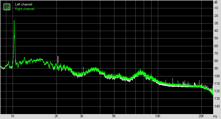

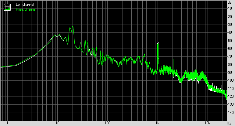

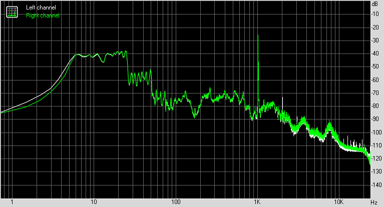

OK, I plotted them all. The difference between modified files is almost non existent, between stock and any mod there is a tiny difference way up high. But could you hear it?
Track 2 and track 3 shown below. Left channels is unmodified reference, right channel is the Longhorn with no extra weight. Also see a zoomed in view.
T2, T2 zoom, T3, T3 zoom
I'll upload the others tomorrow.
Thanks Michael.
I’ve run 2M FFTs on the files and I can’t spot an indication of difference with this method.
My opinion is that whatever changes with this mod, it is to be found at the low or mid frequencies.
Listening tests is a key part in the investigation but it’s uncomfortably warm here and I don’t have the desire to do listening tests now. I have to postpone them.

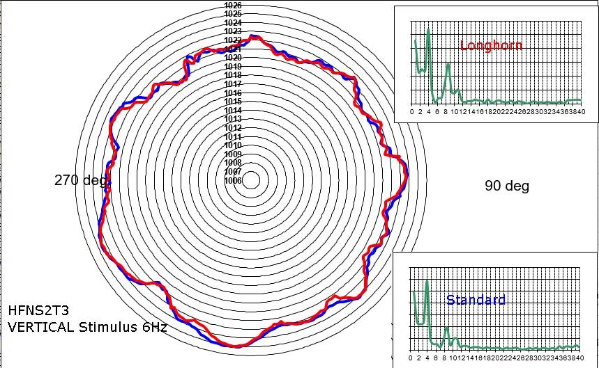

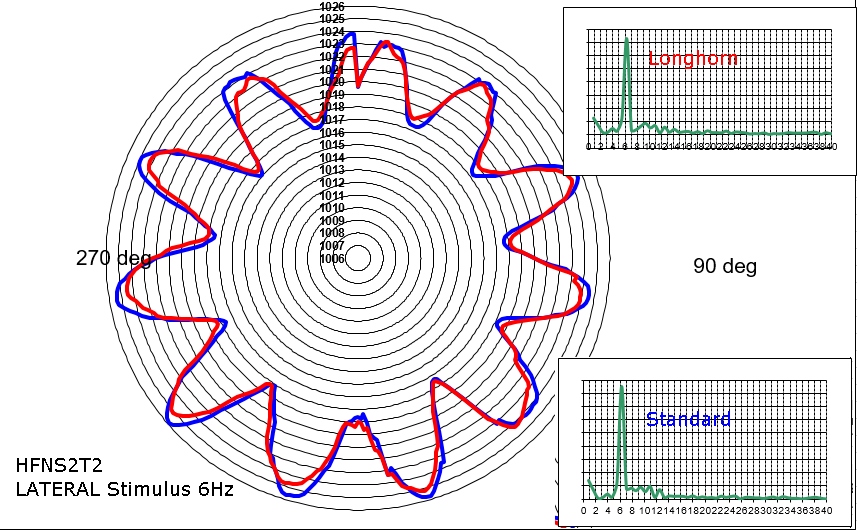

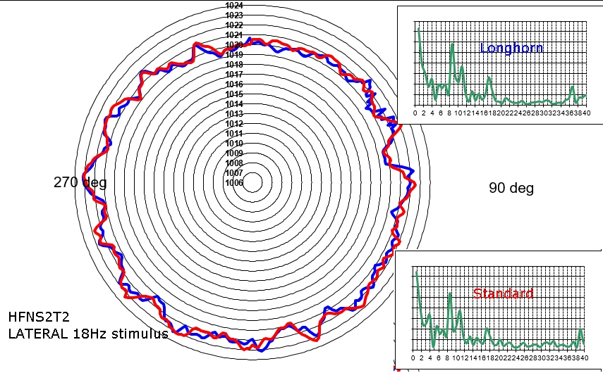

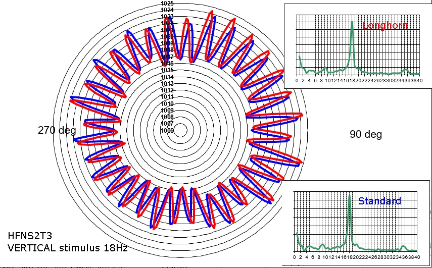

Longhorn versus standard pitch stability polar plots
Let’s put it to the test. What does it do in terms of modulation.
JVC QL- A2 with:
1 Shure
2 Shure+longhorn .......

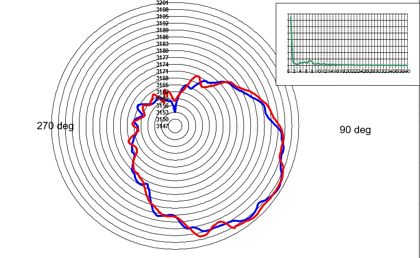

Many thanks George for another set of excellent and careful recordings. I took a good look and ran some polar plots, to look at effects on FM modulation.
Attached are images that show, on the same chart, longhorn and standard polar plots for pitch stability. Red is Longhorn, Blue is standard. Inset are FM spectra for both traces. Carefully time aligned for same location on record - very nicely done George !
I just looked initially at 'standard' Shure, and Shure + longhorn files. For all combinations of lateral and vertical stimulus at 6Hz and 18Hz (which seem to be near to lateral and vertical cart-arm natural resonant frequencies ).
IMO there is no meaningful difference between standard and longhorn FM pitch stability in this test........I think if there were difference in unwanted headshell/cartridge motion it would likely show up here, but apparently doesn't.
I suspect we might well be looking carefully for something that doesn't exist - I can't see why it should........ but if any bright ideas as to what else to look for in those sweeps I'd be happy to have a look?
BTW, any small difference in resonant frequencies due to extra mass of the mod doesn't show up here, because the headshell motion adopts the stimulus frequencies since they are close to the natural ones.
Still very pretty and very interesting 😉
LD
Gotta love science. This is possibly the first time this has been measured despite 30 years of people discussing it and trying it 🙂.
I was thinking the other day. A real time version of the polar analysis software (say LDtech PolarRT) would be the most amazing turntable tuning tool. Would blow Fieckert into a top hat.

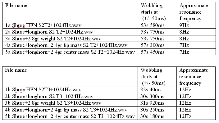

These tracks were meant to be tested through listening (the 1kHz tone starts to wobble when the arm/cart resonance is excited).
So I sat and listened to the recordings, trying to locate on each one the start of the 1kHz wobbling. It seems to me that for the S2 T2 files, the wobbling shifts a bit with the configuration.
I tried to locate the start of wobbling a bit more precisely by mixing one channel from each recording with a steady tone (1024Hz).
I upload the resulting mono files here
Dropbox - Mono files for dropbox
Here is my opinion (attachment).

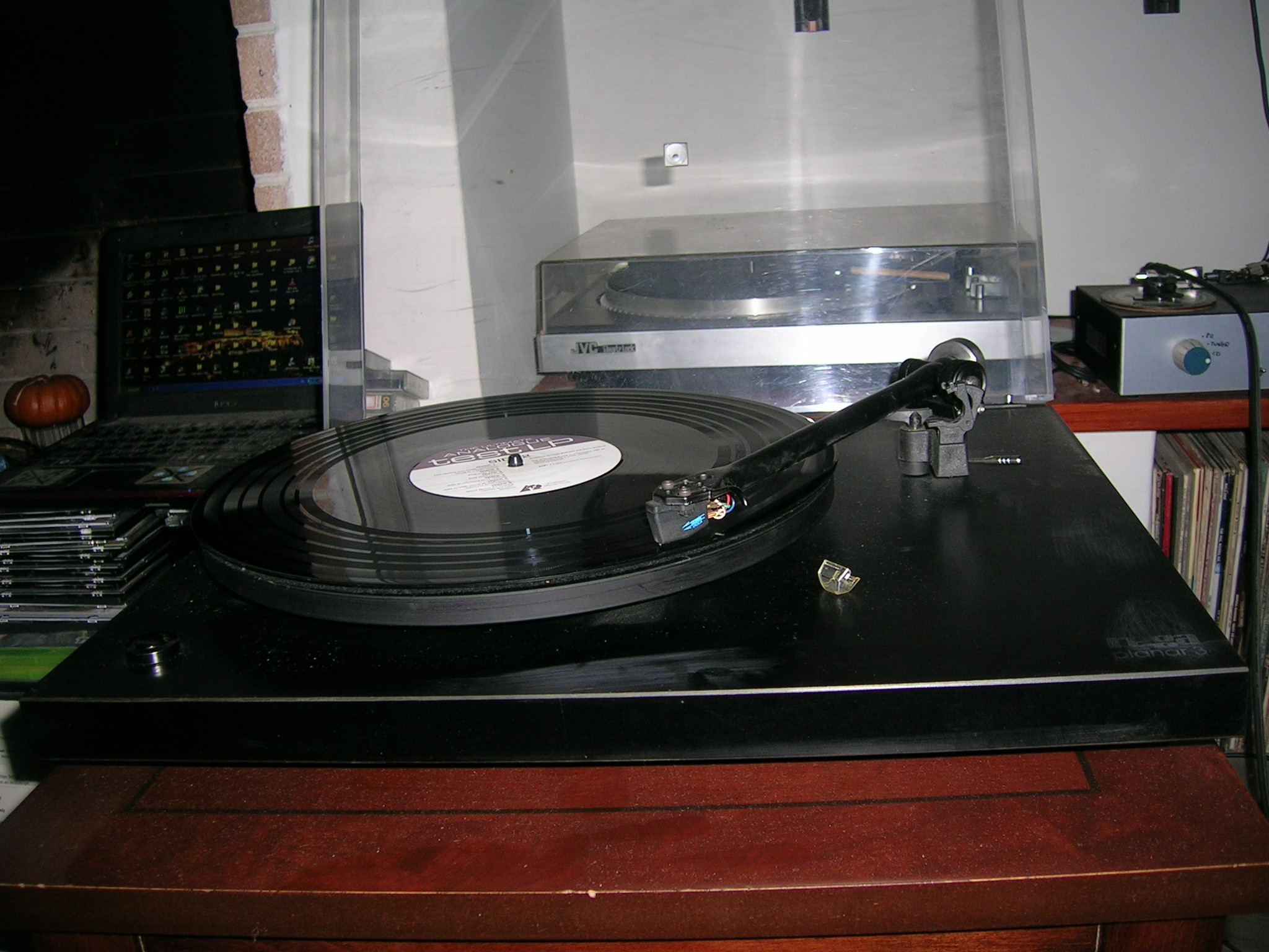

As promised
Rega 3 + Goldring Eroica through Musical Fidelity X-LP (MC) RIAA preamp
15/7/2017 13:00, 32.8d Celcius, 40.4% rel humidity.
Dropbox - Rega3 +Goldring Heroica L for dropbox
With a little help from Lucky 🙂 we’ll see what is going on.
George
