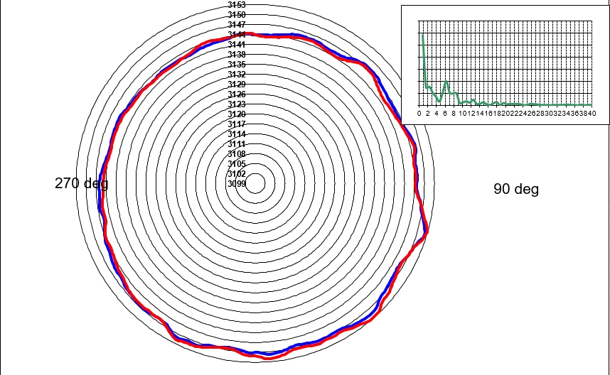

Thank you LuckyHere's the first of the analysis polar plots. It's the S1 T10 3150Hz tone.
The TT is running fast, and there's a strong 'once per revolution' variation that mimics eccentricity. Could be centering or vertical run-out, or bent spindle or something like that ? This effect is so bad that it's likely to mask anything else, and that shows up in the inset spectrum...
Neither centering or vertical run-out at least that strong as I could see.
Not a good rotating platter but judging from the spectrum inset, IMO a very good arm.
George

Noob Query. I am learning to read polar plots. The wavy plot denote speed variation. the centering of plot denotes eccentricity. What does inset spectrum graph denotes ?Thank you Lucky

The inset is intended to provide a spectrum view of whatever is FM modulating the test tone. It's just the result of an FFT of the demodulator output, sampled around the revolution. The y axis is auto-scale-to-fit linear level of demod output. For the purpose of identifying contributing sources that's fine. And the x axis is simply modulating frequency in Hz.
In the scheme of things, the FM modulating action is all at low frequencies, one can see that a number of ways. There's no energy for it to be otherwise, when you think about it....... but hey, that's for another thread !

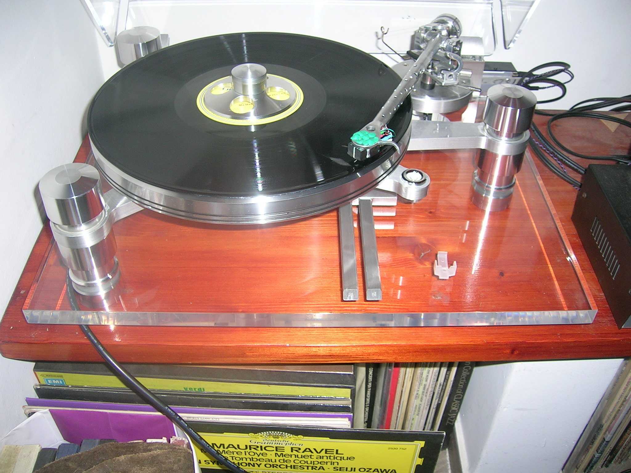

I barely had set the cart on the arm. The combo left the house without giving me time to record the other test tracks.
Oracle Delphi V + Audiomods + DL-103 (VTF 2.5gm)
