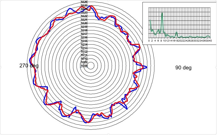

Sure - I had meant to post the polar plot for sections of that track, with vertical only stimulus, but there's so many interesting things going on the forum right now, I got distracted !When time allows, can you post please the polar plot for the HFN S2 T3 as well.
Thank you again. 🙂
George
Anyways, here it is. Very interesting too.
The first polar plot attached below is for the section of the sweep near 8Hz, for direct comparison to the S2T2 (lateral stimulus) plot posted previously. The plot is somewhat similar, but has notable spectral content near 18Hz that isn't prominent in the lateral stimulus test
So I looked at the section of the S2T3 (vertical stimulus) sweep near 18Hz, shown in the second plot attached below. One can see what appears to be a pronounced resonant response in FM, nearly monotonic (looks like a bit of 2nd harmonic near 36Hz). FM due to headshell motion seems near certain as the explanation IMO.
Interesting, and very pretty ! It tallies with the classic spectral plots, IMO.
LD
The lateral signal is so much less that it could even be down to channel imbalance.
I suppose real cartridges have very different horizontal and vertical compliance.
This is a good question. There is at least one cartridge (the ortofon DJ S-120) that makes a marketing point of different compliance. And according to Walton, back in the 60s you had about half the vertical compliance to horizontal. Now, with a donut elastomer its only the suspension string (if you have one) which modifies the vertical compliance. Unsure how to model that though...
In FM, which is what is at issue for pitch stability, channel balance makes no difference to performance or measurement. L, R, mono, difference, all show identical FM results because it's just the relative linear velocity of stylus to groove that matters.The lateral signal is so much less that it could even be down to channel imbalance.
The difference observed here is due to mechanical stimulus to headshell motion being vertical in the case of S2T3 recorded file and lateral in the case of S2T2.
What makes for the difference here is the direction of headshell motion in response to direction of mechanical stimulus.

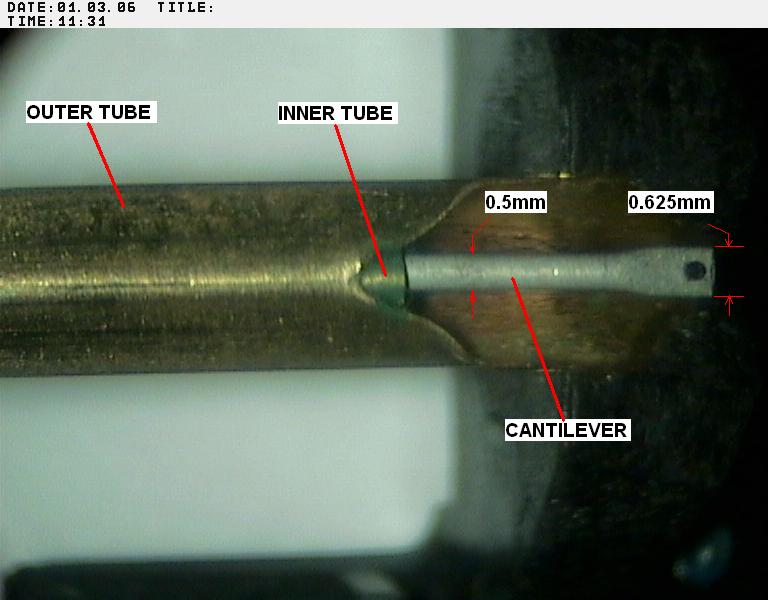

Cantilever suspension in Shure cartridges comprises a combination of an elastomeric donut between the magnet and the metal stylus housing, along with a metal support wire. From visual inspection, the cross-section shape of the housing and magnet (and thus elastomer) appears* to be very slightly rhombic, not a perfect square, with vertices aligned lateral and vertical. Thus, unequal compliance and damping in the lateral and vertical directions appears likely. In addition, the geometry of the tie wire appears intended to primarily provide vertical support, and will limit vertical compliance.
It seems reasonable to limit vertical compliance in order to raise stylus-arm resonance well above subsonic record warp frequencies. For several practical reasons, it is standard practice to mix program material to mono at lower frequencies when cutting a disc master. So there is limited vertical musical program to excite a LF resonance. Thus, limiting vertical compliance to raise the vertical resonance frequency makes engineering sense.
* These observations are purely from eyeball and drawings in promotional literature. We’d need a few sacrificial styli and calipers to confirm.

Personally, I mean any motion of the headshell that displaces it from the locus of the groove. Implicitly, that means movement of the whole tonearm in an otherwise healthy arm where nothing is loose or flexible, because there really shouldn't be anything near as compliant as the suspension elastomer - that should dominate, I think.When you people speak of headshell movement. Do you mean movements at headshell end or at bearing end. Looks like Tonearm with unibody like Rega would be good choice if movements is at headshell end.
Presumably, in this case, the apparent 18Hz 'vertical' resonant system belongs to the classic cartridge compliance/tonearm emass system. Being an elastomer ring, it will be in compression due to VTF, and elastomers notorious non-linearity probably explains the rest. A factor of about x4 in vertical compliance verus lateral complaince is needed to explain the difference between 18Hz and 8Hz vectors, which just about seems plausible I suppose? Or maybe the tie wire is involved in this case?

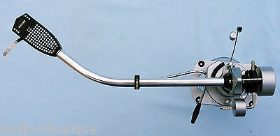

Tonearms, as cylindrical tubes, typically have a first resonant mode at which they become flexible around 200Hz for transverse vibrations, but far far higher than this for torsional vibration. And adding a small stabiliser bar hardly seems plausible to affect this, given the inertia of cartridge mass. Obviously, I'm missing the point..... 🙄
I agree, that seems most likely here.Thus, unequal compliance and damping in the lateral and vertical directions appears likely. In addition, the geometry of the tie wire appears intended to primarily provide vertical support, and will limit vertical compliance.
This is true if the displacement vector is exactly vertical, which probably is nearly true for warps. Otherwise, the headshell path will be some lissajous type path as it settles, especially in the presence of other displacement stimulus that isn't vertical.It seems reasonable to limit vertical compliance in order to raise stylus-arm resonance well above subsonic record warp frequencies.

George: That Shure close up is interesting as the elastomer is only on 2 sides of the inner tube, so relies on being biased by the VTF. Different from the ortofon circular elastomer, but possibly easier to mod...

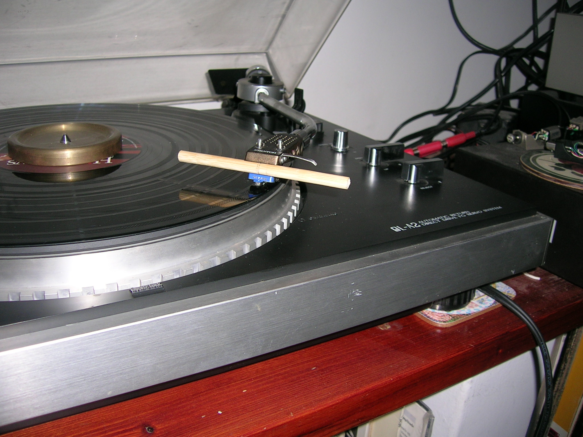

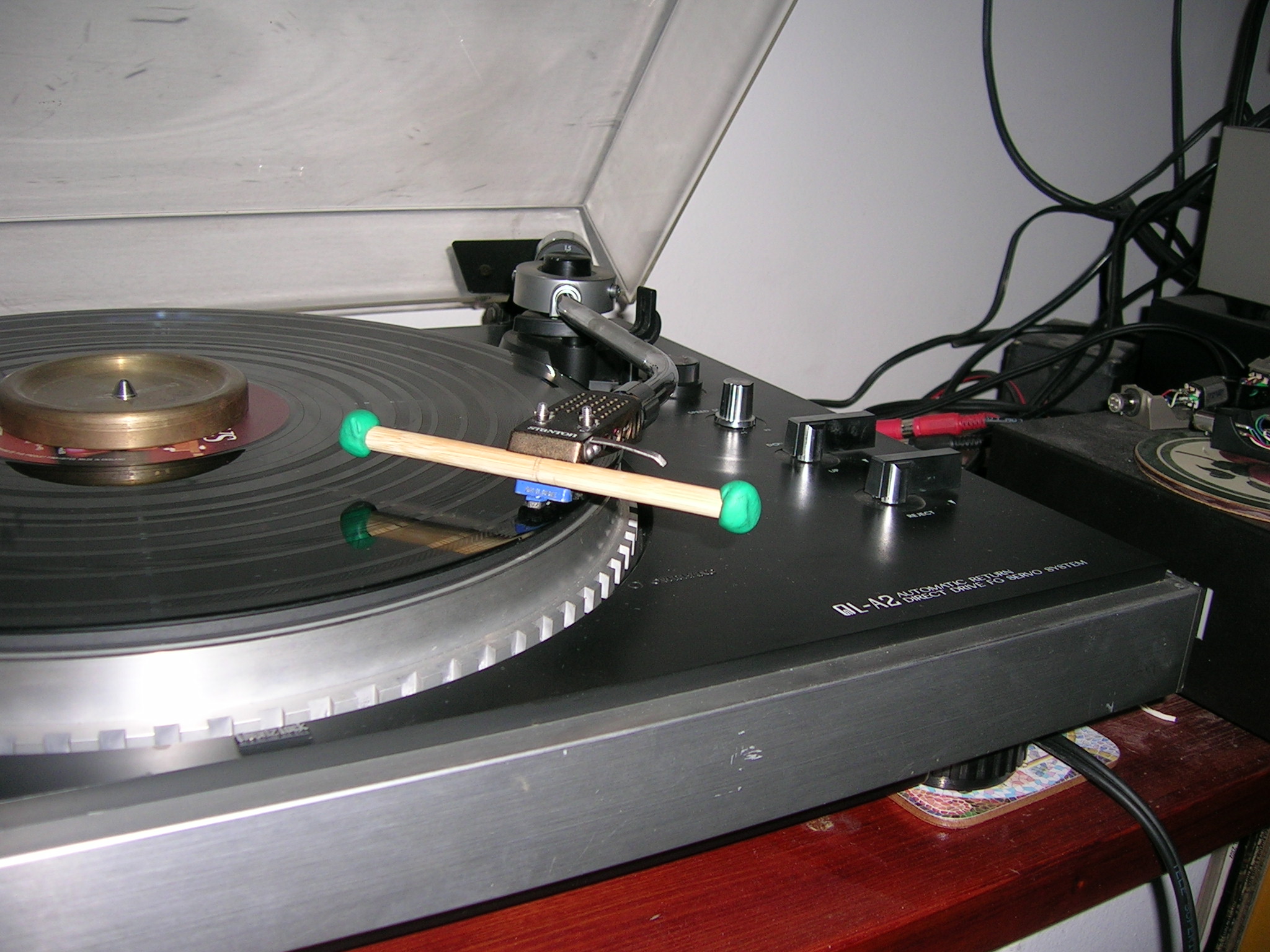

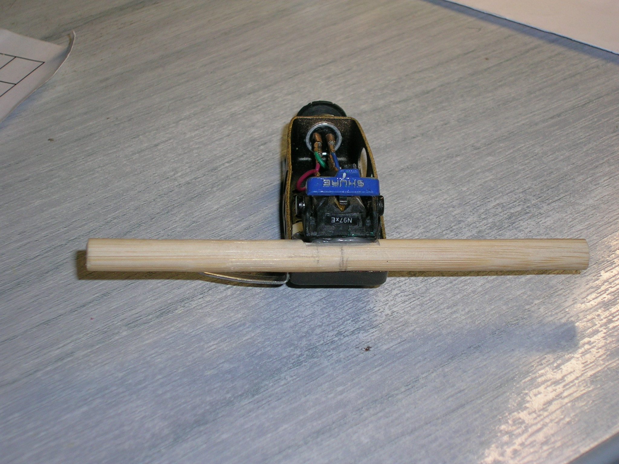

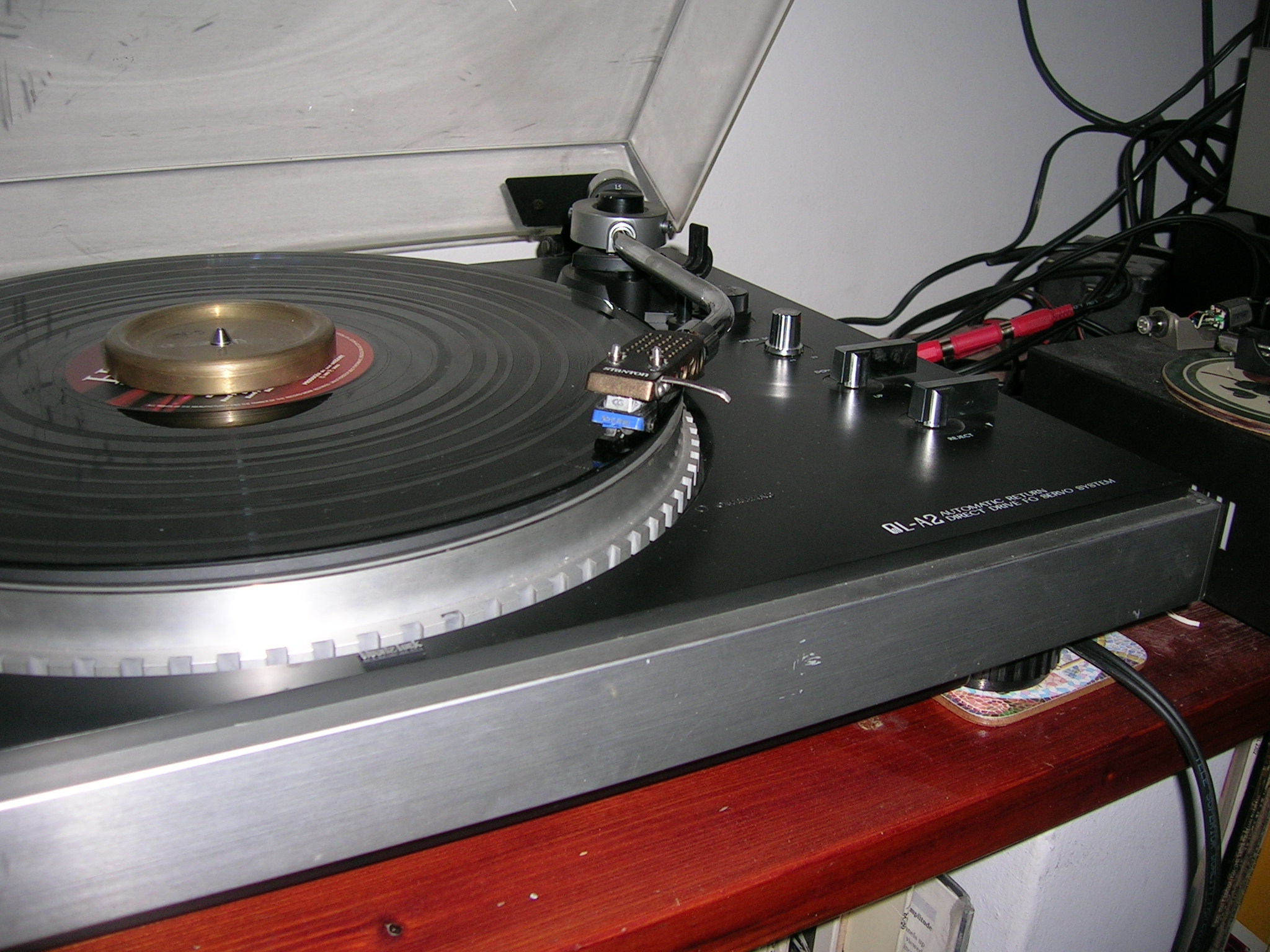

Let’s put it to the test. What does it do in terms of modulation.
JVC QL- A2 with:
1 Shure
2 Shure+longhorn
3 Shure+2.8gr weight (equivalent to the weight of the longhorn bar)
4 Shure+longhorn+2.4gr tip mass (2.4gr added mass positioned to increase roll and yaw moment of inertia)
5 Shure+longhorn+2.4gr center mass (the added mass without the benefit of increasing moment of inertia)
In all configurations, cartridge was reading with 1.5gr VTF (checked)
I haven’t done any listening tests yet with music.
The uploaded files (24b/48kHz) are playbacks of HFN S2 T2 (lateral resonance test) and HFN S2 T3 (vertical resonance test)
https://www.dropbox.com/sh/ik5pq5ghirdxu8x/AABByhfTI8mjVUZwniRWB8m7a?dl=0
File numbering and heading follows the attached pictures 1 to 5 (two files for each picture).
Environmental conditions during recording:
Temp: 32.1 to 32.8d C
Rel. Humidity: 26.3 to 32%
Longhorn reed bar attached to front face of cartridge with fast curing two-part epoxy
Reed bar
Length: 100mm
Diameter: 6.5mm
Weight: 2.8gr
George
Hi Bill
The elastomer is on the four sides but it’s much thicker on the two upper sides.
When the time for dissecting will come, I will check to see if the inner construction is like US 4194744 Figs 10 to 14
