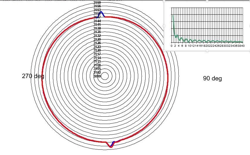

I've attached a virtual TT speed file below - zipped. Since I know exactly what's in it because I made it, it will be interesting to see what your polar plot makes of it. And also to see if I did it right. 🙂
Hi Pano, here's the polar plot for that virtual file.
Looks like a small amount of perfect eccentricity, and a twice per platter very short event that is beyond the display bandwidth of this tool to display properly, but I'd guess either a half sine or step change of duration of a few 10s mS.

Looking at the amplitude spectrum of Pano's virtual TT file, it looks as though there's a realistic strong component at about 6Hz, perhaps intended to mimic the cart-arm resonance. However, this seems not to frequency modulate the 3150Hz test tone, so doesn't show up on the polar plot nor on a classic spectral plot.
Looking at the test tone waveform, that 6Hz component simply seems to be added (summed), and is neither AM nor FM which both requires some multiplicative element. So though it shows up in the classic amplitude spectrum, it doesn't modulate the test tone, whereas a real cart-arm system does. HTH, Pano !
LD
Thanks Lucky, that is exactly right. I made a tone that sweeps back and forth from 3147 to 3153 over 1.8 secs. Tried hard not to get glitches on the turn around, but they still show up in your plot. It's darn sensitive.
About the low tone. It's also a wobble, this time centered around 6Hz. You are correct that is was amplitude summed, I never could get it to frequency modulate the 3150 signal. That's OK, because it lets us know that it won't show up in your plot if it's just mixed in. I'll try again to modulate the 3150 signal at ~6 Hz and we'll see how that plots.
My virtual TT file also had some 60Hz and 41Hz mixed in, and a base of RIAA white noise to simulate surface noise. None of that showed up either. :up:
