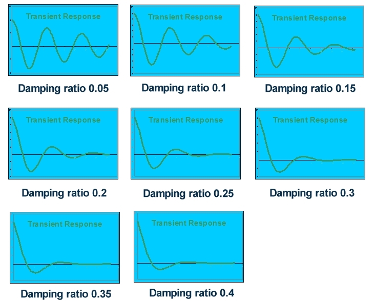

In an otherwise normal healthy and well adjusted rig, the most significant (and audible) contribution to pitch instability is often due to unwanted headshell displacement motion and associated induced FM, IME.
Headshell displacement of only 100um@10Hz, contributes about +/- 0.35% of pitch variation - very audible and about 3 tramlines on the polar plot.
Time domain response to an unwanted headshell displacement from any cause depends on the cart-arm spring/mass/damping system. Then so does pitch variation in the time domain. I think that's the key way to look at this.
Attached is a set of plots showing time domain transient response of pitch variation to a small displacement in headshell position, for various damping ratios. Typical damping ratios in untreated rigs might be between 0.05 and 0.15.
Increasing cart-arm resonant f makes whatever damping there is available go further toward increasing the ratio. Low compliance cartridges also tend to provide more damping, the suspension being the same elastomer providing spring and damping.
There's no mechanical reason to choose exactly 10Hz as a target cart-arm resonant f: it seems some sort of common-lore of vinyl playback. Perhaps it has origin in being audibly better than lower frequencies in terms of pitch stability perception, or some vibrato might even be euphonic......? Or, more likely, maybe it's simply justified by plausible explanation of avoiding stimulus?
However, IMO the common focus on selecting cart-arm combinations based on resonant f alone is a distraction from the real issue of damping ratio - which almost always goes unaddressed and is where most of the performance opportunity lies.
Cart-arm selection is far more significant to pitch stability than motor speed variation in a the vast majority of normal healthy rigs out there, IME. Hence the B&K observation ! In many rigs, design of the cart-arm resonant system provides the best opportunity for improvement to pitch stability.
Counter-intuitive, but true !

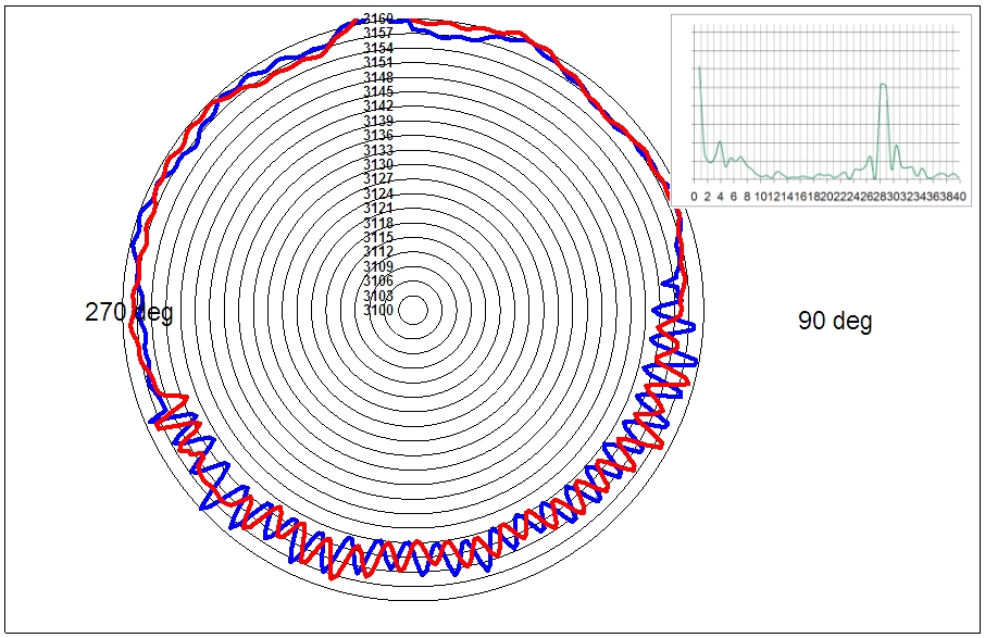

The more times the same pattern appears, the stronger it’s freq component is.
1.8sec frame length is one revolution of the platter.
This way I can locate all the modulating components, i.e. the Cartesian Freq-level inset from Lucky’s analysis.

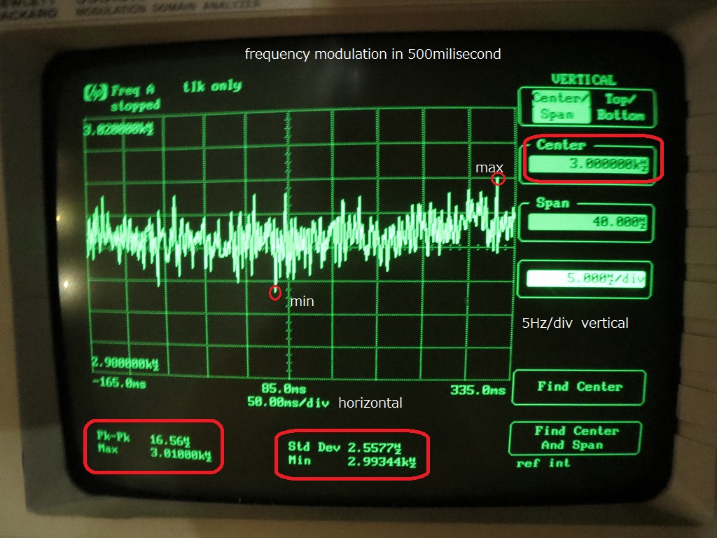

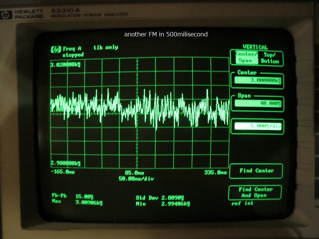

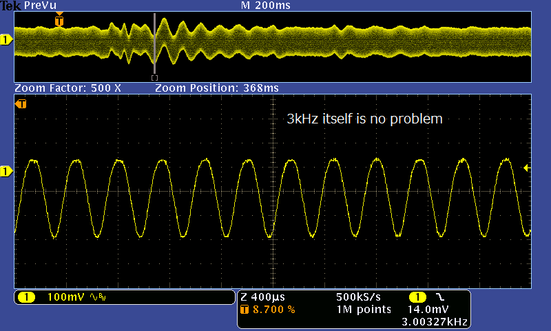

It's very interesting. I have another approach about modulating.HP53310A is modulation domain analyzer which can direcrly display FM.Vertical scale is frequency,horizontal is time.if scope,vertical is amplitude.
3kHz sinewave varies from 3.01k to 2.993k. Pk -Pk is 16.56Hz,almost 0.5%.Std-dev is 2.55Hz, almost 0.1%.I think this is ordinaly.But in practical use,there is some viblation around turntable,loudspeakers and so on.When I walk around the floor near turntable,frequency considerably jump like later 3 photo.
This is not the fault of turntable.Insulator usually has less isolation than one expect.I think digital solution is the best for this.It's better to digitalize record in calm circumstance,no loudspeaker,no walking around.But this is unpopular.😕One says record must be listened from turntable.

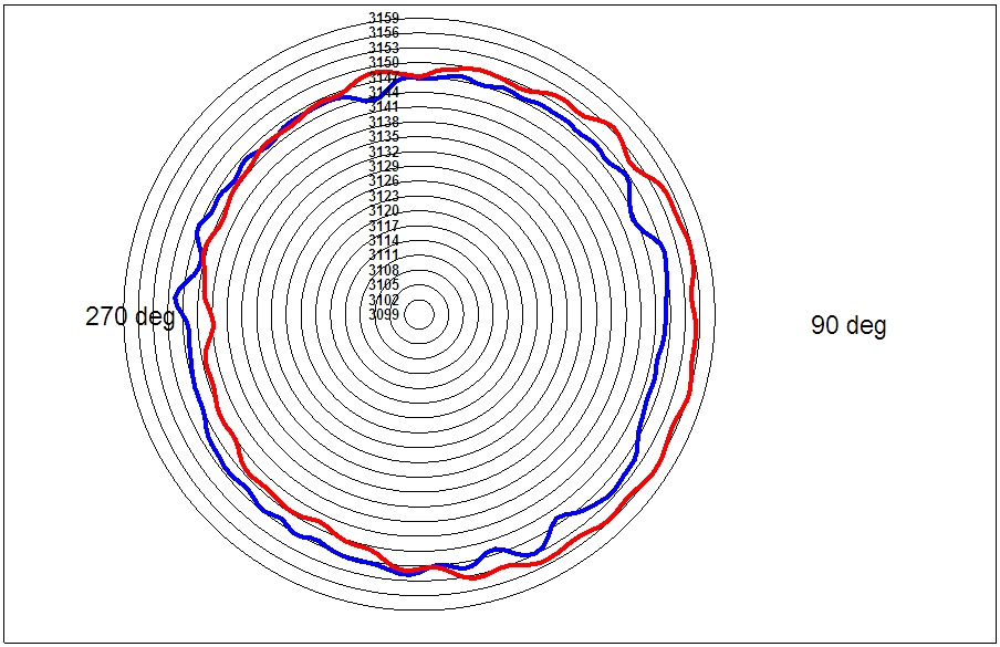

Here's a polar plot pitch stability contest between two well regarded healthy TTs: SL-1200 in red, and SP-10 in blue, displayed on the same chart.
One can see both are very good in the scheme of things, the SL-1200 especially so. In both cases, pitch stability appears to be dominated by record centering, and by cart-arm stability.
I don't have notes of arm/carts used, but I think one can see the principles at issue: it's probably mostly a matter of centering, and settle time following a headshell displacement event.

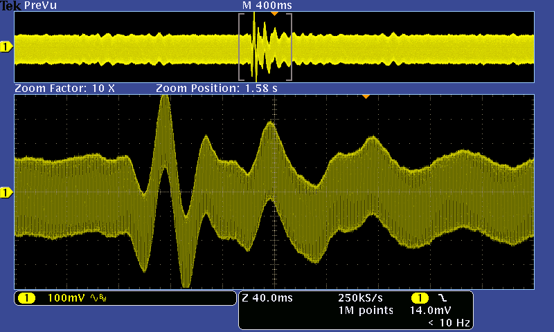

Having said that record centring, levelling, and cart-arm displacement FM typically dominates, many TT drives also have their own FM 'signature' depending on the nature of the drive. Particularly if they need repair or a bit of tlc.
AC synchronous motor cogging can turn up in the frequency range you mention, depending on the number of pole pairs and whether 50 or 60Hz mains. As can idler intermediate mechanics.
For interest, attached is a bad example of a Lenco idler TT with a clear fault that shows up for part of the revolution, at or about that frequency range. But one can see that even for the 'good' part of the revolution, a similar frequency pattern is there albeit at a lower level.
