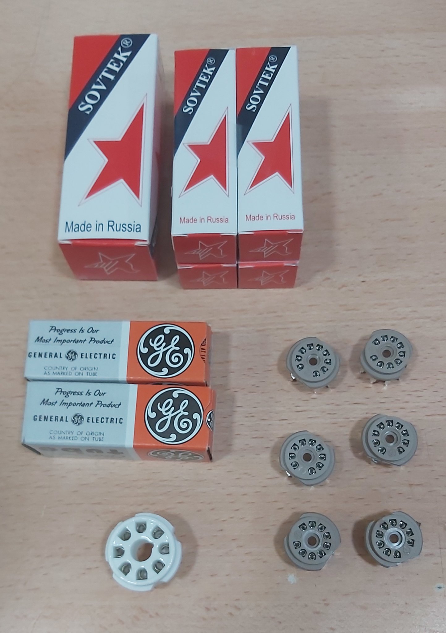

Looking for some advise about fitting the Valve sockets?
My build is to have the Valves displayed and coming through the top cover of a case.
Of course i don't want them to appear like Leaning Towers of Pisa or at different heights.
Yes, the Valves are of course different heights
1x 5AR4
2x ECC81 (12AT7)
4x EL84
So of course i can see there will be an issue getting the Valve sockets level at the same height.
What i was thinking was to fit the 8-pin socket and to make sure it's level.
Then to fit all the 9-pin sockets so that they are all level with each other.
It's virtually impossible for example to have the 6x 9-pin B9A Belton sockets at the same height as the 1x 8-pin Octal socket.
You could place a spacer underneath each socket when you solder it in, so that each socket is the same space above the board. You're probably going to have the board upside down anyway, so use the same spacer for each valve. It could be something like a piece of cardboard or a small wooden or plastic block -- basically anything really.

Managed to view it, jcalvarez, no problems.
With both the 1x 8-pin Octal Socket and 6x 9-pin B9A Belton sockets pushed into the PCB holes, obviously the 9-pin sockets are lower.
Tubelabs says http://tubelab.com/designs/tubelab-spp/manual/sockets/
"If inverted assembly is used we want to have the surfaces of the tube sockets all in the same plane so they will be flush with the top of the mounting plate. Start with the octal socket. It is the tallest socket so it should be inserted into the PC board as far as it will go. The 9 pin miniature sockets will all be spaced slightly off the board so that they will be in line with the octal socket".
With my B9A Belton sockets it almost impossible to get them to the same height as the 8-pin socket, as the 9-pin socket pins just skimmer over the PCB holes, which would be very insecure.
I'm tempted to just fit all the sockets into the PCB allocated holes.
At the same time making sure they are all level avoiding an appearance of Leaning Towers of Pisa Valves (tubes).
Thanks. I have tried this, but the pins of the 9-pin B9A Belton sockets will need to fit through the PCB holes for stability.
This being the case the 6x 9-pin B9A Belton sockets will actually be lower than the 1x 8-pin Octal Socket.
I suppose that as long as the 6x 9-pin B9A Belton sockets, soldered in place, level and stable, that this should be fine??
Clearly not 100% of the 12AT7 and EL84 will be viewable.
I can't see another way out.
I meant just a temporary spacer, to consistently set the height so that you don’t need to press the sockets in the whole way. Certainly they should make good connection, but if there are a few mm between fully inserted and not, then you can use a spacer to make them all a consistent height.
if that’s important. Personally I would notice it for the first 10 minutes and then would forget about it completely.
