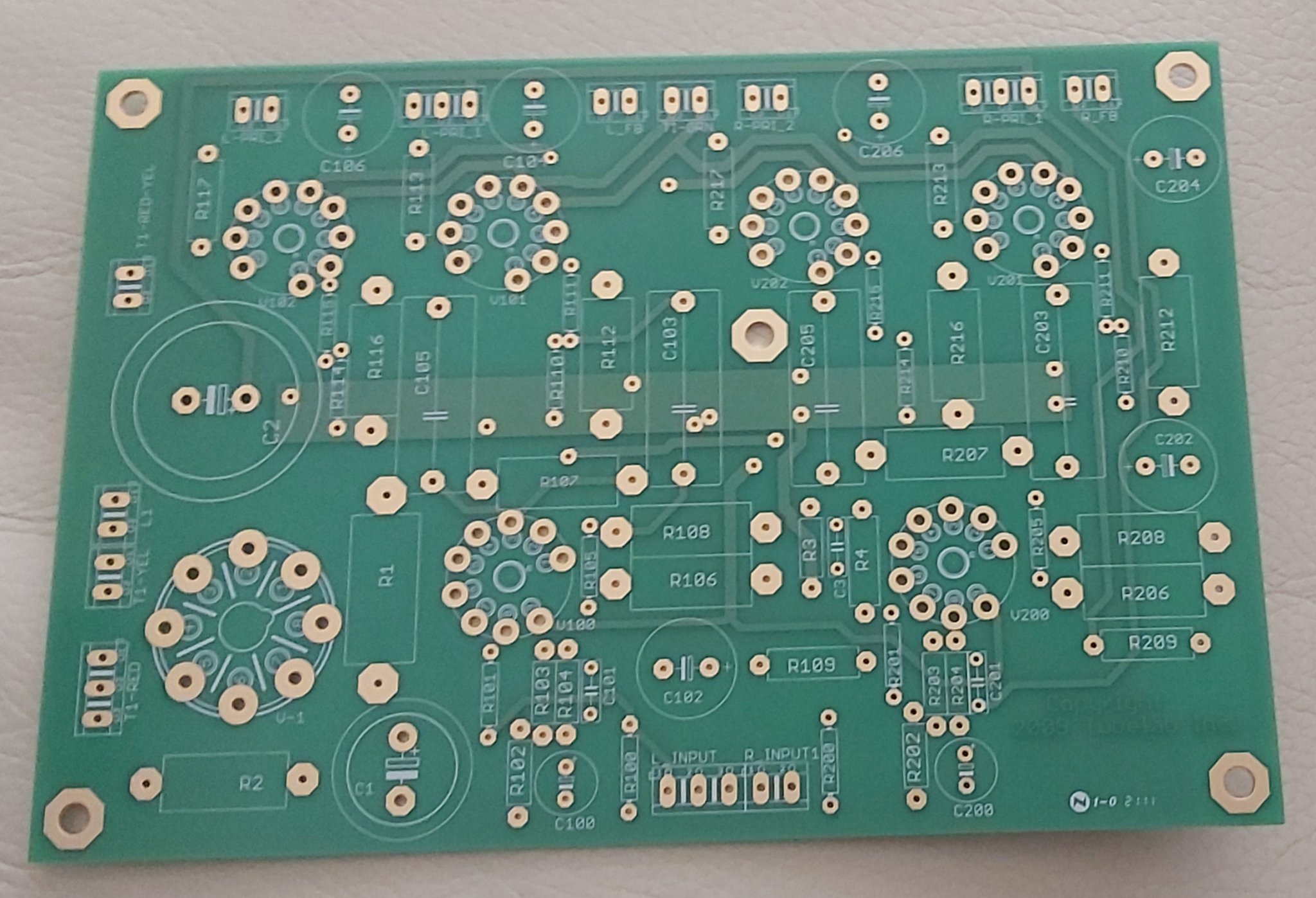

Tubelab SPP first timer build
R104/204 - 5.1K 1/4W metal film:
RNMF14FTC5K10 or
RNMF14FAD5K10 or MBA02040C5101FCT00
R102/202 - 220R 1/4W metal film:
MFR-25FBF52-220R
MFR-25FTE52-220R
RNMF14FTC220R
If 1/4 watt not available go to 1/2 watt.
R106/206 - 75K 3W metal oxide
Try metal film: RR03J75KTB
Diodes won't slow B+, The 5AR4 does that.
In my builds the board is suspended from the case top. I forget the spacers I used, 1/2", 3/4"? Lots of tube sticking through the top. Once you decide on the spacers the 150UF cap, mounted on the bottom side of the board, will determine the interior chassis height you will need.
Cheers, S.
All now placed in 'My List' Digikey. Cheers.
What is the purpose of those HER108 diodes?

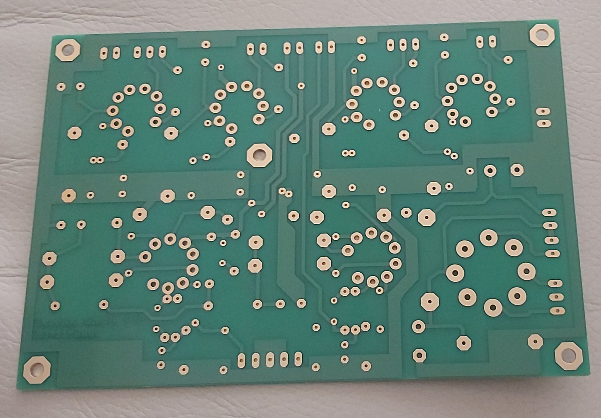

Collected today from the Post Office.
A very proud owner
To determine the optimum value of C101, using 'Silver Mica' is an expensive affair.
I would start with different MLCCs (C0G/NP0) and then replace the correct value with a 'Silver Mica'.
As already mentioned several times, the amplifier will also work without this capacitor.
