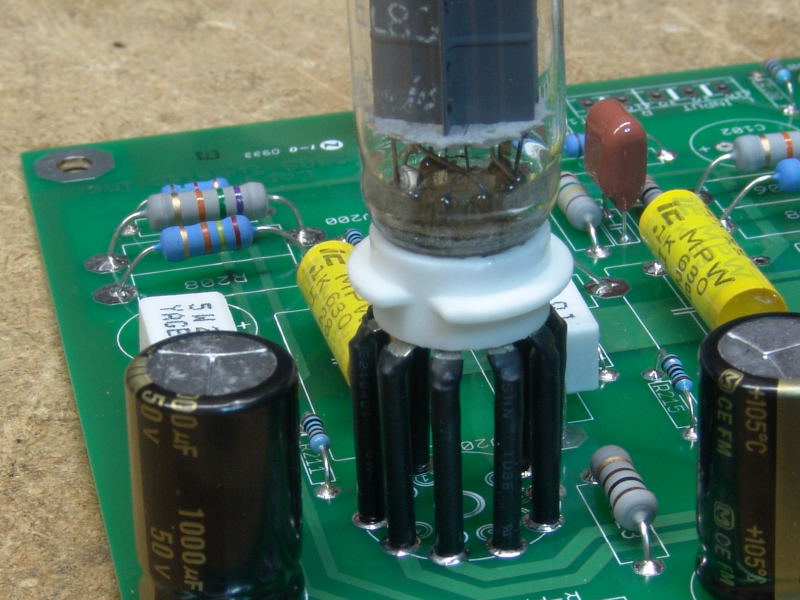

I am thinking of finding a way to elevate the tube sockets from the board.
I have made stilts from brass tubing with heat shrink over it.

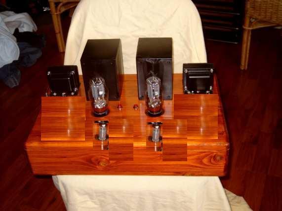

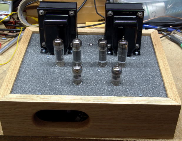

This is a picture of one of my amps that used SS rectification. My main focus here was small size since I have very limited space. I put the two OPT's on the deck and used an Antek toroid for power which is hidden under the deck. The amp will still not be perfectly symmetrical since the driver tubes are offset to keep them away from the rectifier tube.
JohnL

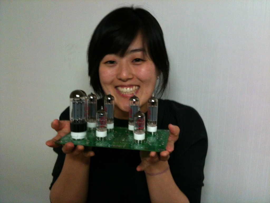

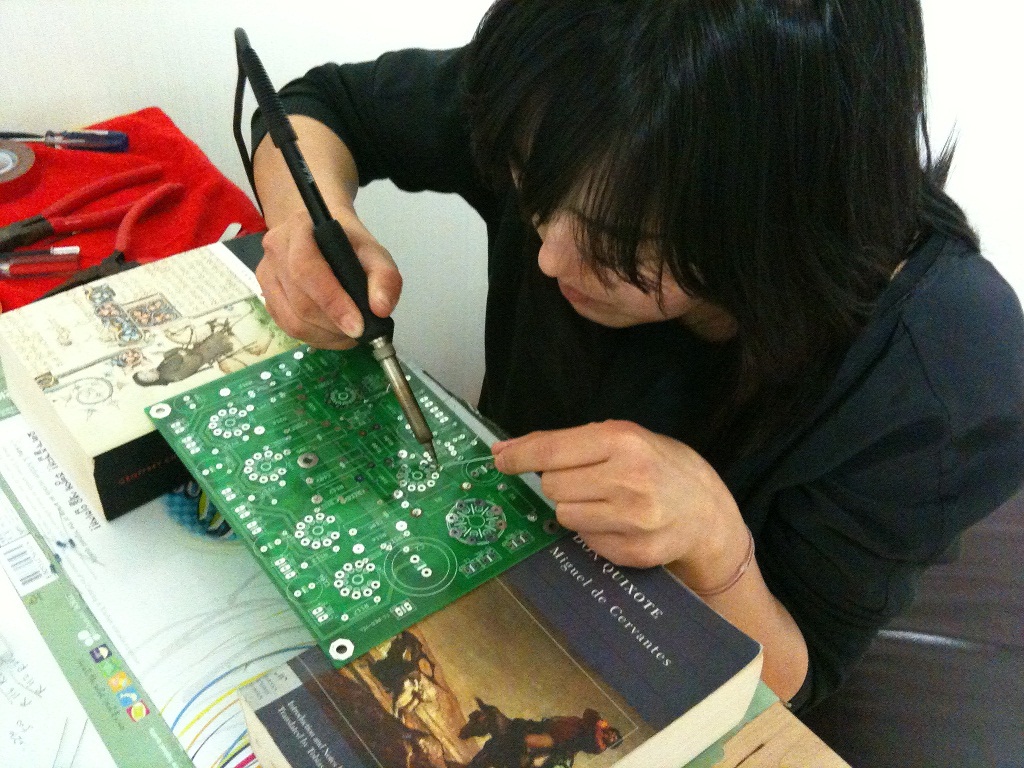

My valentines day present to the lady-friend arrived last week (SPP and parts kit). She got some time with the soldering iron in last weekend and managed to make it as far as the tube sockets (we couldn't resist mounting the tubes for fun... she was pleased).
With any luck, she'll make it over again in the next few days and we'll see if she can make it through the capacitors and terminal blocks (my K12-G crapped out and I have to use some crappy PC speakers until she finishes!). I expect the transformers to show up today.
Since I'm not building this one, all I can do is watch Hitchcock movies and take photos... so that's precisely what I do.

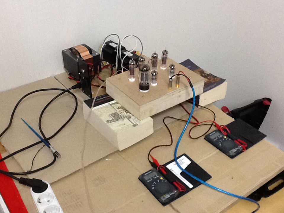

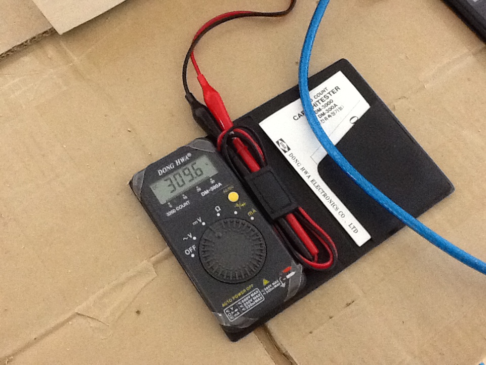

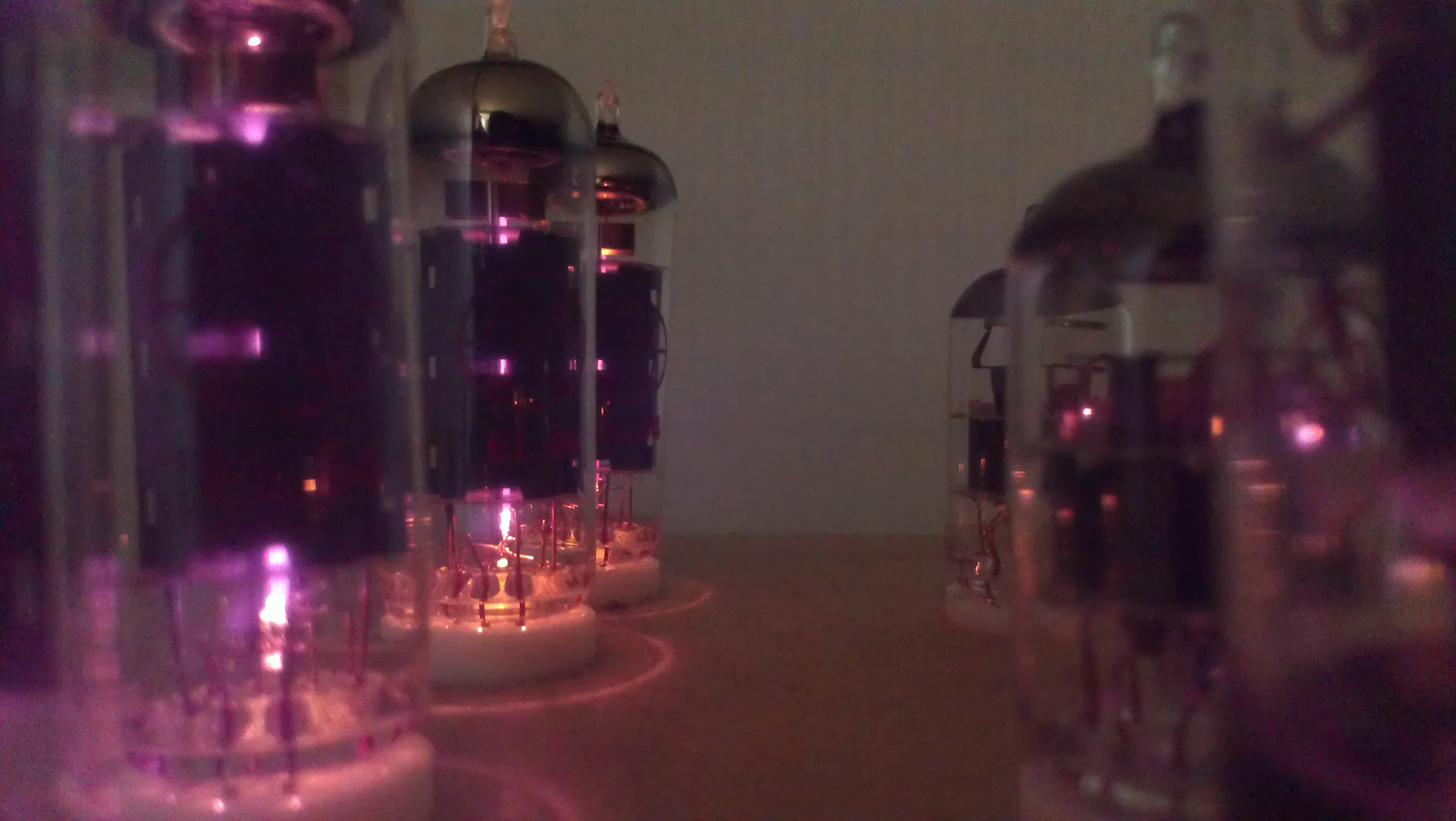

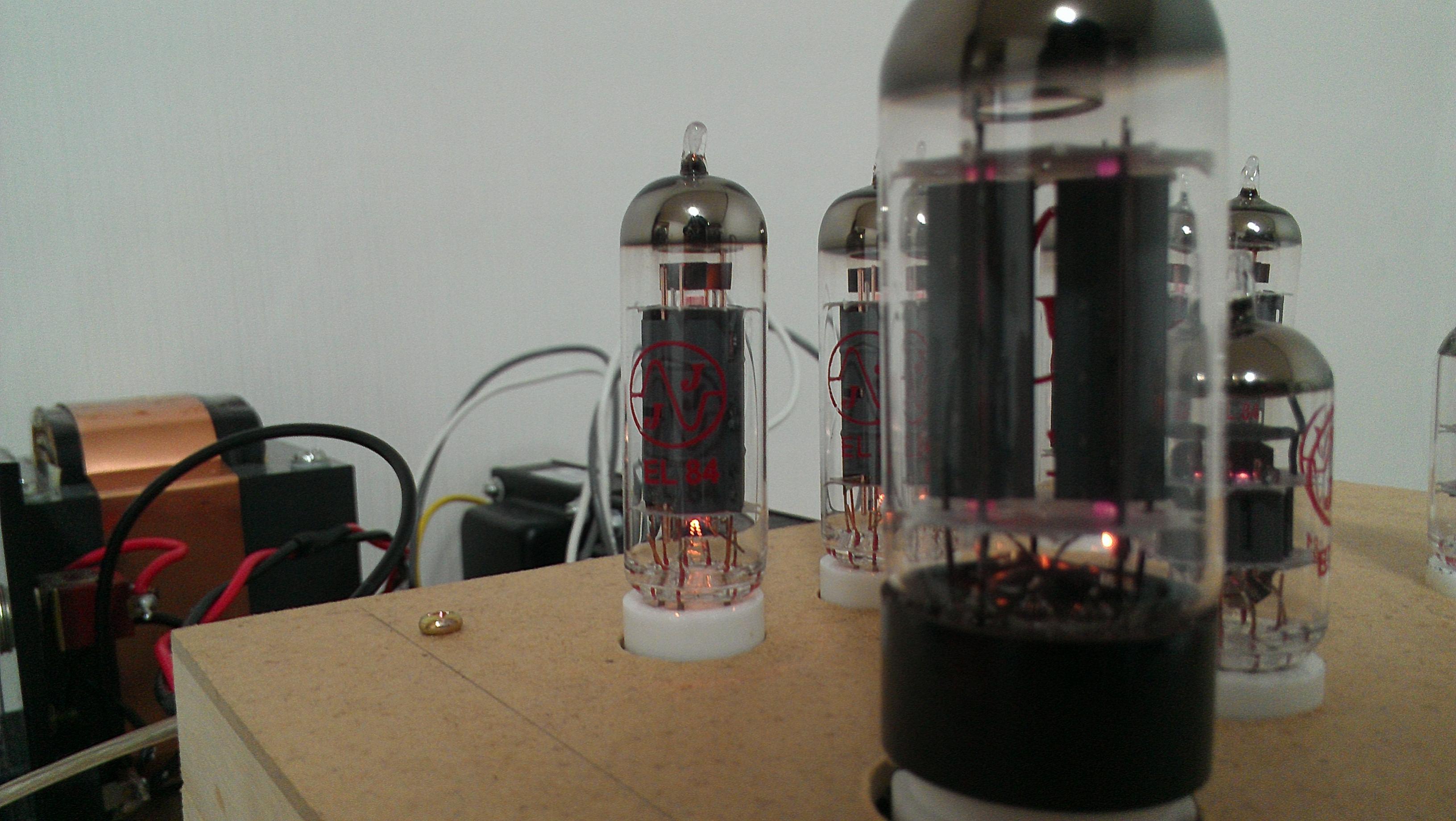

Everything fired up pretty well! B+ is just a breath under 310v. There's a steel case with a full enclosure for the transformers coming up next; it won't see much run-time in that wooden box.
I'll mess around with feedback and UL later on, for now it sounds pretty good. A touch of hum with my head near the speakers, but I'll chase that down later; for now we're smiling and the lady-friend is pleased as all getout.

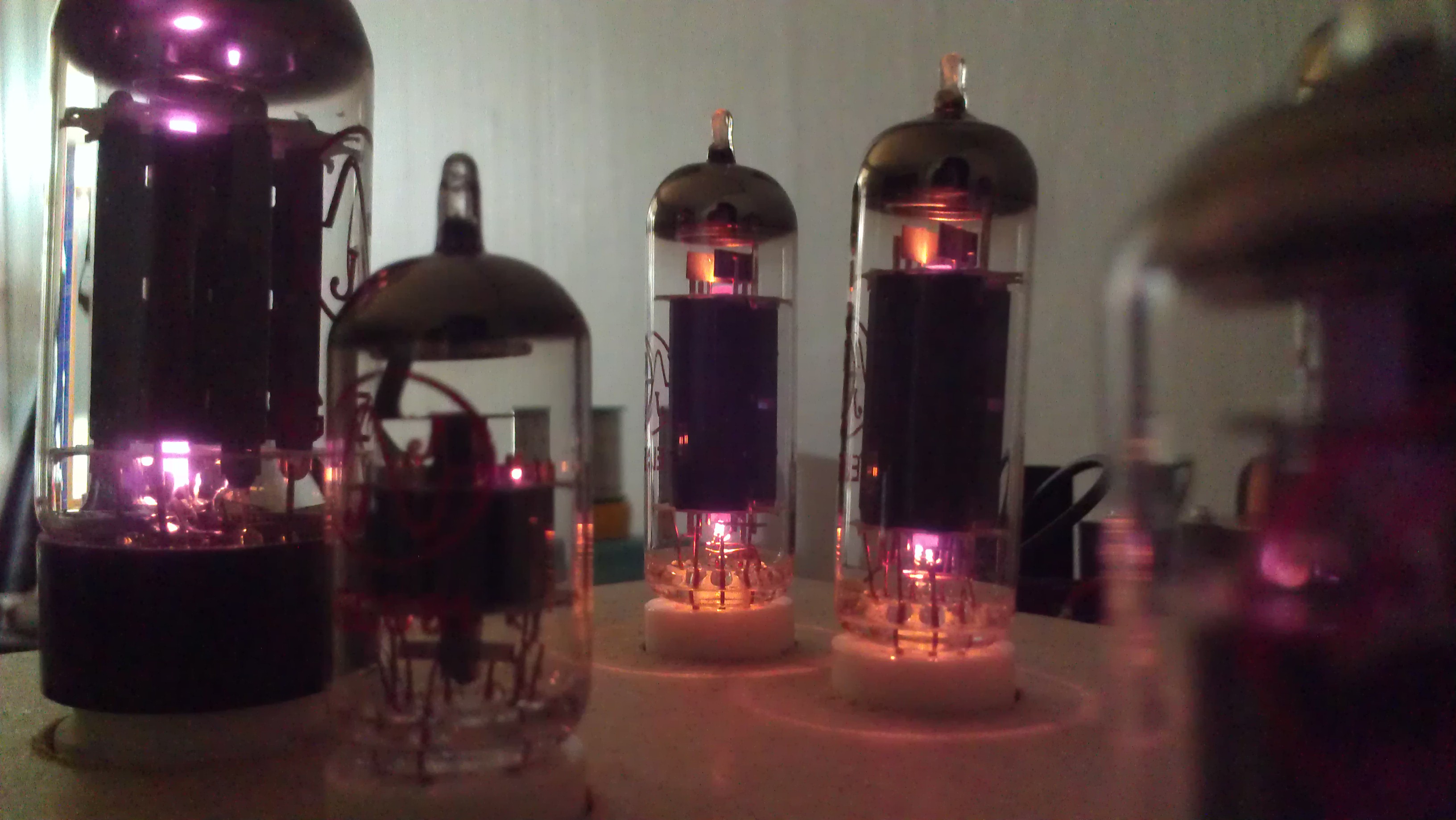

If you want any evidence of how disappointing the cameras on the ipad2 are, look no further than the above two photos. I have two far better cameras (a solid Canon point-and-shoot and a Canon DSLR), but as that line about "the best camera" goes, I use what's next to me. Sue took a few with her way-better camera phone...
