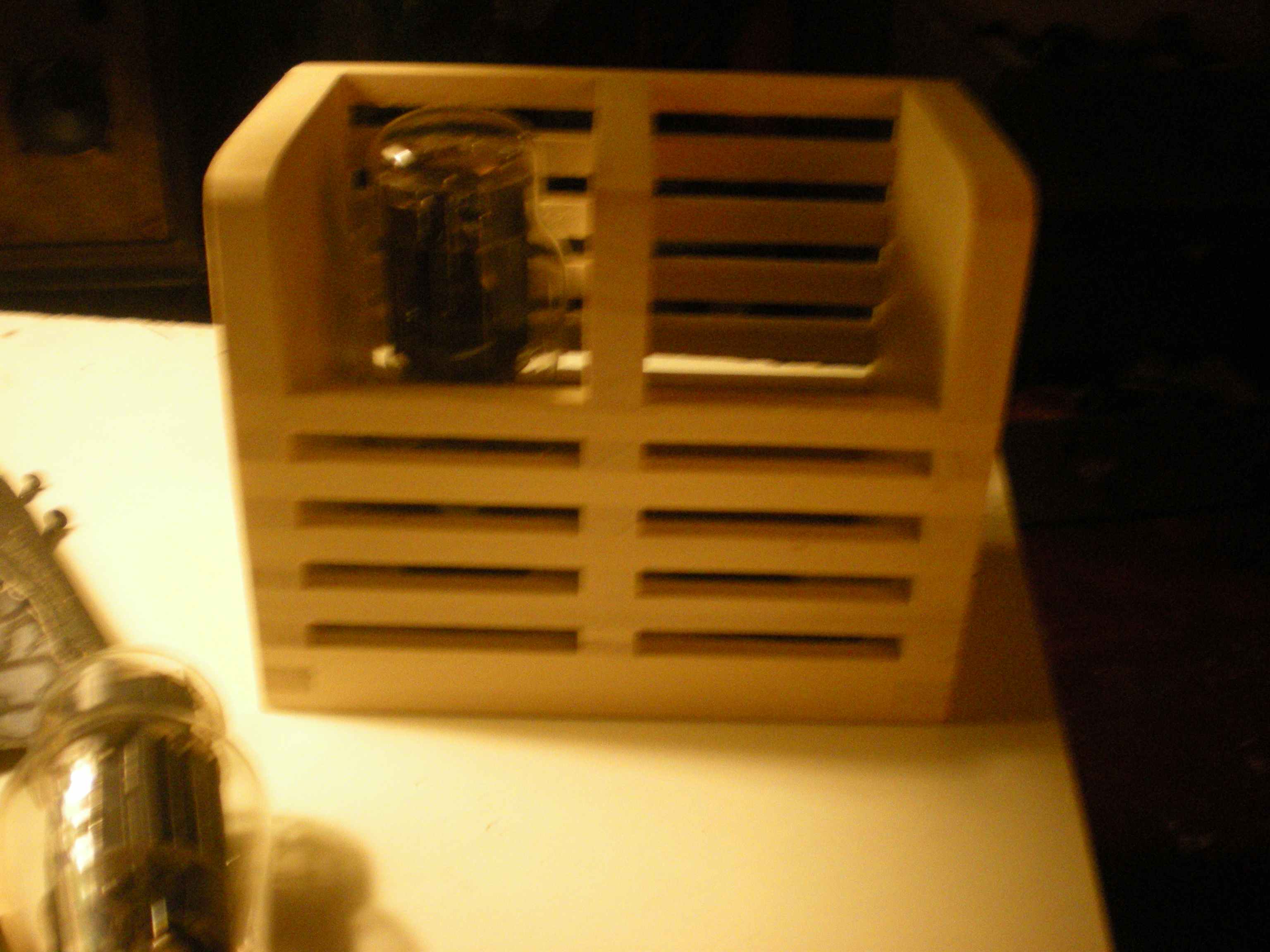

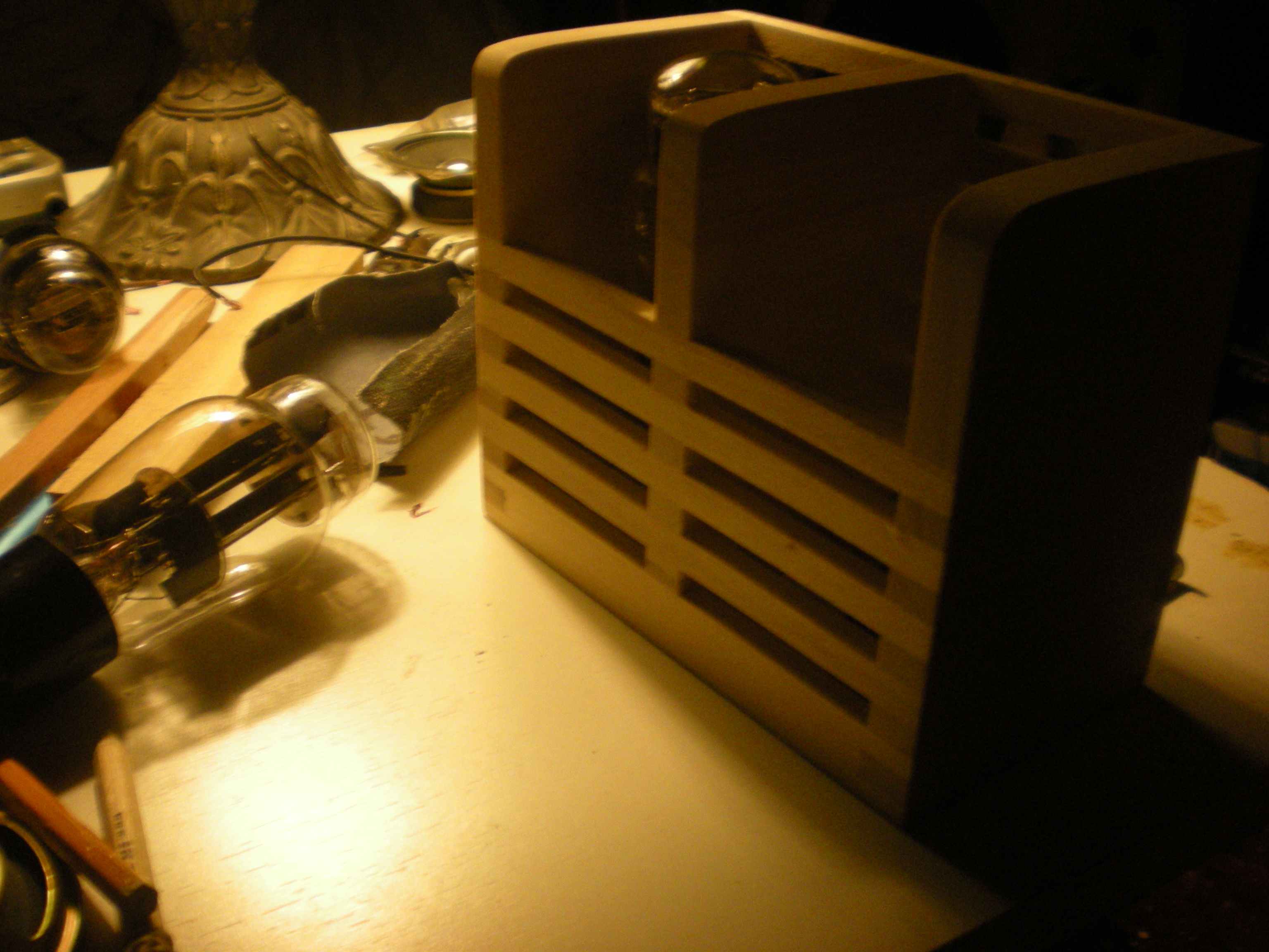

Hi George, I was at Ikea the other day and I bought something that could be used as a tube cage. I'm not sure I will use it yet. It's dirt cheap anyway. Maybe somebody finds this interesting.
