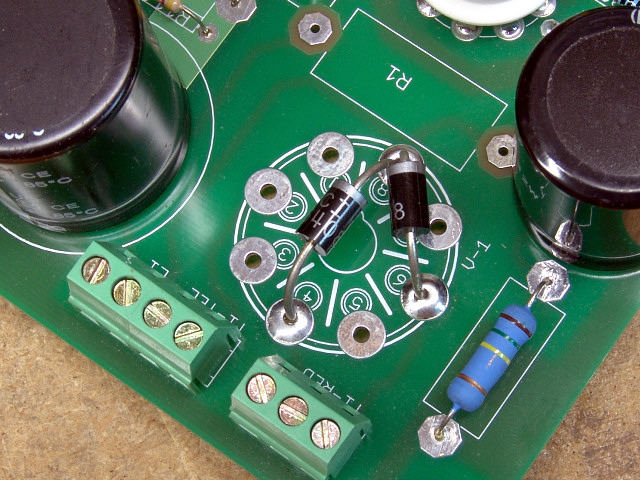

What are you going to use, tube or SS diodes? It mades a big difference. If you use SS diodes alone, the B+ WILL be too high with a 300-0-300vac transformer. Tube rectifiers drop considerable voltage and that drop was anticipated in the design. If you use SS only, you will need to use a power transformer with a lower secondary voltage. Not having tested the amp with SS only, I cannot recomend a voltage value. Moving the rec tube is possible but opens up a can of worms...
If you want to use SS diodes, leave the tube socket off and solder the diodes directly on the PCB without a socket and get a power transformer with a lower secondary voltage. George shows a picture of this configuration in the assembly manual.

Oh. I'll have to think about this a bit more. Where can I put that tube so it looks like it really belongs?
Will there be any real problem with moving the tube sockets around a little bit? Also, I intend to construct transformer covers, which have steel sheet fit inside and soldered in place. That would naturally add magnetic shielding I believe.
Only you can answer that question.Where can I put that tube so it looks like it really belongs?
I think the amp looks just fine the way it is. Long wires with high AC current cause noise in the input section of the amp.
If you are going to relocate the rectifier tube, run the secondary B+ and heater wires to the socket instead of the PCB. Then you can put it where ever you like. If you are going SS, then you need to account for the missing tube drop (about 15-20V).
As far as relocating the other tubes, it should not be a problem provided you keep the leads between the sockets and PCB short and neat. The circuit is pretty stable.

I would keep the 5AR4 for the slow ramp up of the B+ it gives, which George mentioned is very beneficial. You can put it where you want and add the diode mod with UF4007 or better (quieter) for longer rect. tube life. Todays rect. tubes aren't built to as high a quality so this helps take a lot of the load and still get the slow warm up of the 5AR4.

I notice that in George's and Ian's schematics, it calls for PT secondary connections to be to numbers '4' and '6'. I compared it to the rectifier diode mod, which shows the 5AR4 leads going to '5' and '7', and the diodes going to '4' and '6'.
Does this mean the original schematic had the 5U4 in mind?

I believe 5AR4 is what George spec'd. The diodes are put on 5 & 7 as they are unused pins. This saves using a terminal strip.
The diodes have to be in series to the rect. tube as shown.

This how to use SS diodes only.
I remember that picture, but didn't follow the point all that closely before. That's what happens when I am in too much of a hurry. Next time I'll make sure and process it.
I'm going to use the tube though, now that I can bypass the pcb. Setting it in front of, or next to, the power trans is where it should be placed anyway.
