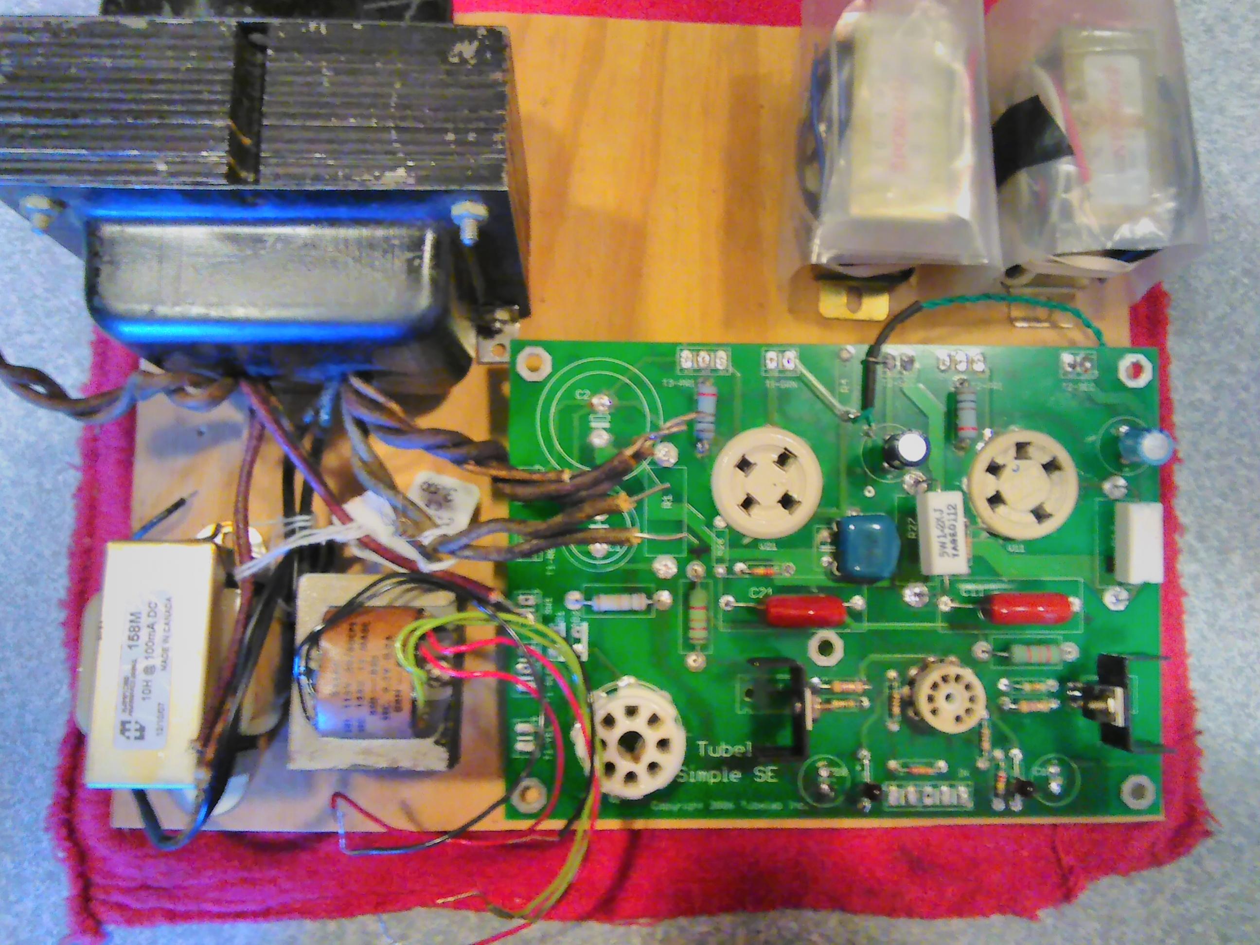

I've been giving some thought to a build out of the now modified ( butchered ) SSE board.
The power transformer I have in mind is a real space hog, but one of the things it has going for it is the inclusion of two 2.5V CT filament windings, it lacks a 6.3V winding, so I only net the elimination of one transformer. It is also 400-0-400, which is way overkill for these small tubes, but should be okay with a choke input, which I prefer, anyway. On the other hand, I've seen at least one circuit running 46's as triodes at 500 volts, so this transformer can accommodate experimenting with higher voltages.
At some point, I need to pick a team, and decide whether or not I want to use 46 and 47, or the more traditional 45 and 2A3. Picking that team has some other consequences - with 45 and 46, there are the extra grids that would allow pentode or ( maybe ) UL operation. I have plenty of tubes available, but am short on decent transformers for anything other than triode / pentode operation.
I have a self imposed constraint that a completed amplifier will have to fit a 12 x 10 chassis, and then fit under the existing cage that I already have for that size chassis. A further constraint is that the chassis height has to be the 2 inch variant, which only allows about 7 inches of vertical height to work within. A globe 46/47 is nominally 5 inches from the bottom of the base, to the top of the globe.
The idea here, which may or may not work, is that once a breadboard is finalized, and a decision is made to complete a usable amplifier, the chassis rear panel can then be precut, and the completed breadboard can simply be dropped into the inverted well of the chassis, and connections made from the prewired breadboard to the typical stuff on a rear panel - IEC, input, speaker, fuse, etc. The mounting holes for the chassis feet, would do double duty securing the breadboard to the bottom of the chassis. This should be rigid, and make the most of the available vertical height. Since all the tight stuff will have been done in advance on the breadboard, final completion should be easy.
I've cut a few breadboards, and have been playing around with parts layout. Smaller OPT's, such as the open frame Edcors, are not that big a problem. Larger ones, such as the Transcendars, which are vastly better performers, are tougher.

Mule 2

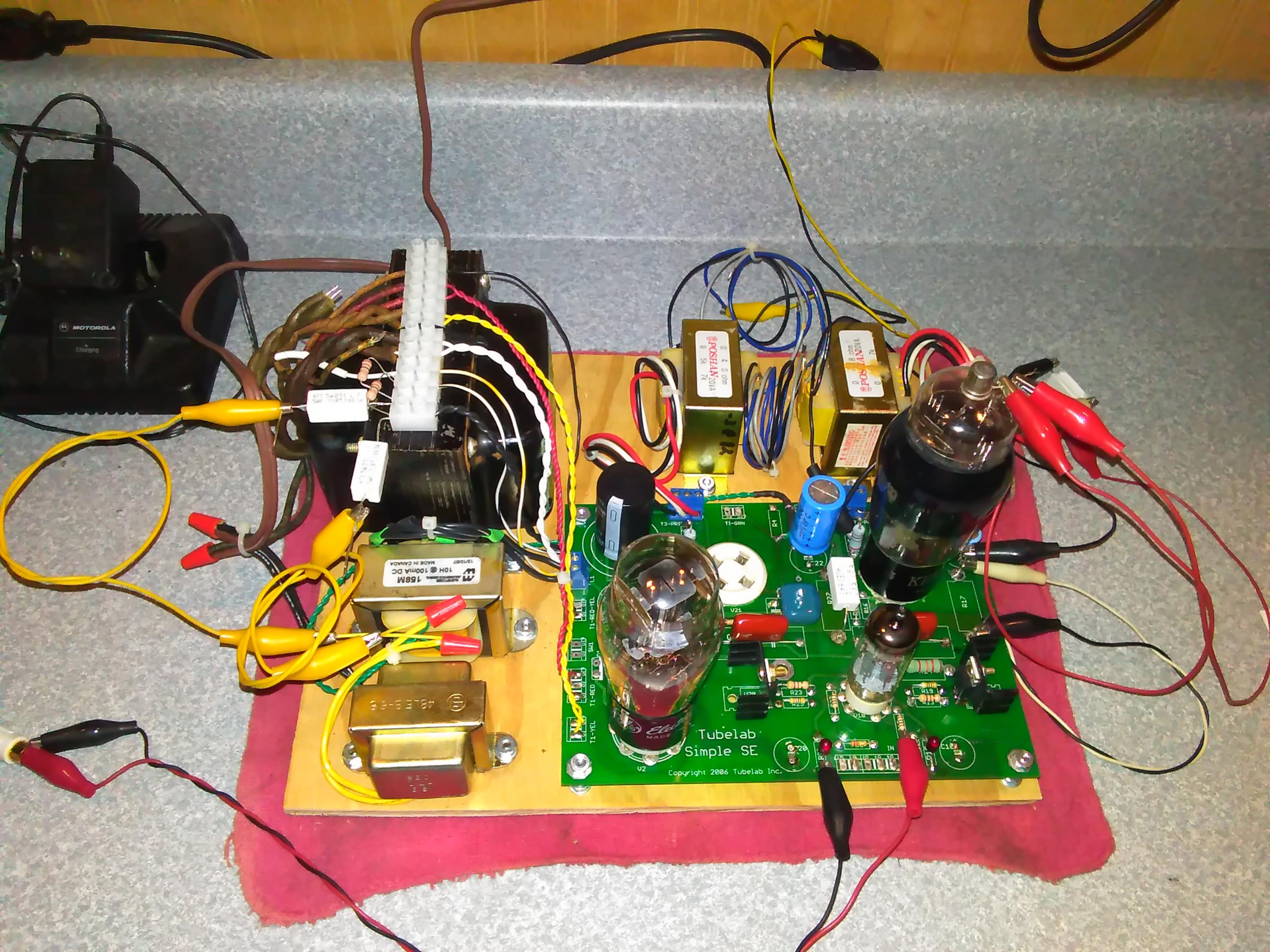

Mule 2, a directly heated SSE, is now up and running in breadboard form. I ran it about four hours continuously last night without any issues.
It's pretty barebones right now - LC power supply, 10 H Hammond choke, and a 220 uF cap. P-K voltage is 287; - 54 on the 45 grid, 13 watts Pd. 1200 ohm cathode resistor on the CT of the heater - it's a 5 watt type dissipating 2.5 watts, so it gets pretty hot; it's well above the board so hopefully will be OK. The bypass cap is 100 uF, I think, 35 volts, so we'll see how long that lasts before blowout. 5W4GT rectifier.
edit: I ran these numbers into SE Amp Cad, with a 7K load, and it predicts 2.1 % second harmonic, and 0.1% third harmonic, 970 mw output, IIRC. I think 5K increased second harmonic to about 2.8%. As of now, I have no means to actually measure THD.
The OPT's are a couple of cheapo's 5 and 7K primary; 4 and 8 ohm secondary. I expect these to be poor performers, but they should be uniformly poor for all types.
Other than checking some voltages, I haven't taken any measurements, yet.
Hum - surprisingly, not much. I have to put my ear up against the test speaker to hear any, and it's very low, at that. I have no idea what the sensitivity of the test speaker is. It's a 4 inch full range in a small cabinet, from decades before sensitivity interested me.
The filament supply for the 12AT7 is unchanged from stock, it's AC and floated as a normal SSE would be. The power tubes are at AC, with no hum balance pot. The open frame OPT's are in the plane of the field ( if any ) of the PT instead of the normal 90 degree cross. The filter cap is pretty small. Since I can hear the hum, I should be able to measure it, and then determine what difference, if any, adding a hum pot, bigger filter cap, reorienting the OPT's, etc., makes, if any. It may be an inconsequential amount, as is.
I still haven't picked a team, and am not really in any hurry to do so. Subject to change, but I thought I would try to characterize all of the small tubes, 45, 46, 47, 2A3 under varying conditions on the modified board, maybe 307A, and then with some data to make an informed choice, I'll probably toss a coin, or something, to decide on a tube for an actual build out, if I go that far. I don't need another amp.
It should be pretty easy to get in and out of the board with the barrier strips for the OPTS on the board, and the terminal blocks for OPT's, so hopefully this will be a useful mule for test purposes.
Fixed bias will be added later. I'm less sure about putting dc on the 12AT7 - I doubt that would make much difference. I am still interested in making some MOSFET modules to sit in the coupling cap position. By that point, it's starting to approach the complexity of the TSE, which defeats the whole point of modifying the SSE to make a simple DHT or dh UL or pentode amp.

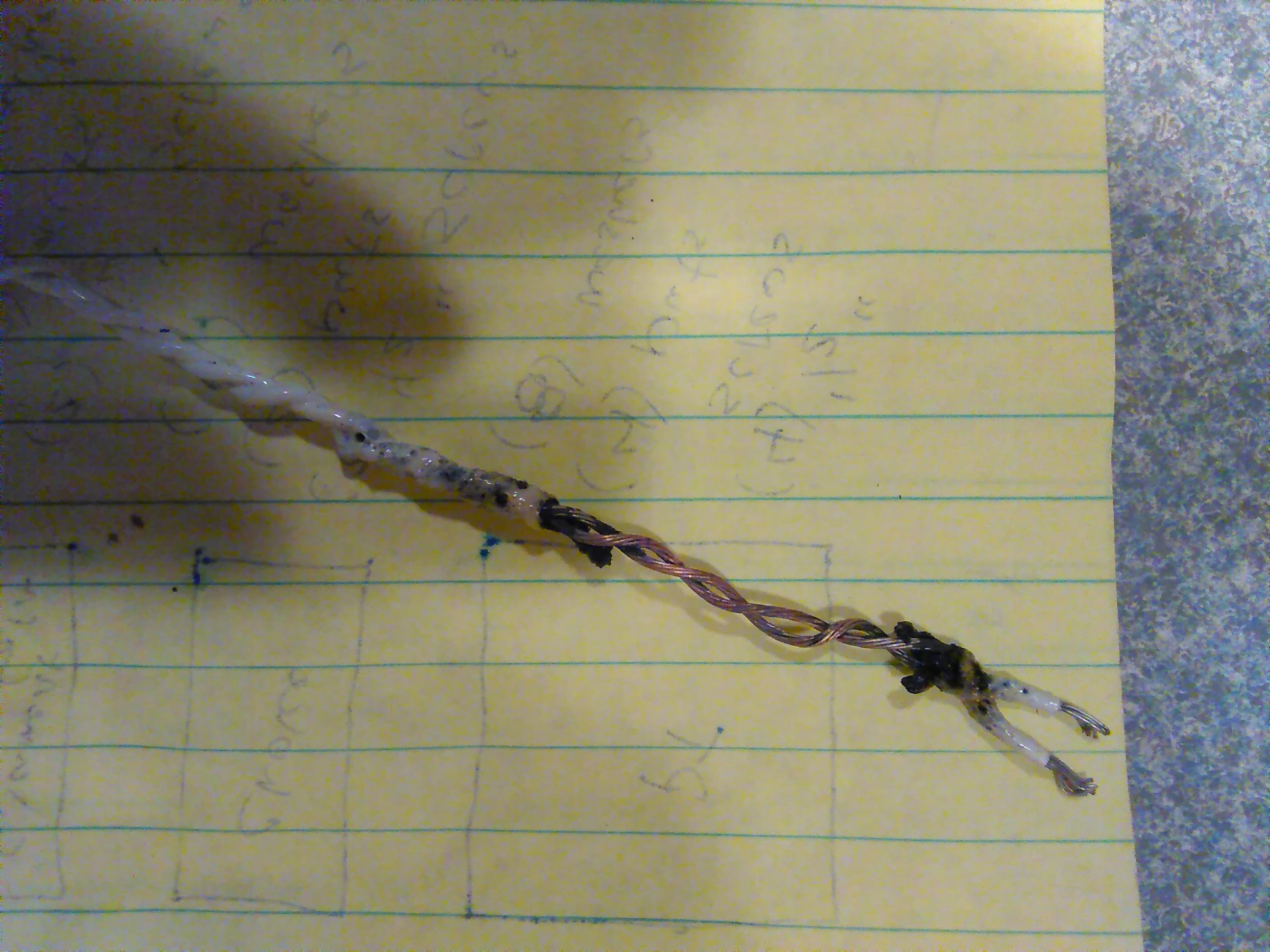

.... The bypass cap is 100 uF, I think, 35 volts, so we'll see how long that lasts before blowout. ....
About five hours.

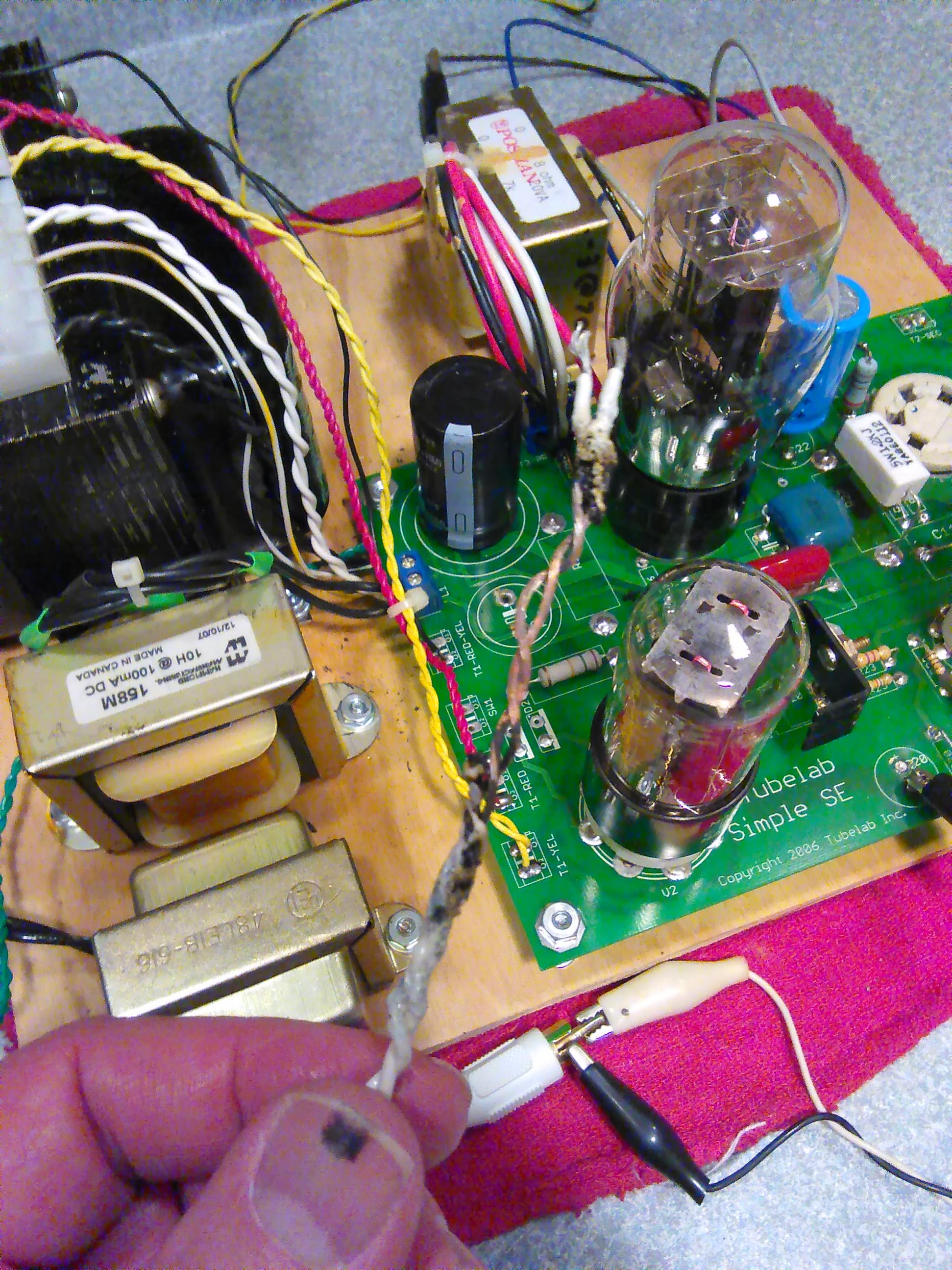

But, that wasn't the real excitement - after changing the cap, on first power up, the twisted pair going to the filament went up in smoke. Literally. The wire is teflon insulated, so it didn't catch on fire, but within a second, it was dripping big globs of molten teflon, smoking like Hades, and the exposed wire was lit up like an incandescent lamp. Hard to tell from the pictures, but that remaining teflon insulation is fused together into one solid piece, all the way to the end of the run. The little black freckles on the breadboard are flecks of charred insulation.
That secondary is capable of 15 (!) amps, and it put all of that and then some into that wire.
Spectacular.
Absolutely no idea what caused this - no remaining evidence. Cut another pair, installed it, checked resistances, powered it up, and it worked fine. I did have the first pair twisted pretty tight, maybe 4-4.25 turns/inch. I relaxed the replacement a bit in an abundance of caution, but, that's really just a guess.

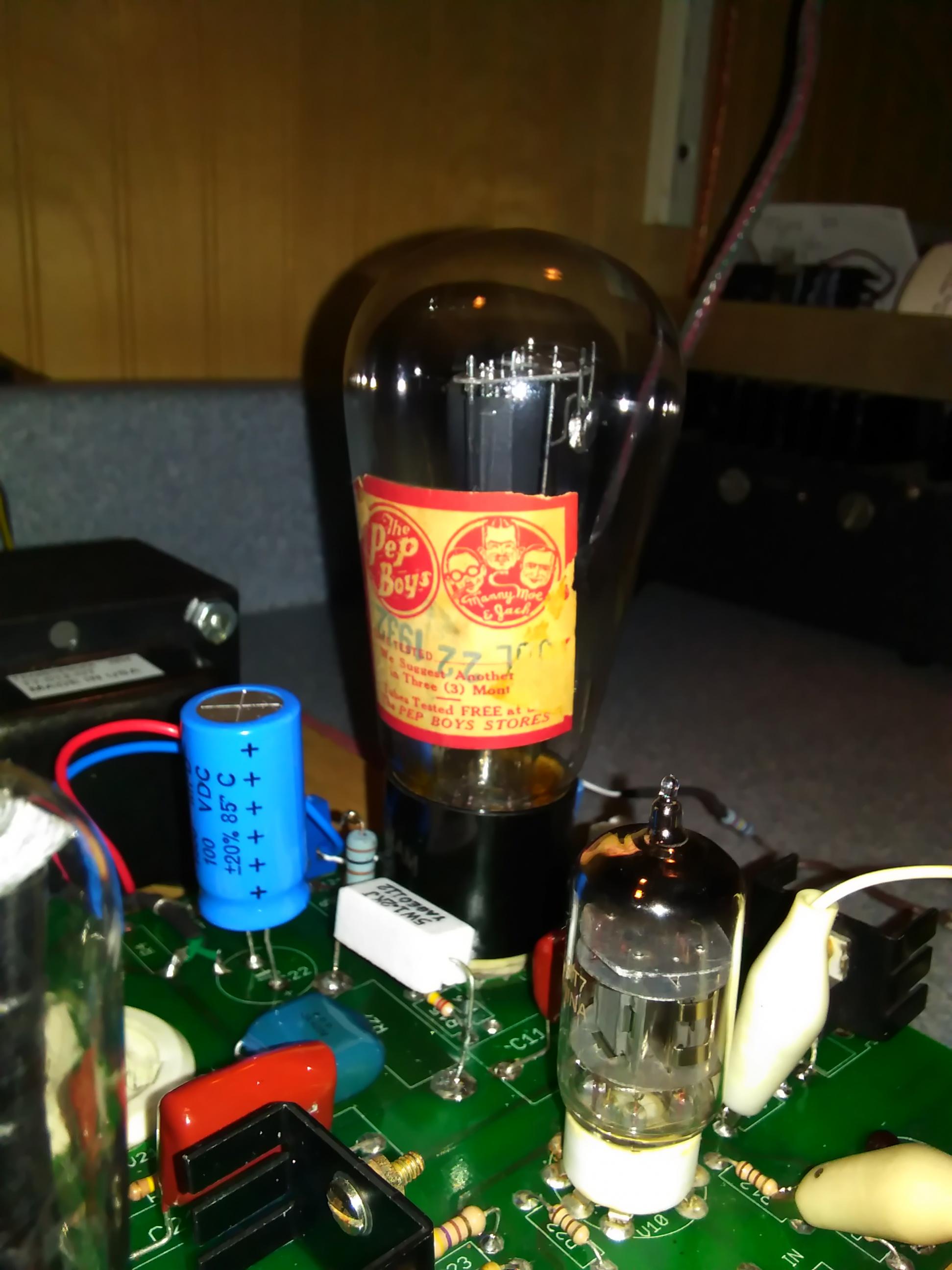

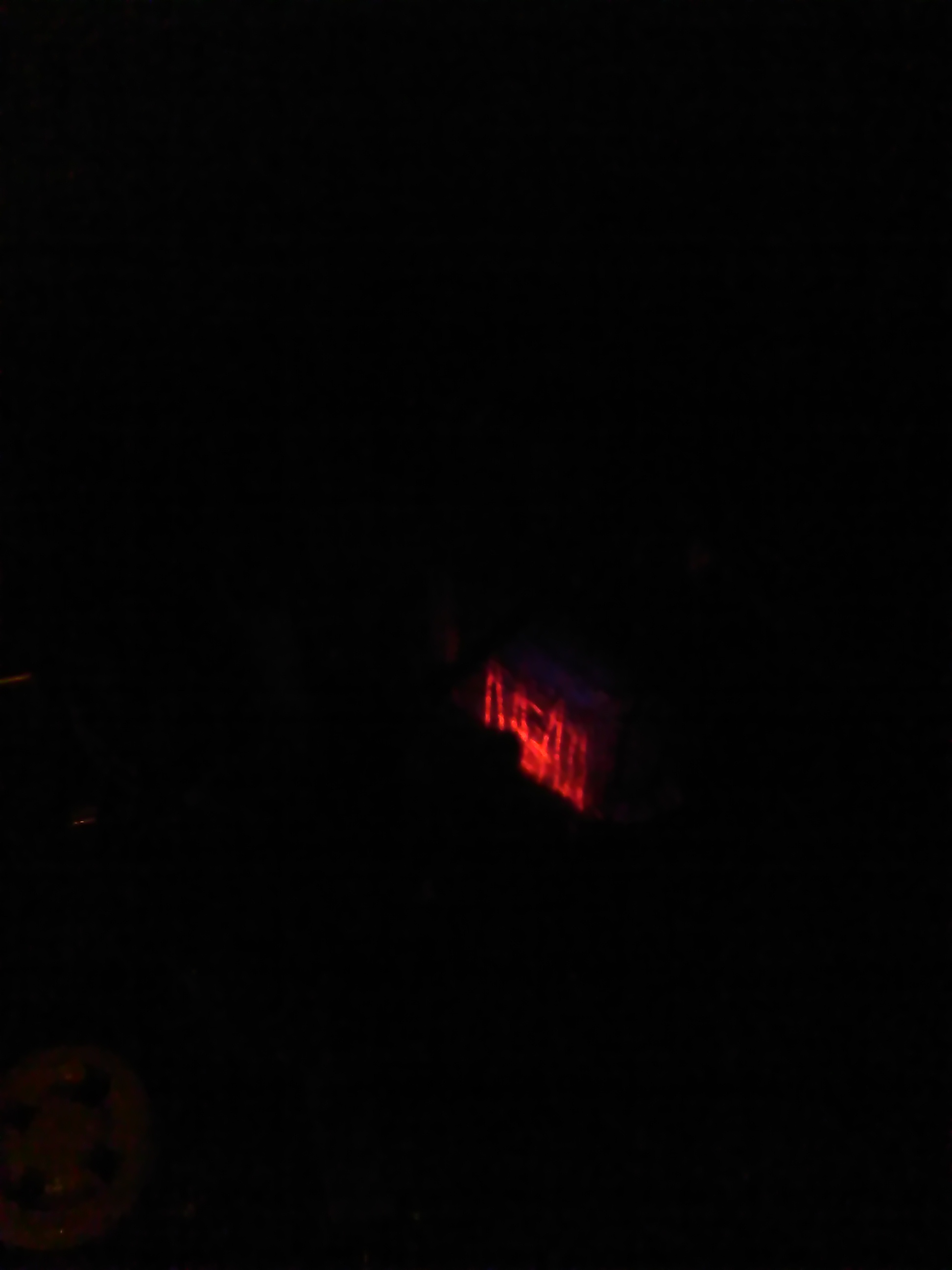

Type 47 in Pentode already looks to be an excellent choice for a directly heated SSE. The white clip lead is for a temporary plate to plate (Schade) local feedback loop. Oft criticized, nevertheless, it works quite well here, as it did in prior iterations of this board running 6146B, 6CD6, and other types in pentode.
With a 5K Transcendar OPT, the first iteration of this showed less than 1% SMPTE IMD at normal listening levels with high sensitivity speakers, about 3% at 500 mw, and about 7.5% at 1 watt. I didn't check it for power output, but I expect better than 2 watts clean sine wave. The high gain of the 47 is useful here. I could build an amp straight from this without changing a thing, and be well pleased with it. It sounded excellent on the test speaker - clean when it needed to be, raucous when necessary.

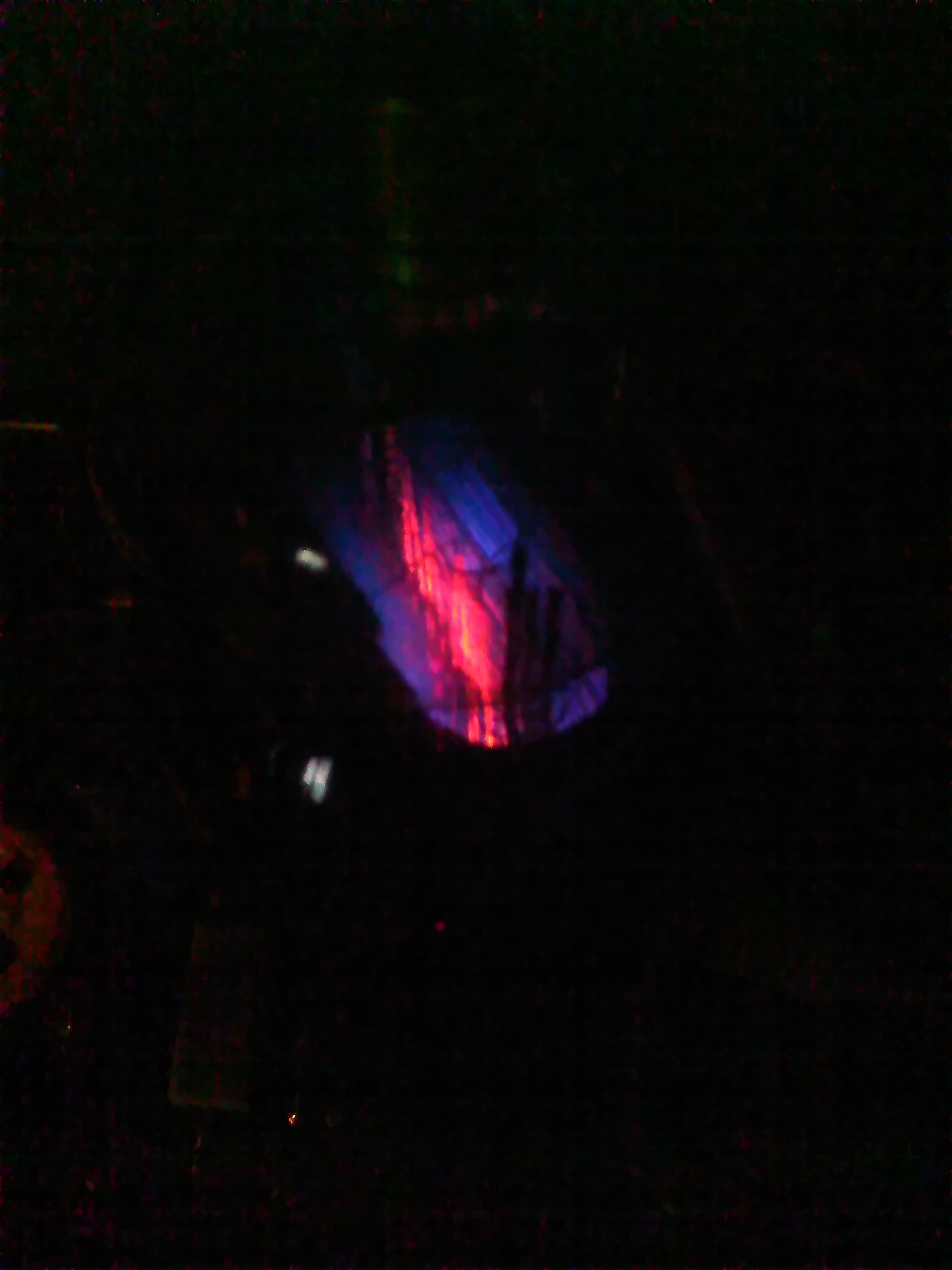

The picture does not show, but in the dark, the whole bulb of this 47 is bathed in blue glow. The 47 data sheet even mentions this is not a defect, so perhaps there is some peculiar characteristic of 47 that causes this. I'm totally OK with that.
I've abandoned those dual impedance transformers - they're just terrible. Useful as test transformers to get something working, but not much else. I don't think any data that comes from them will be useful in any way. They were represented as single ended, but I doubt they have an air gap. Maybe they can be used as chokes, or maybe at very low plate currents, or maybe they can be disassembled to try to make a gap, or paper weights here at the office; but they ain't useful for this test mule.

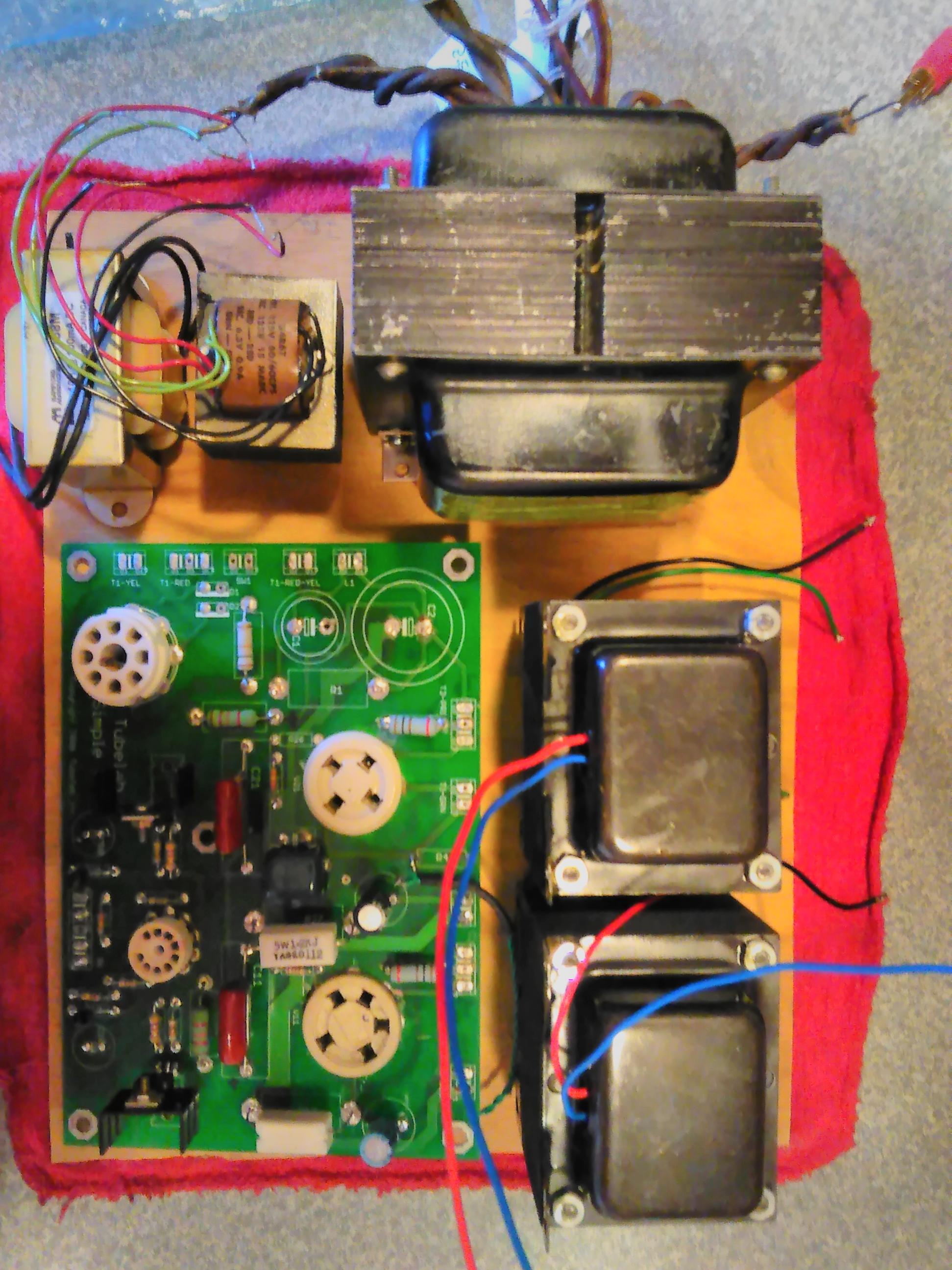

Some slight forward movement on this.
I pulled the Edcor XSE15 5K transformers from the CR SSE, and replaced them with a pair of teensy Merit A 2930's, to have a UL transformer available to experiment with for this endeavor.
Using the Edcor here runs into the same problem it faces on the CR SSE ( and shared with the dual impedance OPT's I was using ) and that is the limited low frequency response of the Edcor just performs abysmally on a two tone IMD setup, where the bottom tone is 60 Hz. You can band aid over that by forcing lots of current through it, but that is a non option with these little tubes ( although, I did try it - and it worked, (Yes you can stuff thirty watts through a 46. And no, it didn't seem to care. ) ), might be with 2A3 where the currents are ordinarily higher.
So, in the interest of progress, and basic fairness to the inexpensive OPT's, I have decided the best alternative is to just cheat, and use a non standard tone frequency for the low frequency tone. haven't decided on the frequency yet, but 100 to 120 Hz seems to be okay for the low frequency with both OPT's.
I've tried every combination of taps, in phase and out, of the dual impedance transformer with the 46, and know what works there and what doesn't, so that is the starting point, then I'll move on to the Edcor, and repeat for the 47. Then 45 and 2A3. Maybe 307A. At least that's the plan. With the basketball tournament and spring stuff coming up, progress could be slow, unfortunately.

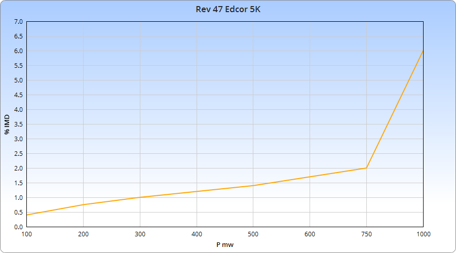

Played around tonight with 47 and both transformers, the Edcor and dual primary.
Lost a 10M45 on the 5 pin side, but not in the usual way - instead of failing to a dead short, it began oscillating. The LED bias revealed this straight away - the LED was too bright on that side. The current set resistor measured correct. I checked the 1K suppressor in circuit, and it read low, about 700 ohms. I lifted a leg, and it measured correct, so I replaced the 10M45, but not before taking a few measurements on the oscillating side - plate voltage was about double what it should be, and the 10M45 and tube were way high in temperature. Cathode voltage was about 0.4 volts higher than nominal.
I've spent the last few days skimming material on partial triode, distributed load, ultra linear - whatever one wants to call it, notably the 1955 articles by F. Langford-Smith and Chesterman, and that zombie thread on distributed load in the main forum, that has just jumped back to life.
Langford-Smith refers to per cent impedance in his work, while it seems like the current transformer makers refer to per cent of turns. I think the former is more useful. Referencing per cent impedance, the 5K tap on the dual impedance transformer provides a 77% distributed load when the 5K tap is wired to a grid, and 29% when wired backwards. The Edcor spec on the XSE 15 simply says 40%, which if per cent of turns, is 16% distributed load if my arithmetic is correct. L-S's paper is good reading, but the bottom line is we're pretty well stuck with what the manufacturers offer, so it's mostly academic. The Merit A-3130 PP Opt's with the 10% tertiary winding look to be a bit of an odd bird. I think they are likely PA OPT's but L-S suggests 5% is optimum for that application, while they are less than what is suggested for optimum fidelity. They might work very well for PP 6V6, though. I got them for 6146 and sweep tubes, and they may work well enough for that. Time will eventually tell.

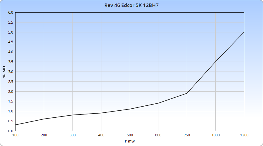

I got a reasonably complete set of data for a 5W4 / 12BH7 / 47 combination with both OPT's prior to the 10M45 failure. I settled on 200Hz for the low tone, and 6 kHz for the high tone. I'll probably try to graph the data, but the bottom line is pretty clear: with both OPT's, 47 just does not gain much of anything in a distributed load configuration. With the dual impedance transformer, 71% distributed load provides a marginal improvement above 600 mw over 7K full triode, and marginally worse below 600 mw. This transformer is pretty well done by 500 mw.
The Edcor performs very well with the adjusted low frequency tone up to about 750 mw. However, 16% UL is measurably worse than full triode at all power levels up to 1000 mw, although the delta narrows considerably between 750 mw and 1000 mw. Pentode with Schade feedback is comparable to 16% UL up to about 500 mw, where the two differentiate, with UL performing significantly better. Triode is absolutely the way to go here.
I haven't tried 46 yet. It will do very well as a triode, likely better than 47. It will work with the 71% distributed load, but may be better or worse than full triode in that configuration. Since connecting grid 1 and 2 together makes a zero bias triode, it is not likely to work well with the 16% or 29% distributed load on grid no. 2.

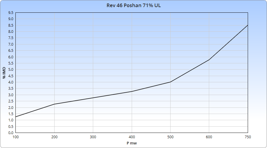

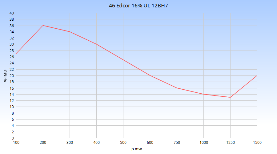

A few caveats:
the front end is modified to pull less current; this adversely affects 12AT7, I think.

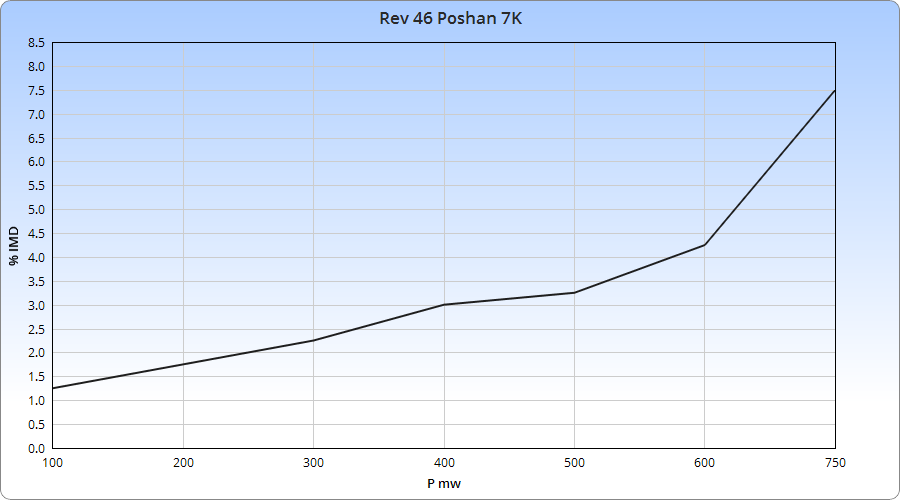

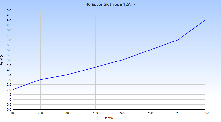

I tried higher voltage and less current on the 46, but didn't see any improvement. There might be merit with lower voltages. I would have to set it up on a bench supply for that.
I did not test for max power. It will obviously make more than one watt with the Edcor. The Poshan is not very efficient, so it might not with that OPT. Eventually I will get to this.
46 obviously makes a terrific triode; why it is not more popular is a mystery.

Win W5JAG

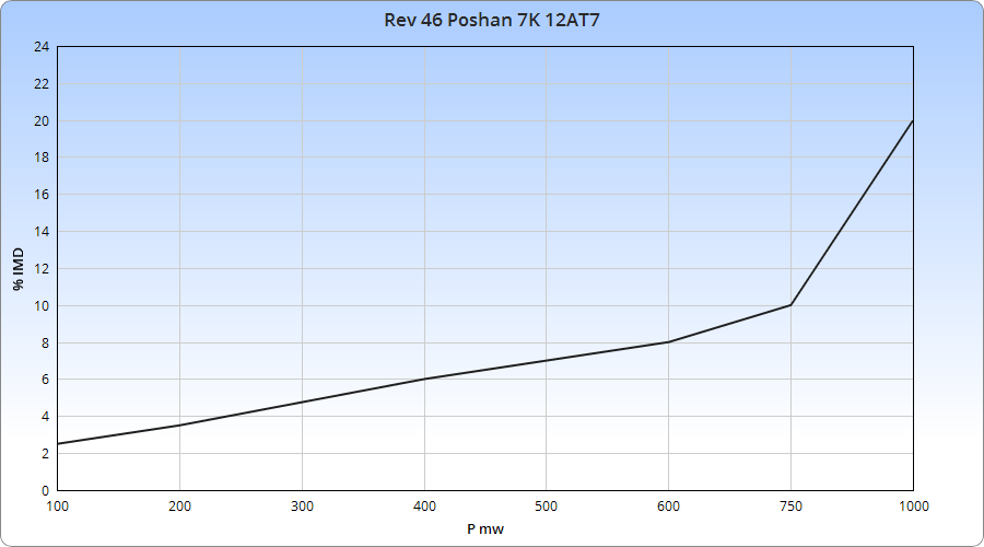

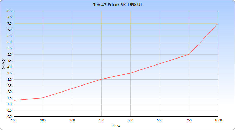

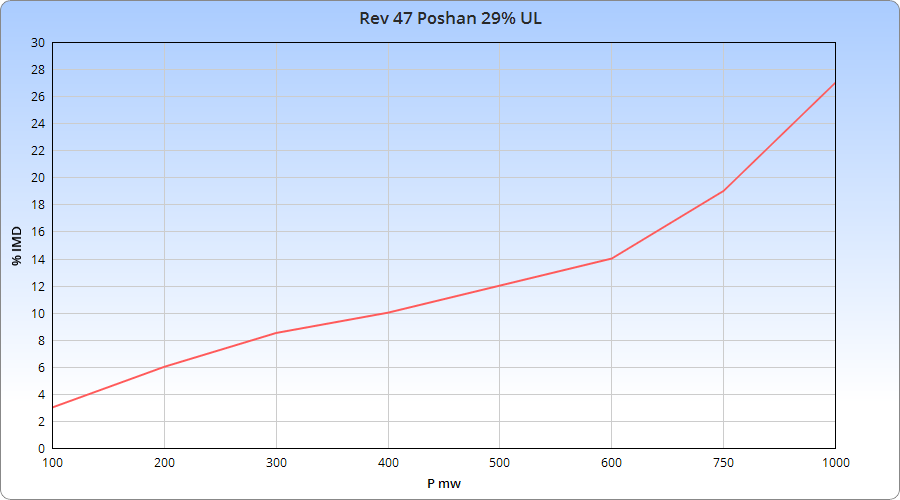

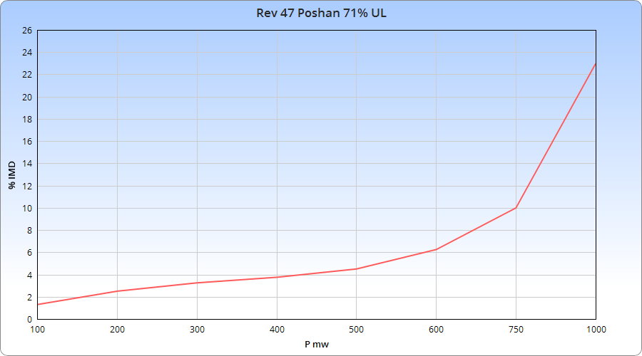

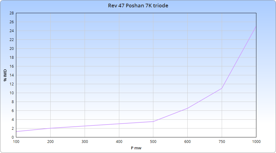

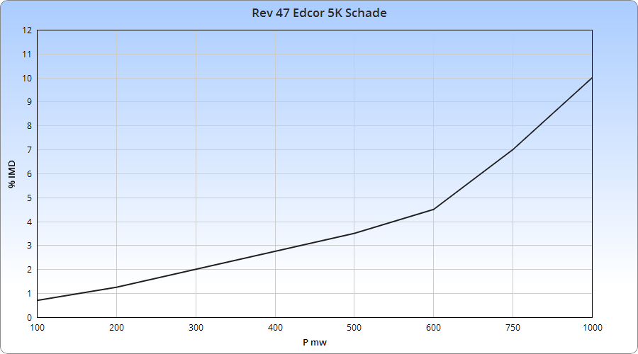

47 was developed as a pentode, but I didn't get very good results that way. More work is needed it seems. The schade graphs are running in pentode - it helped some, not as much I expected.
It makes a good triode, but not as good as 46.
It has very high gain, so I did not use a 12AT7 with it.

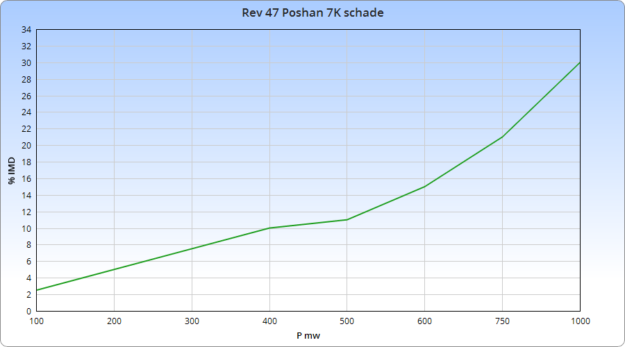

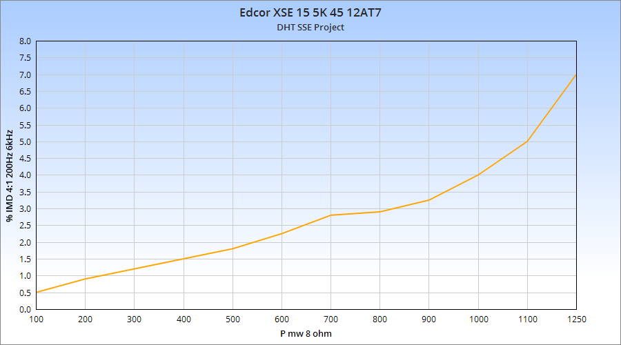

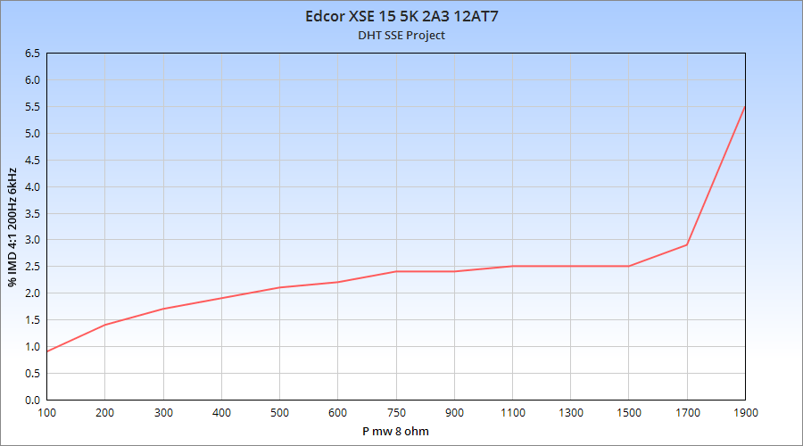

45 using the Edcor XSE15-5K.
test conditions:
unknown 45, branded Delco, FAA RCA 12AT7 blackplate, National Union 5W4GT
B+ 339
Vk 58
Rk 1500
Ik 39 ma
Pd 11
SMPTE IMD 4:1 200Hz:6kHz
SE amp cad predicts 3.1% 2nd harmonic distortion; 0.1% 3rd at 968 mw

307A / VT-225
Okay, I have 307A/VT-225 running on the DHT modified SSE board right now.
I didn't want an extra transformer on the bench, so I used the existing non ct 6.3 volt transformer that is running the front end, and built a virtual center tap to attach the 307A cathode resistor/bypass capacitor. I also have G3 attached to the virtual center tap.
It biased up right where I calculated and seems to be working as expected. is it permissible to use one filament transformer for evaluation purposes, or do I need to give the 307A it's own transformer?
The only curious result thus far is that 307A, like 47, does not seem to respond well to distributed load. I had it hooked up to the Poshan with the 5k lead to G2 for 71% impedance on G2, and this was marginally worse than full triode.
I'm running it at the max data sheet values - 300 volts; -30 on G1; 43 ma, but with a 7K load as a triode. Sounds clean and crisp. I briefly ran it up to about 25 watts, and it seemed fine there.

Win W5JAG
I swapped G3 from the cathode to the plate, and it lit up like Times Square in between the suppressor and the plate. Is this normal behavior for 307A, or is this a gassy tube?
I bumped up the voltage to see if it would burn off, and after an hour or so, the blue area diminished, but was still quite visible, and was still confined between the suppressor and the plate. I only have one 307A here at the house, the rest are at the warehouse of junk, so I don't have any others for comparison.
It seems to be working normally as far as I can tell. I do think it sounds better with G3 tied to the plate.
First pic is G3 tied to the cathode. Second pic is G3 tied to the plate.
Win W5JAG
