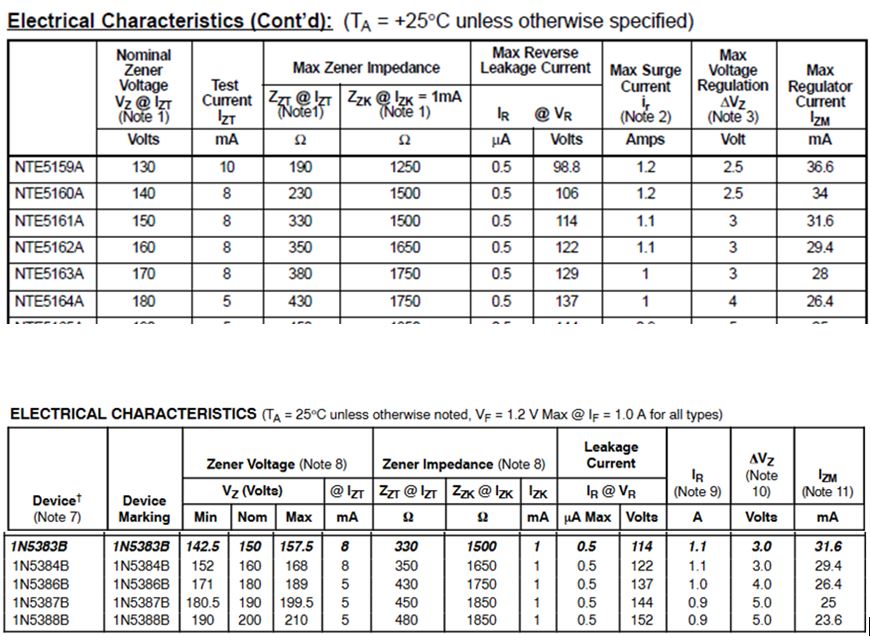

What is the value of the capacitor C1 in the regulator block ?
It looks like I can substitute the zener NTE5162A with 1N5384B, their specs looks identical,
see attachment which I clipped from their respective datasheets.
I haven't had a chance yet to redo the Pete Millet regulator, maybe in the next week.
I'll try this one after that.
10 uF.

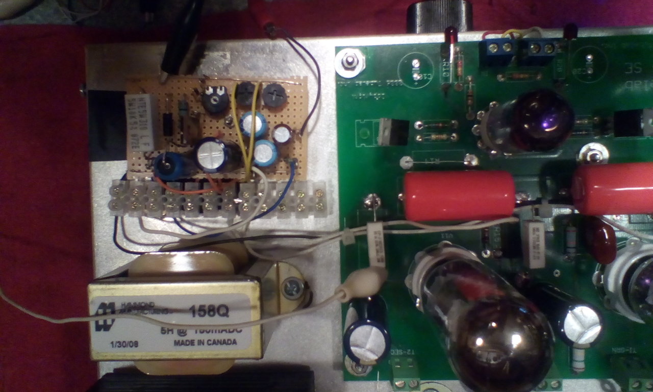

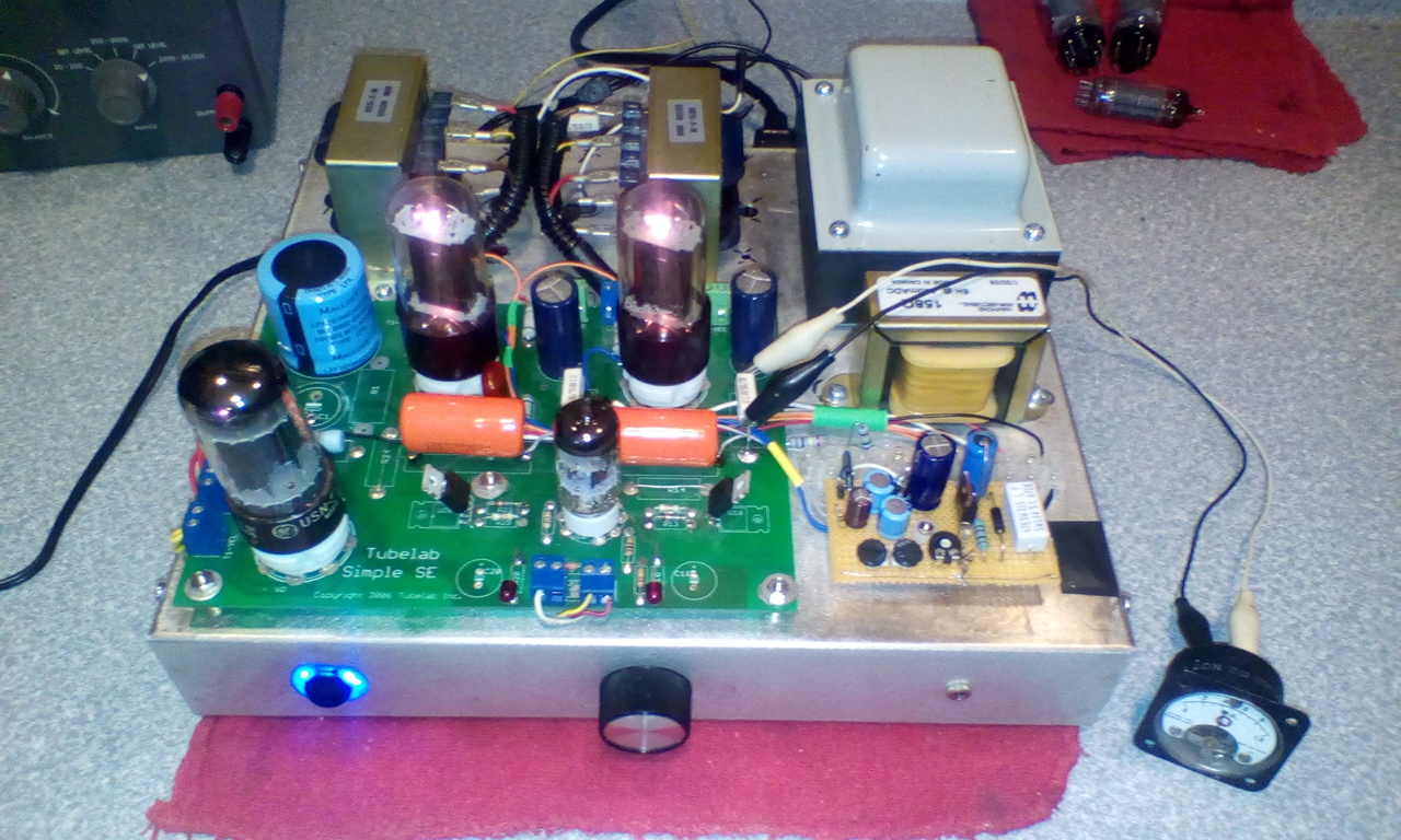

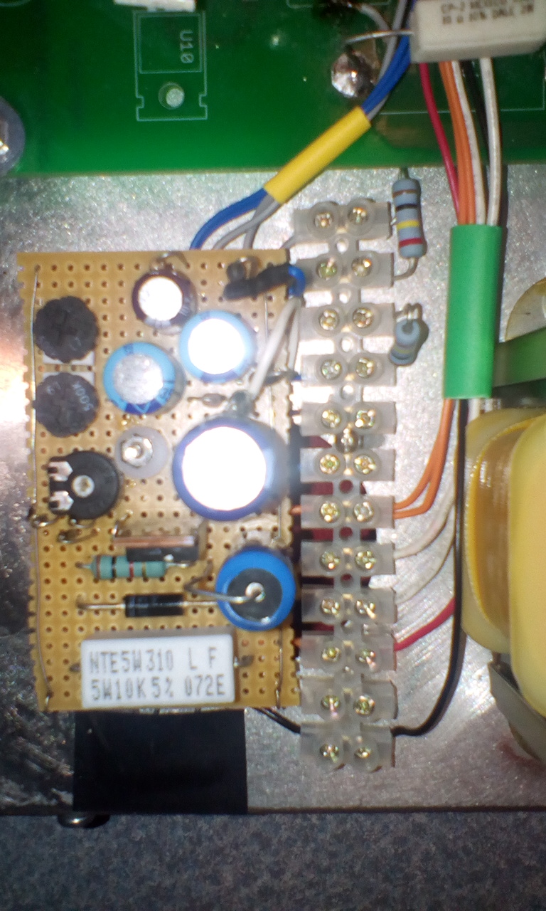

Here is the screen/bias board installed, sort of, in my SSE. The ground bus on the board is attached to the unused terminal of the SSE terminal block as the PT CT, to avoid ground loops.
A neater installation could be made if the board was just hardwired in, but for the moment I am not finished with it.

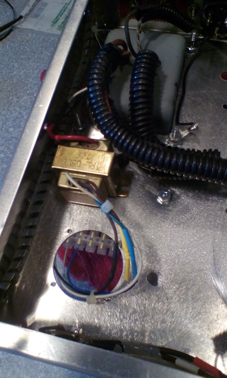

The bias transformer is tucked underneath the chassis, directly beneath the choke, using one of the choke mounting holes and hardware for it's attachment. It has has three ac outputs of about 18 volts, 9 volts, and 4.5 volts. Full wave rectified, the 18 volt tap gives up to about - 26 volts negative bias, the 9 volt tap gives up to about -14 volts negative bias.
The 4.5 volt tap gives about + 6.5 volts dc, full wave rectified.
I am using the 18 volt tap for bias. I pulled the 220K grid resistors, and placed a 100K device standing on end, and attached the bias line from the board to the free end. The cathode bypass caps are left in place on the board, but the jumper connecting the negative end to ground has been removed, effectively taking them out of circuit. A 10 ohm resistor is installed in place of the normal cathode resistor.
I do not have the screen supply wired in at present. Using a low voltage screen supply entails pentode operation, and feedback is required. Local plate to plate ( Schade ) is the simple way to go here, but I ran out of time to fool with it. The four empty spots on the terminal block are for the Schade resistors, for easy experimentation. They are also near a ground point, if some capacitance to ground is required.
The low voltage DC supply is to power the possible addition of some electronic "analog" voltmeters, Martel Electroncis QM-130M, pictured. They have a native 0-1 volt DC capability, hence the 10 ohm resistor shunt installed where the cathode resistor would be placed. They provide an analog indication of about 9 discrete segments. As pictured, it is indicating the static current in a 6V6 biased to about 35 ma.
The interesting thing about them, that I did not expect, is their ability to show the dynamic variation in the cathode current. A DMM measuring the cathode voltage will show a bit of jiggle, not much. The QM-130M will show the current slamming the "peg" at both ends of the scale.

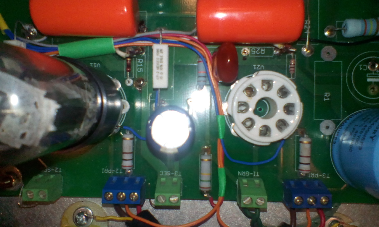

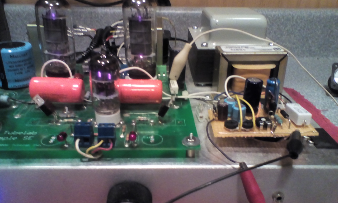

Here is the full implementation of the screen / bias board wired into the low voltage SSE, pictured running GE 6W6GT tubes.
I took power for the screen board from the top of the resistor (R4?) that is used to elevate the heaters at DC. I tried using one of the terminal blocks, but my screen wiring is sized smaller than the plate wiring, and getting a good connection was unreliable. Screen wiring out of the board is orange; B+ into the board is red.
Pentode operation requires additional negative feedback, imo. Local plate to plate (Schade) negative feedback is easy and effective.
Feedback wiring out of the power tubes is blue. I took the feedback directly from pin 3 of the tube socket, and it runs to the terminal block holding the feedback resistors. Feedback into the driver tube plates is grey. I put the feedback in at the pad for the leg of the coupling cap connected to the plate side of the driver triode. The connection between the two is via the schade feedback resistor at the terminal block.
The Schade is quite effective. Just casually playing around with it after wiring up the board and doing the initial tests, bringing the Schade feedback online took THD with a 6W6 at one watt from over about 7% or 8% down to under 1%, as well as smoothing out and normalizing the frequency response.
Having the resistors on the terminal block will allow for easy tinkering with the value, as well as allow adding some capacitance, if necessary. it can be disabled simply by removing the resistor.
My board is built topside, so all of my new wiring is topside. It shouldn't make any difference in operation. There are no issues with wiring everything in one bundle in the middle of the board as pictured, but, if you get careless and cross connect the feedback, you will get a funky mode of operation where it appears both the power tubes and the triode oscillate in a different mode of operation from each other, simultaneously. So, don't do that.
6W6 was all I had at home at the moment. I'm running the screens at about 125 volts, the tubes biased to about 32 mils. Anode voltage is 260 with a 6087. Just casually testing the various bits, I did notice some relationship between screen voltage and distortion, but it didn't look significant to me.
As pictured, this little beast will run pretty much any tube, in any mode of operation, within the voltage and current limitations of the power supplies, just by swapping connections with a screwdriver. A soldering iron would be required only for going back to cathode bias operation, but there is little to no reason to do that.
The versatility and expandablity of the SSE is astonishing.

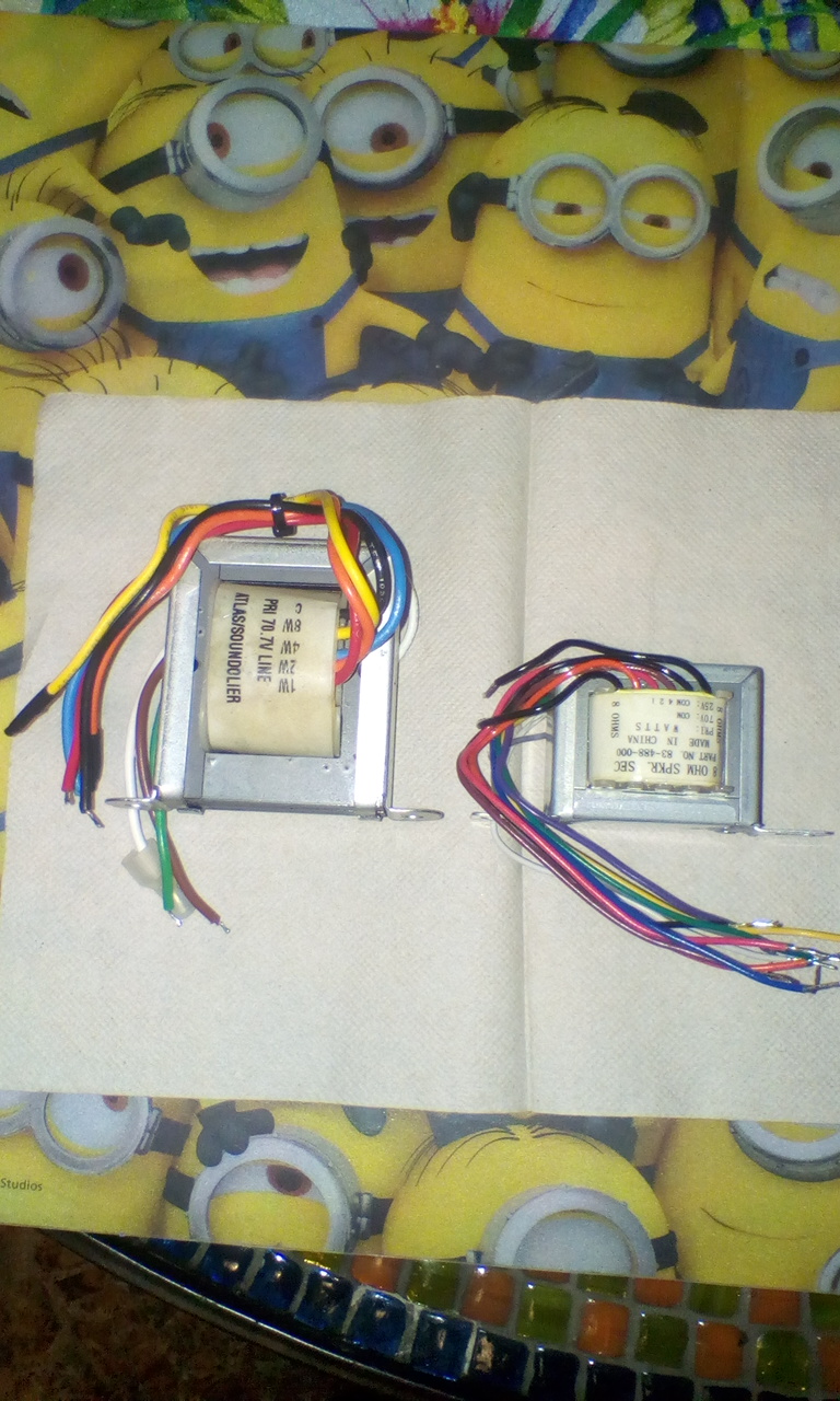

The Bogen T-725 came in a few days early.
I have a case of the Atlas Sound HT-87 here in the storeroom at the office ( I have parts everywhere - it's maddening ) so I lined them up for a size comparison. The Bogen is puny compared to the Atlas, which makes a quite good p-p opt, with the right tube. The Bogen is the usual line transformer size.
What interested me about the Bogen is the wide range of loads it offers. If my arithmetic is correct, I can get 39K, 19K, and 10K, out of it, while the normal line transformer is usually about 5K, max. I'm thinking the 19K load might work for p-p 6G6 and 6AK6, maybe 6K6. Hopefully next week I can get it installed, and take some measurements.
Might be a way to use these as interstage transformers, as well. Possibly it will have enough inductance to use as a plate / grid choke.

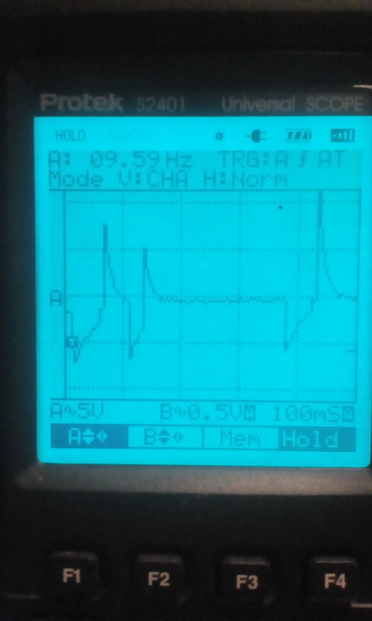

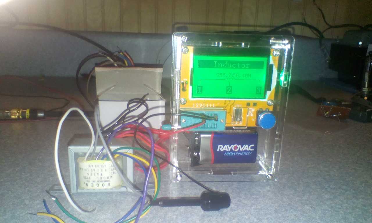

A few weeks ago I bought one of the little Mega 328 component testers off eBay. They are a pretty handy device - not only will they identify many types of components, they will give many of the parameters, such as ESR.
It is not quite as useful for inductance as it is for other components, as it only measures down to 2 microhenries or so, and a lot of RF coils are less than that. Still, for L above that threshold, it beats hooking up a known capacitance and trying to find resonance, like a full house beats two of a kind.
It does quite well at reading the large inductances on power supply type chokes, and primary inductance on conventional audio transformers.
I tried to measure the inductance on the little Bogen T-725, and came up with some oddball results, that I don't have a very high degree of confidence in, unfortunately.
Measuring the 39K tap, I got around 16 Henries. Oddly, measuring the 10K tap, I got around 50 Henries. Lower impedance taps gave more nonsensical results. I tried another line transformer I had laying around, and got the same kind of bewildering results, so, these are strictly FWIW. Which may be not much.
I tried to figure out the frequency it was using to measure the L, and hooked up my scope to an unused tap on the line transformer, and it looks like it pulses the component with a sawtooth type of AC wave, at stepped intervals and frequencies, probably 4, 8, 12, and 16 Hz. I did not look at the DC component, if any.

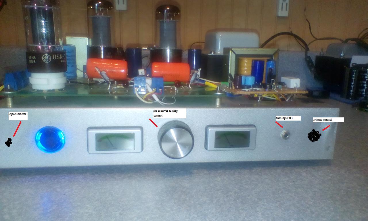

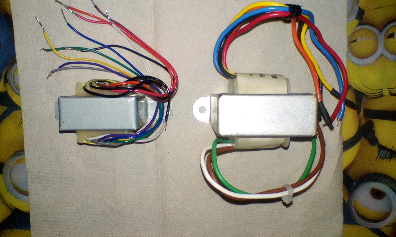

I mounted the Bogen T-725 on Mule 1, and fiddled with it a bit.
8 ohms is the only output impedance this line transformer provides. Similar to the other line transformers, the "center tap" is two taps up from the end tap in use. It has both 25 and 70 volt lines.
I had the amp set up for 6K6, cathode bias, running about 6 watts in each tube of the push pull pair. At 10k load, I got about 3.125 watts out of it. I also tried 19K load, and got the same power output, but saw higher THD at 19K.
Even though it was set up for 6K6, I also tried 6G6. They biased up almost identically to 6K6; a little bit more than 5 watts per tube. 6G6 seemed to respond better to the 19k load. Power output dropped, but distortion also dropped relative to 10K, and at one watt output, wasn't all that bad, about 1.6%, IIRC. I didn't take any notes of exact numbers.
When I had it set up on the 19K load with 6K6, I looked briefly at frequency response. Relative to one watt output at 1 Khz, the -3 dB point was about 55 Hz. I didn't check the high frequency response. With the standard 60Hz:6KHz 4:1 set up, and 55 Hz -3dB point, SMPTE IMD was poor - about 5% at 0.125 watt.
I'll fool with it some more, and get some better measurements at some point - it's a bit of a tedious process with all the combinations of tubes, taps, and operating points - it will need to be set up on a bench supply and rigged for fixed bias; right now other projects are a higher priority. For now, about all I can say for sure is that it didn't immediately self destruct at mid voltages ( ~ 275 VDC ) and low currents ( 20 - 22 ma).
I did not listen to it. It might sound okay or bad.

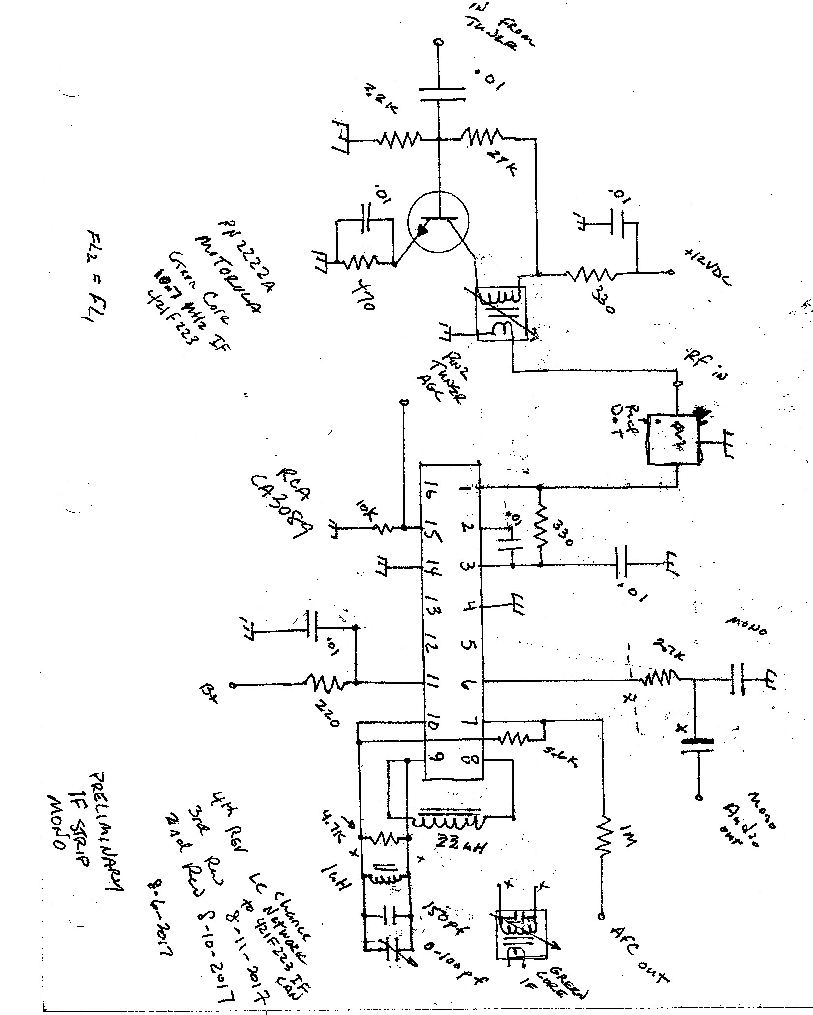

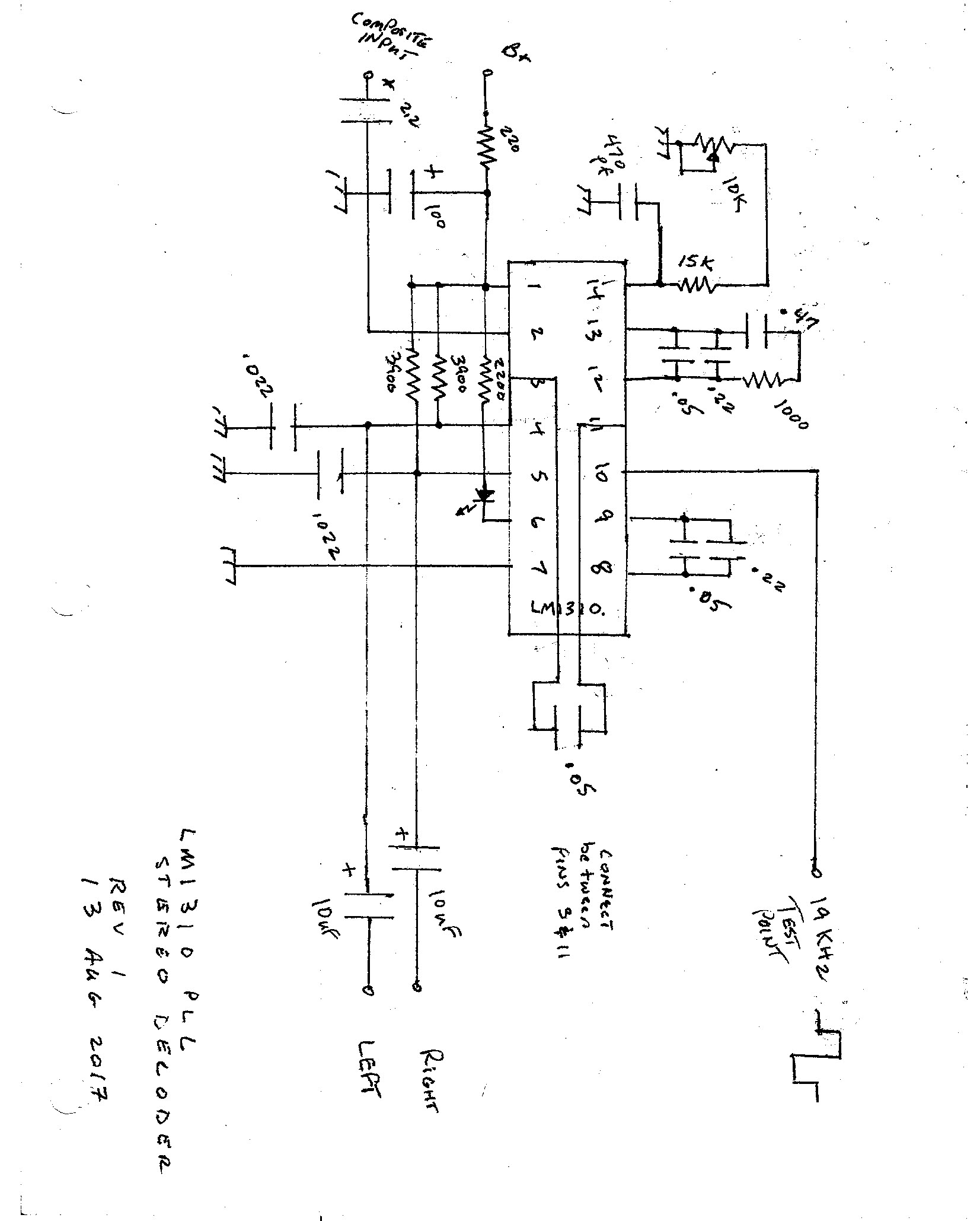

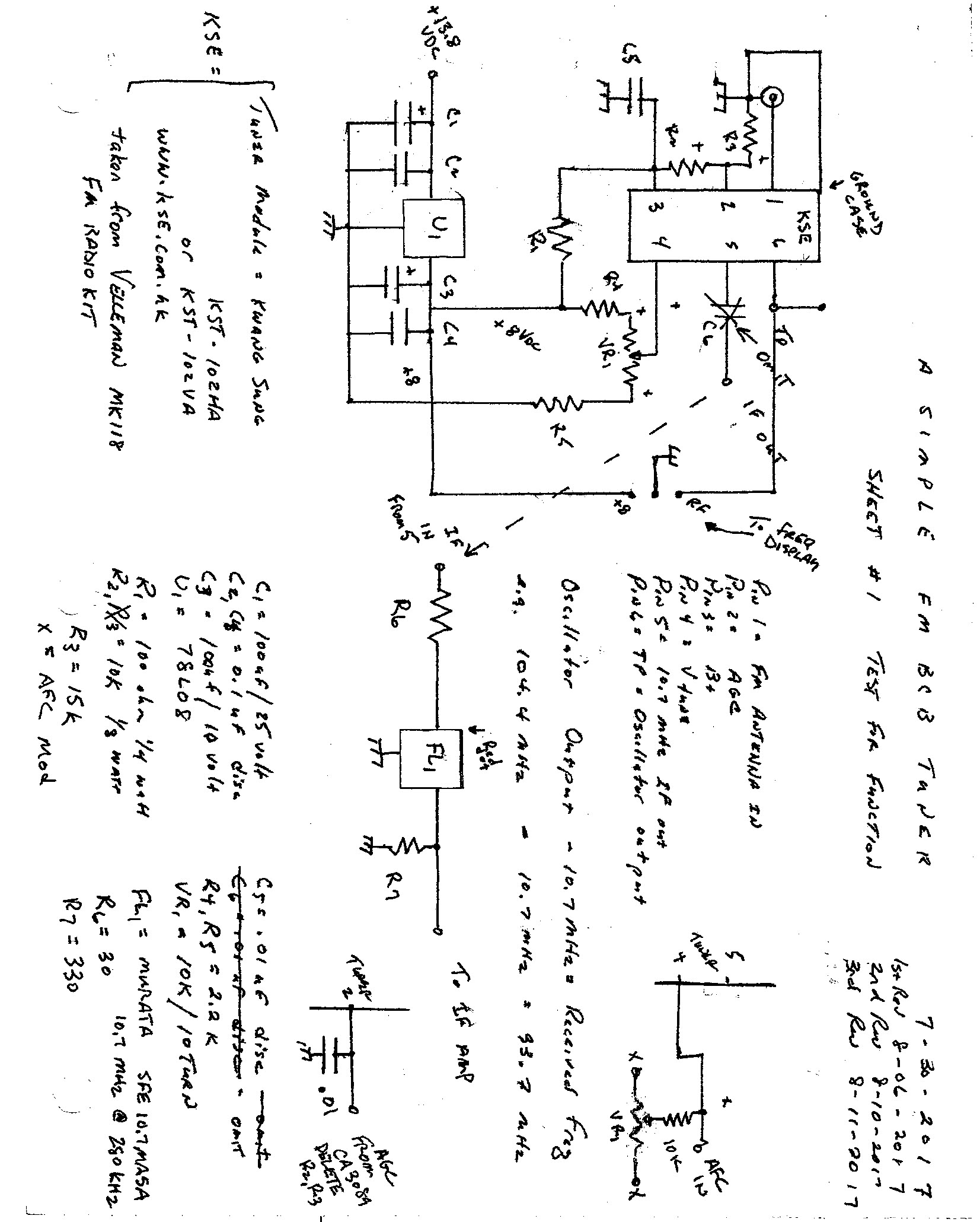

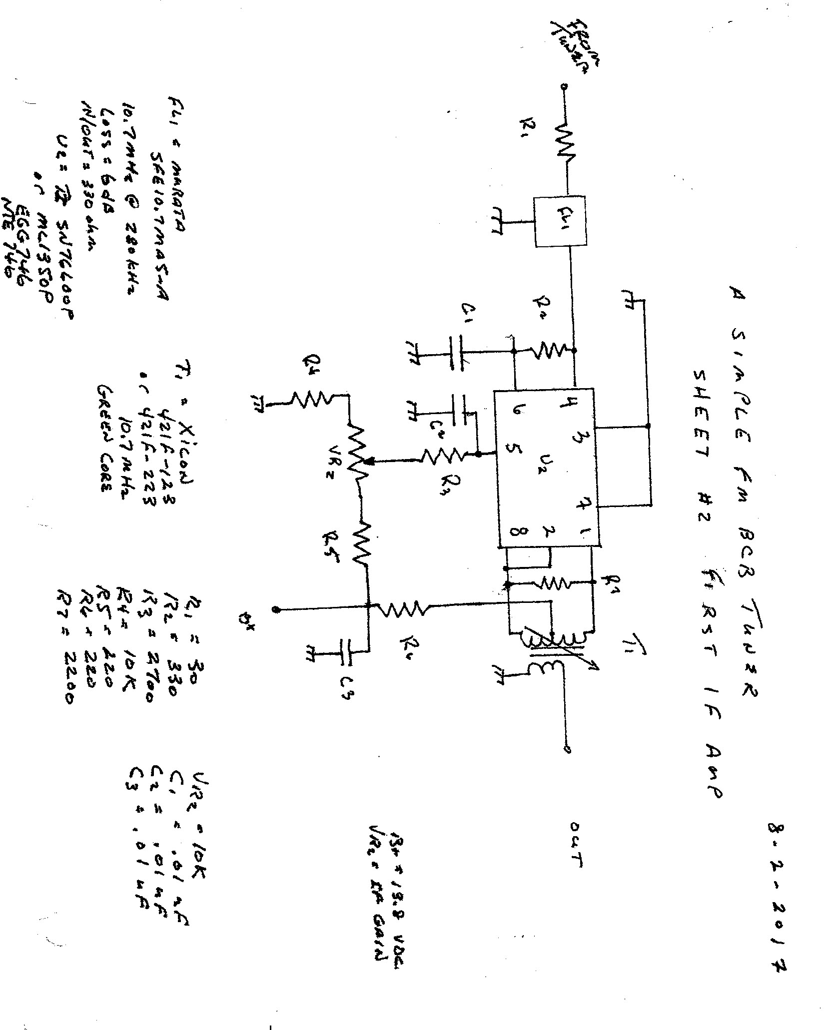

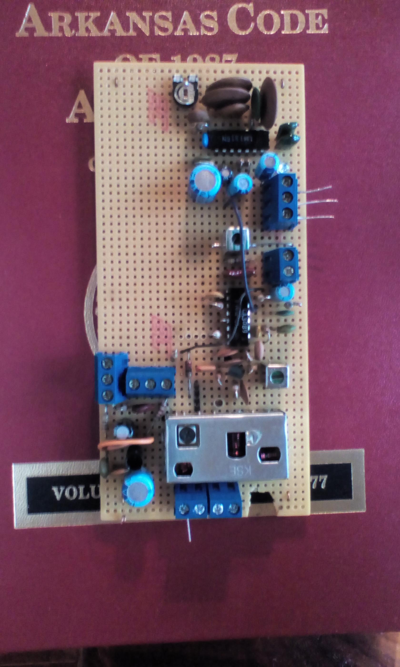

Analog FM Tuner board drawings

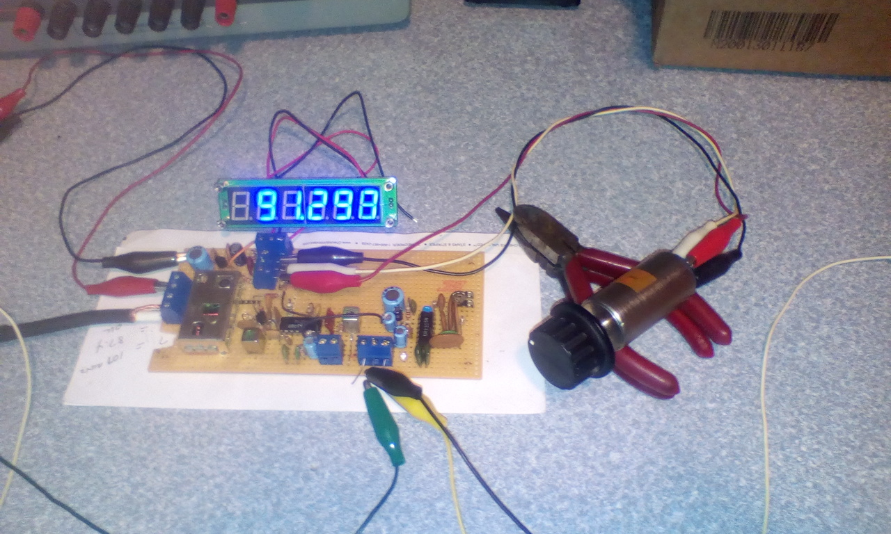

For anyone interested, here are the schematics for the analog FM tuner board. They are a bit helter skelter as I just kept making changes to the drawings as I changed things, in lieu of drawing a new one. Also attached is an IF amp I did not use, but worked well.
It's pretty well done. I may still fiddle with some of the IF selectivity, but that is just part substitution, maybe adding an additional filter. The frequency display is a programmable frequency counter module from eBay > $12 USD to my door.
It should be obvious that I am not an engineer, but if there are any questions, I'll try to answer them.

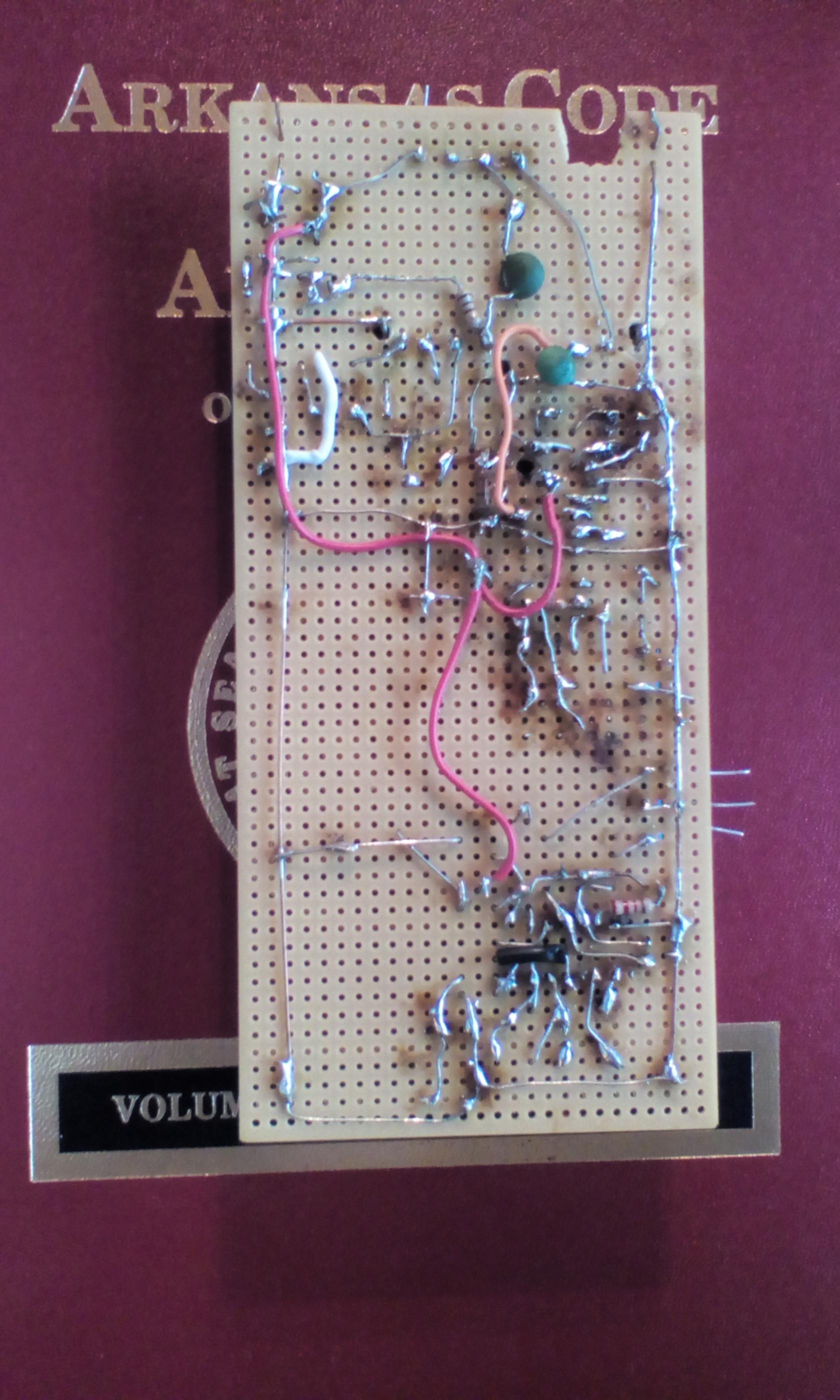

Construction used both sides of the board. My soldering sucks compared to what I did twenty years ago. It caused me some real problems with the stereo decoder. I'm not adapting well to the new solders / parts.
The tuner works well enough, and is pretty hot. I live on a pretty good hill in the river valley; standing on my roof I am line of sight to the foothills of the Boston Mountains to the north, and to the horizon east and west. A ridge four or five miles to the south limits line of sight in that direction. One of my target stations was a 47 KW station 53 miles south, down in the Ouachita Mountains. The tuner limits, stereo decodes, and fully quiets on this station with a couple of clip leads for an antenna.
Connected to a test dipole cut for 98 MHz and mounted about 17 feet AGL; there is a 100 KW station 11 miles north of me, line of sight, and a 250 watt translator spaced 600 KHz below the 100 KW station, also line of sight. The tuner has no difficulty receiving the 250 watt station.
I haven't started on the audio input switching yet - I lack a few needed parts. I think I can get it all in the existing SSE, except for the frequency display. There just isn't enough front panel space.

my 845SE which is sitting on the shelf waiting for something between a power supply upgrade, and a total rebuild. There are multiple instances of exposed electricity up to 1050 volts and grandkids come here.....
