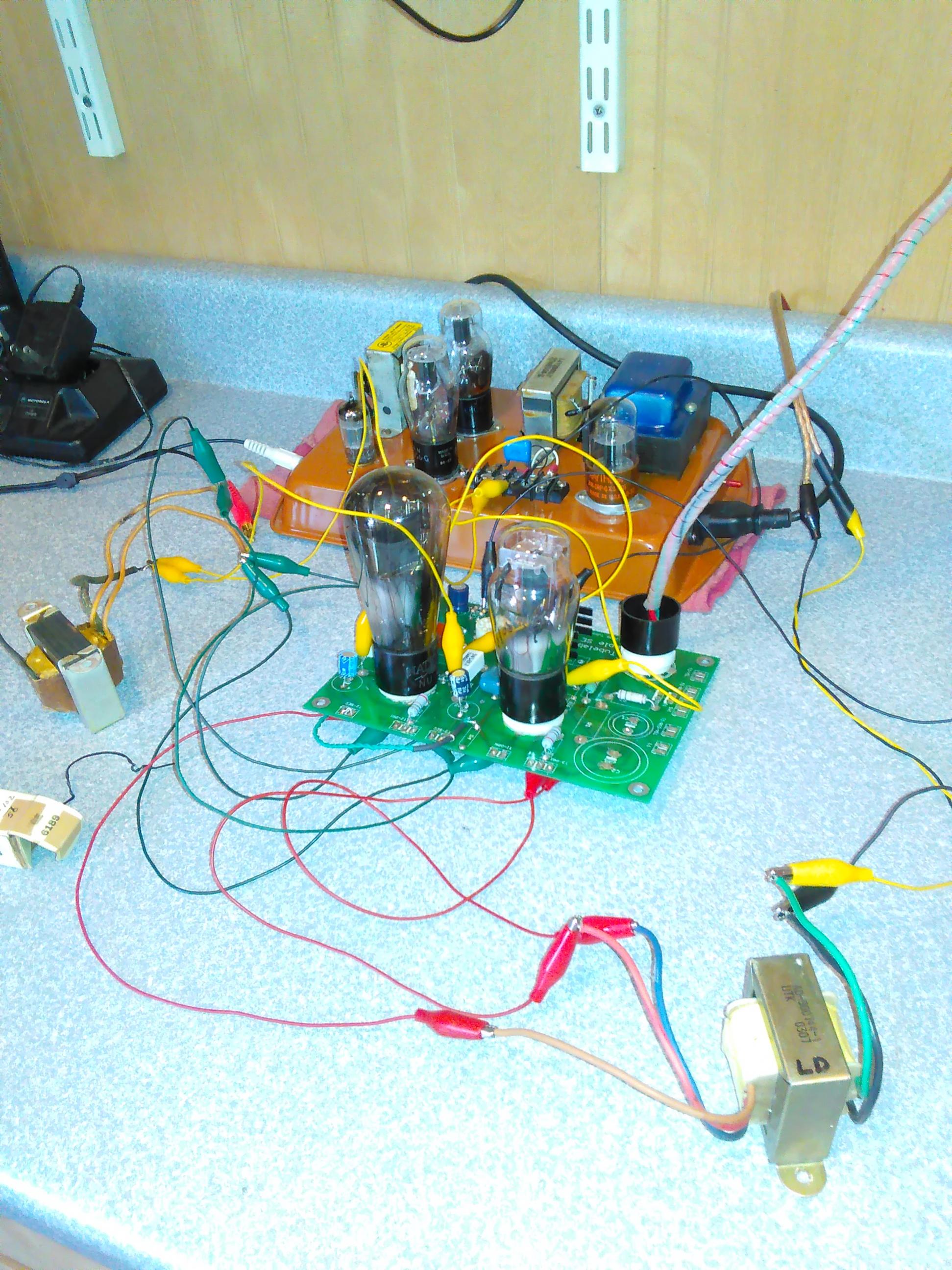

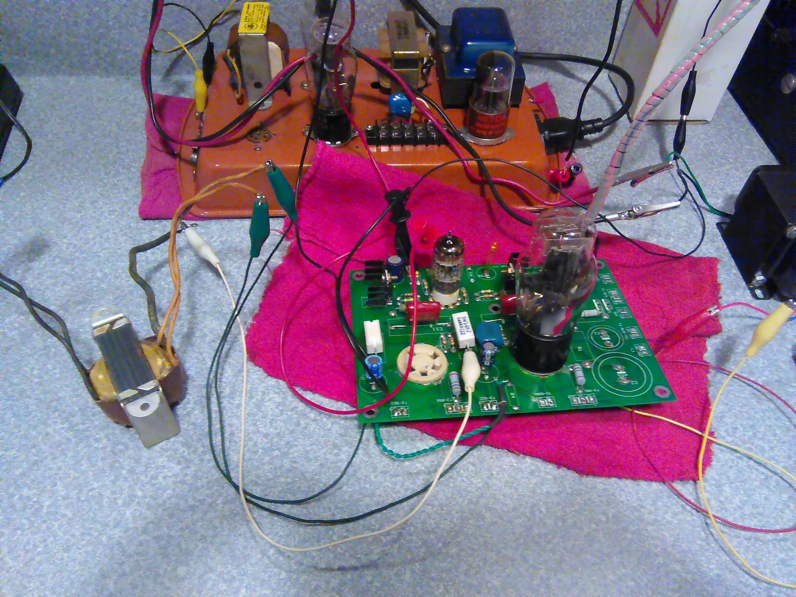

.... the idea of a very simple, very low cost, directly heated push pull amp, and I kind of think that this is one of the directions your thread will veer off into - a mosfet less simple quasi UL 46 SE, and a mosfet less simple PP quasi UL 46.
The obvious first use here of the phase splitter outputs / inputs is making an SSE board push pull. ...... Should be easy, really -
Yep, couple of minutes with clip leads is all it took to make the power amplifier stage work.
Front end ought to be pretty easy - one side is already an amp; I haven't looked at the board that close, but it would astonish me if there were not some way to haywire the other side into a phase splitter using the existing holes and traces.
Obviously, some refinement is needed - one side is 45, one side is 46. Might be pursued further. Might not.

I found some 5930 here at the office, so I took one home last night to give it a try on the modified SSE board.
I'm not really a fan of 2A3, but the results on the modified SSE board looked pretty encouraging. I was running them in the range of 260 to 300 volts, unfortunately, this is in the range where 12AT7 seems to produce pretty variable results in the unmodified front end, so I used 12AU7 ( 6189, actually ) and 12BH7 as a substitute.
Preliminary results were encouraging. I didn't take any notes so this is from memory:
With a 5K Transcendar as the OPT, 12BH7, 1 Khz sine wave tone, and an 8 ohm resistive load, I saw 3.25 watts at the first indication of sine wave distortion. It took about 2.25 volts RMS input to a 12BH7 to get to there. 1 volt RMS gave about 4/10 of a watt.
Two tone IMD was pretty good, really. IIRC, with a 12BH7 it was about 7 or 8 % at 1 watt, about 3 or 4 % at one half watt, and at a quarter watt it fell below 1 %. The 6189 was a bit higher, but either would be acceptable.
I'm not really a big fan of 2A3 - just never cared much for the way they sound, but out of the DHT's that I am aware of, only 45 and 5930 are the short bottle types. This is important to me, because with these short tubes, a DHT modified SSE board would be a drop in replacement for the SSE board in the child resistant SSE. It would be a one or two evening project if I decided to go there.

This is really fascinating and I've been watching it closely.
So have I. Most people build amps by the numbers, and are happy with them. A few will go on to mod their amps to make them different or better, or whatever......then there are the few, the proud, the real hackers. Those who go where no tube has gone before.....not many of us.
Yes, I have cut up some boards to make something different, but I just made adapters to put the 307A's in my TSE (they work just fine on the 5 volt filament regulators). I never would have thought of drilling big holes for 5 pin sockets, but I might have to try it. I never would have put my SSE in the dishwasher either, but I had a really ugly one that had gone through at least two cap explosions........
making an SSE board push pull. I do recall at least one thread a few years ago on this.
I made one 6 or 8 years ago using an external phase splitter. In fact the driver board was an entire guitar preamp similar to that found in a Marshall amp. It drove an unmodified SSE board (except for some resistor values and a 12BH7 tube) to about 50 watts using a push pull OPT. I mentioned it somewhere and that prompted the push pull SSE thread.
http://www.diyaudio.com/forums/tubelab/171340-dual-simple-ses-push-pull-w-differential-input.html
There are two different paths to get there from here. I have done both years ago, and hacked up the board to get there quickly.
1) Split load PI. Leave one side of the 12AT7 as a gain stage CCS and all. Wire its plate directly to the grid of the other side of the 12AT7. Remove the CCS from the second side and replace it with a wire jumper. Swap out the 10 K in series with the CCS, and the cathode resistor for equal valued split load resistors (I used 33K I think). Remove the cathode bypass cap on that side. Sky wire the coupling cap for the now un fed output tube over to this cathode. Futz around with the bias (CCS current and cathode resistor) on the phase splitter side to get the plate voltage around 1/3 of B+.
2) An LTP design is possible, but more difficult due to the lack of a negative voltage source on the board. I don't remember the exact details. I jumpered the CCS chips in the 12AT7 plate circuits and used larger valued resistors in place of the 10K's. The grid resistors were not connected to ground, instead they were wired to the voltage divider that normally biases up the heater winding. A coupling cap is used for the input, and the unused input is connected to ground through a cap. The cathodes were connected together with both caps and one resistor removed. The remaining resistor was replaced with a larger resistor, or a CCS circuit.
I wonder if there is enough gain out of the 5842 to drive the 300B to clipping.
The 5842 can barely drive a 300B to clipping when driven by a good CD player or a line stage and being CCS loaded with a mosfet or tube buffer. Some users report not enough gain to hit clipping with a TSE driven by an iPOD or cell phone. Depending on your source a third stage may be needed with an unassisted 5842. I know many will find this unbelievable but a 12AX7 with a CCS load and a buffer will produce plenty of gain and remarkably low distortion. All 12AX7's are not created equal in this respect though. Some work better than others.
I assume you know this, but when operating an SSE on low voltage place a jumper across the 10 K resistor in series with the CCS. That resistor drops roughly 100 volts, just to take the heat off the CCS chip, and help make the board more blow proof when poking around in a live amp with a probe or screwdriver.
Even when jumpers are in the place of those two resistors, like W5jag I've found when the voltage is below 300V and particularly as it approaches 250V the sound starts to deteriorate rapidly with the 12AT7 in place. Also like him I've found that substituting with a 12BH7 is a good fix for this.
The 12BH7 will lower the overall gain a bit, but if that's OK, it is a good choice. I have used it on occasion, usually for lowering the gain.

The SV-811-10 continues to be a difficult nut to crack on the SSE board.
I've played around with it a little bit more, but the results, while improving, are still disappointing. I've been trying to drive it with an interstage transformer. The best results so far have been with a lower gain tube in the front end, and a 5:1 ratio interstage, and a transcendar 3K OPT. I'm probably not using the transformer optimally - I left the front end as is, and drive the interstage from the coupling capacitor.
The interstage transformer is better suited to a push pull stage, I think, but it's the only one I have. It's a Merit driver transformer, and has multiple ratios from about 2.5 to 5:1.
The SV 811 models well enough at the voltages I'm using, but the real world is completely different.
Win W5JAG
Win W5JAG

Here is the modified board with LED bias on the input tube.
An orange led set the cathode at at 1.97 volts. It does not get anywhere close to full brightness, not sure how important that is. The input tube is a 6189 (12AU7).
Power tube is a 45 set to 300 volts and 40 ma. Tubelab noted somewhere he has never seen a Pd for 45; I don't believe I have seen one, either. SE Amp Cad lists the maximum wattage for 45 as 8 watts, but I don't know where that came from. That seems low to me.
From a distortion standpoint, this works quite well. Two tone IMD does not exceed 1% up to 450 mw, from there it rises rather sharply, hitting 1.2% at 500 mw; 7% at 750 mw; and 13% at 1 watt. There is some trade off here, it can be made lower at the higher powers, but this increases the IMD somewhat at lower powers. OPT is a 5K Transcendar.
I don't think there is enough front end gain with this tube and this type of bias, so more work is needed, but it looks to be worth exploring. It certainly sounds good. When they designed the 45, they got it right.
Win W5JAG
Win W5JAG
