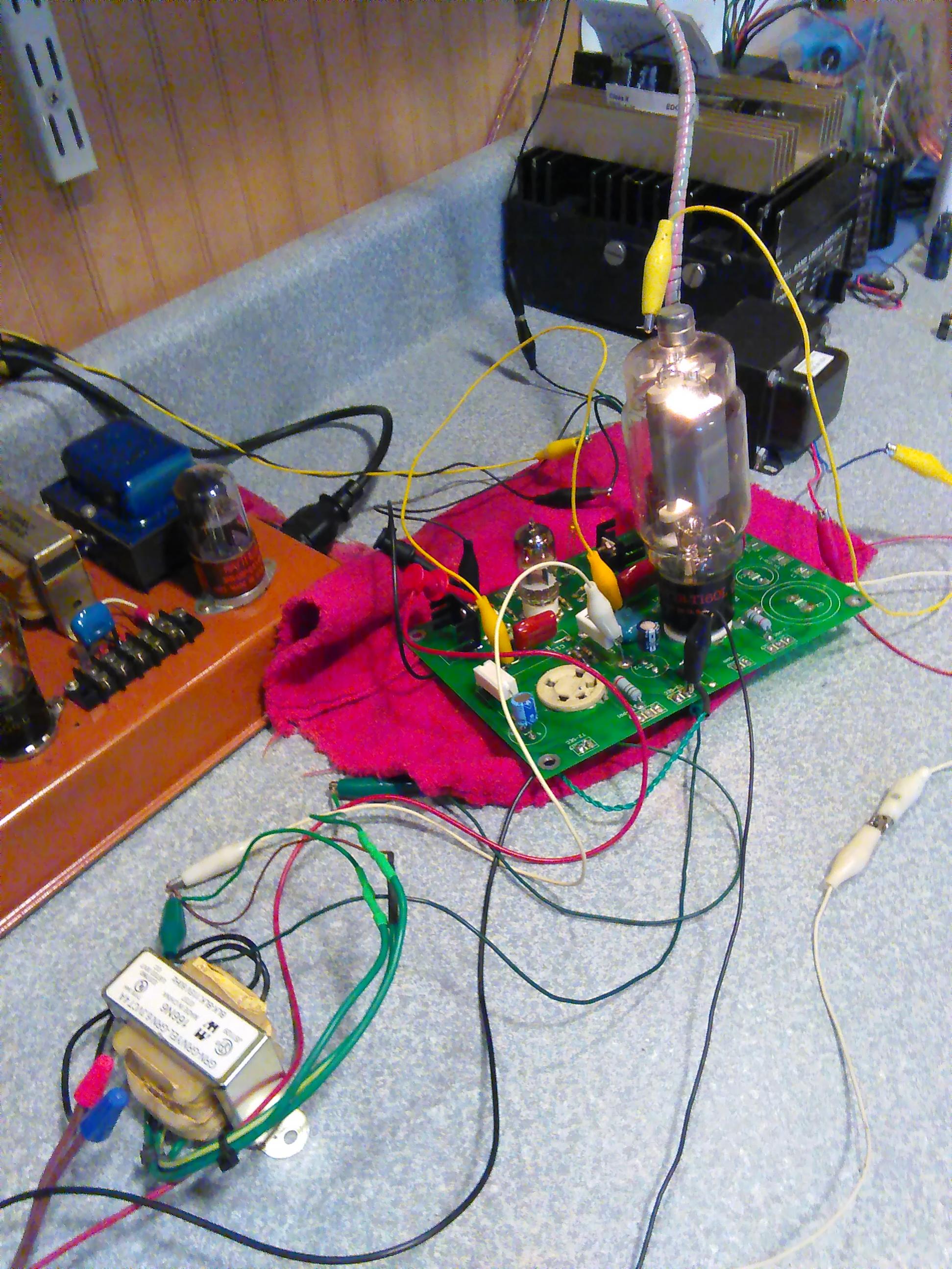

Found a gnarly looking RCA 811-A here, may or may not be good. My TV-7 says it is, but that doesn't mean it is.
It's working on the board now, but is behaving quite differently than the SV572-160.
It worked, sort of, at zero bias, or just slightly negative, but wouldn't pull any current. So, I put some resistance in the cathode; right now, I have 1.2K and a bypass cap on the center tap, and about 45 volts positive on the grid, this shows 5ma grid current, and about 40 mils at the plate at 400 vdc. That's probably a net zero to slightly negative bias, but it's the only way it will pull current.
It has quite a bit more gain than the 572, but audibly seems not as clean. Same unmodified 12AT7 front end.
Odd. Or interesting. Not sure which.
Win W5JAG
edit: 10K load on both tubes.
This 572B is dead, even the TV-7 says so. I've been saving it to build a nightlight for my four year old, as soon as I can spare a filament transformer.
Regardless, it worked on the SSE board, and sounded the same as the SV572-160, although it took the same quirky set up as the 811A to make it do anything worth listening to.

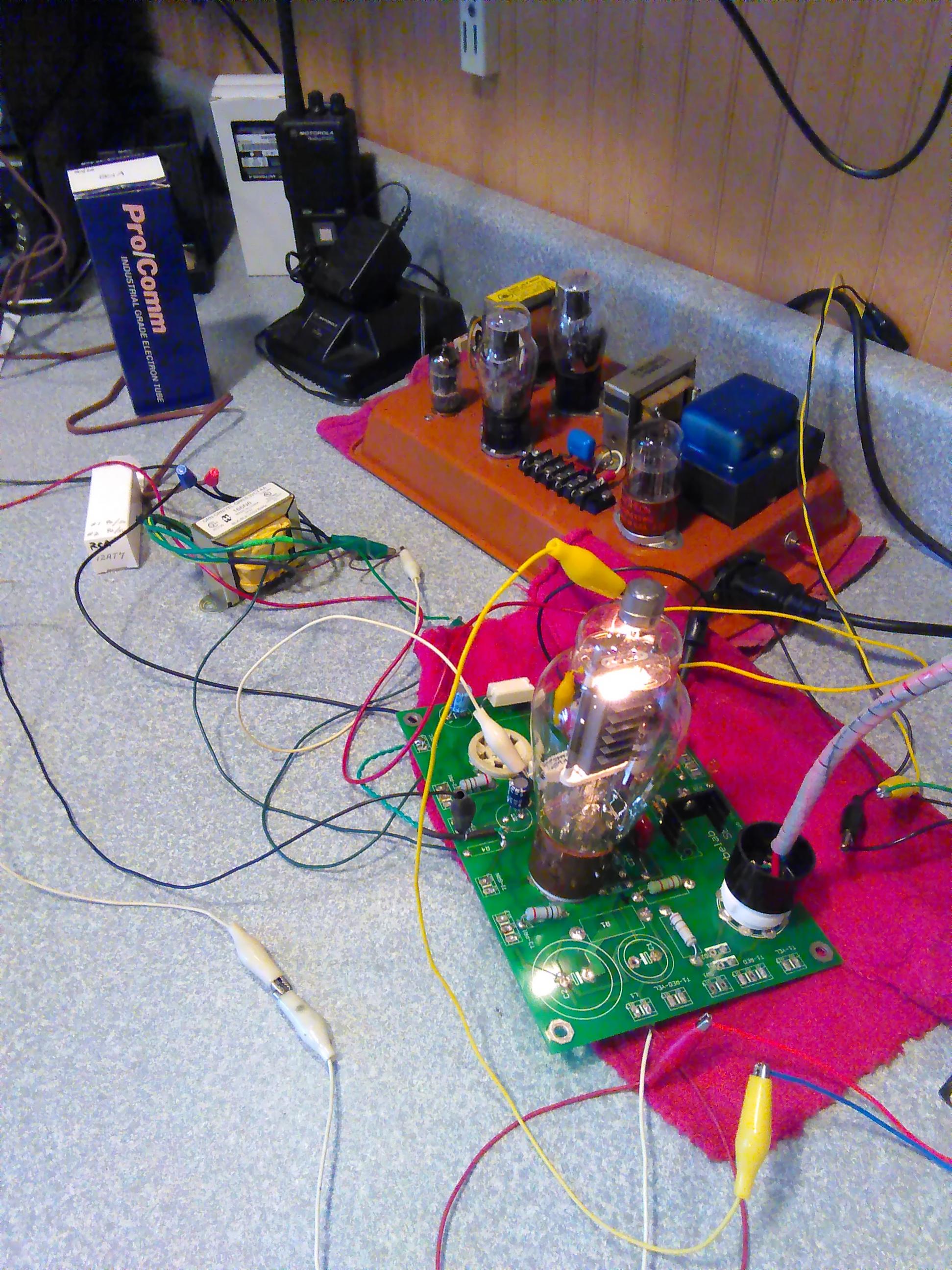

I spent a fair amount of time listening to the 811A this afternoon, and had it not been so drizzly/dreary here, I might have gone out to the warehouse of junk to grab some new 811A and 572B to see if they behave as these dregs do.
I had believed that the SV811-X and SV572-X tubes were the transmitting tubes, except for the different mu's and lack of a plate cap. I'm less sure of that now, but I think I have quite a few, enough for a decent sample, of new Svetlana 572B at the warehouse, so at some point it will be easy enough to put that to the test.
Out of this bunch, the 811A is now the one that interests me the most.

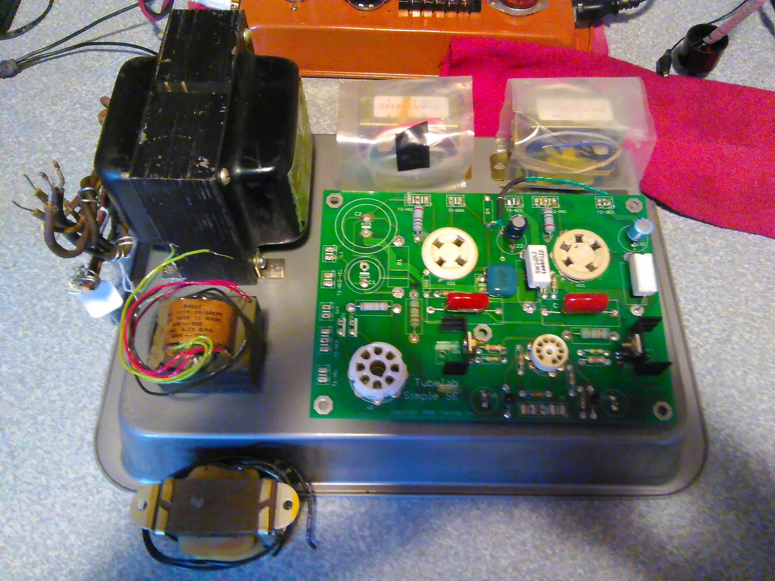

This would be a tight fit, but looks possible.
The big PT has two ( 2 ) robust 2.5 volt CT secondaries, so that eliminates the need for filament transformers, but lacks a 6.3 volt secondary, adding an additional problem. It's also 400-0-400, making a choke input mandatory. The choke would have to go under the cake pan. This would be robust and well suited for 45, 46, 47, and 2A3.
Since I would have to add a filament transformer, the little Thordarson pictured has both a 6.3 volt secondary suitable for the 12AT7, as well as a 115 volt secondary; fixed bias would be added to take advantage of that extra secondary, might as well put DC on the 12AT7 filament.
The OPT's pictured are not great, but are suitable enough for this purpose. The 10 watt open frame Edcor XSE would probably fit here. If actually built out, this would slot in somewhere between the Simple 45 on the web site, and the TSE.

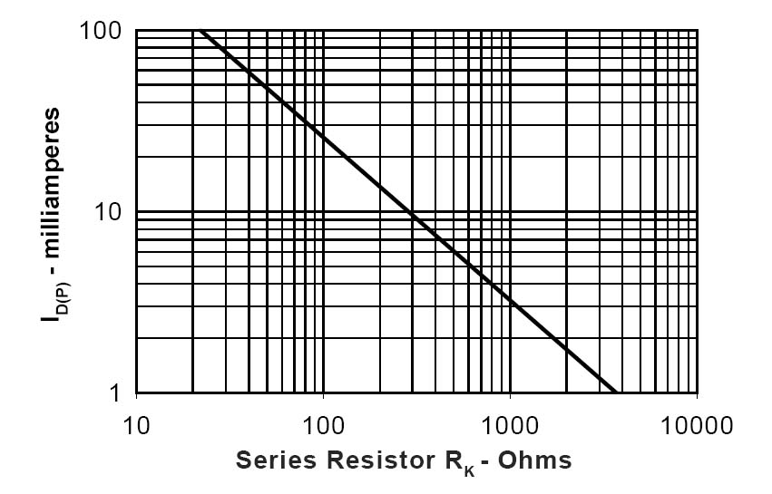

I'm using 25-30 year old red LED's for the 12AT7 bias on both boards. After reading up on this, I have no idea whether I went through the correct selection process. I didn't see any distortion difference between the LED and the RC combination; if anything, the LED might be slightly better. It sounds fine, so I guess I haven't botched anything. I'm wondering if a secondary artifact might be a visual indication of tube health and aging.

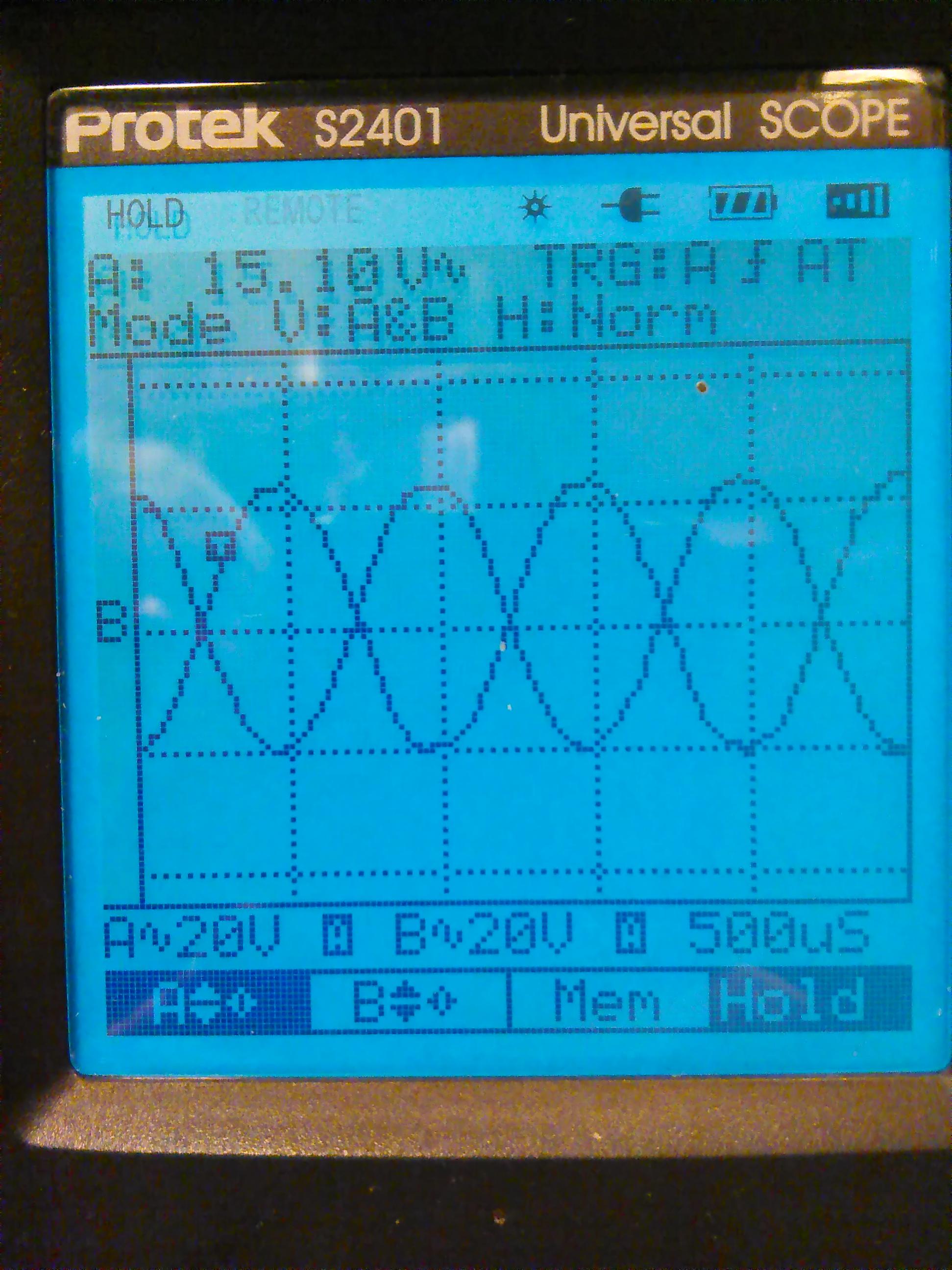

This is the output of the phase inverter, taken at the cold end of the coupling caps / grid of the power tubes, showing one half running out of gas well before the other. Phase invert looks OK, amplitude, not so much.
Results are similar with 12AT7 and 12AU7, and several examples of each type, so not likely a tube problem.
1 kHz sine wave input, 68K plate resistor on the input side, 20K on plate and cathode of the inverter, 0.1 uF coupling caps, 470K grid resistors.
I would think I need closer to 33K on the phase inverter, but I used what I could find at home on a Friday night to make it work; I don't stock a lot of 1 watt and higher resistors since I don't use them much.
It does work well up to the point this asymmetry occurs, and I don't need more than 3 watts from it; I just expected 5 or 6 out of it.

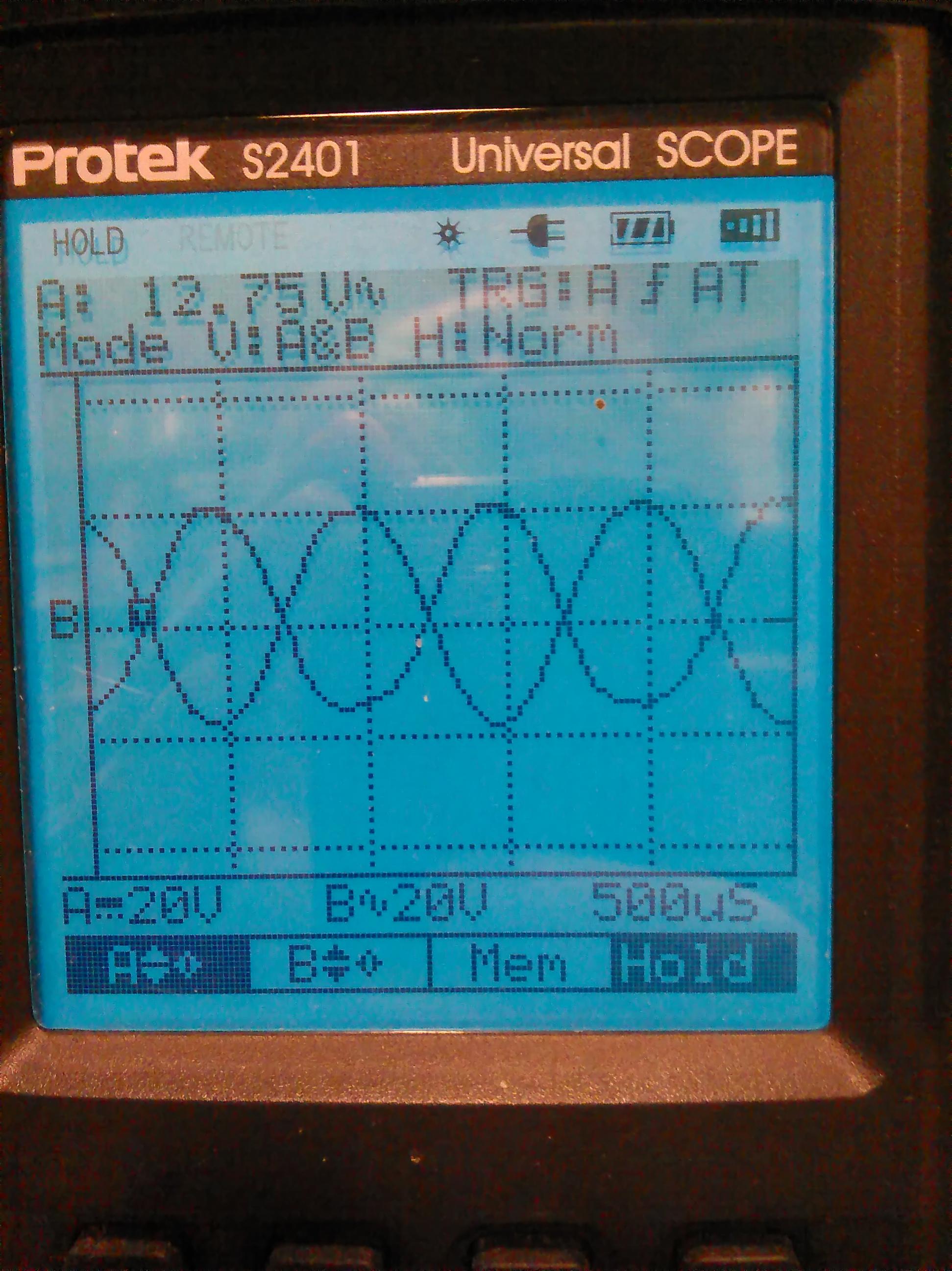

I found another barrel to scrape.
In between the warehouse of junk, and what gets binned / shelved, there is the intermediate cabinet of sacks, one of which yielded up some baggies of resistors, mostly unsorted 1/2 watt carbon comps, but one had some nice 1, 2, and 3 watt carbon comps, including almost a dozen really nice, flameproof, 3 watt, 39K pieces.
I put two of those, measuring 38.5K, in place of the existing 20K's at the output of the split load, and that seems to have cleaned up the front end nicely.
The below pic is of the mule front end, same 1 kHz sine wave, with the mule doing about 3.25 watts into 8 ohms, which is all I can eke out of it. At this point, it just begins to show the beginning of crossover distortion, and the beginning of sine wave compression.
Am I being unrealistic in expecting more than this from it? Should I bump the coupling caps up to 0.2 or 0.3 uF from the existing 0.1 ?
These tubes only draw 150 ma filament current each, and 3 watts is adequate for my needs, so maybe I am being greedy expecting more, but if there is more to be had, I'd like to get it as a matter of principle. I still think the plate load is a little low at 10K, but it's all I have right now.
