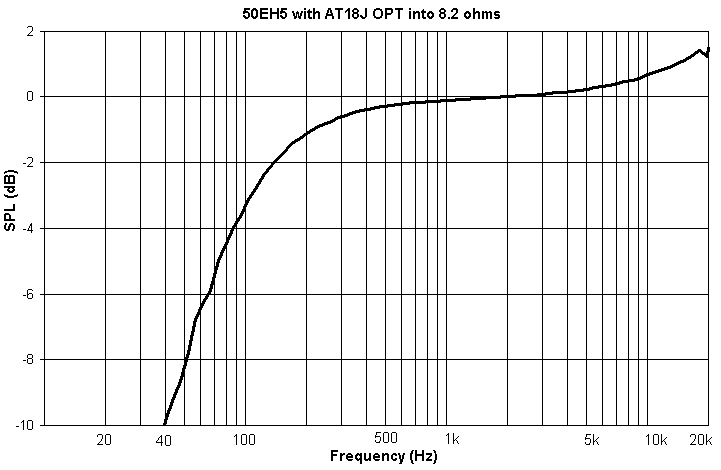

50EH5 Measurements
I finally got around to measuring my 50EH5 project. Attached is the frequency response from 40Hz to 20kHz into 8.2 ohms.
Basically, the amp is -3dB @ 100Hz and about +1dB @ 20kHz.
The response is about what I expected from these tiny OPTs. The plan for this amp is to power a radio shack super tweeter.

It looks like it would also be good as a "main" amp connected to a subwoofer to supply the low end.

Re: Re: 50EH5 Measurements
It would be ok, the problem is I don't have a suitable (efficient) 8 ohm speaker. With the 8ohm 2.5k OPT, this amp sounds horrible into 4 ohms and even worse into 16ohms!
Check out the attached graph.
The volume control will let me adjust the tweeter seperately from the preamp and into an 8 ohm supertweet @ 97dB, the low power is not an issue.
The rise in the top may well be a sign of some ringing in the OPT... adding an appropriately sized (small) cap shunting the primaries is a tactic often used to counter this.

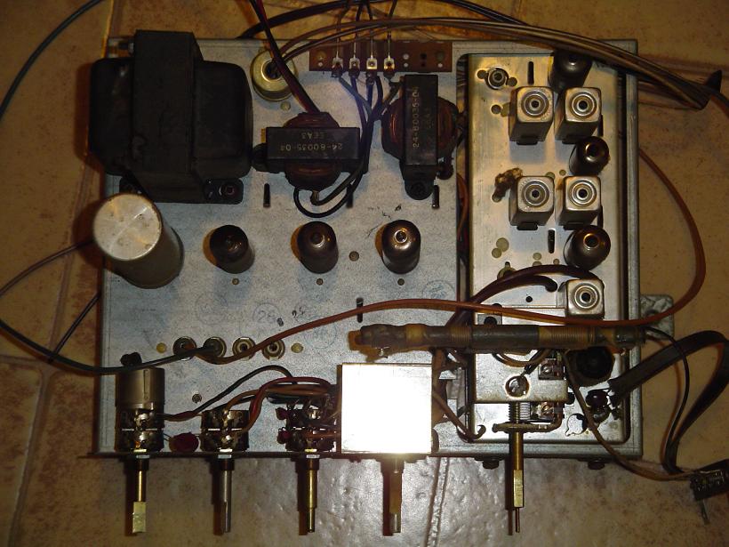

Thanks Dave for your reply. You're certainly right about this amps anonimity. I can't seem to find any label that points to a manufacturer. There is an ink stamp indicating RCS 602 but I believe that's the Viking model and not an indication of the manufacturer. For what it's worth here's a picture of the amp.
That's a receiver. All the stuff to the right of the photo is RF related. What are the tubes in line leading from the big can at the photo's left? I'm going to guess a 12AX7 and 2X 6BQ5/EL84s.
The power trafo seems fairly substantial but the O/P "iron" looks puny.
Eli,
The ECL86 was referenced, which would make the twin triode extraneous, unless it is there to recover gain from tone controls, so you may be right.
I have had those (or similar) OPTs thru here.They are smallish, but still good for a 1st tube amp build -- say an RH84.
