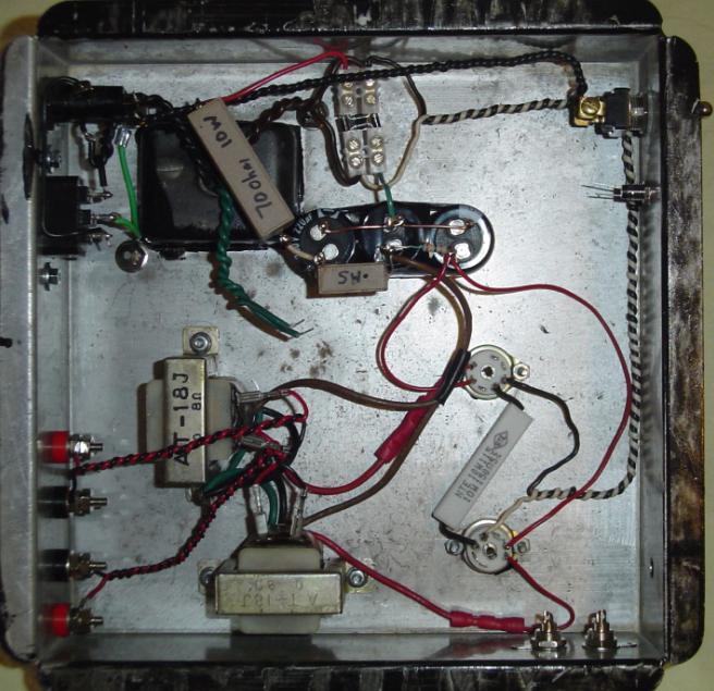

Need advice .. 50EH5 Amp
Greetings,
I need some advice and pointers to finish up a 50EH5 "spud" amp. Underside picture attached.
The datasheet for the 50EH5 can be found at:
http://www.mif.pg.gda.pl/homepages/frank/sheets/093/5/50EH5.pdf
Dave mapped the console that the parts came from:
http://www.diyaudio.com/forums/attachment.php?s=&postid=563745&stamp=1107083701
I am generally following this circuit:
http://www.mif.pg.gda.pl/homepages/frank/short/001/5/50EH5.gif
I will not use a DC blocking cap. The heaters are 50VAC. Going to DC heaters is possible.
I need some help with grounding. I have made this with a 3 prong outlet, so I have taken the ground from the outlet to the chassis. The AC from the mains transformer is to the heaters and to a 4XUF4006 bridge into a 70ohm, 220uF, 220ohm 470uF, 22ohm, 470uF supply.
Should the speaker negative and RCA negative go to the chassis?
What about the DC negative ... should that also go to the chassis?

Re: Need advice .. 50EH5 Amp
If you aren't using any feedback you can just float the speaker outputs. As to wiring schemes... do a serach on star grounding... to much material to go into here, but as a simplification all the signal grounds should go to one point, all the PS grounds to a different point, then these 2 should be wired together & to the chassis (often thru a very small cap)
dave
GG said:Should the speaker negative and RCA negative go to the chassis?
dave
Re: Re: Need advice .. 50EH5 Amp
Thanks .. I was a little worried about connecting the AC ground to the DC negative. I will worry about snubber, coupling and bypass caps later.

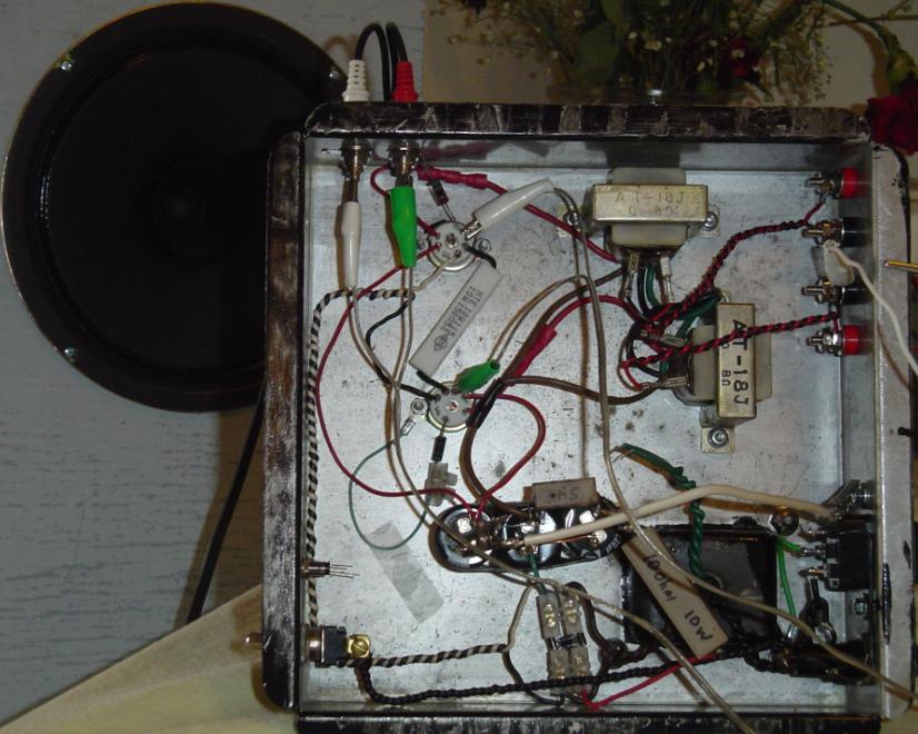

50EH5 SE Amplifier and Cathode Bypass
Well, this confirms what I am hearing without the bypass. I should put more faith in my hearing. I also noticed that the lack of a cathode bypass does not affect the quality of the midrange and high frequency responce, with the exception that there is a loss of power. Is this consistent with your experience?
That is very well explained. I have seen the use of batteries on the cathode in circuits, but never an explanation. Now, would the batteries have to be charged up on occasion, or do they pick up enough power from the circuit? Having to charge up the batteries would not be desireble for me.
Right now, I plan on just listening to this little guy as an amp. However, with the limited bass extension, my long term plans are to use this as a tweeter amp. When I do that, I will simply remove the cathode bypass as it does not sound like it affects the mid-range and high frequency. However, there is a significant loss of power. What would be the effect of remove the cathode resistor Rp and going straight to the ground? Could this damage the tubes?
I have posted a couple of pics of the finished amp in the Photo section.
http://www.diyaudio.com/forums/showthread.php?postid=642095#post642095
I am very pleased with the results of this low cost project (<$15US) and I have put togther a webpage. (see my signature).
Thank you to all who helped out with this project and esspecially Dave who provided a lot of input.
Gio.
