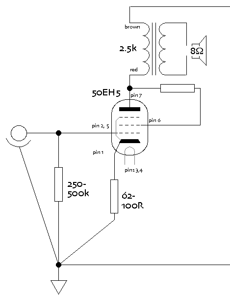

Here is the essentials of the circuitry... with only a requirement for 2.5V to reach full power the 12AX7 is way overkill (and may partially explain the large gridstopper). The grid leak on the power tube is one of the tone control pots.

And here is the minimalist design i'm hoping to get away with... no grid stopper, wired in triode (lower power, lower output resisitance), no cathode bypass (some degeneration, higher output resistance). If i can get away with it, then the only cap in the signal path is the last power supply cap.,,, with only a requirement for 200V i can put a nice poly there.

planet10 said:And here is the minimalist design i'm hoping to get away with... no grid stopper, wired in triode (lower power, lower output resisitance), no cathode bypass (some degeneration, higher output resistance). If i can get away with it, then the only cap in the signal path is the last power supply cap.,,, with only a requirement for 200V i can put a nice poly there.
dave
This looks great. I'd be willing to try this out too. When you say poly, are you talking polypropylene or is polyester good too?

GG said:This looks great. I'd be willing to try this out too. When you say poly, are you talking polypropylene or is polyester good too?
In general polypropylene is better.... If i don't have something suitable in my collection, i'll probably just get a Solen.

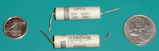

These capacitors caught my attention .. they look like some sort of poly.

Any thoughts on those capacitors? The outside feels like ceramic?

GG said:Any thoughts on those capacitors? The outside feels like ceramic?
I'm not quite sure what those are... Aerovox is a good brand name thou.

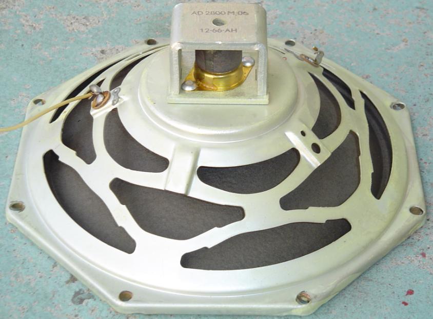

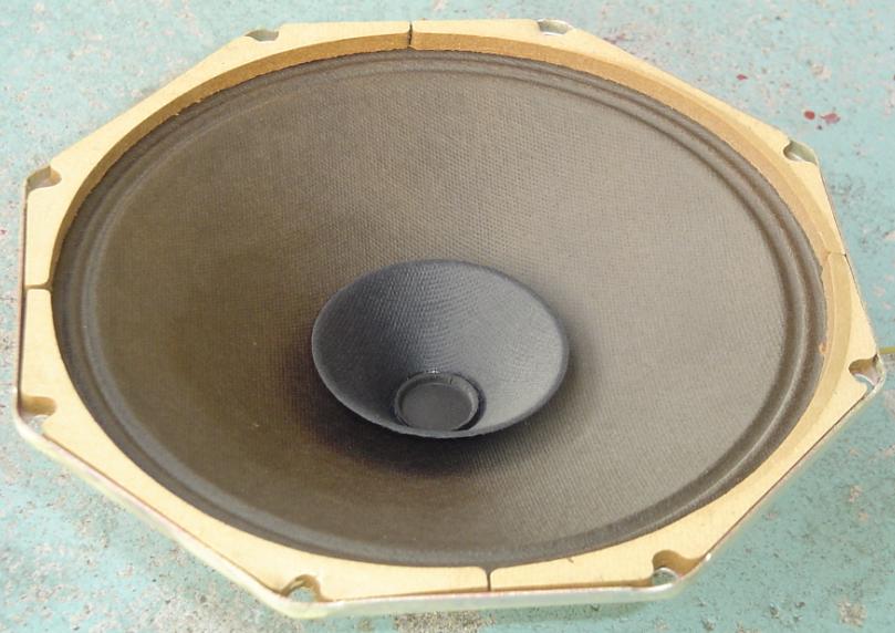

The console had 4 ~6.5" alnico, all paper, full range speakers. The motor is small and the frame is light. However, they are in great condition for their age, but I do not find them too exciting.
This time I took pictures! 🙂
planet10 said:
.... pull those drivers -- even if it is only for me to see a pic 🙂
dave

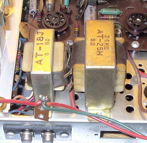

The power iron is very large. The OP transformers are much bigger (twice the size) of the previous ECL86 OPT that I pulled.

Very likely Hammond iron -- you have the bits there for a nice little SE amp (either reuse the ECL86 or go to EL84)
Don't let the tiny magnets fool you, those are quite sought after for open baffles...

Yeah, the OPTs on this console are respectible, so I will try an SE amp. I also want to try a simple 12AX7 phono preamp.
Is there a way to measure the OPT to determine if it is also suitable for an EL84?

An ECL86 can generally be considered half of a 12AX7 & an EL84 in the same bottle (a bit less dissapation than an EL84) and uses the same range of OPTs as an EL84 -- given the economics of manufacturing, it is likely that the same OPT was also used for EL84/6V6/6AQ5 applications.
To measure the turns ratio, i connect my Variac to the primary (set to 10V) and then measure the secondary. Divide 10V by the measured voltage on the seconday and square it... that is your turns ratio. Multiply that by the nominal impedance of your speakers and you have the reflected impedance of the OPT. For an EL84, 5-8K is typical.
An example can be seen here (my guess is that these OPTs are similar to yours)

I kept the speakers. I wired them to the output transfomers when I brought the amp up. Each channel includes a 8" woofer and two 3" tweeters in parallel and a 6uF 'crossover'.
No foam rot like some other speakers I've seen! I was going to throw them away but after reading a bit more, I may try to use them. Gee-tar cabinet?

Any chance you can take pics?
Try throwing the 8s on a baffle (even just a big piece of cardboard... you might be surprised 🙂
