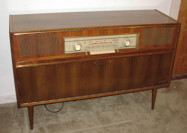

That there is a Grundig Mandello, a unit which I have pride in. I wouldn't recommend taking it apart if that's the one you're thinking of.
Might I ask where you got this picture? I have one of these myself and I use it on a regular basis. It's one of the best radios I've ever used and the FM quality is outstanding.
It has the obligatory european oval speakers, reminiscent of the american 6x9, but bigger and really nice. On the sides of the unit, underneath the little plastic grilles, are small electrostatic tweeters.
Perhaps you already know all about this unit and I'm wasting my time. But I had to put my comment in on it 😉

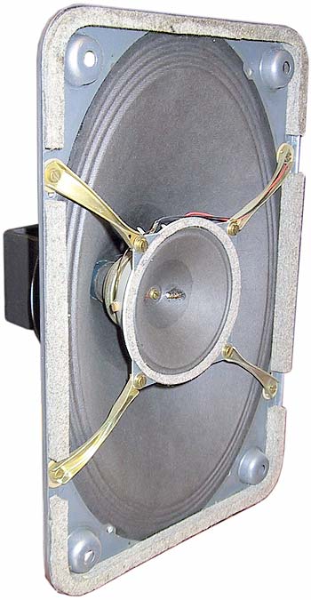

1/ they come with nice speakers -- the Nordmendes in particular are a rich source for vintage alnico Isophons (older Noresco speakers are also a good source for isophons)

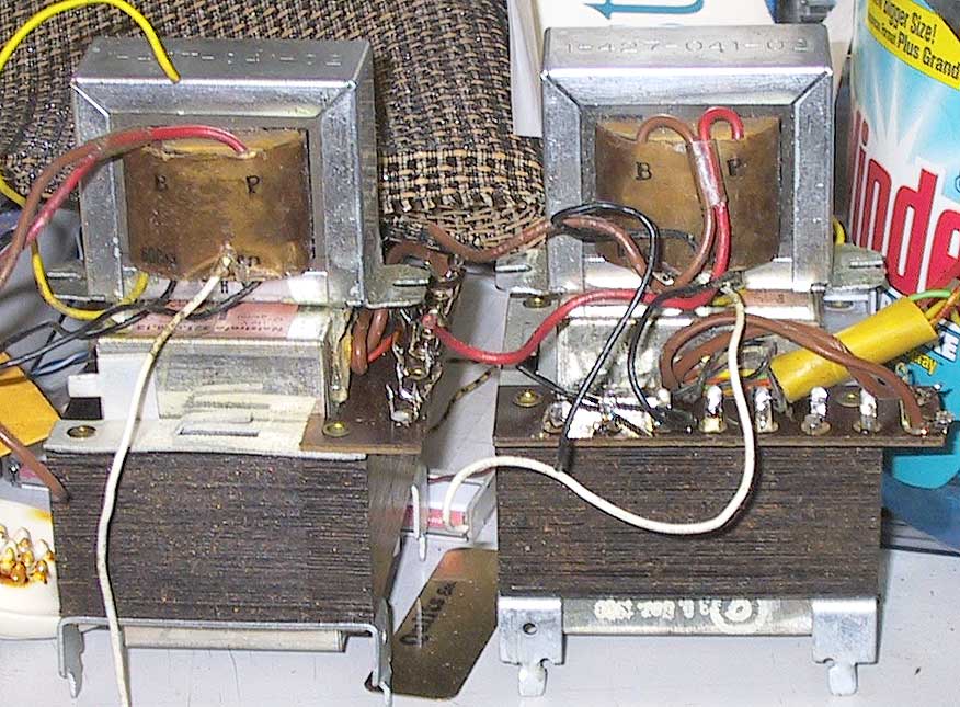

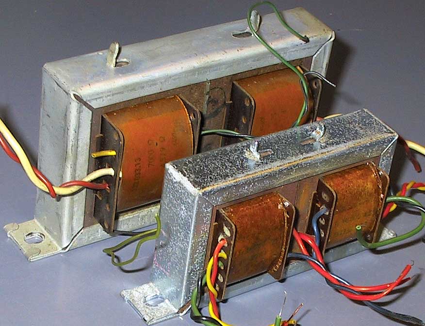

3/ most of the times the iron will be small but well made... but every once in awhile you score one of the higher end, and that iron is really nice.
Little Nordmende vrs big Nordmende iron
usually the iron is SE, but occasionally you'll run across a PP. The little SE iron will make an amp that doesn't have a whole lotta bottom end, but conversly this makes them quite good you use as tweeter amps (one of the constraints of SE iron is that to get them to go low you have to scrifice top). If you find 2 sets of iron you can also do the parafeed thing... use the primary of one OPT for a parafeed choke, and another for the OPT -- the friend who built the spud above eveloved the Decware ZEN idea into parafeed monobloks (EF86 into EL84, both triode strapped) that are quite stunning. He used Grundig trafo, OPTs, hammond choke, and RS filament trafo. I've also run across a couple RTF consoles with SE EL84 OPTs that are monsters (think ST70 OPTs)

Reel-to-reels are also a good source for bits. Here is a pic of some sizeable EL84 SE OPTs from a Sony portable R-R (sitting on top of a pair of Nordmende power trafos). They also have a 600 ohm secondary which could be run out to RCAs and used to drive a SS woofer amp and add the tube amps flavour too, or even use as a real ballsy pre-amp. (i'm guessing the OPTs are made by Tamura). The tape deck these came out of also came with a pr of a Coral version of the FE103A)

Duo said:Might I ask where you got this picture?
Sorry, I found the pic on the net. It was ment to show people what what a console kinda looks like. The consoles I see are typically Viking or Fleetwood.

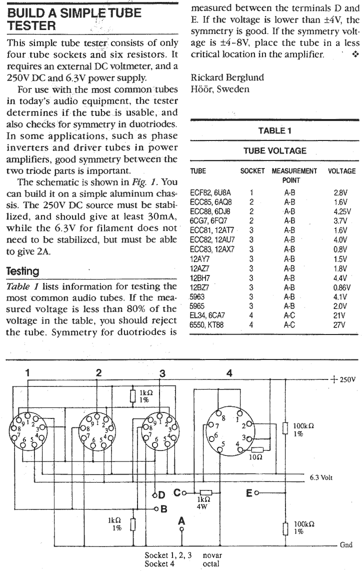

I may have to consider getting a tube tester. What do these normally cost?

My tube tester (Heath) turned out to be broken (good for testing shorts thou). I have another i haven't checked out yet (so old i need to check everything over before plugging it in). I also have a couple articles on making your own tube tester. I haven't pursued any of these because there is a local fellow (Pacific TV) with a whole whack of really good testers. He charges me a loon a tube (sometimes i swap him parts). The real value is that the guy is a wealth of info about tubes, tube kit etc. I always leave with my tested tubes with way more value in information and stories than the cost of the testing 🙂

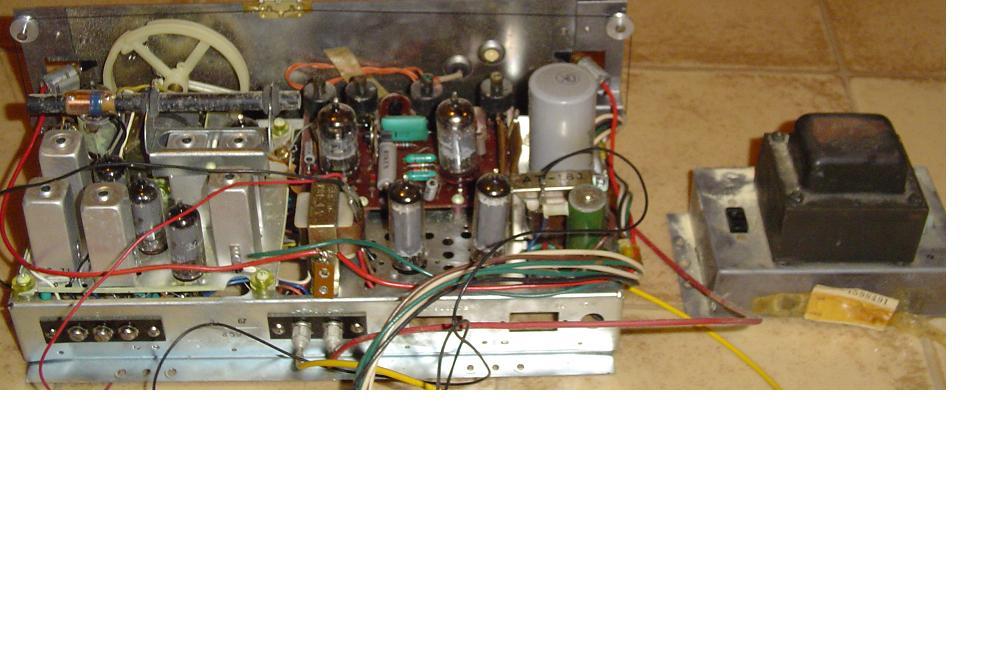

Well, I got the bug, so I purchased two consoles today and took them apart. Here are the details:
Viking $13CDN
Power Iron EEA3 24-80035-04 (enclosed)
Output Iron EEA3 24-10034-01
(2) 6GW8 / ECL86 - amp
(1) 6C84 - rectifier
Radio tubes (one each) ECC85/6AQ8, ECH81/6AJ8, 6BA6, EABC80/6AK8
Fleetwood $7CDN
Power Iron ANB8 71F055 60CY (enclosed)
Output Iron AT-18J (marked 8 ohms)
(2) 50EH5 - amp
(1) 12AX7A - preamp ?
Radio tubes (one each) 19EA8, 12BE6, 17EW8
(three) 12BA6
I did not have to look hard for something to do with the 50EH5 tubes:
http://www.t-linespeakers.org/tubes/SEP_50EH5.html
Mine would have to be a $7 amp! 😀
How do I figure out what type of output tranformers these are?
Also, anyone have any project suggestions.
Gio.
Viking $13CDN
Fleetwood $7CDN
(2) 50EH5 - amp
(three) 12BA6
Gio.

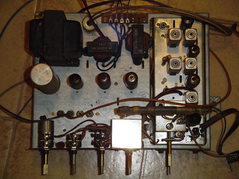

Can you take pics... the 50EH5 amp may be the same as a pr of amps i have for the mark II (BTW, my $5 amp cost more than $5 --- just the name given to it by Allen Wright.
The ECL86 is a candidate for an RH circuit.
dave
dave
Re: Fleetwood
Yes, that is the one i have 2 of. They have much, much nicer OPTs than the usual 50EH5 faire and they come with power transformers to boot... i've got chassis started for 2 stereo amps. I was going to see how few parts i could get away with in the amp (ie 3Rs).
dave
GG said:Here is a pic of the Fleetwood with the 50EH5 tubes.
dave
No mention of the speakers in these puppies....
I know i was able to sell the one's out of the Vikings. If you remind me what they are i can tell you for how much.
I also note that your Fleetwood has the same stream of transformer numbers as my last Viking with the PP ECL86 amp -- same construction style -- means Fleetwood was buying amps from the same place Viking was (come to think of it, aren't Fleetwood & Viking both Eatons house brands?). That console had RSC speakers with numbers that indicated they were OEMed for Jensen (the Jensen name makes them no better, but does make them more valuable if resold)
dave
dave

planet10 said:No mention of the speakers in these puppies....
I did not pay close attention to the speakers. The Fleetwood were 6 or 8", one was badly damaged, the other had a small hole in the cone so I did not pull them. The Viking were 6X9 stamped 3W max, but one was damaged, so I did not bother with them. There were also paper cone tweeters, three pairs that I pulled out. They do not look too exciting.
Gio.
GG said:Do keep us posted. Simple is the way I like things. Were you planning to use the same iron from the console?
Will do... your find has inspired me to dig one out and at least trace the thing.
Even so -- worth pulling the singles... you nevr know when the opportubity to mate them will come... the alnico makes good fridge magnets on the damaged ones... feed me the numbers and maybe i can come up with some info for future reference.
