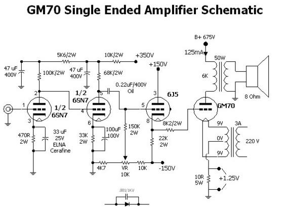

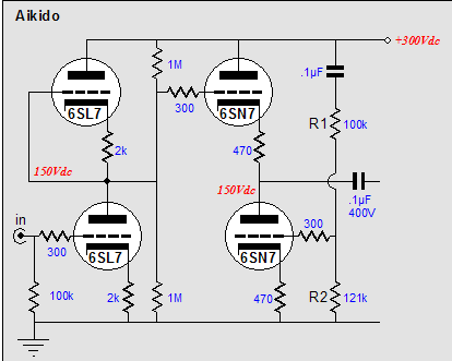

Drive the GM70 triode with Aikido preamp
Hello to all
I would like to have a couple question about my GM70 triode amplifier project.
First question the attached schematic is correct??I would like build similar 3 stage amplifier but I want to run my amp about 920V on the plate 80-85 mA.
Second can I drive the GM70 tube with the Aikido octal preamp?I know someone did it , I found in the You Tube GM70 amplifier driven by Aikido. Unfortunately no schematic available.
It would be easier to purchase the PC board for the driver stage.
If I can use the Aikido PC board how I connect the bias for the power tube?
All help are welcome!
Thank you very much.🙂
Greetings gabor

I think we would need a higher gm driver than the Aikido. Probably a Tube-lab SE driver or pentode driver. I am currently trying research some driver circuits. I have the octal aikido and don't think it has enough bite to drive the GM70.

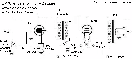

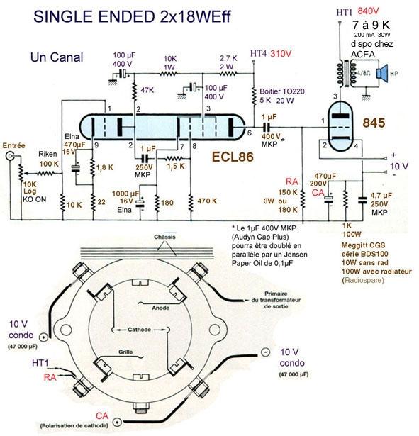

I sow on You tube Aikido driven GM70! Sounded great...
Also the attached schematic is similar like the Aikido but the second stage only half triode.🙂
That is a working (I don't know if the best , or can bring out the best performance the GM70 tube) circuit.
If you take a look that second stage only half triode, the Aikido second stage a double triode which is much stronger I think (all do I can be wrong)You wrote you have the Aikido, I don't!
Don't forget many DIY-ers built only two stage GM70.
Look the Andrea Ciuffoli circuit. Even do He use inter stage transformer still two stage GM70. He's transformer 1:1. I upload His schematic.
Also I attache a 2 stage 845 which is very close to the GM70. Someone wrote if I change the heater to 20V I can use the 845 circuit !
I do not need 45W from the GM70. 15-18W it would be more than enough.
Thanks any way about your comment, good to know you also search for driver stage for the GM70, I'm not alone.
Please let me know if you find something! I do my homework to..😱
Do you have any OPT idea??

driver tubes
I tryied the D3A, 12GN7A tubes with exellent performance! they can easily drive the GM70!
