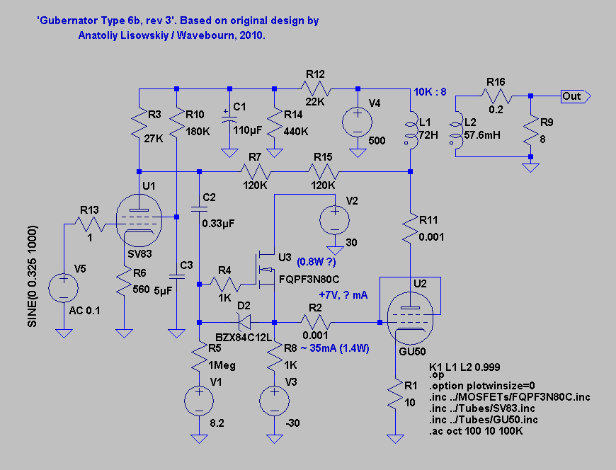

I don't know which one you are referring to.
This is an alternate version where the GU-50 is configured as a Right-handed triode requiring positive grid voltage. I have not built it and do not know the power output.
Yes, you are right that I built the one with many MOSFETS. But the MOSFETS are all mostly in the power regulator section, not the amp section. I built my power supply with split power supply and CLC smoothing, and eliminated the voltage regulator stages. 🙂 Also replaced the gyrator section with a resistive plate load due to lack of time to make a gyrator. So basically, mine has got NO MOSFETS 🙂.

I'll wait to see all the schematic.
I don't understand what you mean. You've attached one of versions to your own message. That means you could see it, save it, attach, and post here.

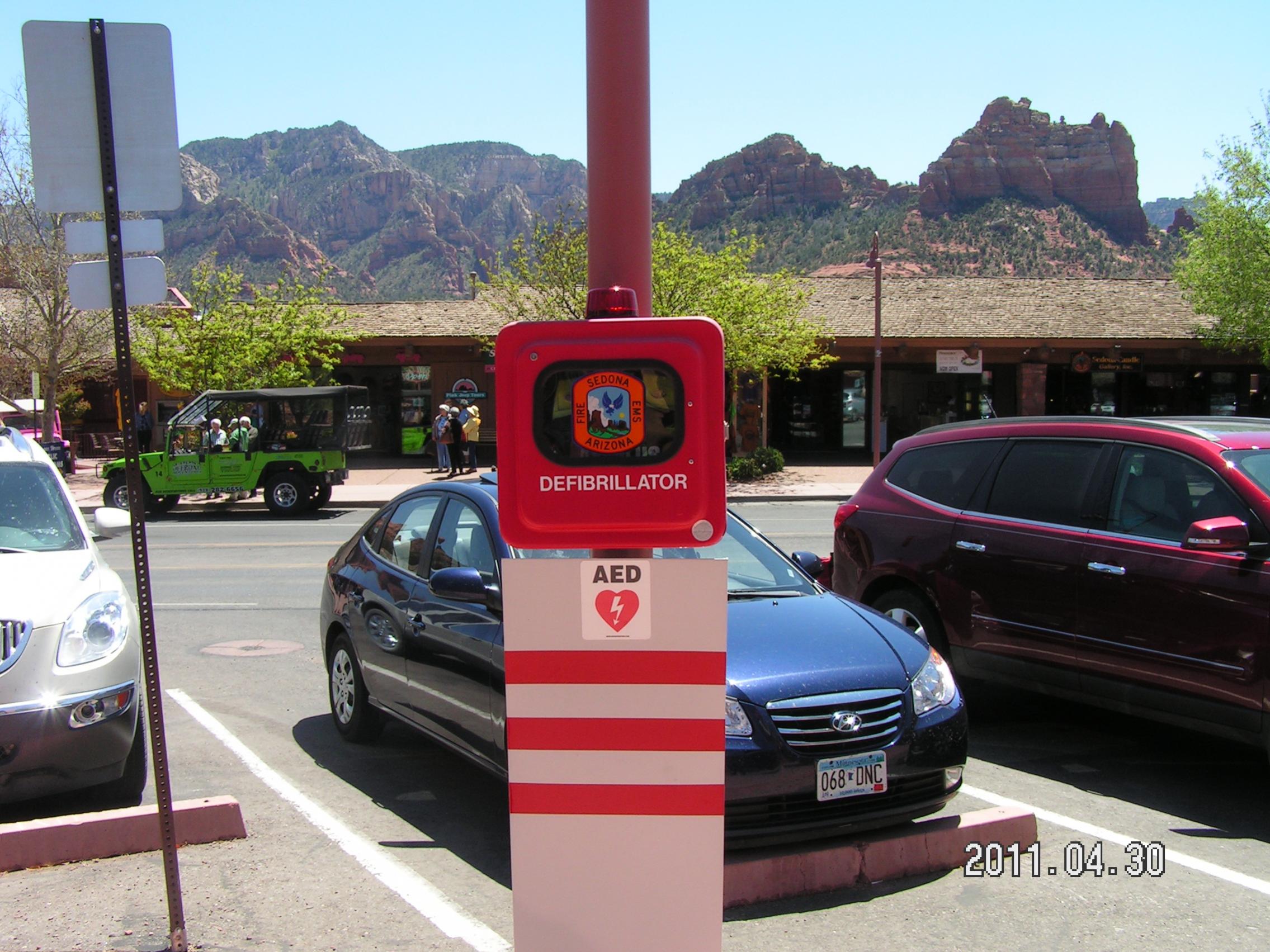

Have you got a schematic for a defib 🙂 .
If not then have you got a circuit for an 845 + PSU running approx 900V.

I'm not totally a novice ,I have more than 20 years experience DIY! At the beginning with tube amps after (the last 18 years) only SS amps and some tube amp upgrade.
What I mean at page 2 post 13 you posted some schematic and I'm unable to see that.
Do you mean this one? I have not heard from Frank since he posted his version, but I am pretty sure it should work well.

My point was, to exclude both chips and transformers, but exclude as well a coupling cap to the grid of an output tube because it's input current is non-linear causing dynamic distortions when driven through a cap. That's why it is driven through a cathode follower loaded on a CCS. Also, cathode follower welcomed load of the 1'st tube on gyrator with high dynamic resistance on AC, for minimum distortions.
