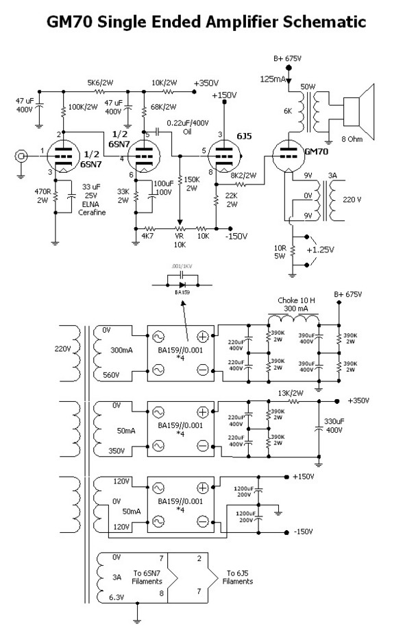

Hi Gabor!
i will draw it! and scan it and will be posting to you to see it..
this is my latest amplifier i made, so the schematic is in my head!
i want to make some changes!
now i am running them with self bias...!
1) I want to change them to custom bias!
2) I want to configure the driver stage replacing the anode resistor with a choke loaded..
I think i will get better results.. if not! I'm open to any advise every one can give me!!
3) In my opinion you will build a good amplifier!!
if you customize something to your own needs!!
fixing something from another some times is a good thing to go...
but we are talking here about taste!! and not every one of us has the same taste!!!!
to some will sound great, to you will otherwise.. that doesn't mean that there aren't any good schematics on the web...
once again if i am wrong somebody correct me!!
i will help you with every thing you need!! soon a possible a will send you some drawings! you can do what ever you like with them!
try to experiment!!!!!! 🙂
best regards Nomikos!!

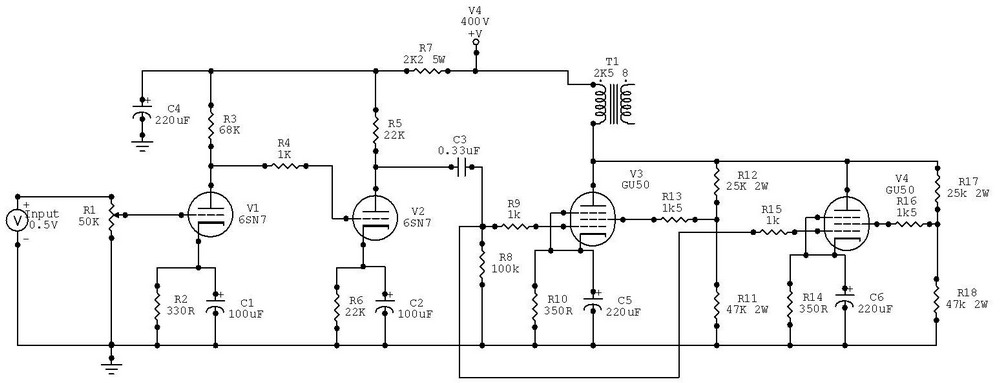

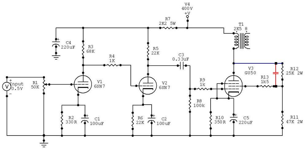

Hi Gabor,
I have built this amp taken from Wavebourn site using GU-50.
My friend who has a 6550 amp says this amp sounds way better than his custom designed amp.
http://wavebourn.com/forum/download.php?id=487&f=7

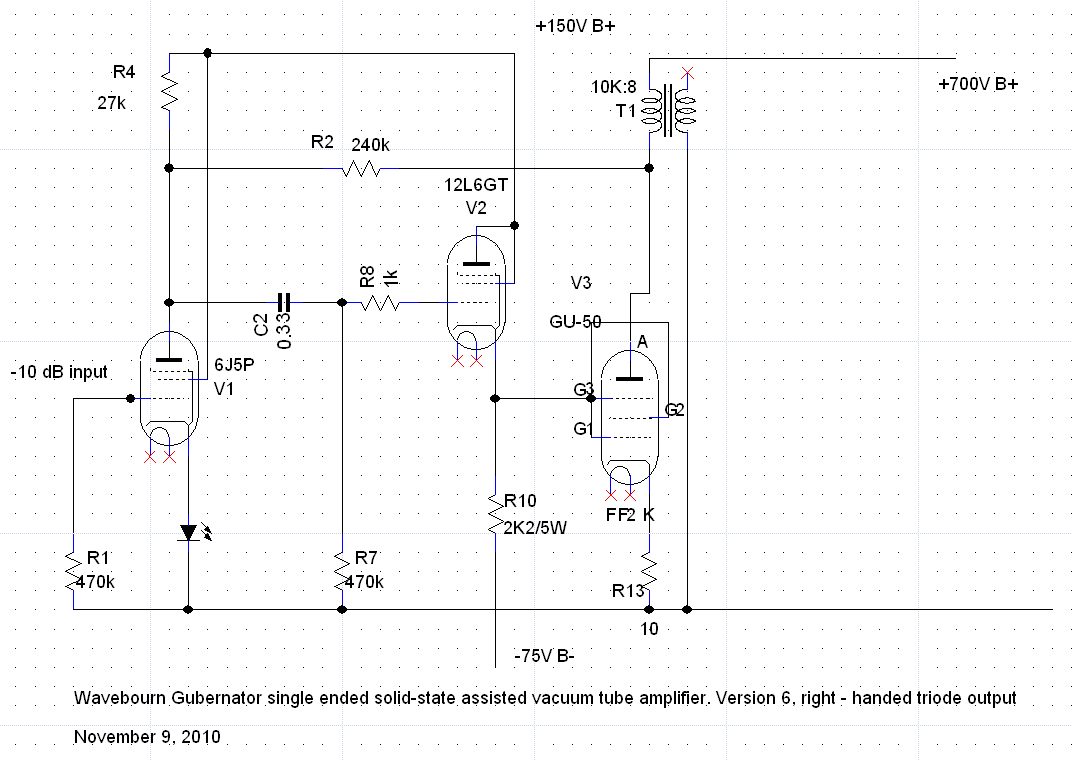

Hello quikie22
Thank you for your post, and good to know you like your amp.
Are you sure Wavebourn gave me that schematic to me? To me a bit look to complex that amp.
Did He gave that schematic to you or pick one from his website? I have all respect to Wavebourn , I know He is a great designer.
I sow many of his amp on the forum , all my respect to him!I'll wait on Nomikos, GM70 tube also nice..
After I decide which amp will chose.
Thanks one more time.

this is a nice amplifier with great characteristics!!
me an a friend build this amplifier for him! and we were very happy with the results!
i got a few interesting ideas from it!! tomorrow i will post the schematic that i draw!

Hello nomiconxp
Thank you for the schematic! Let see what other experts will think about.
Also I found several GM70 schematic.. To me the inter stage transformer a bit new ... All do nice schematics!
I found in Andrea website also similar amp.

That circuit is on Wavebourn site. 🙂
I simplified the circuit by using a resistor as load for the first stage instead of gyrator (BSP225 circuit).
The driver stage is excellent thus explaining why the sound was so good. The cathode follower using the 6N6P ensures optimum drive voltage and current for the GU-50 thus ensure best power output and sound. You can follow our discussion and thread on the GU-50 cct on Wavebourn site.

I found also a couple GM70 schematics, here is one of them
gm70 se
gm70 se

the circuit i have passed you is the finalised version for a single-ended GU-50 amp. We discussed several possible versions with MOSFET followers and tube followers. As I was keen to keep the the follower to tube, we came up with this final design.
AS for the sound, it sounds great. I have not heard the GM-70 so I cannot comment on its sound. I have listened to 6550, FU-13 (813 analog), EL84 and many solid state amps, including the highly regarded Pass Labs F5. The Wavebourn GU-50 Gubernator beats them except for the FU-13 amp. (and that is only because the FU-13 is a much higher power beast, running at >1kV voltage).

I still wait on Wavebourn answer because he posted a schematic and it impossible to see it, to open up.

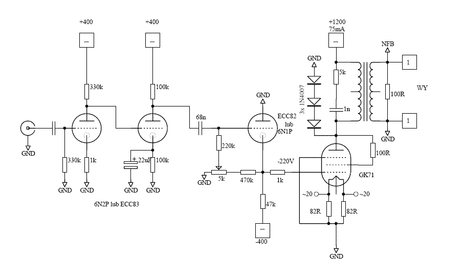

Here are some more schematic
Hello
There are some simple schematic.
To me important to be simple at first so I can finish the project and can test it.
After I can do some upgrade,when I know it worth to invest more into the project.
Please someone comment these schematics I'll post .
Thank you

If you want a simple GU-50 amp, this is a very well thought out one.. Look at post #66. I believe it is even simpler than the schematics you have posted 🙂

I still didn't got any info from Wavebourn. If you go back you can see He advise one amp but I can't open the attached schematic..
Can you open that, I think is on the second page..
