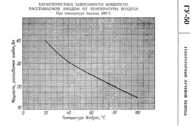

Gu-50 was designed for 14,000 hours of life in military equipment when used in specs, including temperature. If 2 or more parameters are on the edge of maximal values the plant would not accept complains.
Here is the graph that specifies max power dissipation depending on ambient temperature.

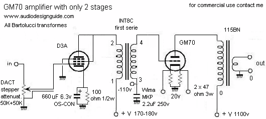

Hello
Here is the whole website about that GM70.
I would be delighted to find a schematic like these with 3 stage so no need for a preamp.
With separate preamp more connectors , RCA cables etc.
I think the schematic originally posted on the website not correct.
I see 3 tubes on the amplifier plus the rectifier tube.
At the schematic only has 2 tubes🙁
Can someone explain these??
GM- 70 amplifier mono
Greetings Gabor
In the schematic there are 2 tube rectifiers supplying different voltages.

Hello singa
Yes you right! Because he wrote about a 3th powerful tube to drive the GM70 i got confused.
Now I took a look at the PS and I see it.
Greetings.. gabor
Greetings.. gabor
Hello
I think one of the most important parts to get the right transformers for start these project.
If nomiconxp some reason can't help us with transformer we can probably can order from Edcore but we need all the info about the transformer.
I think we need a special transformer here!
I see Andrea used Tango and Bartolucci transformers but those are $$$$ pricy!
Greetings gabor
Greetings gabor
