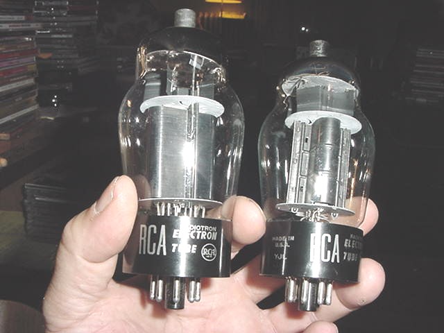

tubelab.com said:And there was this old RCA. It looks too cool.
Looks kinda like a KT88 with a plate cap. Very cool!
I recently picked up a few GE 6BQ6GTB's, a couple 12BQ6GTB's, and a couple 12DQ6B's. I was going to try AES for some 6BG6GA's. Did you ever test any 6BG6GA's in your Simple SE?
Jeff
Yup, that's an RCA. They are the original 6CB5. I have a few from years ago (keeping them) and lots of the later A version. They were used in at least one of the old Dukane amplifiers. This number has been one of my favorite outputs for years. Notice the left tube has a smooth plate.tubelab.com said:And there was this old RCA. It looks too cool. Did RCA really make this? Where can I find 3 more?
Victor
They look really nice, the 6CB5 G (or ST) bottle. I am curious if I will receive some of those bottle types among the 20 pieces ordered about two weeks ago.
Erik
Erik

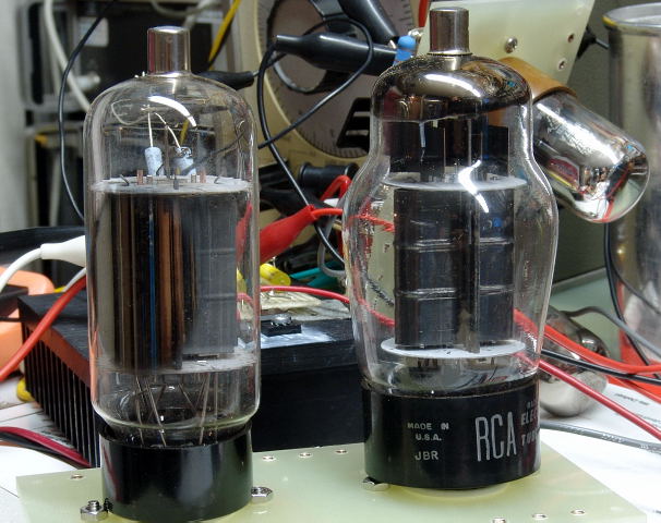

Looks like the plate from a 6146.

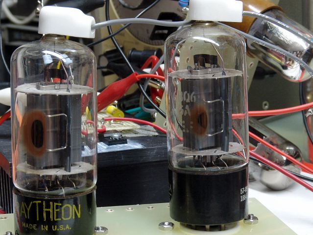

The 6BG6GA's that I received from AES are a much later design. The plate structure looks like a 6L6GC. The textbook ratings for a 6BG6GA is 20 watts. Some Sylvania 6BG6GA's were made with 7027A internals that can handle 35 watts. These look like something in between those extremes. The unique pinout of a 6BG6 makes it difficult to test in a Simple SE, but I may test these since they are here. It is much easier to simply plug a 6L6 type tube directly into the Simple SE. Every 6BG6 variant has a 6L6** (or 7027) equivalent.
