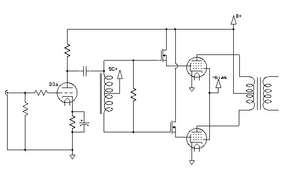

Thanks. Any tips on choosing OPTs ... or rather, any tips on choosing tubes to use with the pair of 2K5:4 OPTs I already have? 20W to 30W (or less really) of actual power is fine.
Also, since my power requirements are modest, is using a highish mu tube as an initial gain stage and leaving out the second gain stage reasonable to simplify things a tad. Something like the attached.

The interstage xfmr will have to handle rather high voltages for screen grid drive. If you are going class A output operation, I would put a CCS under the cathodes to split the signal at the outputs. Then delete the interstage. Getting enough gain for screen grid drive in one stage will be hard, to say the least. Maybe with a pentode input stage.
