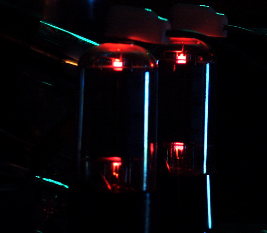

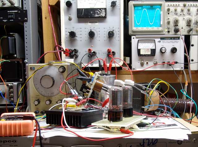

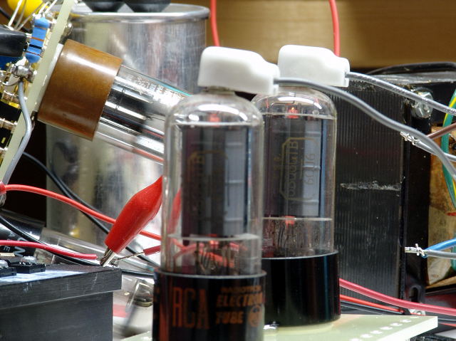

OK, enough of that, tonight I decided to find out just what the Leaning Tower of Power (a very lopsided 6BQ6) could do in screen drive. SURPRISE, the little guys ($0.98) ROCK! I just kept cranking up the voltage and the drive, they just kept making more power without glowing at all. How much power? Would you believe 60 watts at 5% distortion! Believe it. How much power does it take to get some glow? 80 watts! Now we are at roughly 3 cents per tube watt.
Scope trace is at 60 watts, distortion is 4.99%.

Details:
Power output at 5%, 60 watts. Plate voltage is 500 volts. Control grid is at - 10 volts. Screen grid is at +29 volts at idle. Idle current is 10 mA per tube. Load impedance is 6600 ohms. Cathode current is 190 mA for both tubes at 60 watts output. This is 95 watts input for 60 watts output or 63% efficiency and 17.5 watts per tube of dissipation at full power. Yes, over the 11 watts published rating, but this is only seen at full power, not a problem for a HiFi amp that sees full power only on signal peaks, but probably not a good guitar amp.
While I was typing this, I looked up the tube specs and realized that the max plate voltage is 600 volts. For 98 cents, what have I got to lose? Max voltage is on my power supply is 550. Power at 5% distortion is now 73 watts, NO GLOW! Cathode current is 210 mA for both tubes at 73 watts output. This is 110 watts input for 73 watts output or 66% efficiency and 18.5 watts per tube of dissipation at full power. Power at the glow point is 90 watts, where the amp is still making a respectable 9.5% distortion. Full cranked clipping is 104 watts, yes the tubes complain brightly from the plates and screens!

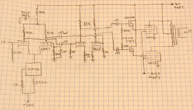

George a couple of quick questions. I may have missed it but did you post a schematic of the circuit you are using for this test? Also did you run any tests at a more sedate B+ say in the 350V range?

Per request, I set the power supply on 350 volts. I gould only get 25 watts after turning every knob there is to turn. There may be some power to be found by swapping OPT's.
I have not drawn up a schematic for this mess yet. It is very similar to this one, I just used different tubes and changed some resistor values.

Thanks George, that helps a great deal. So it is the Defibrillator style B+ that makes this tube get up and sing. Still 25W would be all I would need for my woofer amp.
I noticed that the circuit uses LTP PI as first stage with balanced VAS after. Do you prefer the sound of this arrangement to the conventional one with PI just before the drivers? What are the practical advantages?
Sorry for the 20K questions. 🙂
hmm... just noticed there is no load resistor on the source followers. Does the output tube screen grid act as the load all by itself?

Notes on the driver circuit:
The posted schematic is from the 6AV5 screen drive test I did over a year ago. It no longer exists. I started with this schematic and built the tag board driver used in these experiments. I used octal tubes (6SN7's) since I had some octal tag boards on hand. This circuit follows the original schematic pretty good, but several resistor values have been changed. I will be tweaking on this driver to improve the design as I use it. Once I have it where I like it I will draw up a schematic and post it.
The original 6AV5 design did not have any load resistors. This one currently has 10K resistors returned to a - 25 volt power supply. I would prefer a higher negative voltage, but I don't have one handy.
I had noticed an odd distortion profile (see post #105) where the distortion peaks and then goes back down. It is the same regardless of the output tube being tested. I am now convinced that this is coming from the mosfet driver. It distorts as the current through the mosfets drops to zero. Further work is needed here.
About 10 years ago Kevin Kennedy (kevinkr) designed and published a P-P 300B amp. It used this driver topology. I built a modified (OK, hacked) version of this amp. it is the only one of my old amps that I still have. It sounds great. I have preferred this topology ever since, but it does require more tubes. Exact tube section matching is not required, but some tubes are so imbalanced that they can't be used.
Practical advantages? The usual split load PI requires an equal load on each output to work right. The common practice it to tie the output of the PI directly to the grids of the output tubes, and this does well in typical static bench testing. However real music is anything but static, and the input impedance to the output tubes under high signal conditions is anything but constant and equal. Driving the screen grid is far worse. I prefer a buffer between the PI and the output tube. I have built amps with the usual split load PI followed by a buffer stage. It works well, but screen drive requires some extreme drive voltage. This means that all of the circuitry must be optimized for gain and dynamic range. This topology has done the best for me in that regard.

Since I was writing about the 6BQ6's at the time of mashaffer's request, I assumed that was the tube he was talking about. My 350 volt test was run with 6BQ6's and a 6600 ohm load. 25 watts is about what you would expect. Power did not go up when the load was configured to 3300 ohms. I think the cathode current is limited under these conditions.
All of these experiments are using SCREEN DRIVE. This is a relatively unexplored territory, so most of are learning as we go along (myself included). In a screen driven application the screen being driven positive is what casues the plate voltage to decrease. Any pentode does not like the screen grid operating at a voltage significantly above the plate voltage. The screen grid will hog all of the current, and get very hot (visible glow). Brief excursions on signal peaks are OK.
Lowering the plate voltage also lowers the screen drive voltage in my design since they are both operating on the same power supply. Two supplies could be used, but that would risk blowing the screen grid right out of the tube!
The amplifier output impedance is higher than a similar tube in normal triode operation. It is similar to the same tube used in pentode mode. NFB will likely be required.
