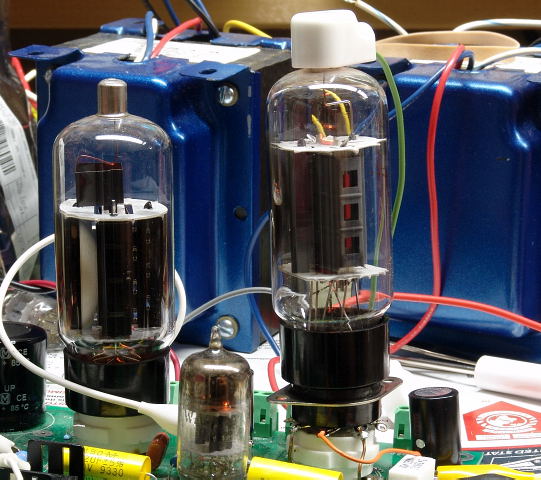

The 6CB5's were many different brands, mostly GE. They seem to all be made by RCA or Sylvania, except for one odd ball. It is marked Westinghouse, looks like Sylvania guts, has a stop sign type number and the grid radiators are different than all others.
They are easy to identify, the Sylvania's have large rectangular black plates with no holes in them. There are heat radiators on the top on G1 and G2. The type number is printed on the side with U.S.A. underneath. The RCA's have grey rectangular plates, slightly smaller than the Sylvanias, with three rectangular holes in each end. They have the familiar RCA stop sign type number. I got two RCA branded tubes that are made by Sylvania. The GE's are mostly by Sylvania, but a few are RCA. The Zenith, Raytheon, Dumont, and Sylvania tubes are made by Sylvania.

The Sylvania is on the left, the RCA on the right. Only the RCA has plate voltage applied.

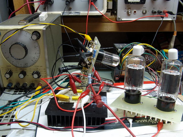

OK, I thought that getting 25 cents per watt from the 6BQ6GTB's in SE was cool. I just trashed the watts per tube dollar threshold. I am now at a nickel per watt, without anything glowing! How?

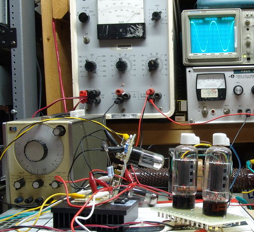

Well, I didn't buy a bunch of 6CB5's for nothing. Today I wired up a screen drive amp and turned it up, and up, and up. With my power supply maxed, and its current meter pegged hard, the power meter is reading 120 watts! Dialing the drive back until the distortion comes down to 5%, the watt meter reads 85 watts, so I will call this an 80 watt amp. At $2 per tube, $4 for the pair, this is $.05 per watt. I doubt that this can be bettered, unless I can find a bigger power supply.
This photo shows the tag board and clip lead design. The amp had been quietly cranking along at 90 watts when this picture was taken.
The tubes are biased near class B. The idle current is 15 mA per tube. This is achieved with a plate voltage of 550 volts. The control grid is at -11 volts, and the screen grid idles at +35 volts.

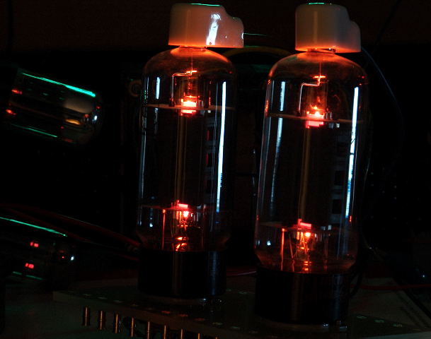

Here is my usual photo with the lights out. The amp is operating at 80 watts. Notice what is missing from the photo. There is no glow. Careful observation in a totally dark room with a magnifying glass reveals that the screen grids start to barely glow at power levels above 100 watts, and are readilly visible at 120 watts.
This proves that it is possible to violate the screen grid ratings in screen drive mode. This will not be a problem in normal use since this power level should be seen only on extreme signal peaks, and the amp is clipping heavilly.
Call this an 80 watt amp with 40 watts of head room!

Here is a close up picture of the amp. There are 3 main modules.
The tag board standing on its side in the rear is the driver board. It uses 2 6SN7's. The first is an LTP phase splitter. The second is a differential amp. DC coupling is not used in order to maximize the available output voltage swing.
The heat sink inhabited by sand state life forms is the mosfet follower. It contains two ST micro 900 volt 3 amp mosfets. These can feed the screen grids with enough current to make them glow.
The tag board in the foreground contains the two 6CB5's and nothing else. All connections except for the filament and plate are made with clip leads.
The OPT is seen behind the left output tube. It is an "80 watt" 6600 ohm guitar amp OPT that I got on Ebay several years ago. It will saturate badly at these power levels below 100Hz.
The large brown object behind the OPT is a 500 watt load resistor. Yes, is is not a purely resistive load, but it is the only thing that I have that will handle this kind of power. I learned from experience a few years ago that the OPT will instantly catch fire if the load goes open at this power and B+ voltage.
