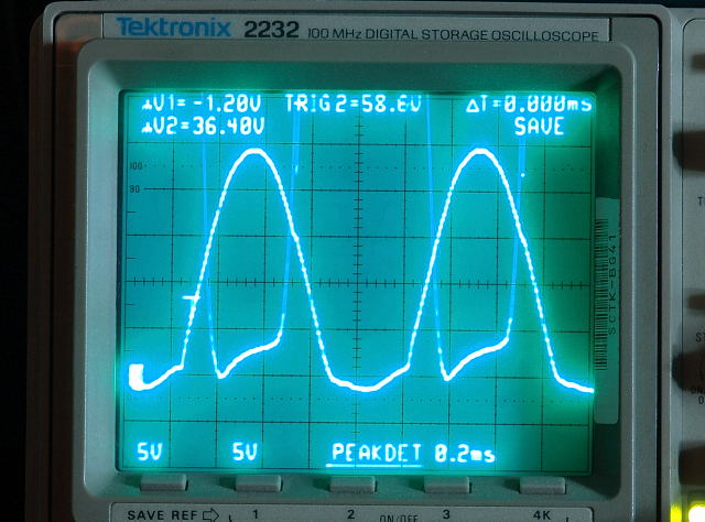

I'd love to know the peak drive voltage in hard clipping - those poor hard-pressed screens might have been above plate potential, and acting as surrogate anodes.
BINGO! At the moment that the screens are reaching for the sky, the plates are touching the ground, literally.

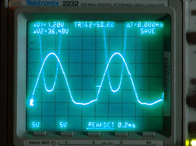

I did some measurements as promised. First off, I noticed some irritability in my tired power supply, so I put a 100uF motor run cap across the output. I was rewarded with 10 more watts when driven to clipping.
I put one scope probe on the screen grid, and the other on the plate, and took some pictures. This one is with the amp cranked to 130 watts. The scale is 50 volts per division, and zero is the second division from the bottom. The screen drive voltage goes from about -15 volts to +250 volts. The plate voltage touches zero and settles to about +35 before heading to some extreme positive voltage above 1KV.
There are two observations here. There is limited negative screen voltage. This is again a limitation of my power supplies. The bias outputs on the typical vacuum tube power supply can only source 1 or 2 mA. The idle current on the mosfet is about 10 mA, so I am using a SS power supply that only goes to 25 volts. In the final design, I believe that the negative screen excursions should be limited. Screen grids were never meant to be at -250 volts, and once the tube is cut off, why go further.
There is a small glitch seen in the plate and screen voltages as the amp comes out of clipping. This is an oscillation that only happens when the amp clips. Too many clip leads. The oscillation moves around as the clip leads are moved. Under some conditions it wipes out the nearby TV set and makes the computer speakers hiss!
Next picture. I turned down the drive until the amp puts out 80 watts. The screen grid is still being violated. The plate swings down to 40 volts while the screen goes up to 180 volts. The two traces touch at 50 watts.

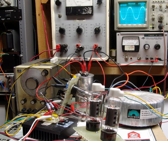

OK, time for one more expeiment, and this one moved the cost per tube watt. I connected my 8 ohm load to the 16 ohm tap. This reflects a 3.3 K ohm load to the tubes. What happened. Well now I get 115 watts at 5% distortion, and 154 watts at 10%. Turning the drive up any further sends my power supply into convulsions. The current must be over 500 mA. I had to shut the power supply off and let it cool.
This load now causes plate glow to appear before screen grid glow. Clearly, there is a happy medium out there somewhere. More experiments tomorrow if the weather is still bad.

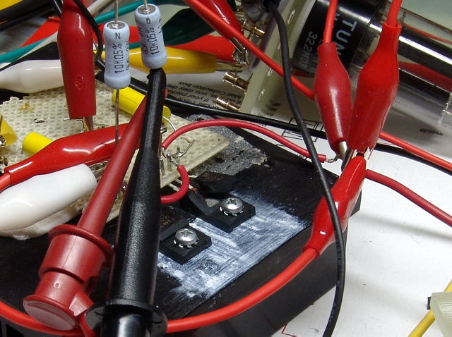

This experiment is sitting on top of a 1KV power supply that I got from Ebay. I am going to need the whole bench to build that big guy. In reality it must wait for some other experiments to get done.
After I replaced both (well 1 1/2) mosfets, and connected everything back the way it was, the amp is live again. So, whats next? Someone mentioned a BF toroid.
I hooked up the Plitron. I tried the 8 ohm load on all of the output taps and picked the one with the most power. I don't have the data sheet handy, but I think that it is on the 4 ohm tap giving a 2500 ohm load. The amp behaves about the same as before, except that I can make 130 watts at 40 Hz with 5% distortion. Some saturation is seen at 20 Hz, especially above 100 watts. There has been no attempt to balance anything, or match tubes.
The picture shows the size of this monster. The scope trace is at 1KHz and 150 watts. Distortion at this level is 7%. There is a pale glow of the plate in a dark room, screens are dark.
