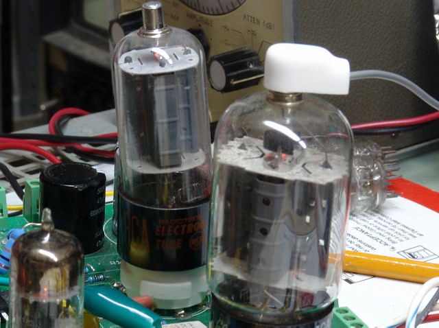

I had been looking for a fat bottled 6BQ6 type tube. I saw one with a plate like you would find in a 6AV5 in it. I have bought some 6bq6's from several vendors, and until today, I haven't seen one. I asked a tube seller to find me the fattest 6BQ6 type tube he could get and send them to me. I got 3 different fat boys. Well, whats next? To slightly misquote Mick Jagger "My favorite color cherry red".
These two tubes have the same number on them. The small one is the most common. Note how crooked that it is. The picture above was taken at about 40 watts of dissipation. (56 watts in, 16 delivered to the load). The small ones will melt at that level.

That **** eyed thing would drive me nut's
But I guess if it sounds good you could do something to make it look better, or deal with it.

I have read several complaints about some new production tubes being crooked. This is a good example of a vintage RCA leaning tower of thermionic emission. I have seen plenty of others. I only paid $0.98 from AES for this one, so I don't care. The other 9 tubes stand up straight. This one will be used for testing.
You I think it's funny I could care less about anything else it's just for some reason that bothers me, goofy.
Probably some Freudian thing saying it because of my Mother LOL.
Nick
No, I just know that this tube is likely going to get melted. Does it matter what it looks like. When I get a bunch of tubes in for testing, I pick the ugliest pair for experiments. This one qualifies. If it survives, it isn't going into an amp, it stays in my collection for experiments.

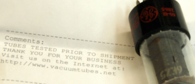

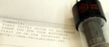

There are now two boxes of tubes here with a third (the AES box) due on Friday. I already have a Simple SE set up with a variable supply, and fixed bias from the power supply (cathode resistor jumped). I decided to test a few tubes.
First off I got 20 6EZ5's from Radio Electric Supply for $1 each. They resemble a 6W6 and I believe that they are cut from the same mold. I am not feeling up to any serious testing, so I just set the power supply on 300 volts and set the bias for 50 mA, in triode with a 5K OPT, to test the tubes for life.
The 6EZ5 will produce about 1.5 watts under these conditions. All of the good tubes were very consistent, and I did not have to readjust the bias voltage from tube to tube.

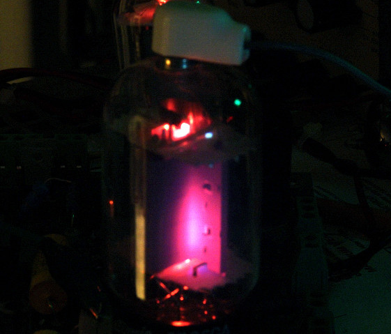

The first tube out of the box had a completely white getter, toast. The rest worked, except for one that would draw 100 to 200 mA, and glow the gassy tube glow. OK, 18 good tubes, 2 dead tubes. For $1 each, I'm not going to complain, it would cost more than this to send them back. I included a picture of the dead tube, lying on top of the invoice where it reads "TUBES TESTED PRIOR TO SHIPMENT". Look carefully, there is rust on the plate. Rust doesn't grow in a vacuum, so this tube has been full of Florida moist air for a long time.
